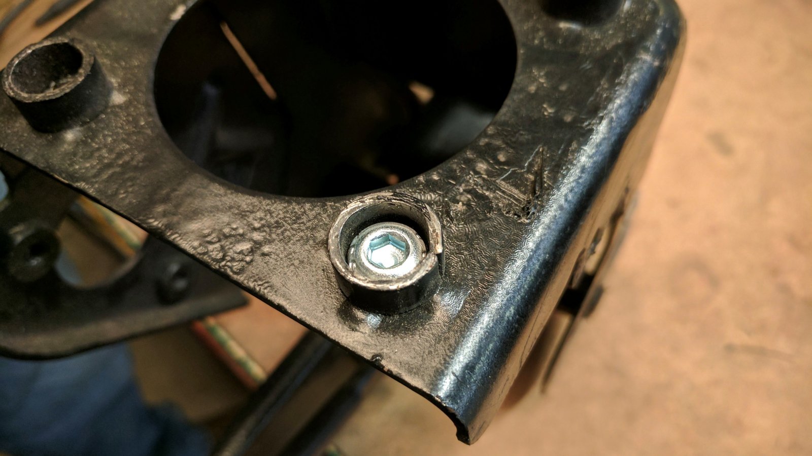

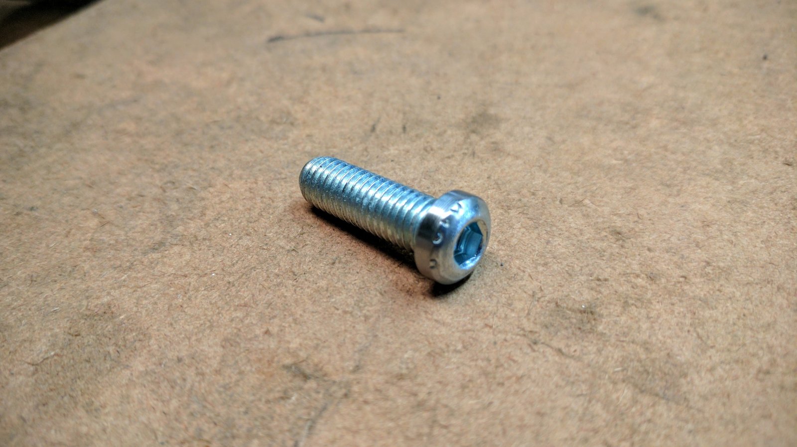

The brake booster will cover one of the holes used to mount the pedal box. This means that you have to install this bolt first before installing the booster. We used to supply a flat head screw and a machined washer but now we supply an M8 bolt with the head machined down to mount the pedal box. Here's the new bolt:
Installation of the pedal box is easier without the throttle pedal attached to the box.
Start by putting the pedal box in place and loosely installing a donor 8 mm bolt and nut in the pedal box support tube (at the top rear edge of the pedal box).
Next find another 8 mm bolt from your donor parts and push it through the pedal box and through the mount on the car. Don't worry about putting a nut on the back side, this bolt is temporary and only used to square up the pedal box as you tighten the next bolt. Instead of the washer and flat head bolt in the following image, use the M8 bolt with the machined head. The head of the bolt fits down in the tube on the pedal box so that it is out of the way of the booster.
Tighten a donor nut on the M8 bolt.

Main fuse box
It is a good idea to get your fuse box installed now so that as you fit the wiring harness to your car, you can be sure that the large plastic blocks reach the fuse box.
Tools and equipment
  • electric drill with 3/8 drill bit
Components
