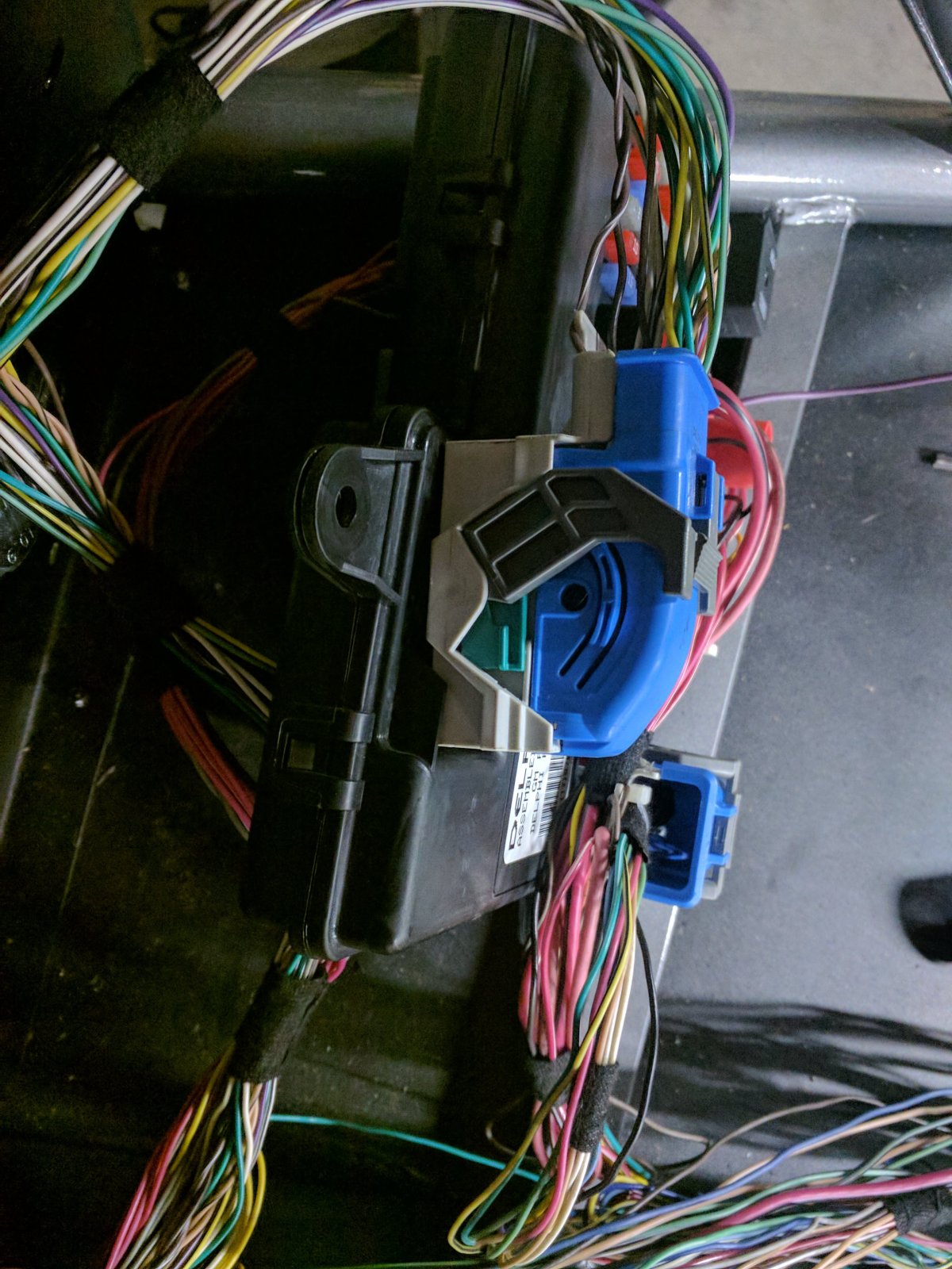

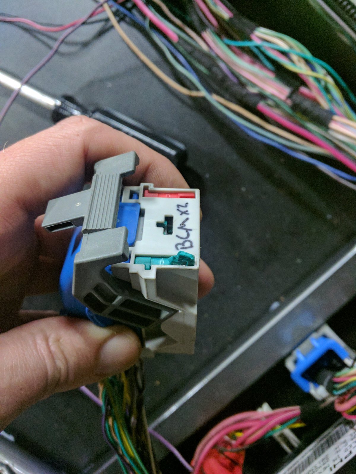

Problem solved! It was simple, but not obvious. BCM X2. The little green plastic slider piece inside it was bent somehow, and that prevented it from fully seating.
When connecting it, the lever slides and locks, and you can feel the plug get pulled into the BCM. From the top it looks fully seated (and there are wires over it because I haven't wrapped my harness yet). I pulled the BCM off to check all the fuses etc and when putting it back I didn't reattach it to the wall first. That's when I noticed the front half of the plug was not fully seated.
I messed with it a bit and took out the piece of plastic that was the issue. With X2 fully connected, the security light goes out, it tells me I have low fuel and low coolant and displays the air temp, all things it did not do before. It also cranks, and starts! Thanks everyone for the help! One more thing to add to the list of things to check if your engine won't crank.

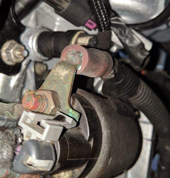

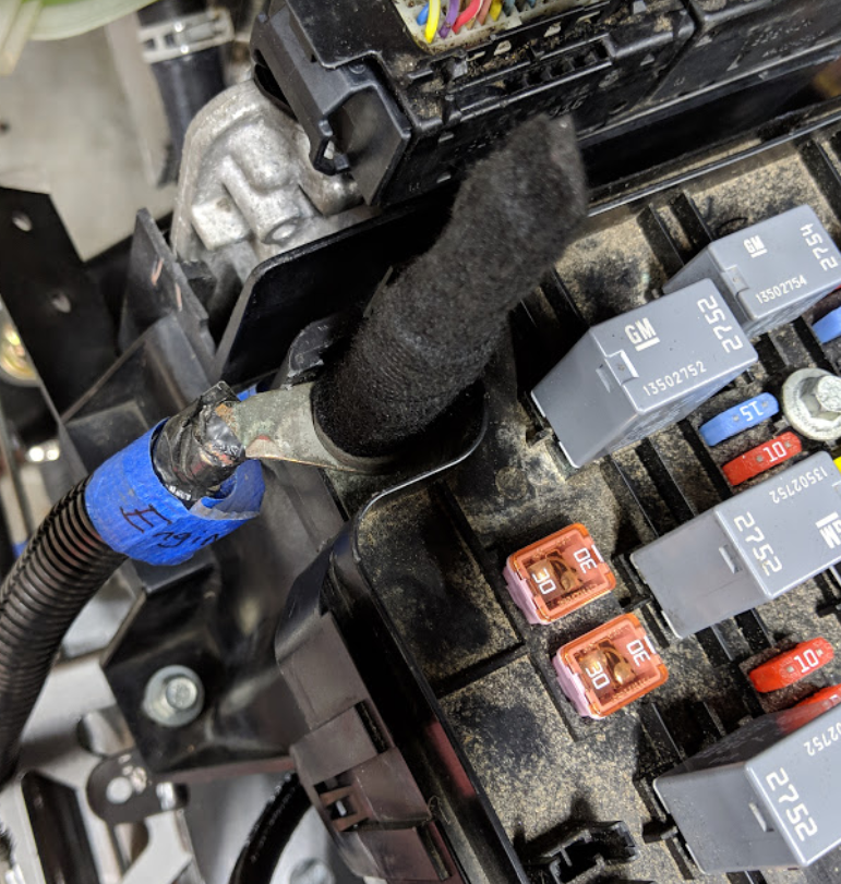

Can you send me a picture of where the positive battery cable attaches to the starter and from there where it goes to the positive post on the fuse box?
This is for an 09 SS/TC. Not sure if the others look the same.

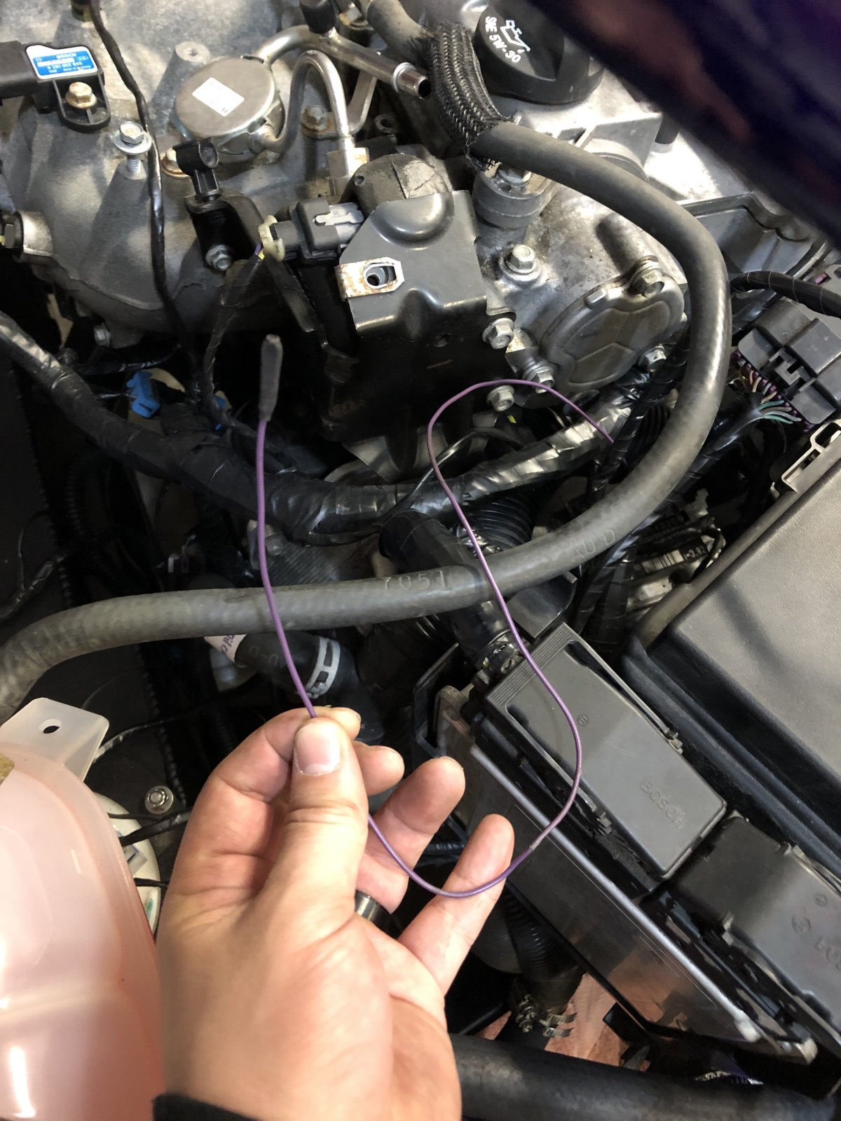

This purple wire?
That purple wire is originally from your donors fog lamp. It will turn on when you push the ACC button on your button panels. You can use it for turning on accessory lights or Street glow lights. There is also a purple wire up front and it also comes on with the ACC button.

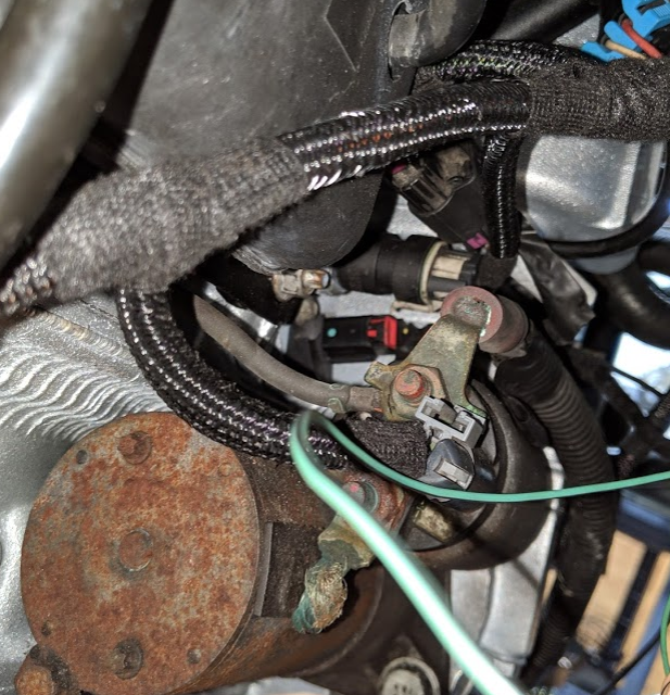

It turns out that if you have the fusible link between the starter and the alternator connected to the lower terminal of the starter, the throttle body, dash, and other things will indicate that everything is fine, but the thing won't crank. I finally figured that issue out tonight and now it runs.
