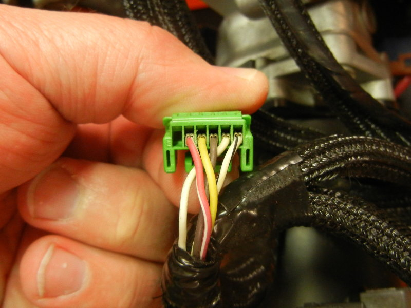

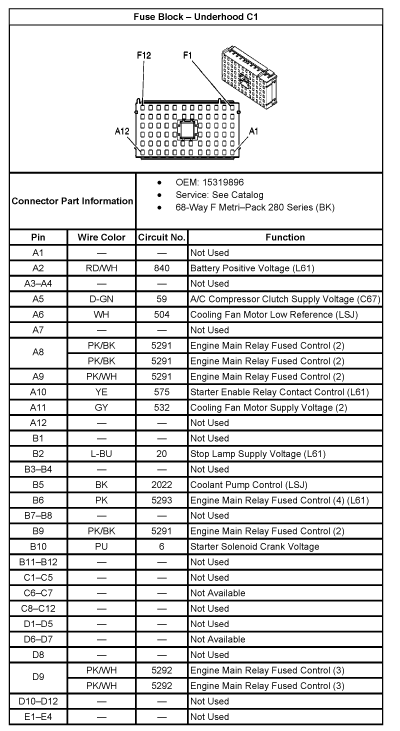

Made some progress this evening.

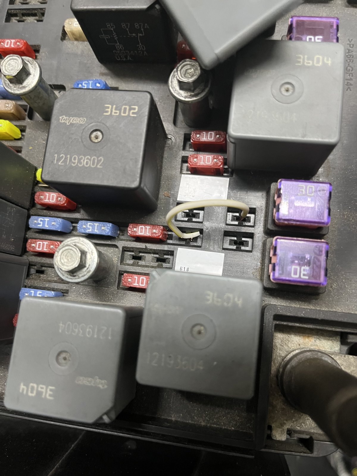

Ignition wire shown in picture has continuity with A9 on C1 PCM fuse block (Engine Main Relay Fused Control). I jumpered A9 to B10 Starter Solenoid Crank Voltage and the engine started. When I try to start the engine with the ignition clutch and brake pressed I hear the relay click on the Fuse Block but the engine will not turn over. I also re-flashed the PCM and this appeared to fix my gauges so I am leaning towards this may have been another issue.

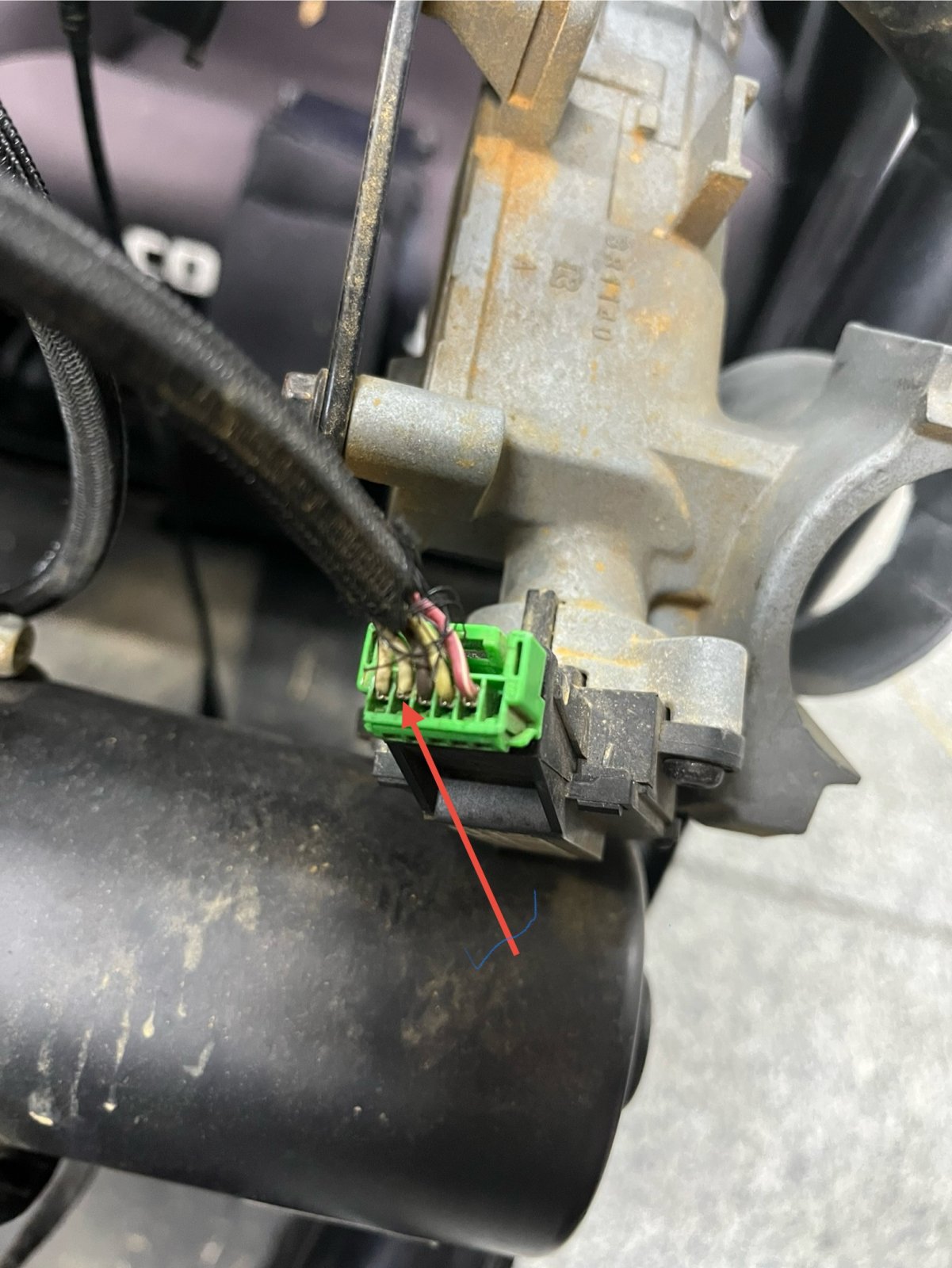

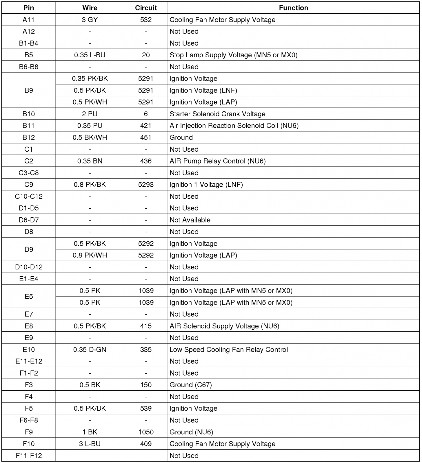

ncgoblin
Adding to this I am assuming Pin 5 is the one I need to be testing for sending crank voltage to the starter. This pinout goes to BCM C2 Pin 56 with 0.27 is the reading during continuity. From the BCM to PCM which connection should I be testing? I am thinking my initial test on A9 PCM C1 fuse block may be not a valid test.
Pin 1 Not Used
Pin 2 Battery Positive Voltage
Pin 3 Run/Crank Voltage
Pin 4 Accessory Voltage
Pin 5 Off/Run/Crank Voltage (WHT)
Pin 6 Key-in Ignition Switch
50293
You are showing me the ignition switch connector? No this won't be sending crank voltage to the starter.

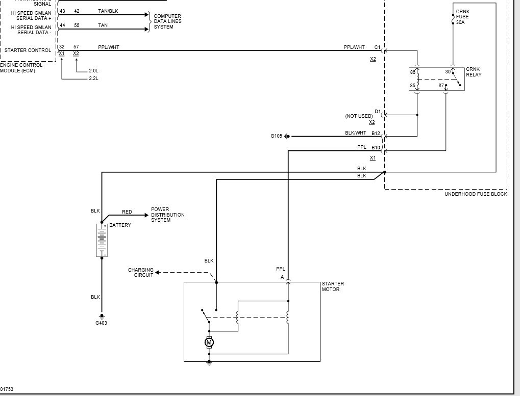

This page shows the circuit. Basically, the ECM decides on when to fire the crank relay coil, based on programmatic logic hidden in the ECM.
If the relay you hear clicking is the crank relay, then the purple wire going to the starter should go high (12V+).
The yellow wire from the ECM, C1, pin 48 will go low (12V-) when the ECM decides it wants the Crank Relay coil to click on.
If the 10A HVAC/IP IGN/PK3 fuse #10 in the BCM is providing 12V+ to the clutch switch pink wire, and that the clutch switch in closed, then the 12V+ goes on a different yellow wire (not shown below) to the Crank Relay coil. If the Crank Relay coil gets both 12V+ and 12V-, it should go click, sending power from the 30A Crank Fuse in the fuse block thru the Crank Relay to the starter. I would check the 2A BCM IGN switch fuse #8 too, just make sure it is good.

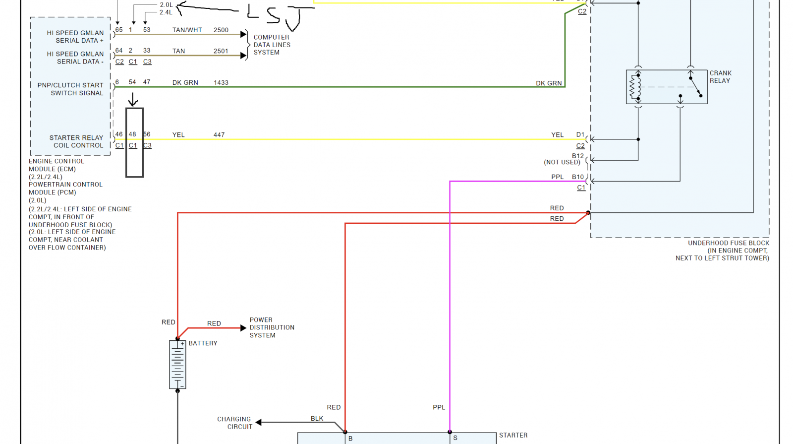

50296
Opening this up to the forum, as you guys usually have good ideas.
To test if ECM is sending a low signal, you need to see if C1 pin 48 has ground. Put your electrical meter on Voltage testing, red lead on 12V+, and the ground lead on C1 pin 48. The if the ECM sends low to start the engine, the meter will read 12V, otherwise the meter will "float" probably showing 0V, but may wander depending on how sensitive your meter is, and how the ECM handles it. Might be easier to test with a 12V light bulb rather than a meter.
I followed your instruction and the result prior to turning the key to crank is 00.03v on the meter and when turning to crank no change.
So the ECM's isn't requesting an engine start when you turn the key.
