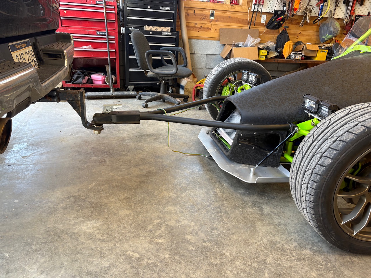

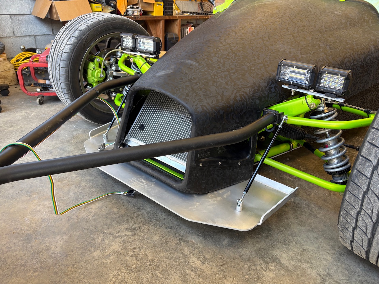

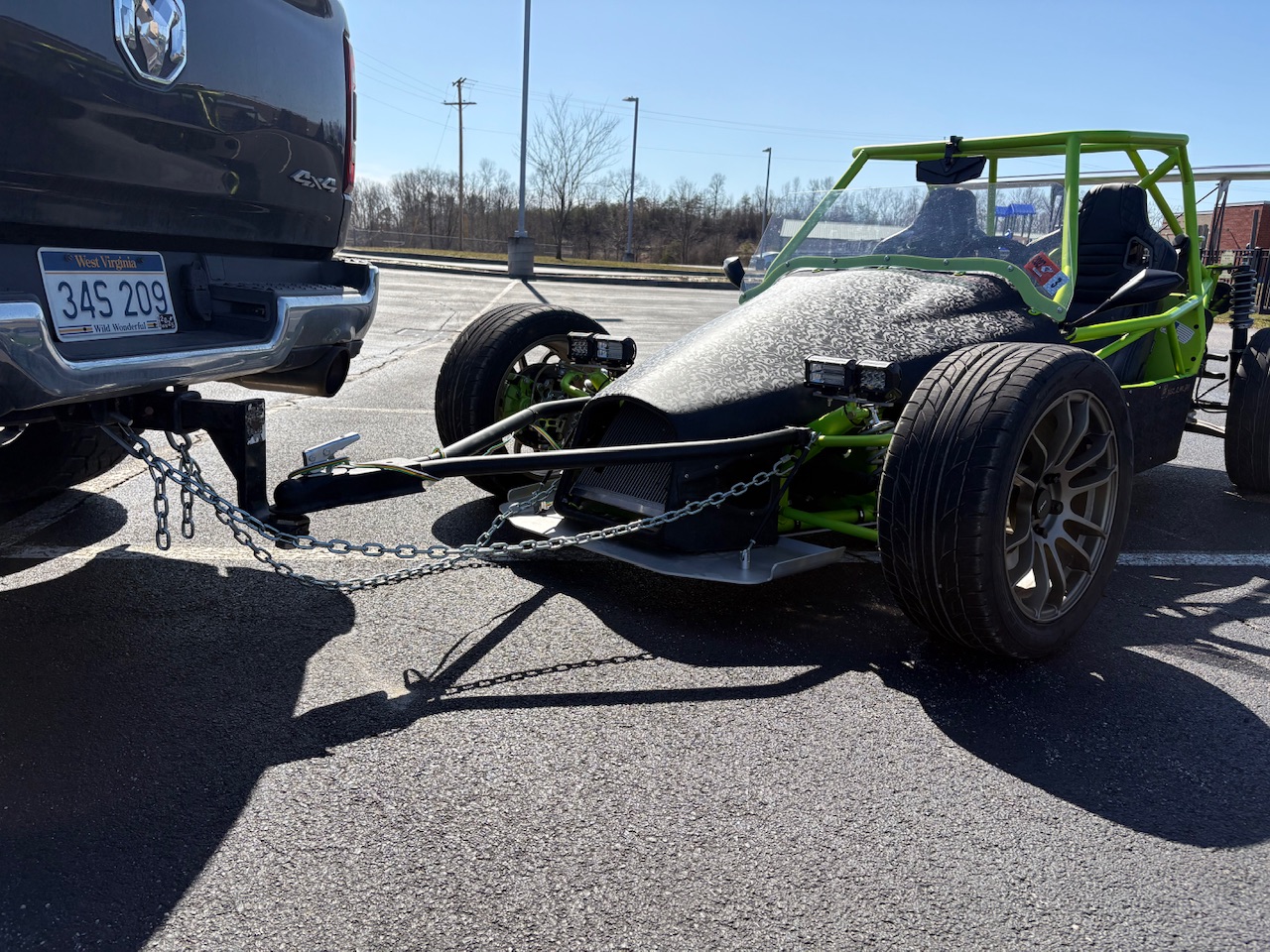

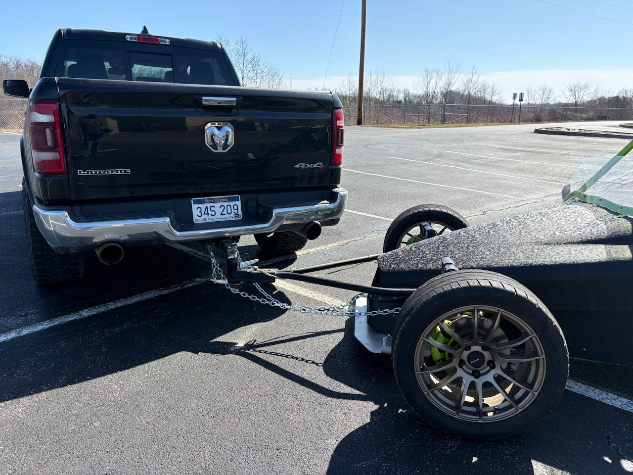

Finally got my splitter plate and NACA ducts on so I can hook up my tow setup and take some photos (attached).
Front tire pressure is 15psi.
Rear tire pressure is 18psi.
Front alignment -1.5 camber, 7.2 caster, 0.13 total toe
Rear alignment -1.5 camber, 0.2 total toe
I do think the height of the hitch is playing a factor because it does seem to follow steer better if the truck it coming up a hill and dropping the hitch, but I already have a huge drop. Not sure I want to go more. Maybe with the splitter in front it will apply enough force at speed that it will do good a higher speeds. It just depends at slow speeds if it turns much or scoots.

That looks pretty good. Don't worry if the front tires are a little slow to turn... as long as they point straight down the road when the road is straight. When the tires are scooting, there isn't even enough weight on them to caster the tires to the correct direction, so they are barely scrubbing the tires.
