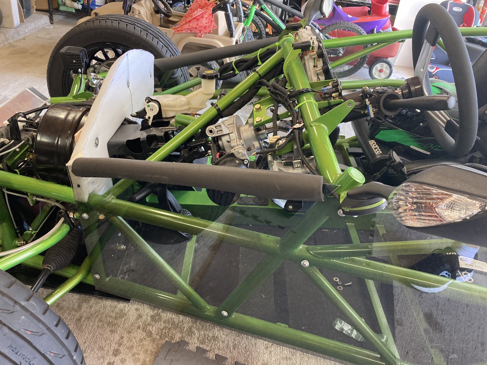

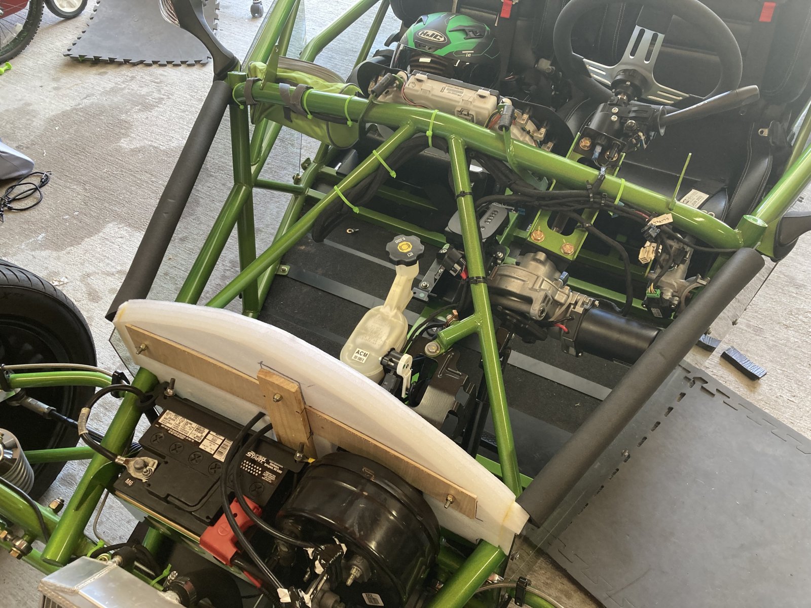

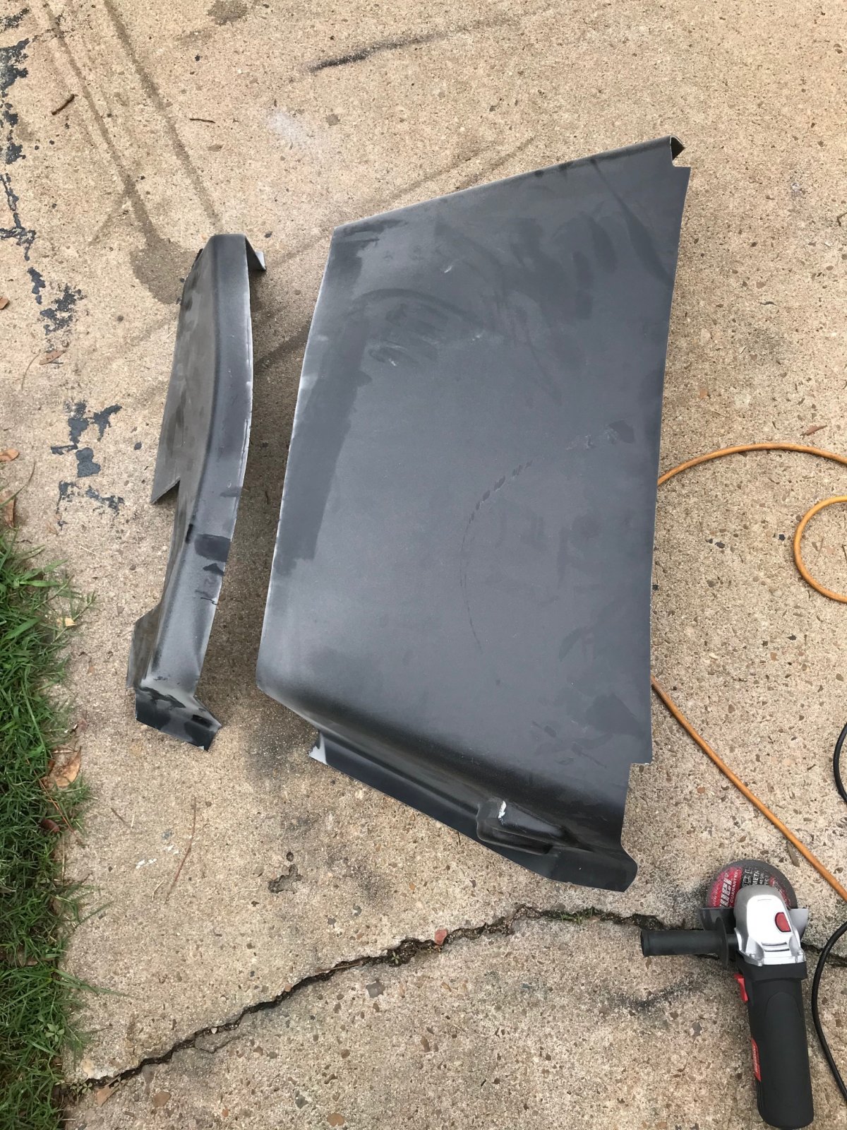

I had a little different idea for the footwell. There is quite a bit of overlap between it and the hood when both are installed. The key part of the footwell is the front vertical wall to keep the radiator heat from entering the passenger space. So, I simplified it some. I avoided drilling screws into the frame tubes. I used adel clamps to make it easily removable if needed. I used Tim's idea of the foam pipe insulation to seal between the footwell and the hood.
A little simpler way to do it. :)
View attachment 13278View attachment 13279View attachment 13280

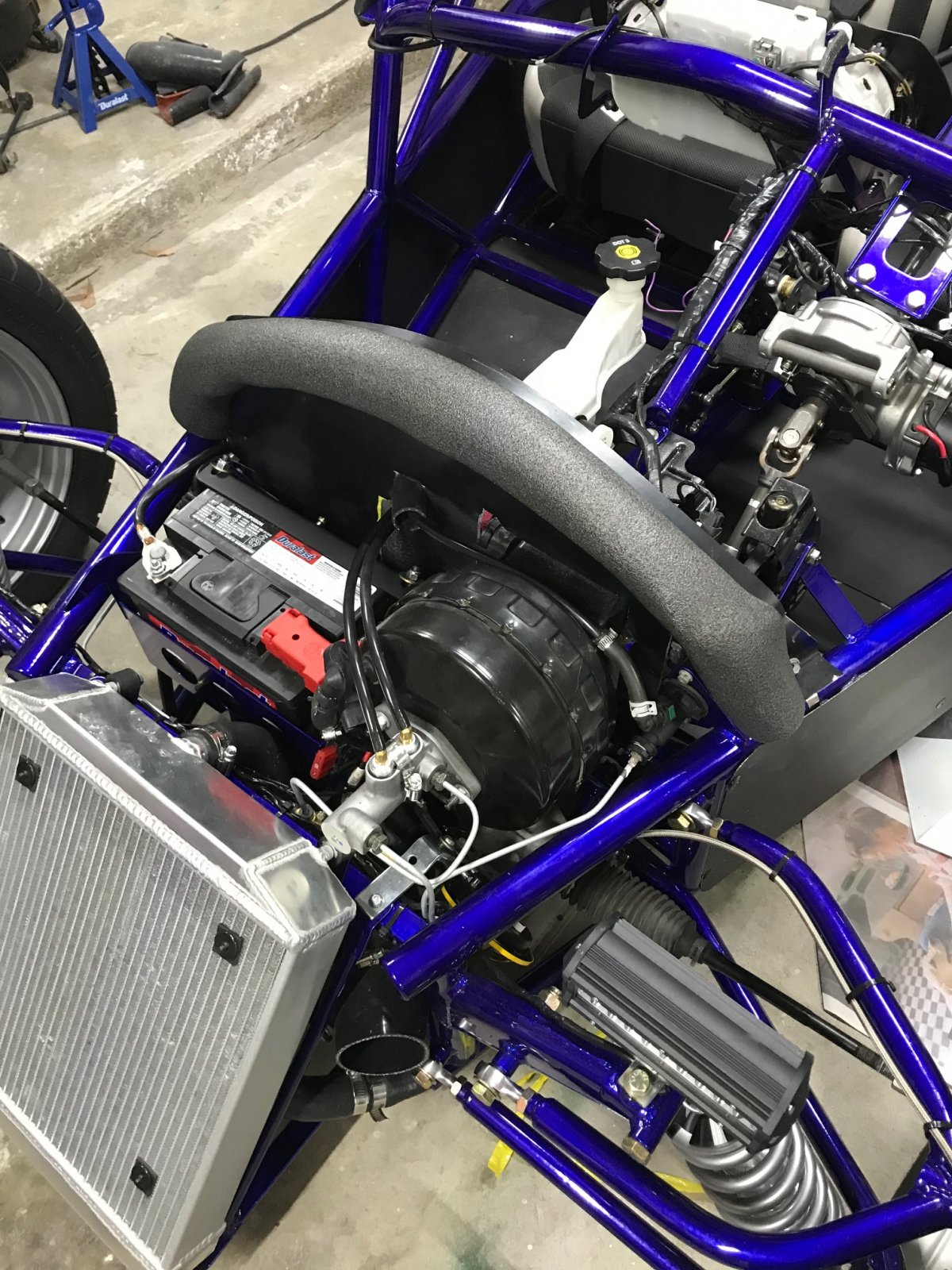

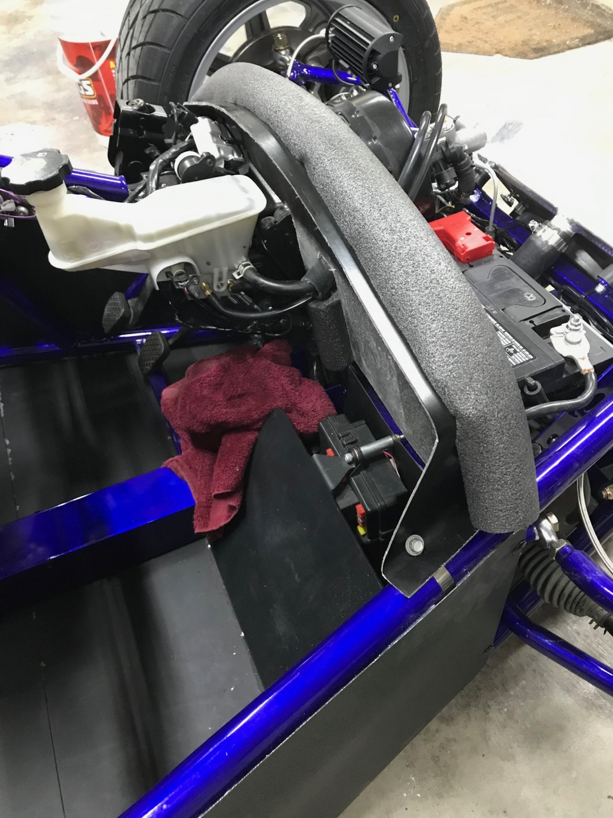

I’m just doing the foam trick

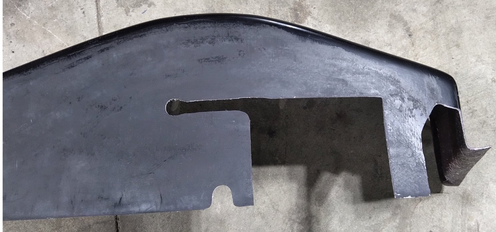

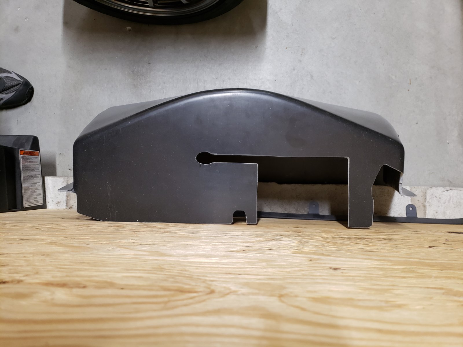

If you do the foam firewall to the hood and you don't have any sides, the heat just goes around the firewall, and blow dries your outside knees. Like the footwell cover, you also need side coverage to isolate from the radiator heat.
In the end it is black but the white shows the detail.
