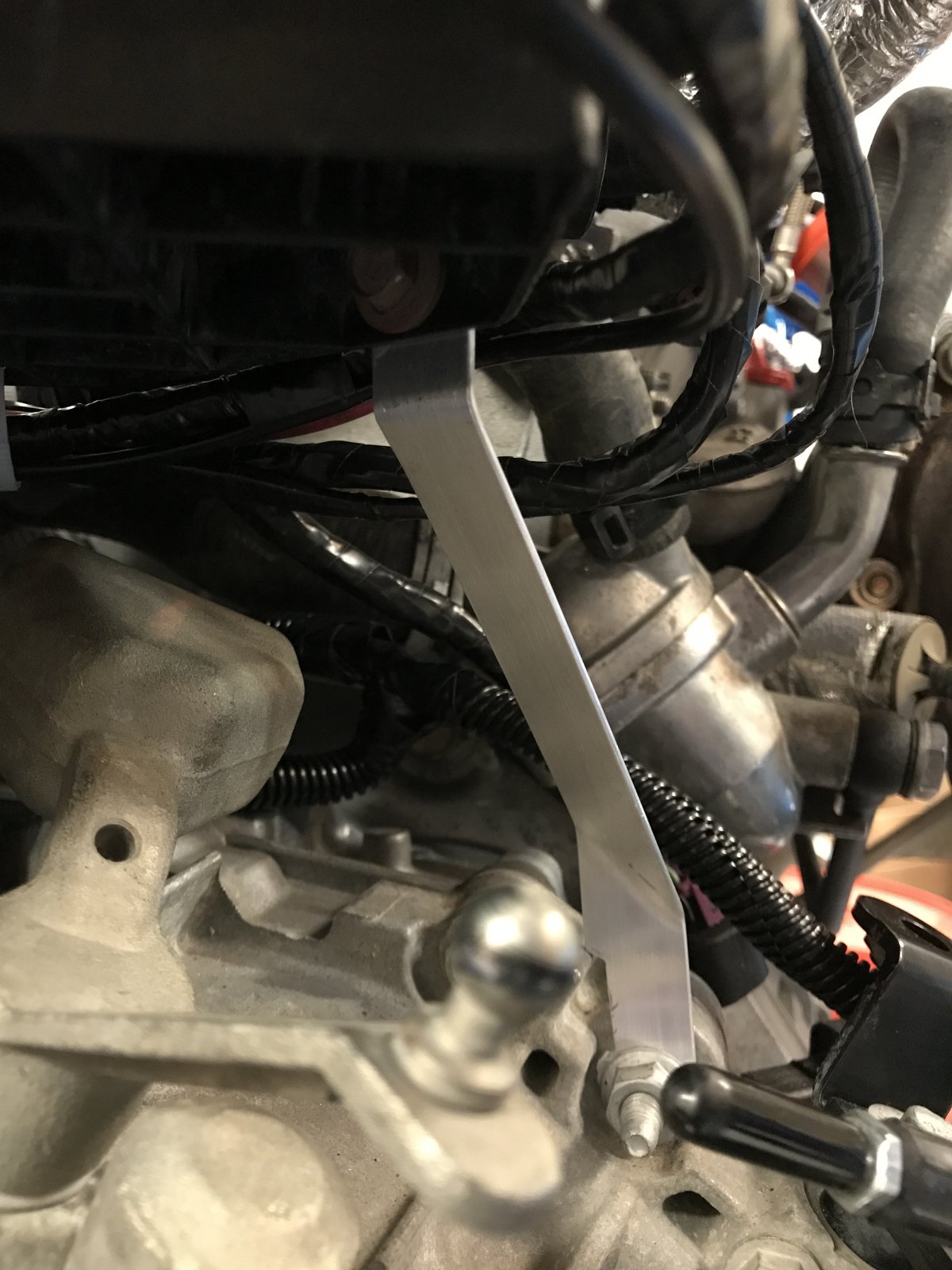

I used a piece of 1/8" steel flat stock. About 2" wide. 4"-5" long. Drilled a hole in the upper motor mount plate to attach the plate.
I saw a few that added a spacer to raise it about an inch which I think I will do also to get some more room underneath the fuse box.

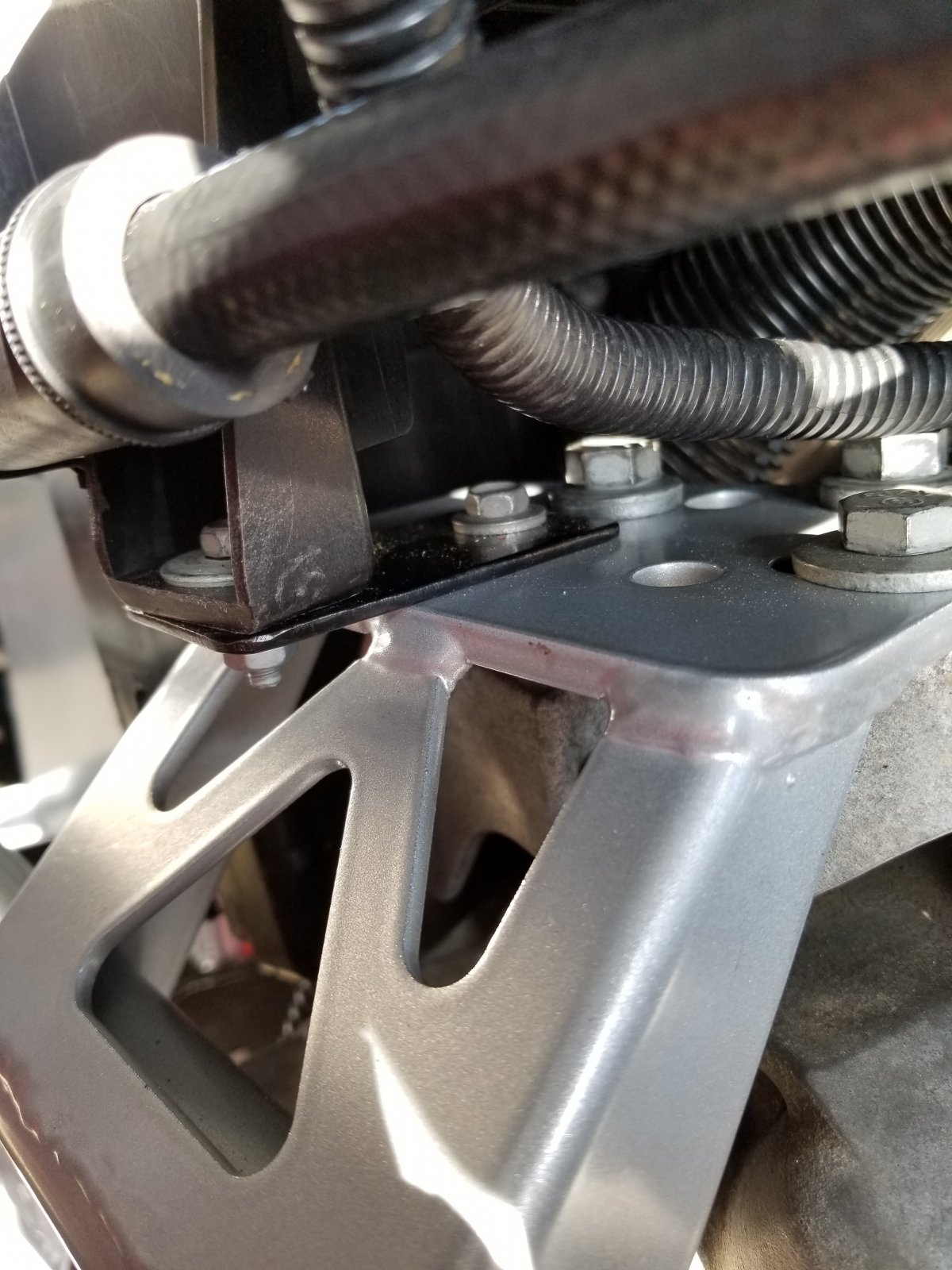

dperkins
I did a spacer made out of aluminum like waterdriver. I didn't like the stiffness of the supplied way to mount so I made a custom mount out of more aluminum.
I think everyone should do this. It makes the box so much stiffer and more secure.
