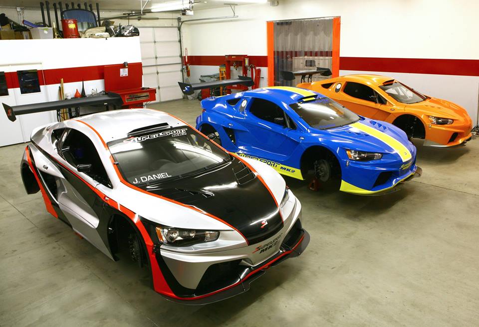

so while I eagerly await the completion of my Goblin frame, I have been contemplating additional directions the Goblin could go in the future. My favorite idea is a single seat, pushrod suspension car incorporating a longitudinal drivetrain with a rear mounted radiator and inter cooler that uses aerodynamic body elements to move air through the radiator and ic on either side of the car, perhaps with an intake funnel over the drivers head like a formula car. The car could use existing front suspension on all four corners, wider body in the rear to achieve a wider stance using the same wishbones .the gauge, pedal box and steering wheel mounts and anything else that would fit from the two seat Goblin could be used to keep costs down.
Thoughts? Do front wheel drive longitudinal transmissions exist for ecotecs or would another driveline be superior?
