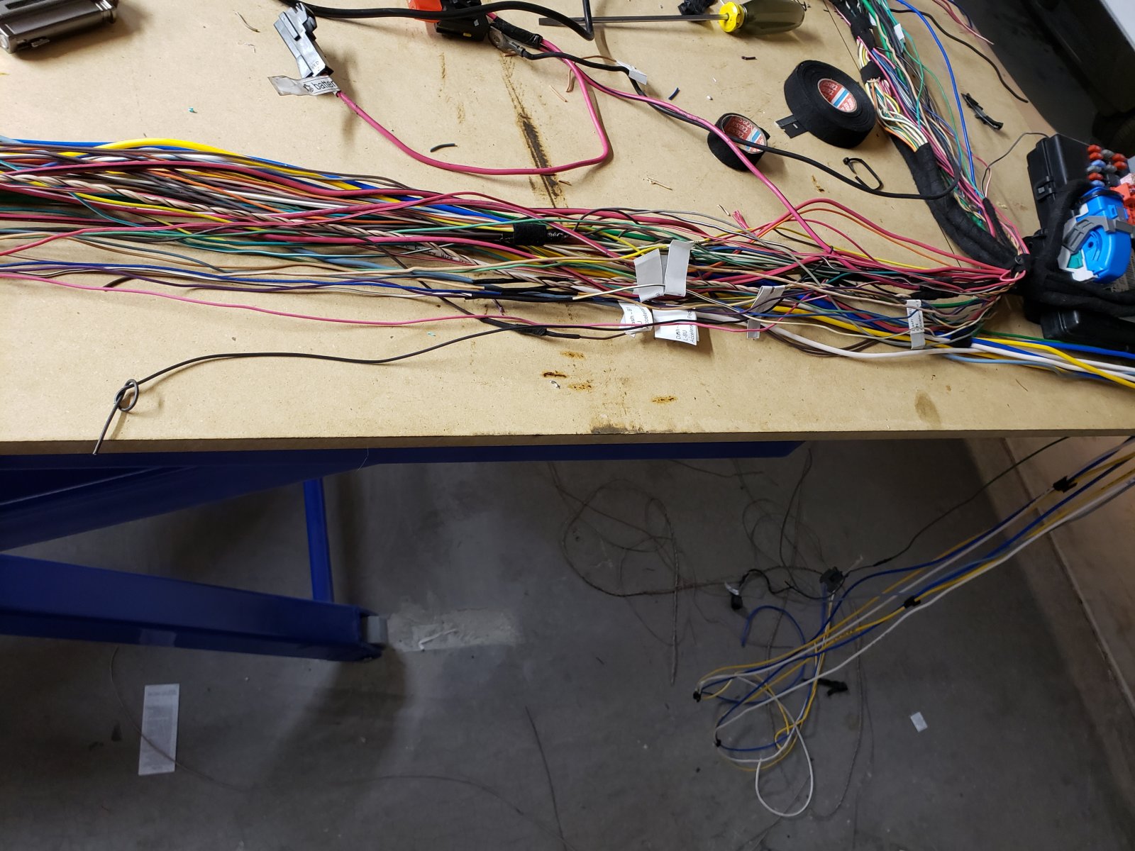

I'm finishing up the wiring harness and have a ground wire coming of the BCM that is cut and knotted. Did this have a special purpose? I can't remember at this point.
Also I noticed that there does not seem to be a ground connecting the ECM and BCM. Is there supposed to be?
If that wire is not coming from a copper ground lug then I would make sure it gets grounded.
Joebob
About 2 minutes into Video 11, Lonny checks the grounds to all the components. Check those as well as any custom features to make sure you are not missing anything.
