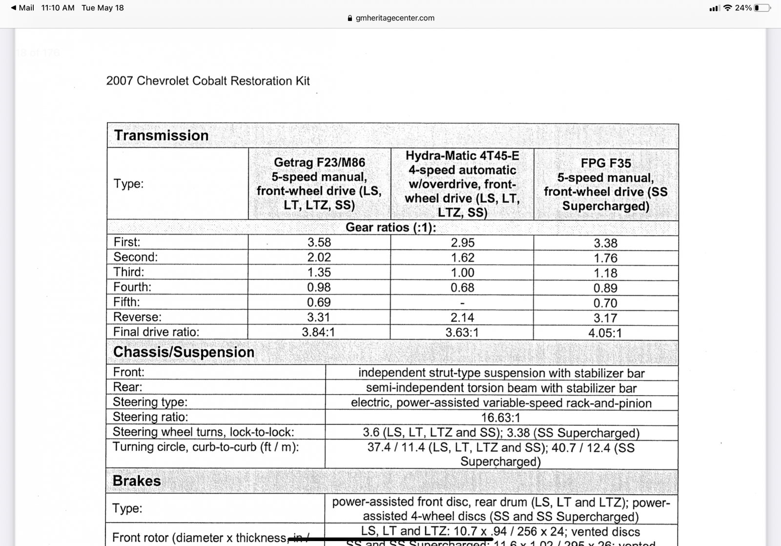

Well, first is performance. Going from the F35 with Final Drive of 3.82 to the HHR FD which is 4.17 has considerable drivability & torque improvements. The Getrag F23 is known to be able to handle more power than the F35 due to how the shift forks are implemented. F35's are known to break their forks at high torque, low rpm situations. The F23's parts are also more abundant, in the event it does break there are parts available for cheap. That brings me to my second reason, the transmissions are effectively everywhere as they were in a ton of mass produced vehicles. The F35 has become extraordinarily expensive over the past couple of years, going for as much as $1,200 used before shipping to >$3K new. The idea here is that I could take my F35 w/ LSD and swap to the F23 w/ LSD and sell my existing transmission for about the same cost (if not more).

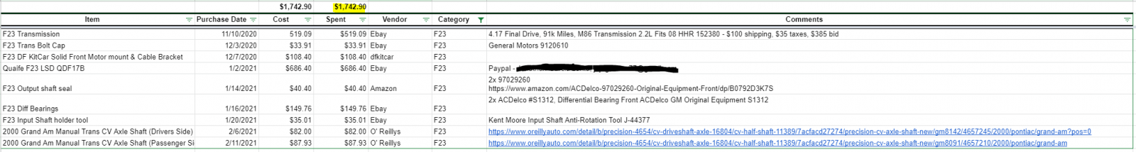

Here's the process:

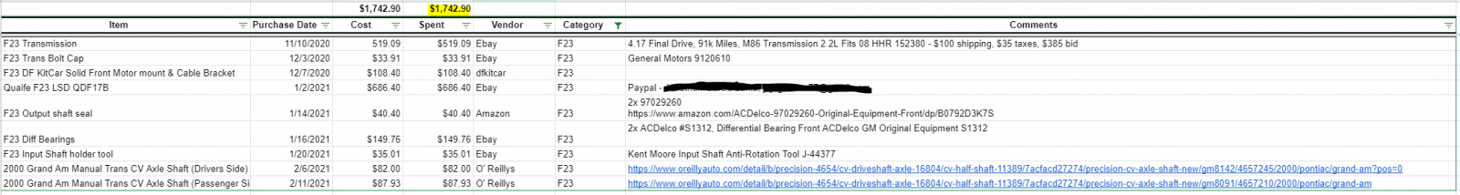

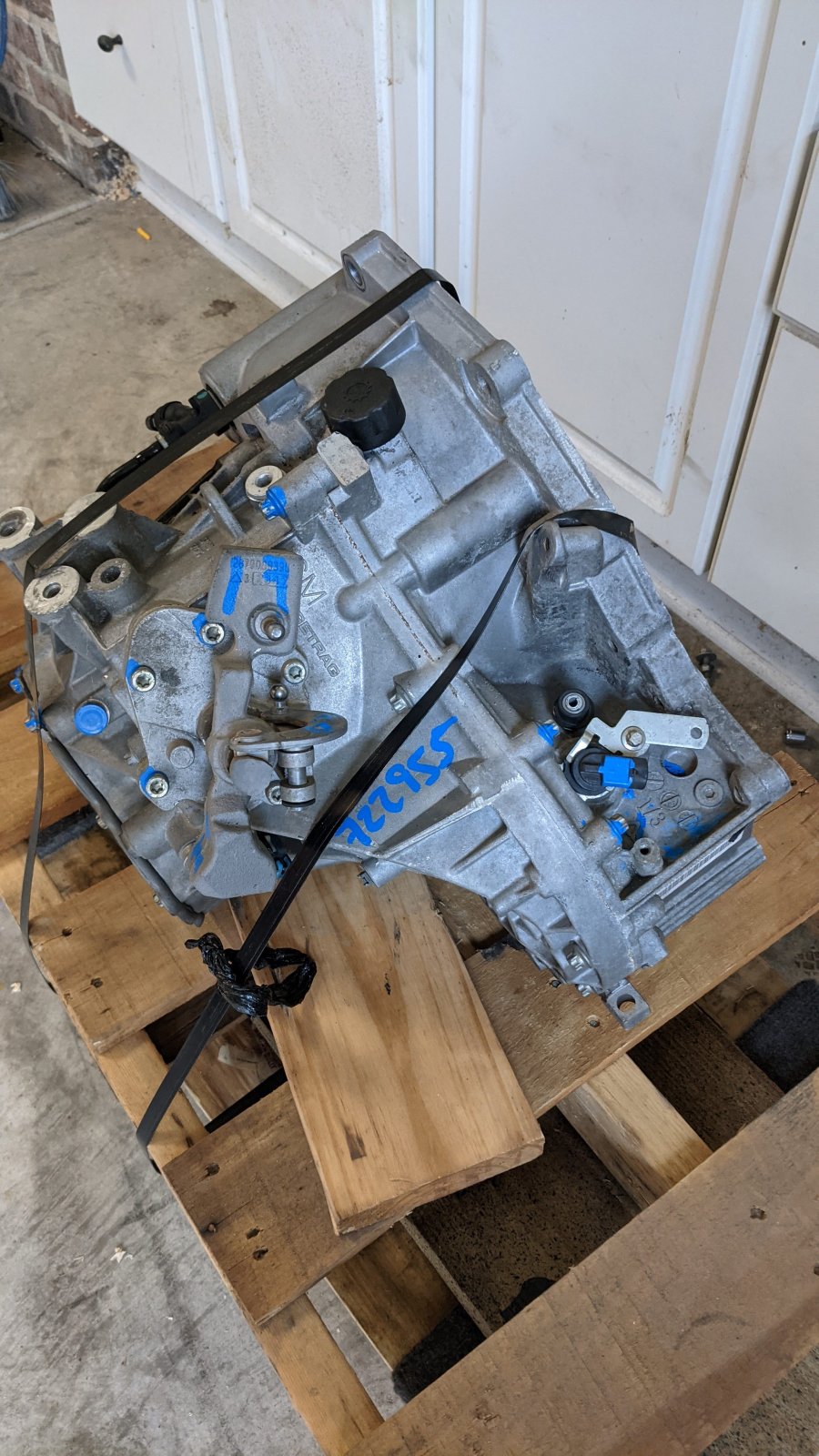

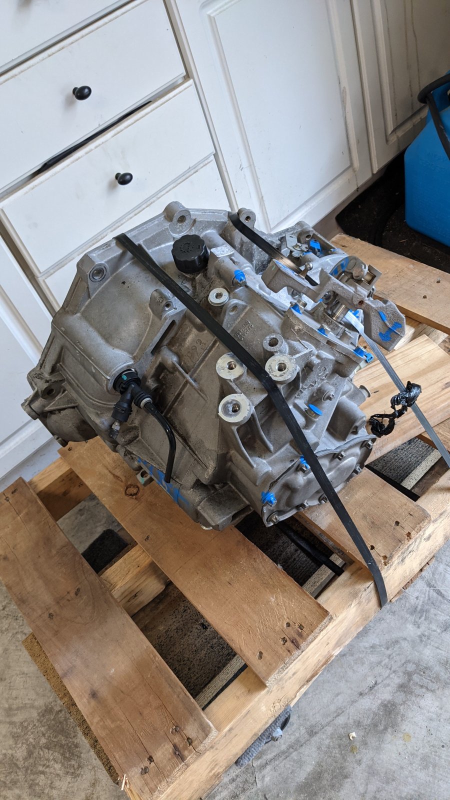

I used this link to understand the right years and models, off to ebay I went. You'll notice the year on the HHR makes a difference. If you want the 4.17 you want to look for a manual HHR between the years 2005 - 2008. I found a 2008 with 90k miles and thought that was a STEAL.
Delivered

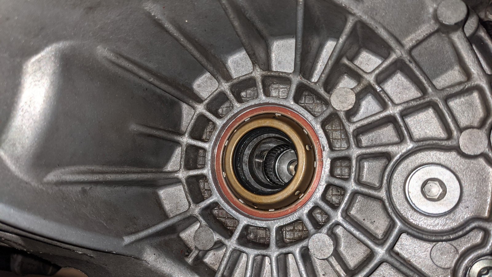

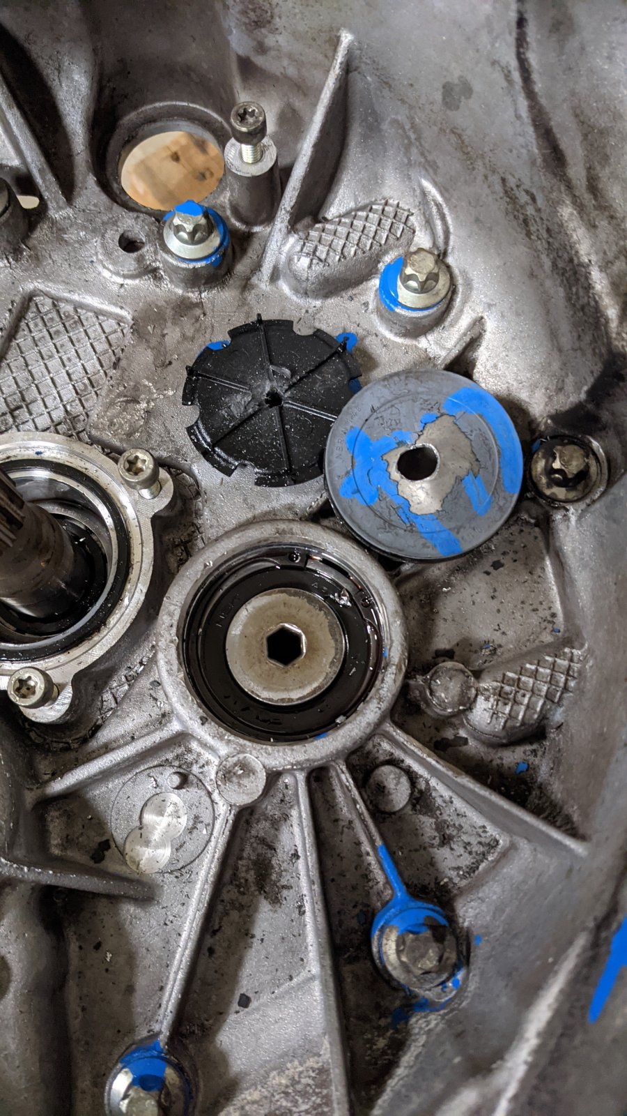

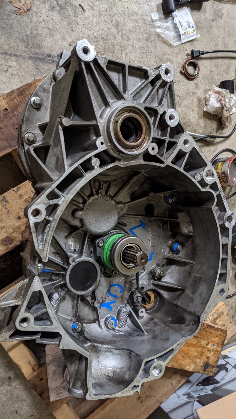

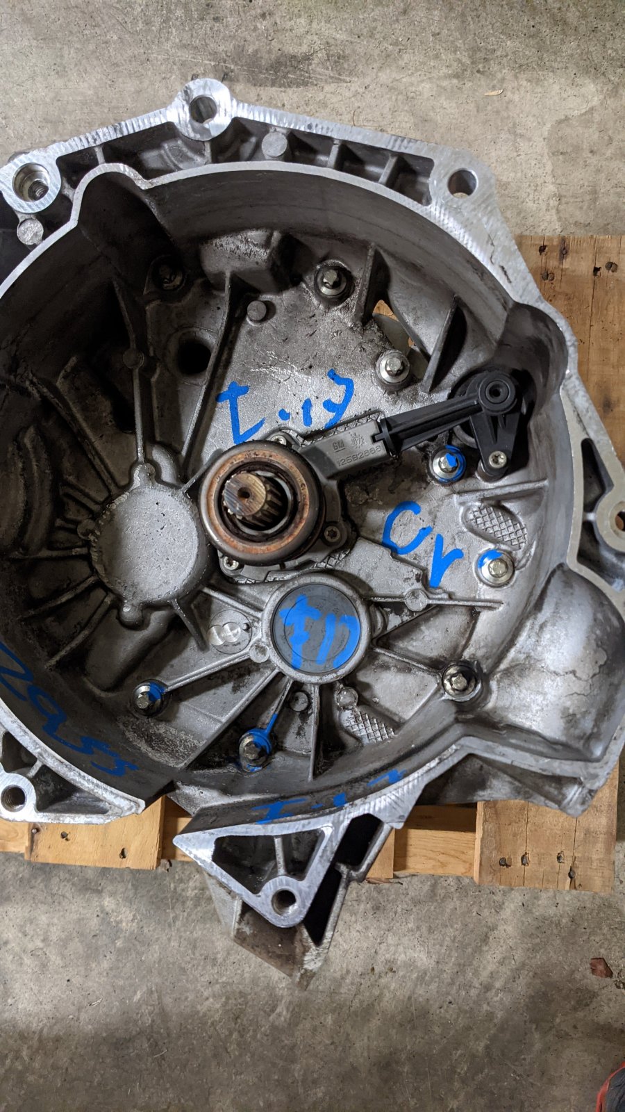

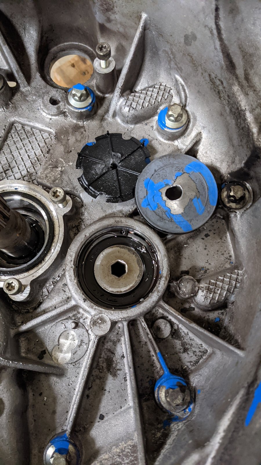

Take your throw out bearing off. Your first mission is to get the cap out, I drilled through mine and then used a little leverage to get the cap and black piece out.
21401
Notice the snap ring, you'll want to save this. The black plastic part is directly under the cap and easy enough to pull out. You'll want to buy a new cap ( 9120610 OR Ford 1311152 )

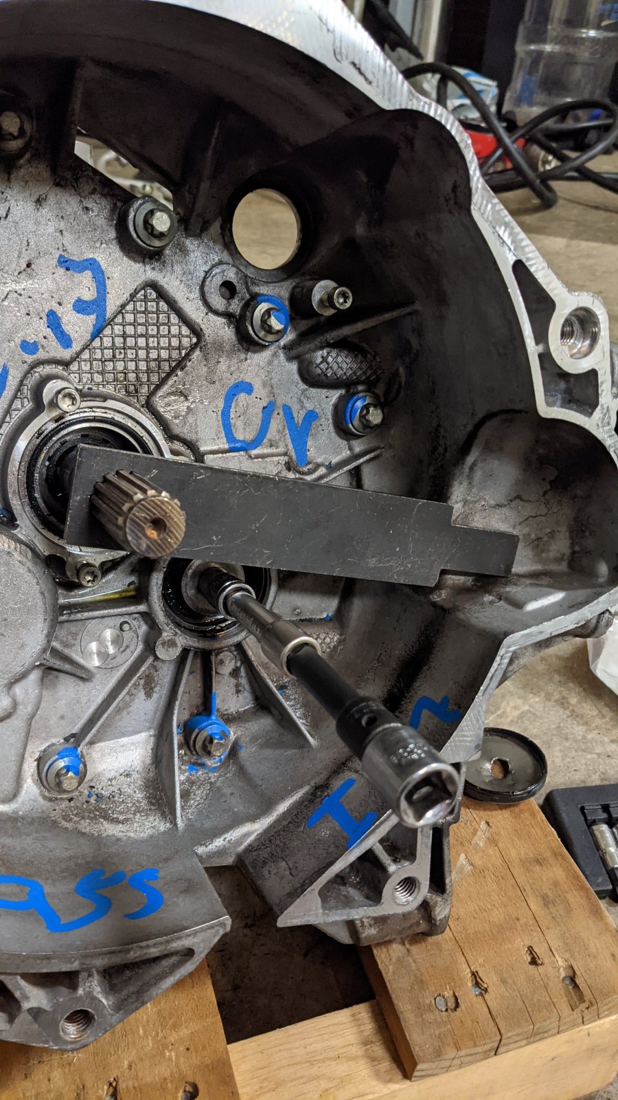

Getting that bolt out can be a straight up pain in the ass. In the youtube vid you'll see the dudes using vice grips, I'm not lucky enough to use vice grips and not strip the threads. I hated buying the tool to use just once, but made removing and tightening the bolt a breeze and I can sleep well at night.
Kent Moore Input Shaft Anti-Rotation Tool J-44377

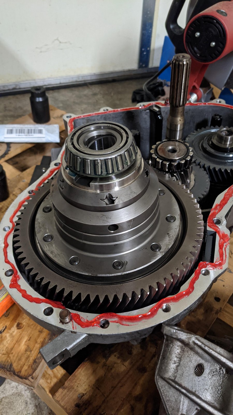

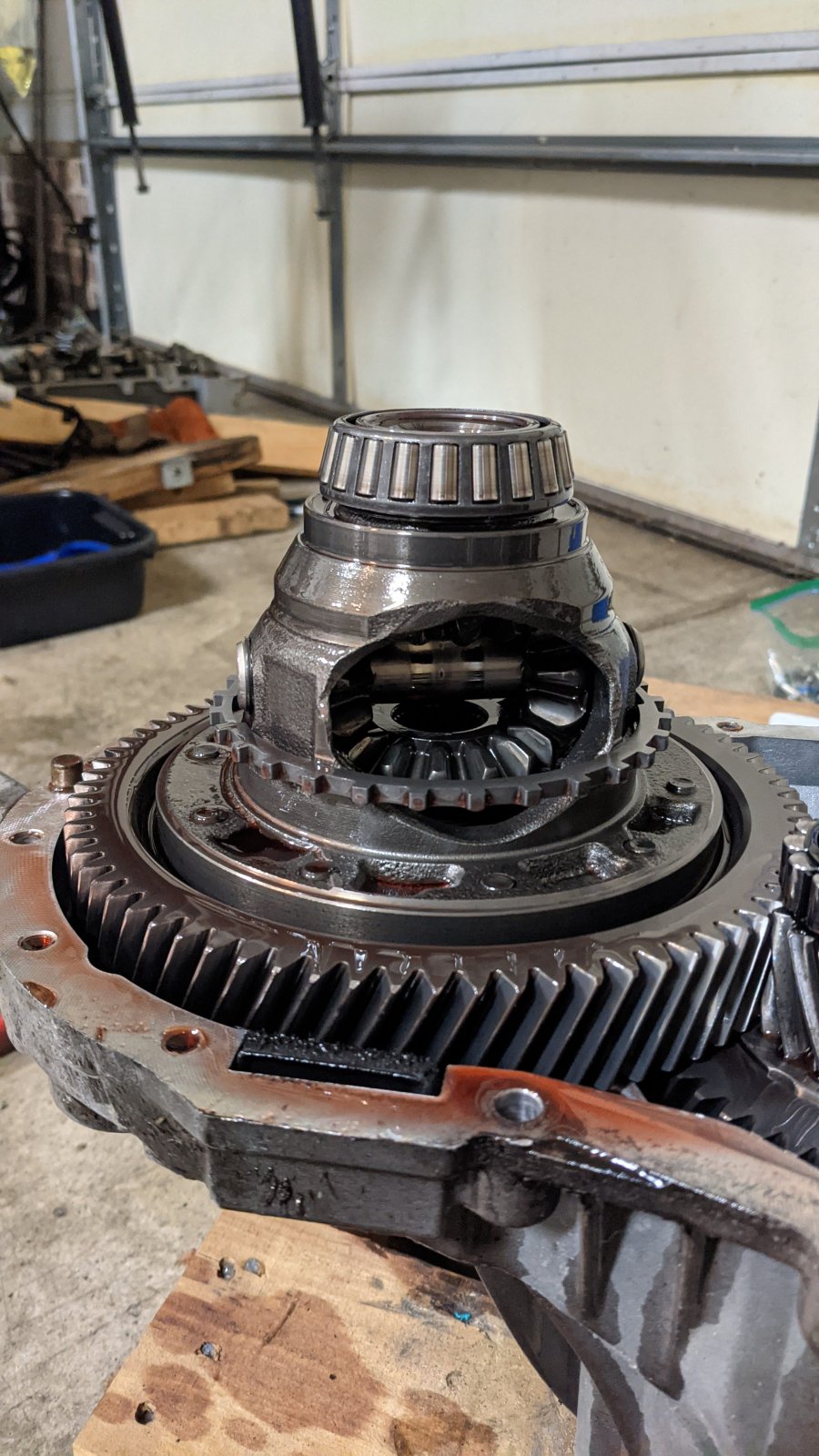

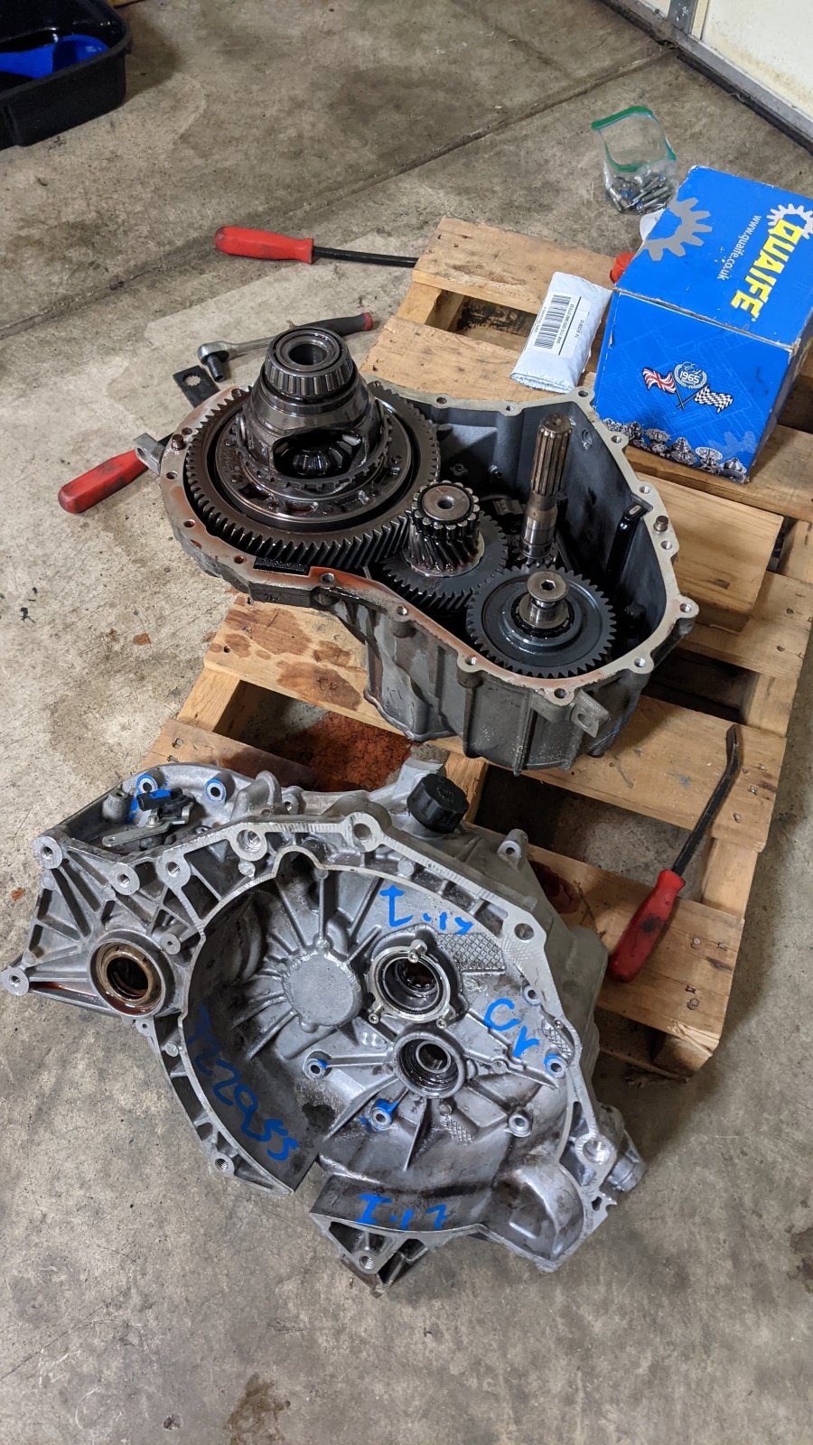

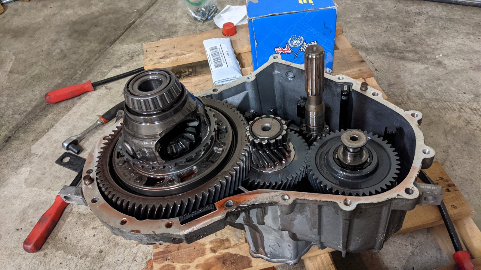

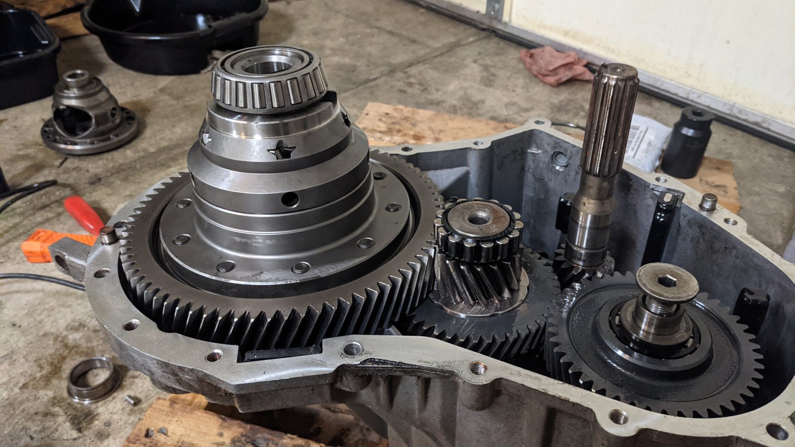

This is what she looks like with the top half off
21405
21404

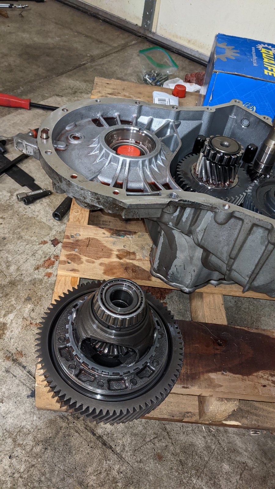

This is where the real fun starts. You can either purchase a bunch of different sized shims and do a bunch of trial and error for the right preload, of you use the shims on your F23 trans which should be close enough. I chose my F23 shims and straight up battled getting the diff bearings off to get to them, you need both sides.
21407
21408

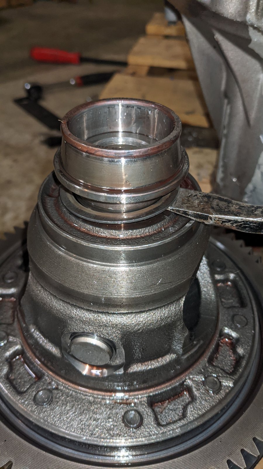

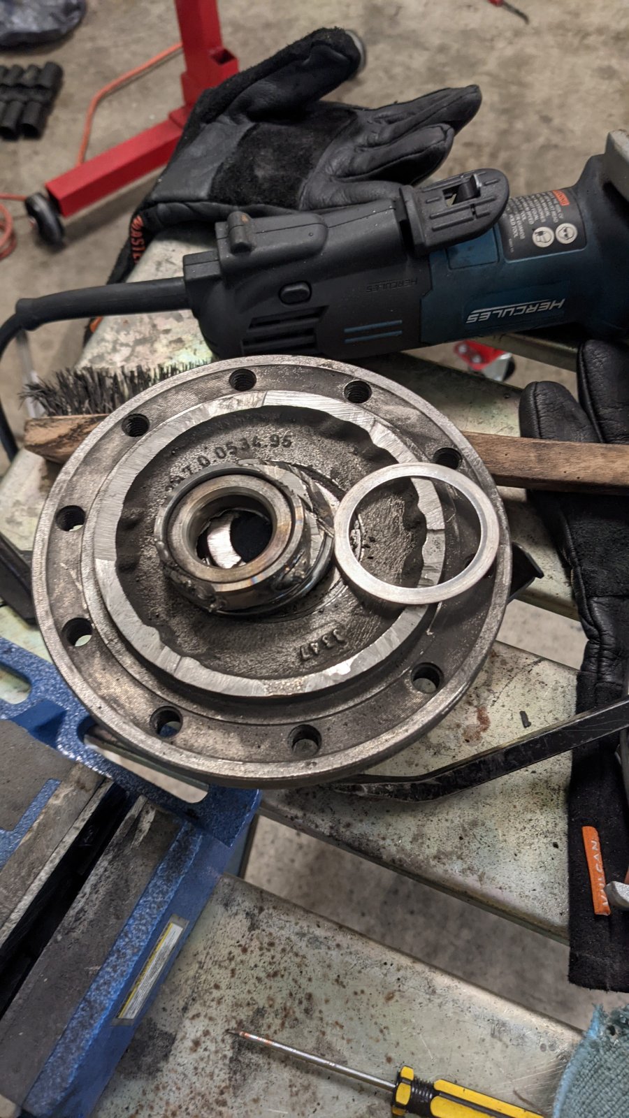

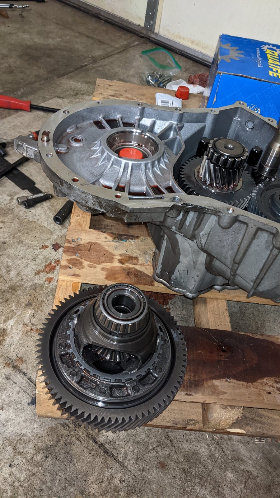

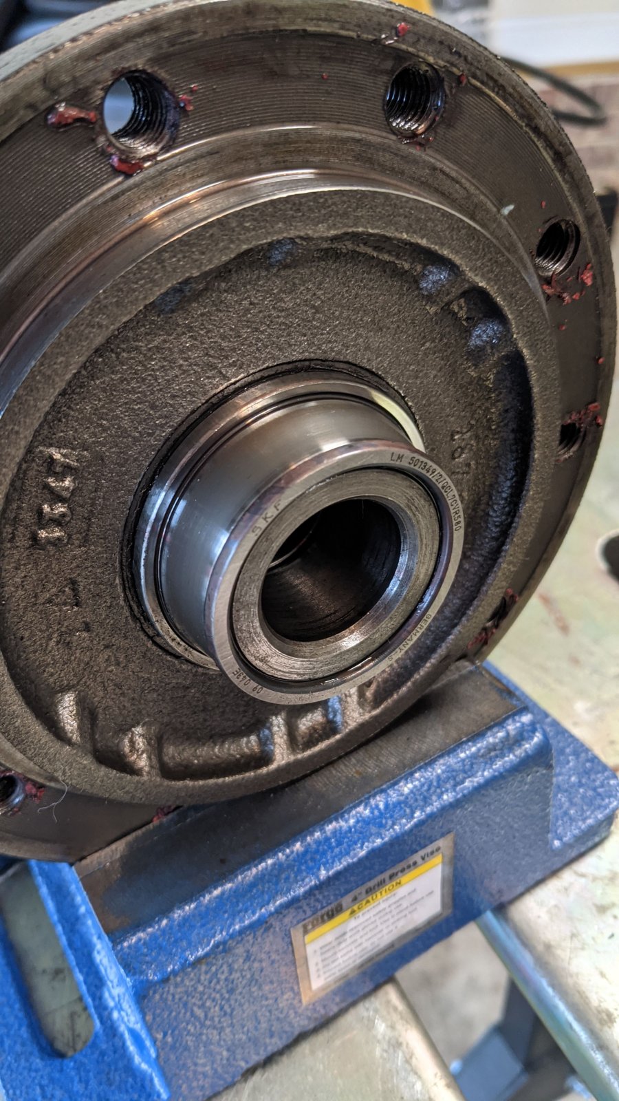

You typically ruin the stock F23 bearings in the process, which is why I had to purchase new bearings. This is the shim you're looking for
21409

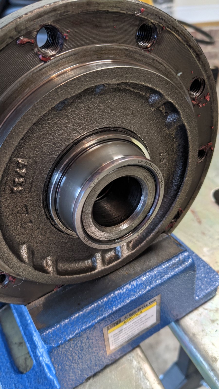

Backside was a total b*tch as there is nothing to get leverage with to remove the bearing.
21410
As you can see, I did not have a good time but managed to get it out unscathed.

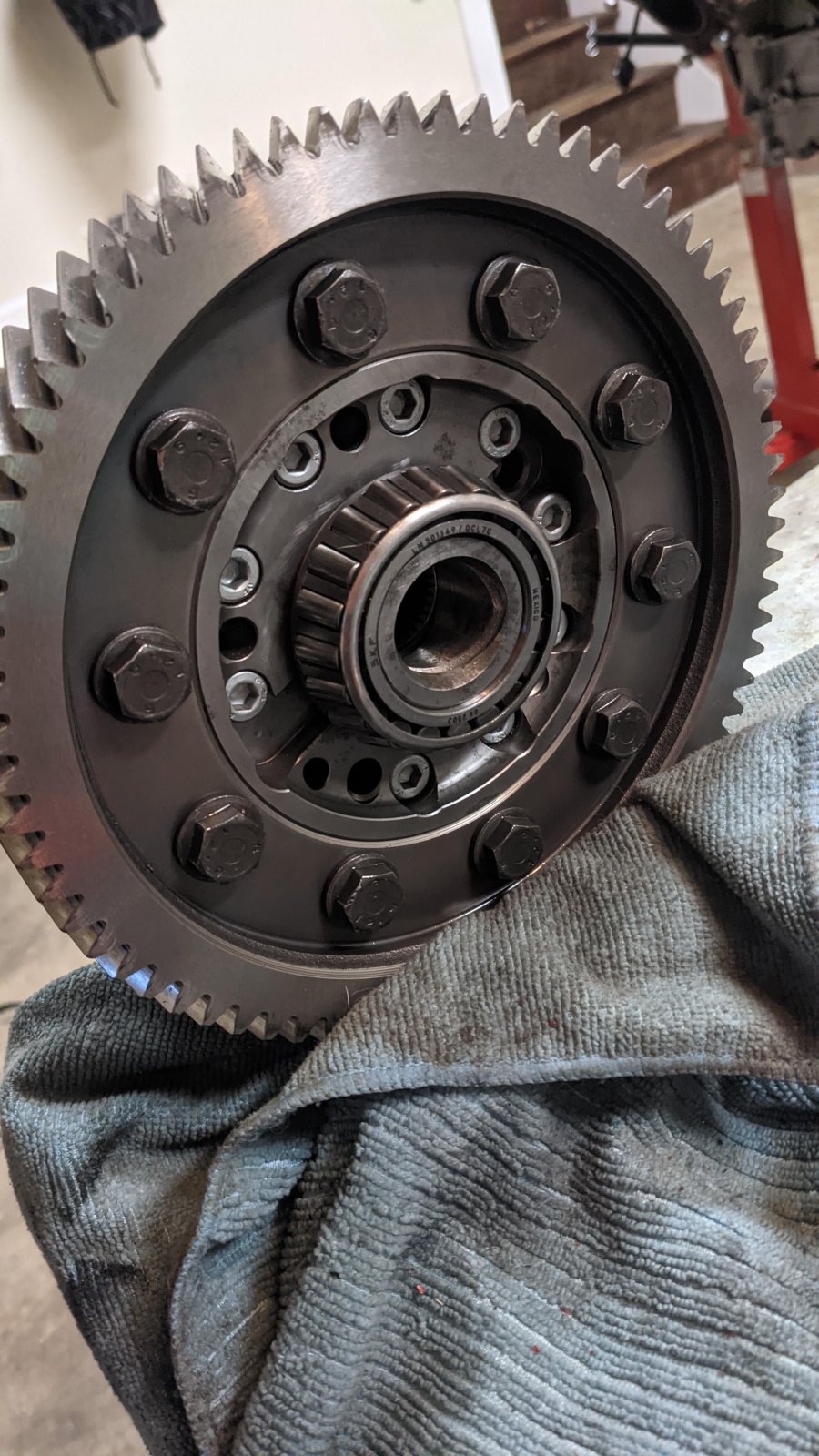

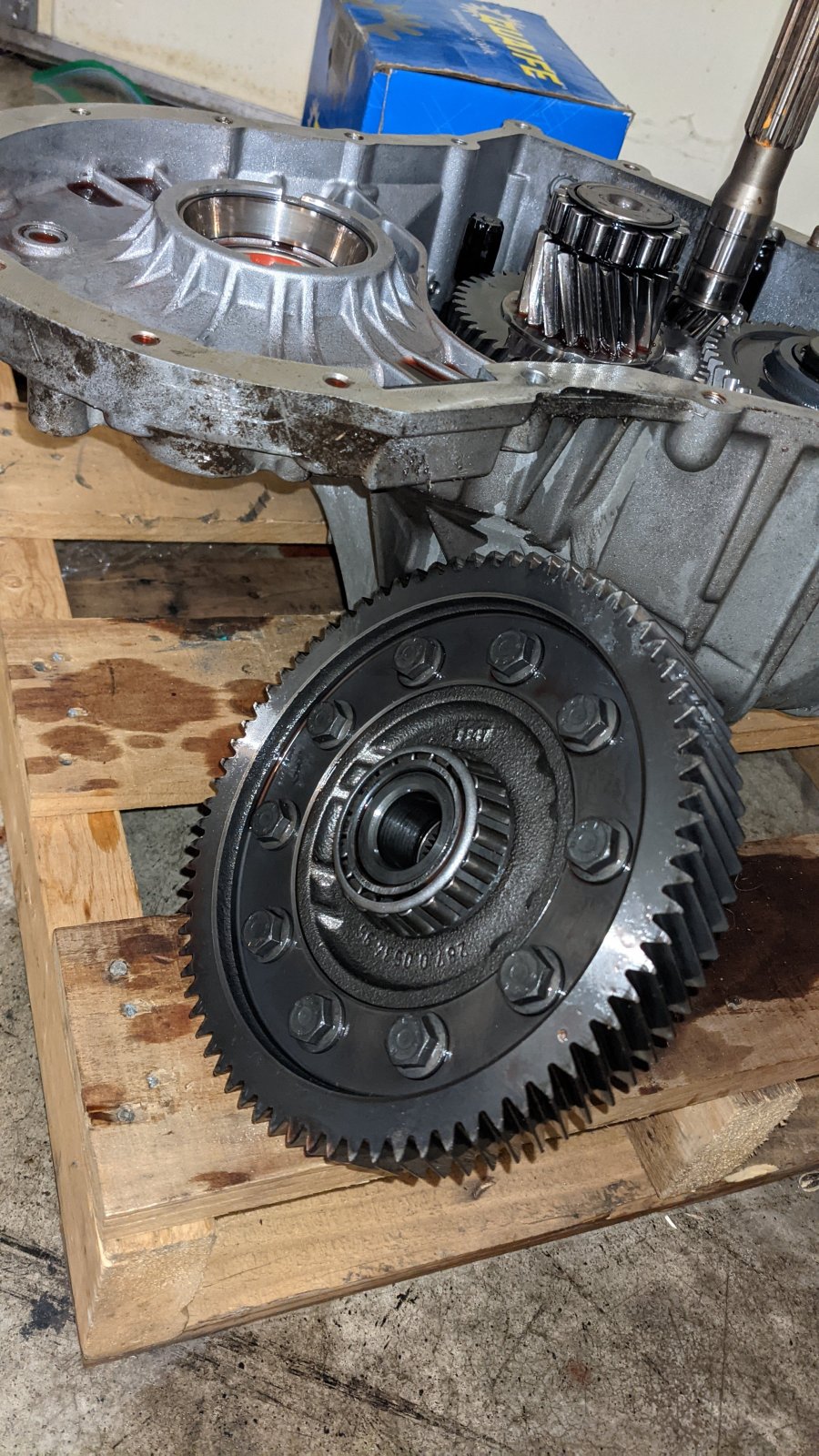

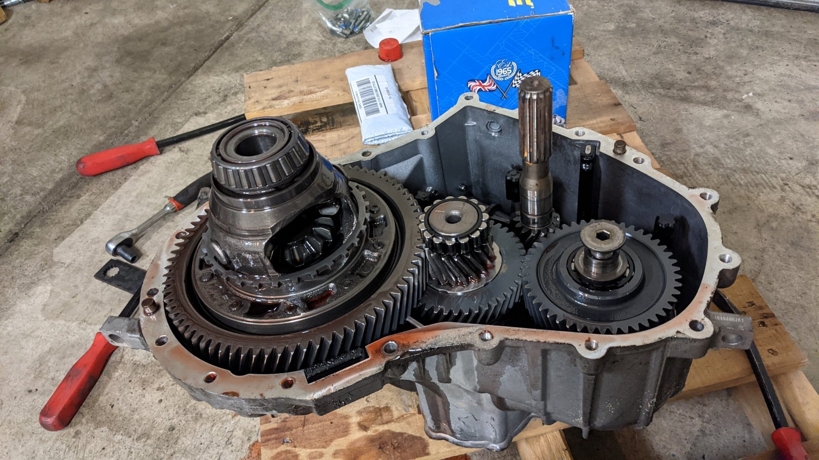

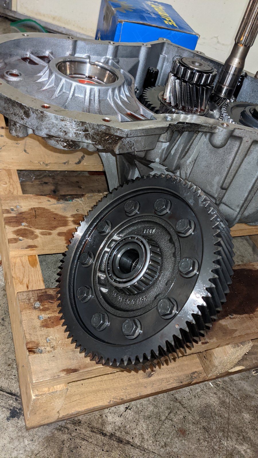

Take out your Quaife > insert your shims > press on the bearings > install your ring gear w/ loctite and torque to spec
21412
Take out some assembly lube and put it liberally on your bearings and put her back in

Pick up some anaerobic gasket maker and tighten everything to spec
*** DO NOT FORGET YOUR SPEEDO RING FROM THE STOCK F23 DIFF --- NOT PICTURED HERE! ***
21414

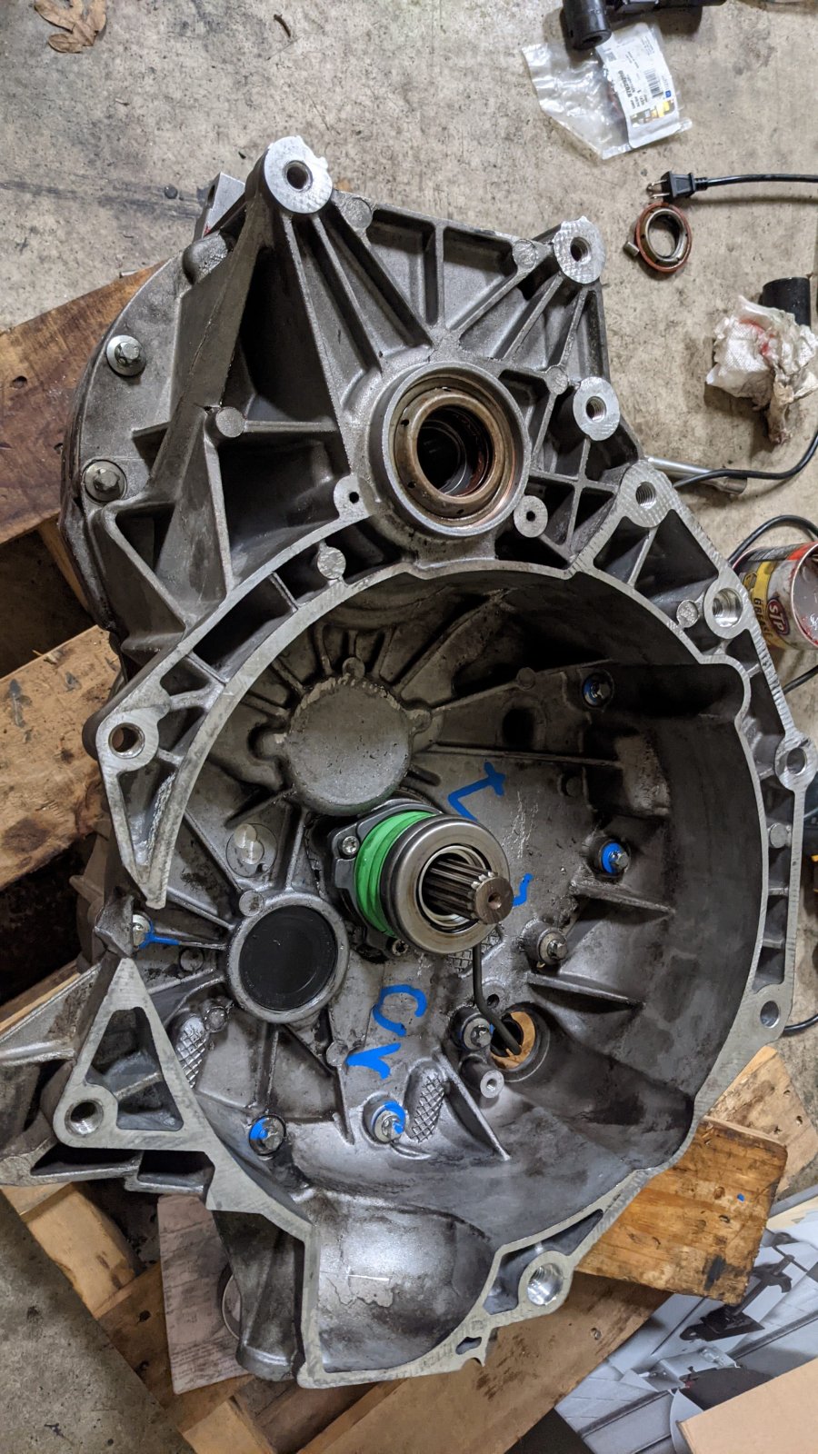

You can use the F35 throw out bearing and pipe with slight adjustments to get it to stick through the existing hole
21415
21416

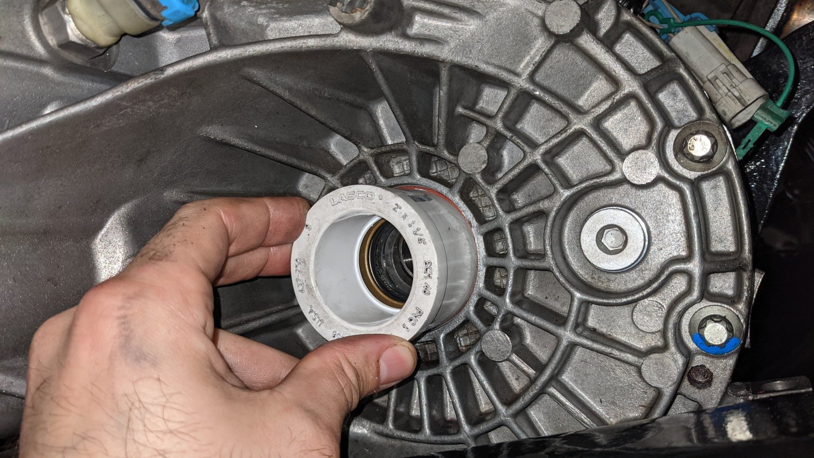

You want a 2 x 1 1/4" fitting
21417

Picking up from where I left off, here's what the seal should look like correctly installed.
21418

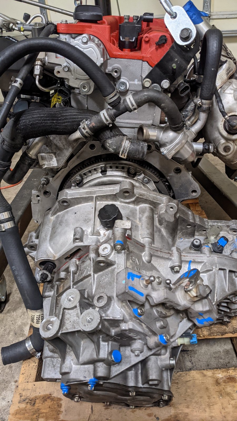

You then need to extend the reverse light plug
21419

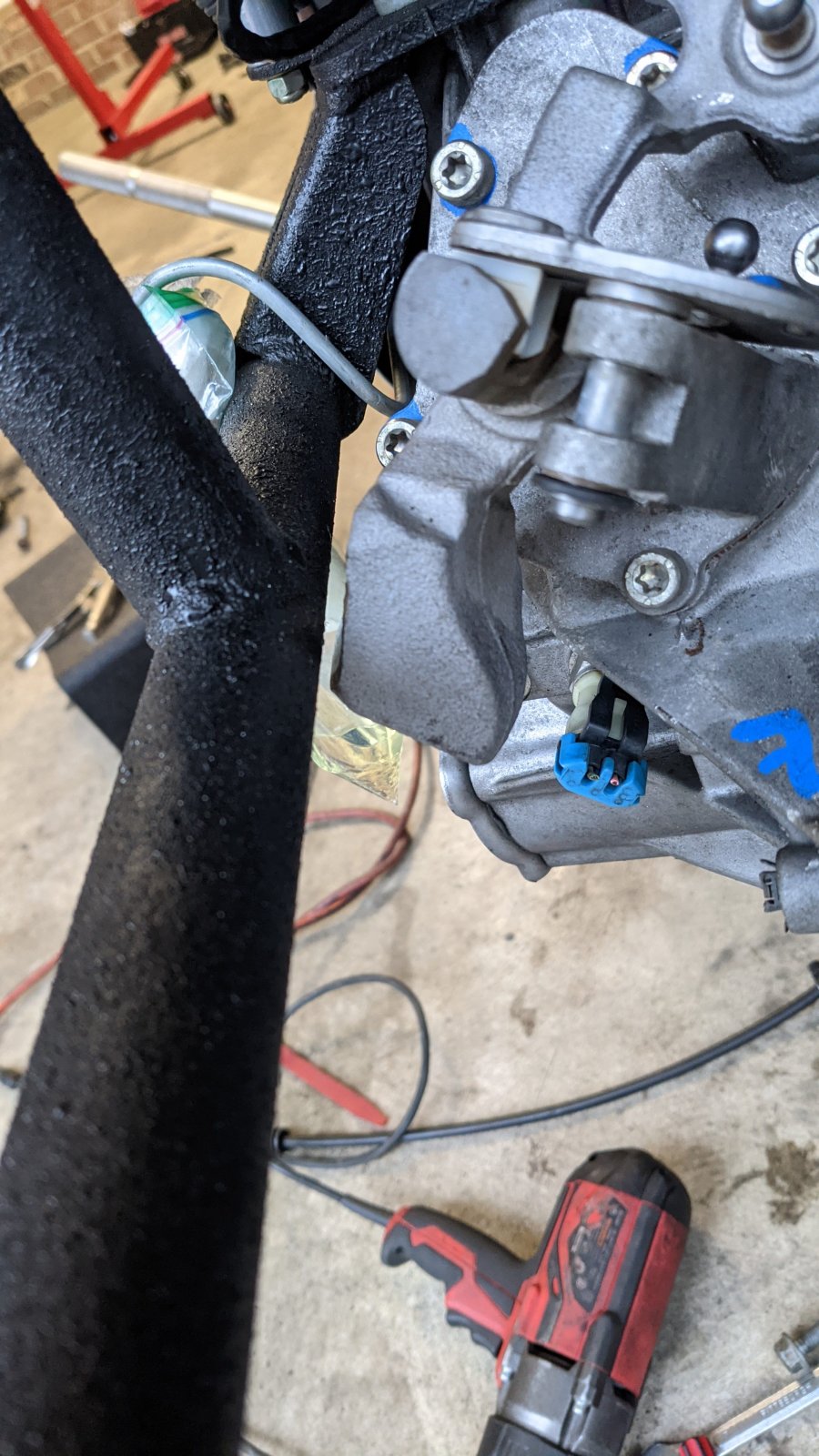

You'll need to grind the shift lever so it doesn't hit your frame
21420

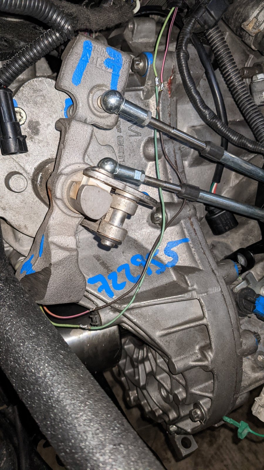

You can use the LNF F35 goblin shift cables but I had to adjust all the fittings to be on the VERY end of the rod to be long enough.

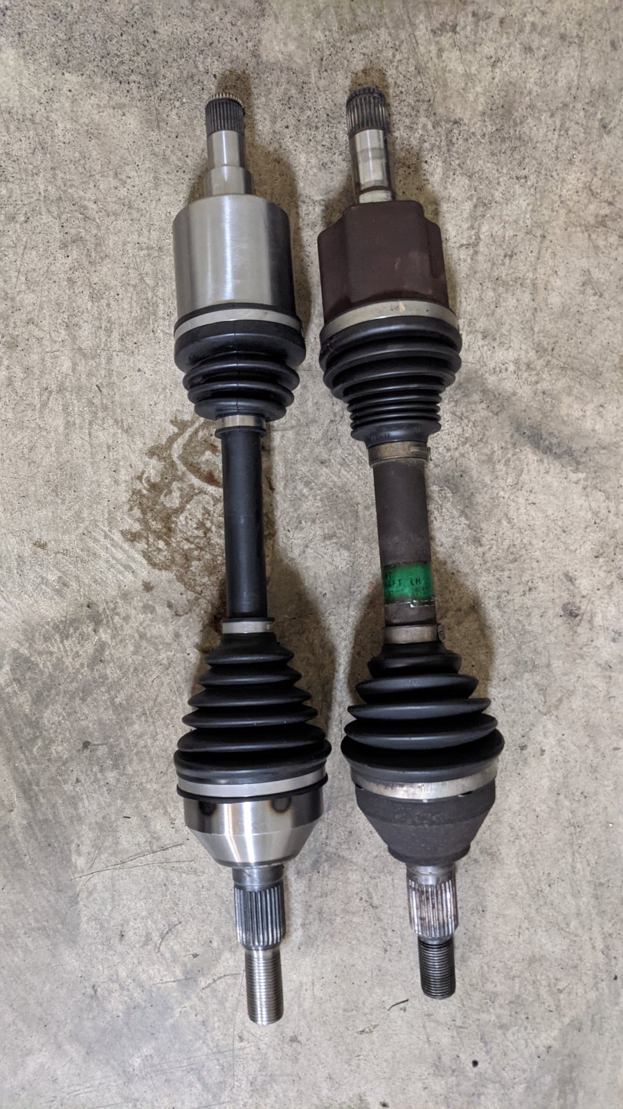

On to the axles. The LNF F35 axles are too large for the F23 trans, you must purchase both the drivers and passengers side axle from a manual 2000 Grand Am
Drivers
Passengers
The passengers side is the long boi. You no longer have the jack shaft and mount that the F35 has. I believe you can get an equal length shaft out of an Isuzu of some type but I didn't research that far enough. These Grand Am axles will fit the LNF hubs no problem

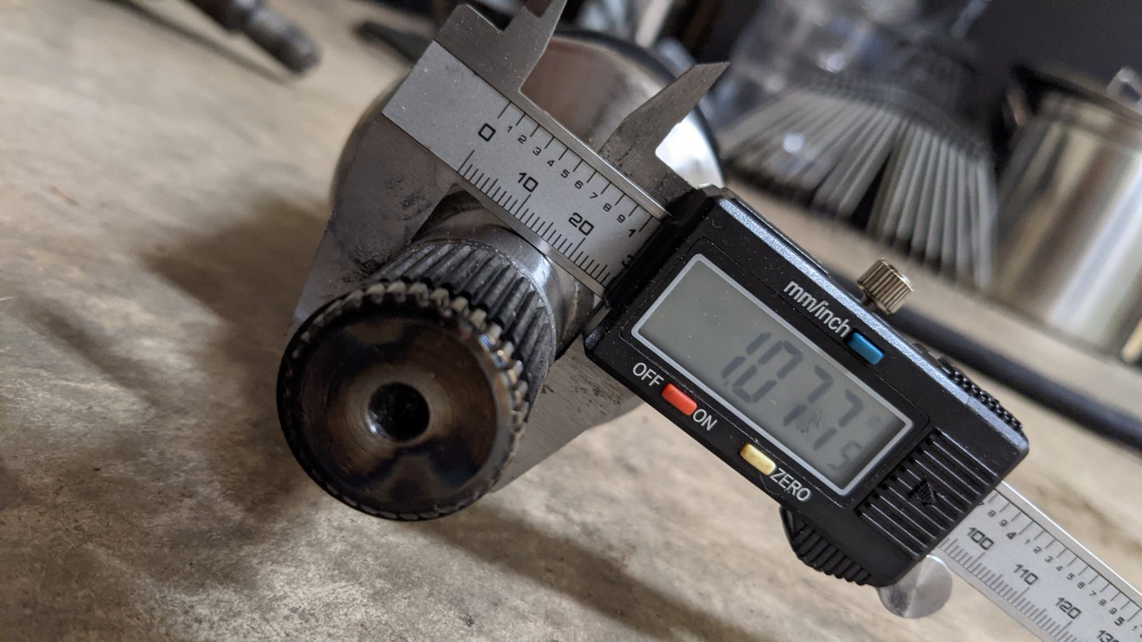

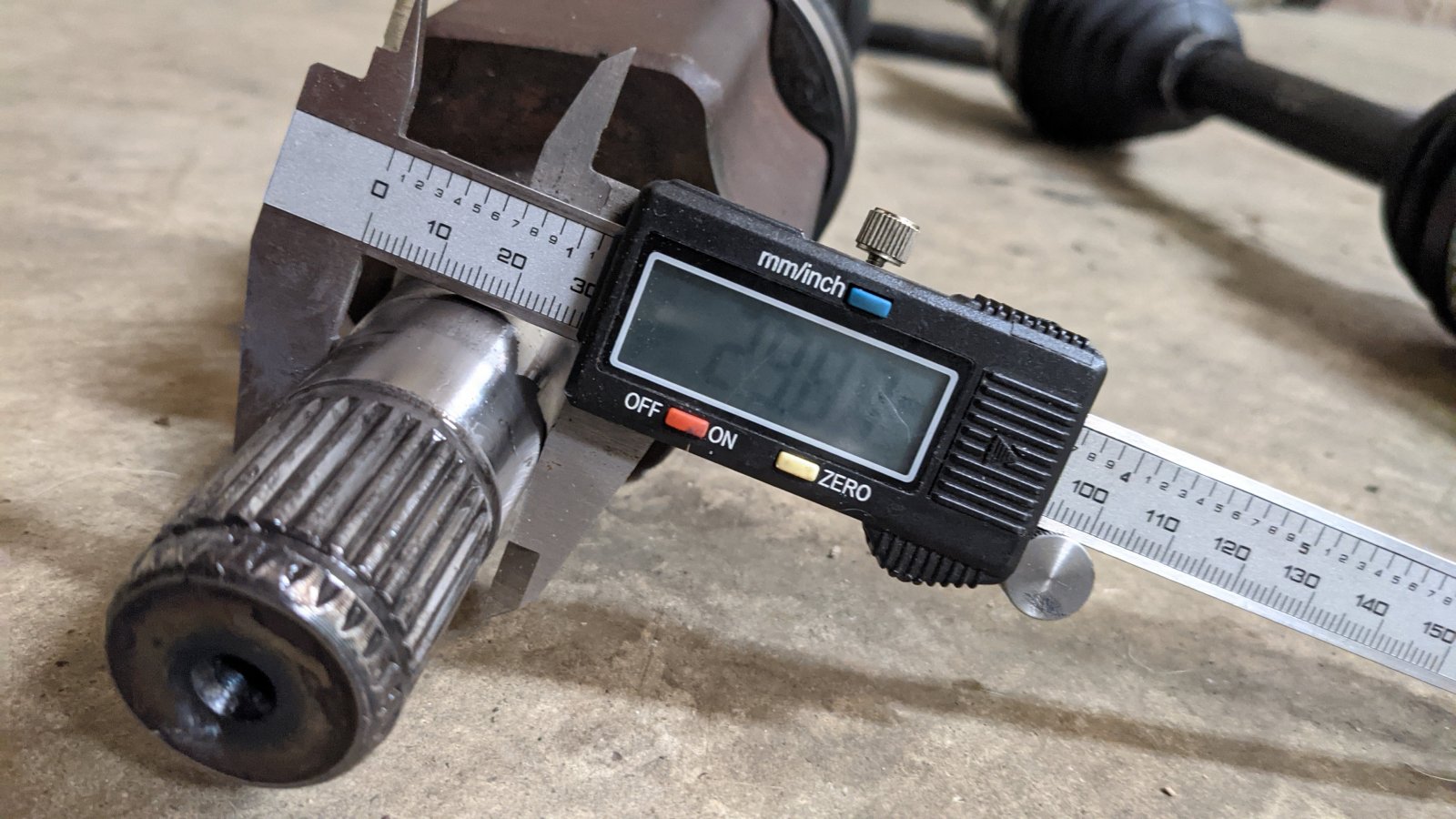

F35 = ~29mm vs F23 is input is ~27mm
21422
21423
You'll notice the F23 axle shafts are significantly smaller in diameter, it didn't seem to make a difference on the dyno....time will tell.
