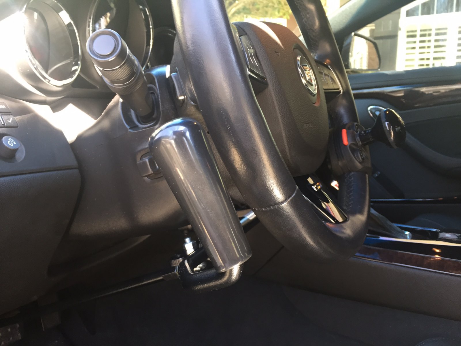

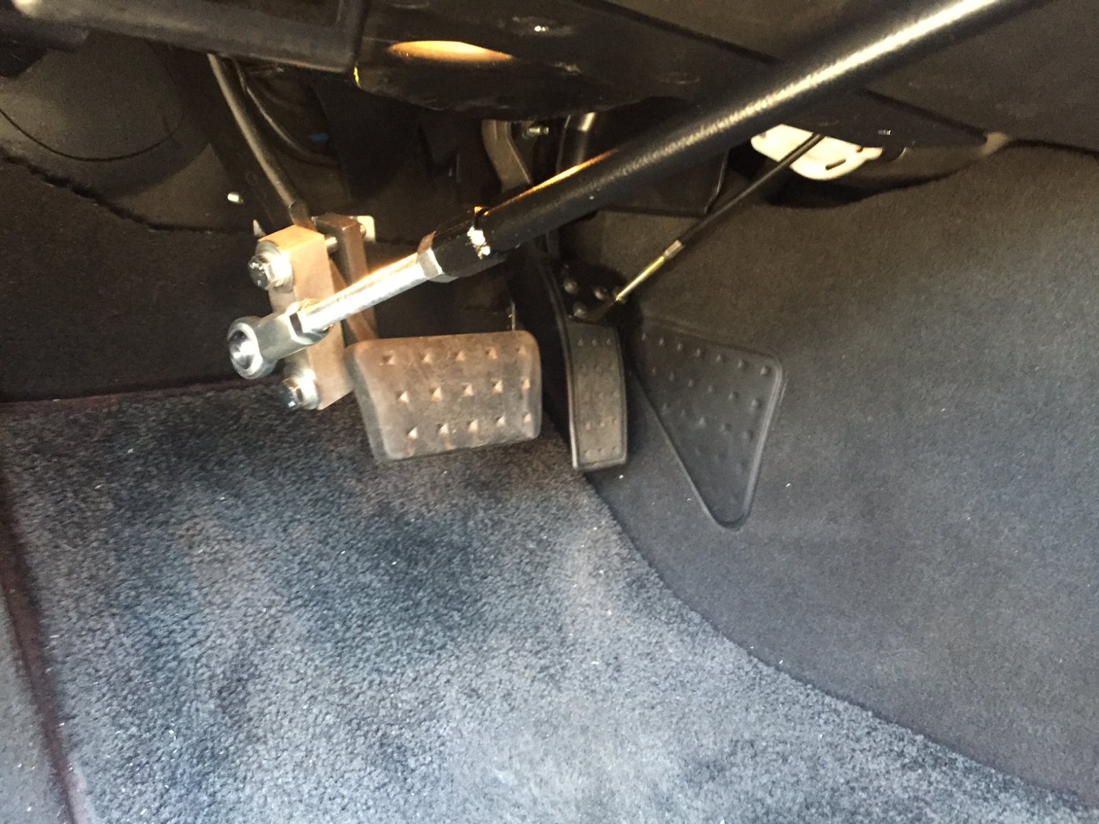

Hey guys/gals, I'm going to be pulling the trigger soon on a Goblin once I sell my CTS-V. Im very new to building a car so forgive my ignorance to all of this. I am wondering if there are any sequential trans options out there that would work with the goblin or anything like that? I am a paraplegic and I'm trying to figure out a way to make hand controls work for a traditional manual, but I have a feeling the controls would be so complex it would take away from the joy of driving it. It would be awesome to have paddle shifters or just be able to hit a lever and shift. Here's the simple setup I drive with right now, but its an automatic. Any ideas? Again, please forgive my ignorance to all of this, I have a lot to learn! Thank you!

Welcome to the forum. Veteran? Just asking because I have good friend who also has a similar set up in his F150 pickup - thanks to an IED in Afganistan.
To answer your question, there are some transmission options that could be used with the ecotec engine that can utilize paddle shifters. Just recently a thread conversation about the automatic trans stated a Saab 6 speed auto with paddle shifters was looked into. I believe it is in this thread:
dfkitcar.com/forum/index.php?threads/base-model-performance.1087/
I am sure that contacting Lonny and Adam with your specific requirements can be accommodated and they my have some suggestions for outfitting a car.
I know that some semi trucks use "automated manual transmissions" where they have connected electronics to the clutch and transmission. So there is parts available if you really want a manual transmission, but the manually shifted SAAB or Cobalt automatic transmission is probably easier to engineer into the kit.

Thank you! No, I was injured in a Polaris RZR with a rollcage that failed.
It looks like there might be a few options out there, I have emailed Lonny once about the easy entry option and just did about trans options. Im wondering if the Saab paddle shifters have any lag? I have paddle "Buttons" on my CTS-V and they have a bit of a lag. I really only use them to downshift into the correct gear when roll racing.
George
They are not a quick as I would prefer but if you put in sport mode and are aggressive with the throttle it will surprise you. The down shifts are quick and firm as well as the upshifts at full throttle

I don't know your budget or how much his setup would cost , but Rob Parsons a.k.a Chairslayer is also a paraplegic who has created hand control system that allows him to drift/race manual transmission cars.

Thank you guys for the help. I've been looking into mastershift and I have also checked out Rob Parson's setup. I'll make this work one way or another! Im really looking forward to this project.
