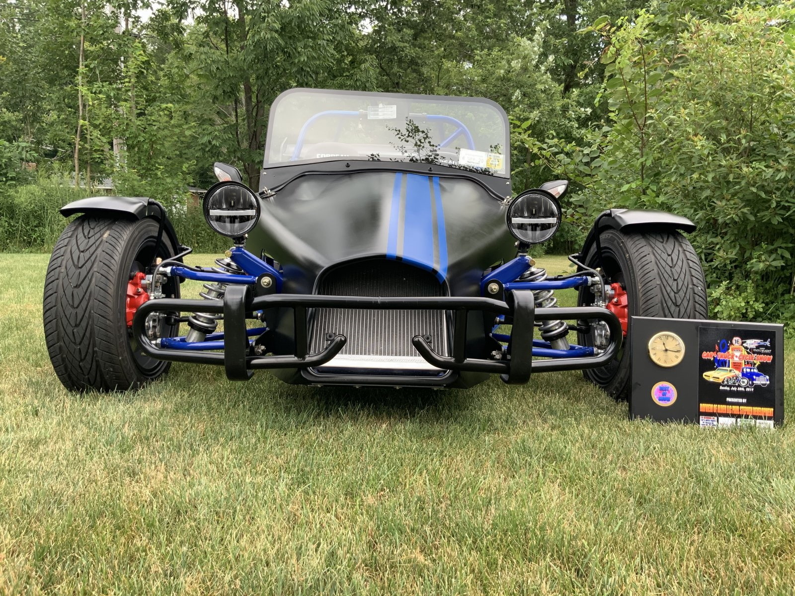

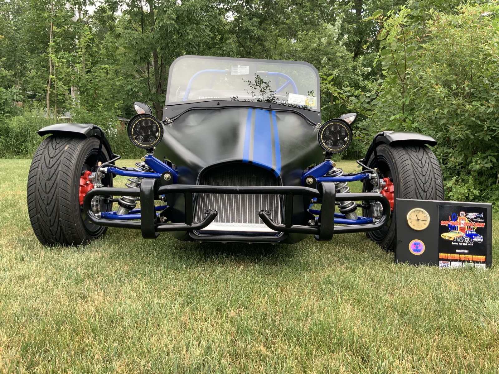

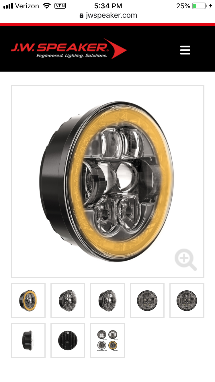

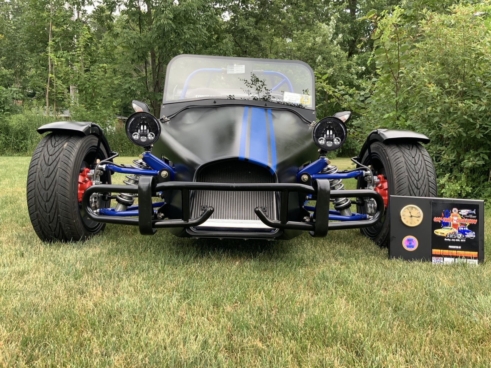

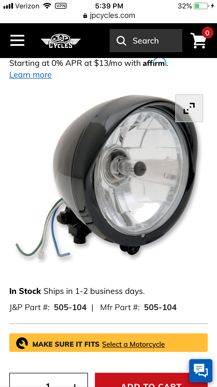

Nothing in a 5 3/4 round hi/low beam. The more I look at the Eagles, the more I’m liking them. I did a mock-up photoshop using Bruce’s car. 2nd one is my favorite.

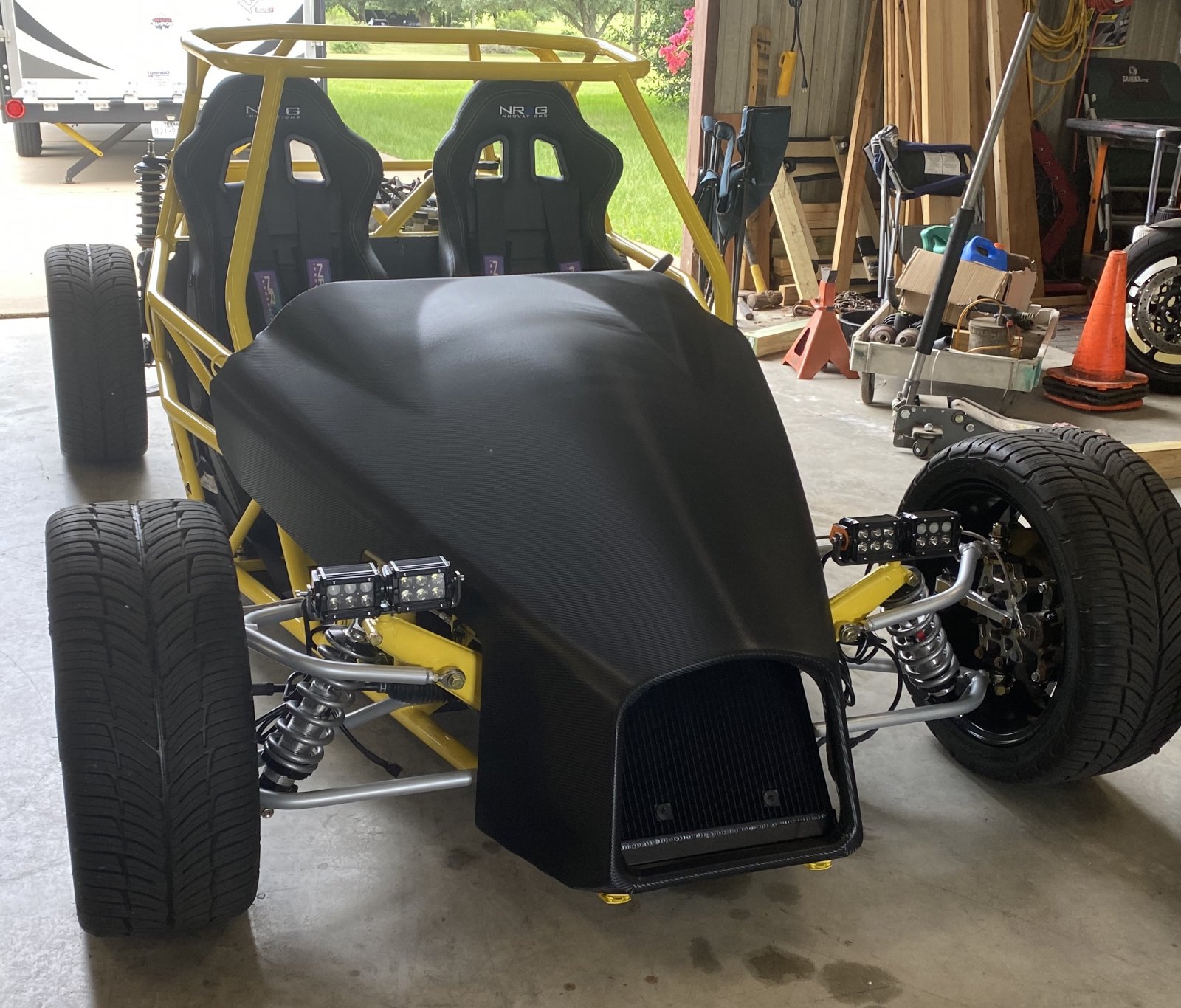

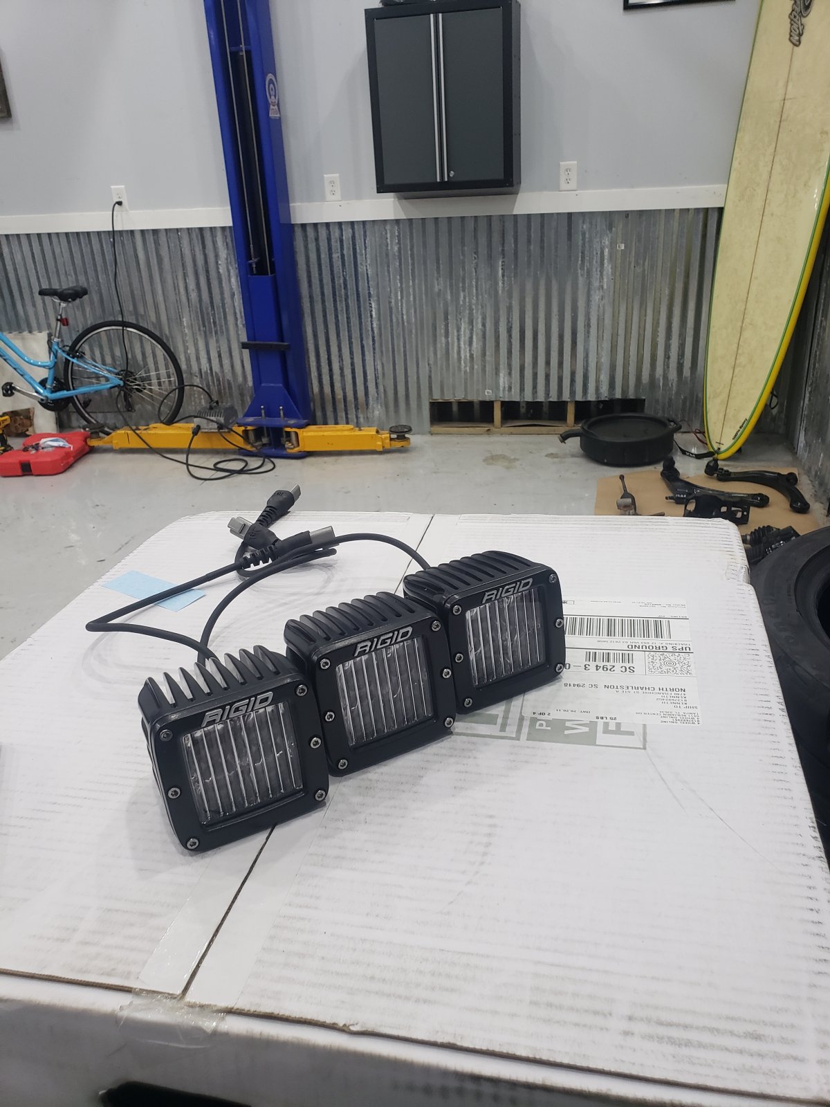

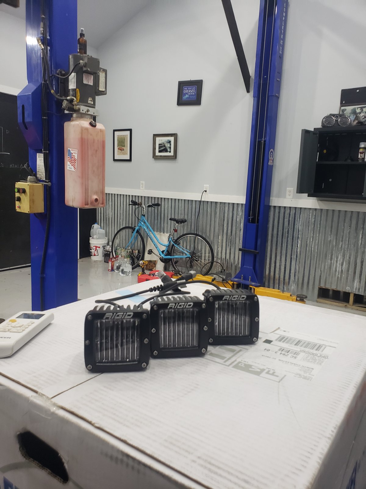

Really thinking of doing 3 rigid SAE lights per side. I have the lights I just hope that I have enough room between the hood and the wheel as it turns. I do know my frame is welded so only a matter of time to know for sure. Has anyone else used these lights?

We use the Rigid Duallys on our car and absolutely love them! We use the flood version for the low beam and the spot version for the high beam and it works out great. They don't follow the DOT guidelines, but I don't think many OEM lights do nowadays.

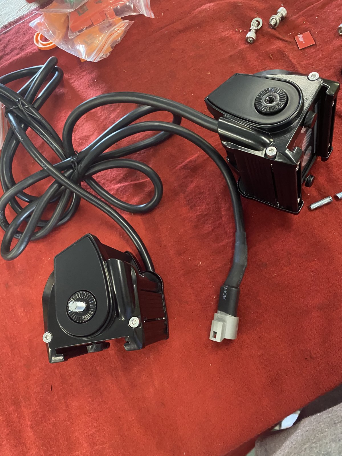

I did something similar. I took 2 Luman led pods that have built in side markers, attached them together and made a bracket to attach to the goblin.

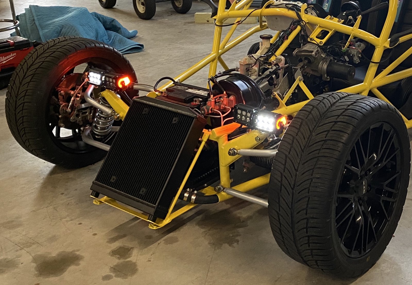

don’t forget, these project a spectrum and not very direct. Blinding other cars is possible. I’m working on blocking some of the light, so it’s more direct on the roadway, at least on low beams.
I thought about that also, but about the only real way of doing that is to open the light and paint the lower half of the conical-shaped reflector for each individual LED inside. That way it doesn't reflect up. Trying to put a hood or cover over the top half will not actually block all of the light from the multiple LEDs inside.
Ya, painting the lens should work, but mine came with these covers, to change the color of the light and one is black (for some reason), so I was thinking on cutting that and inserting it. I’ll take a pic of the covers sometime today.

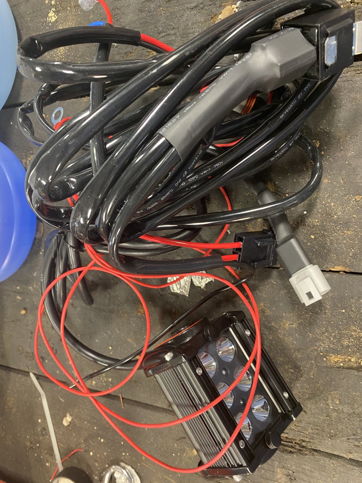

The lights I bought came with all these side and lens covers, plus the provided wiring harness is the most stout harness I have ever seen. :eek:
