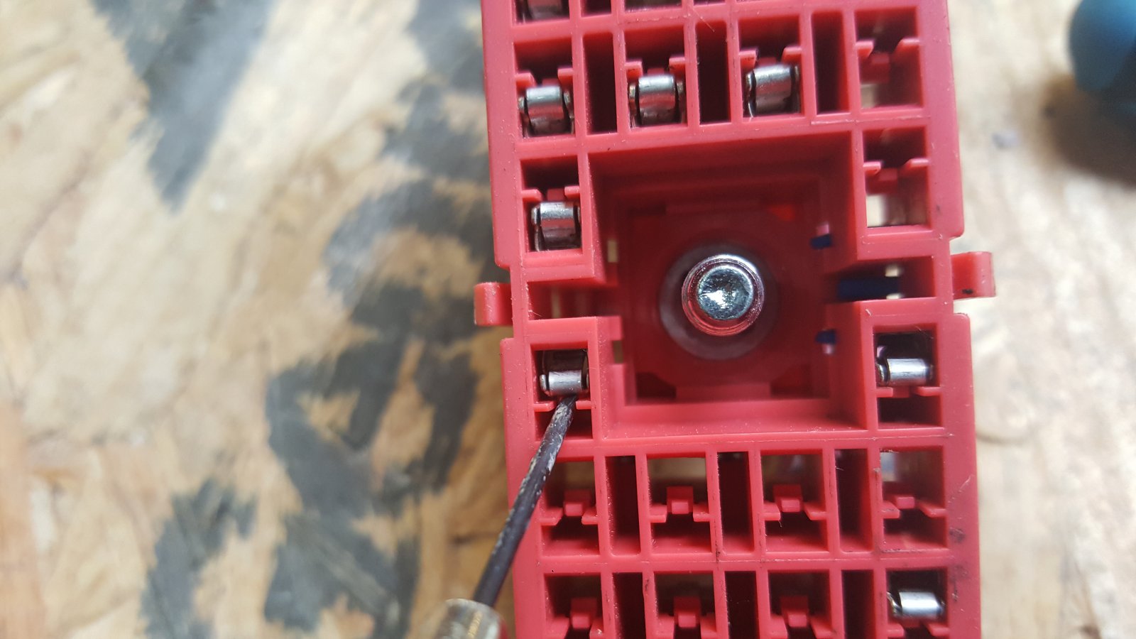

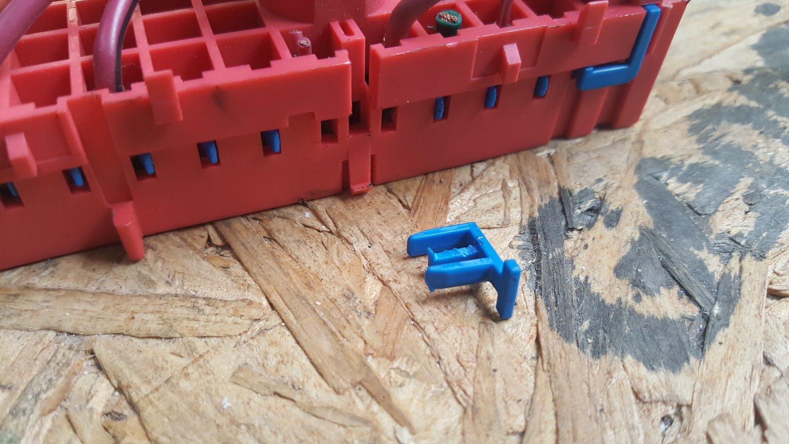

If you have already cut these wires off at the big red plug you will need to remove the connector from the plug and attach a wire.

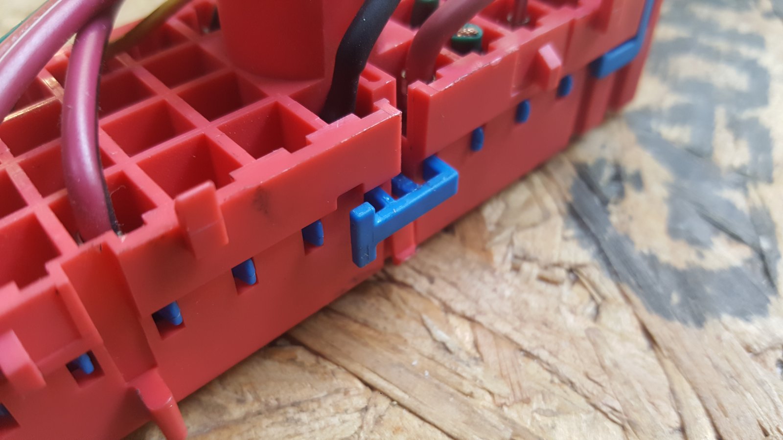

Use a small screwdriver to push down the lock tab and remove the blue retainer.View attachment 5256
Now use a small screwdriver to release the connector.

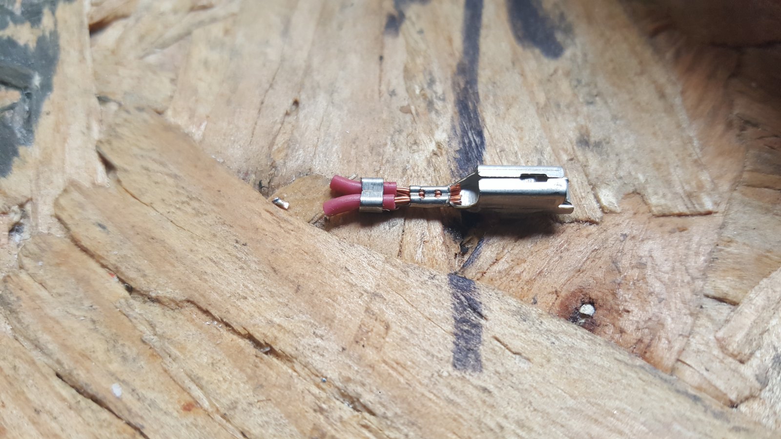

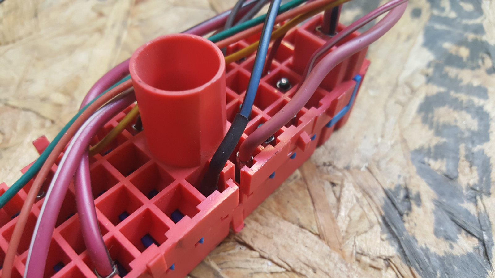

View attachment 5258View attachment 5259

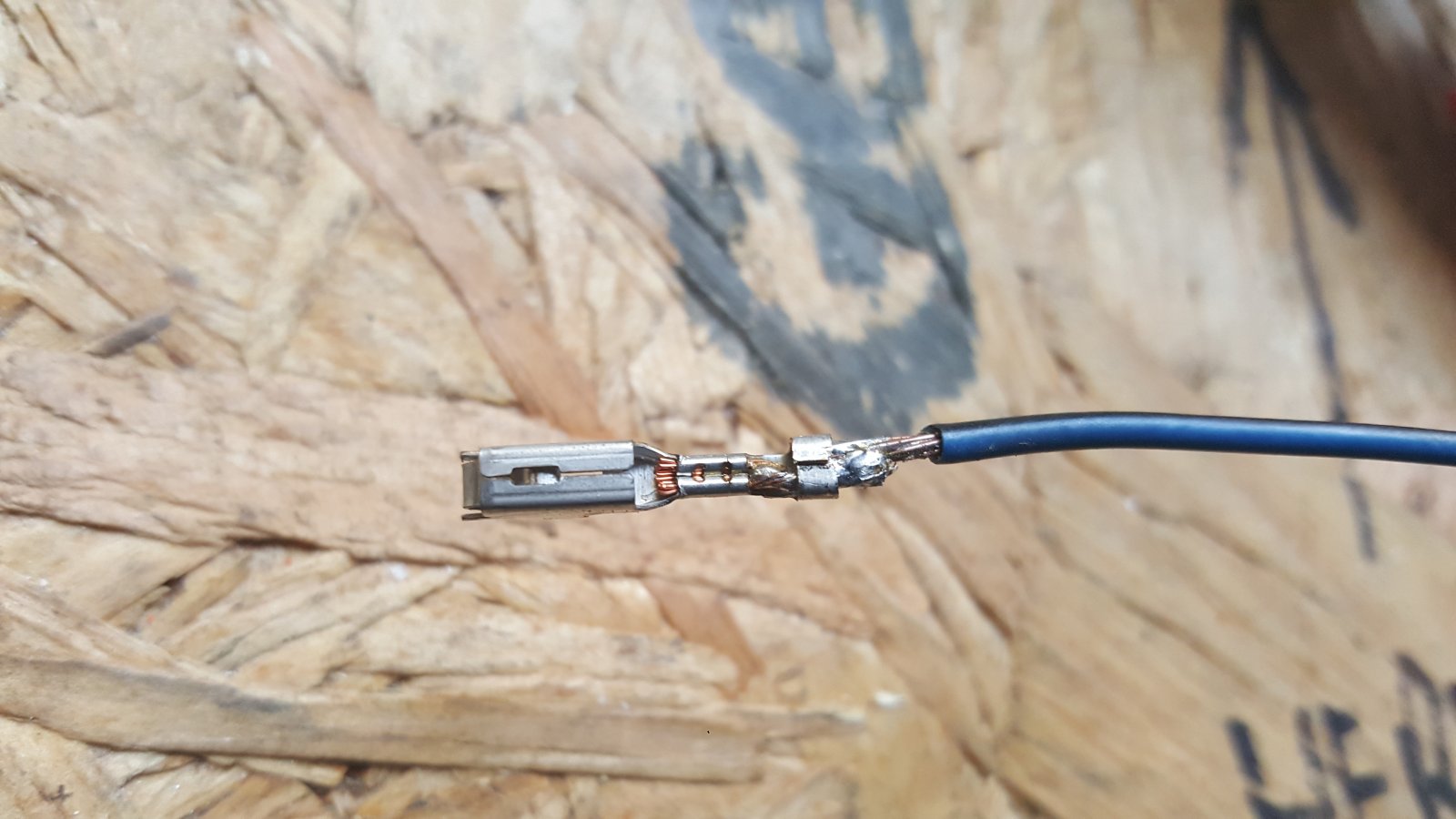

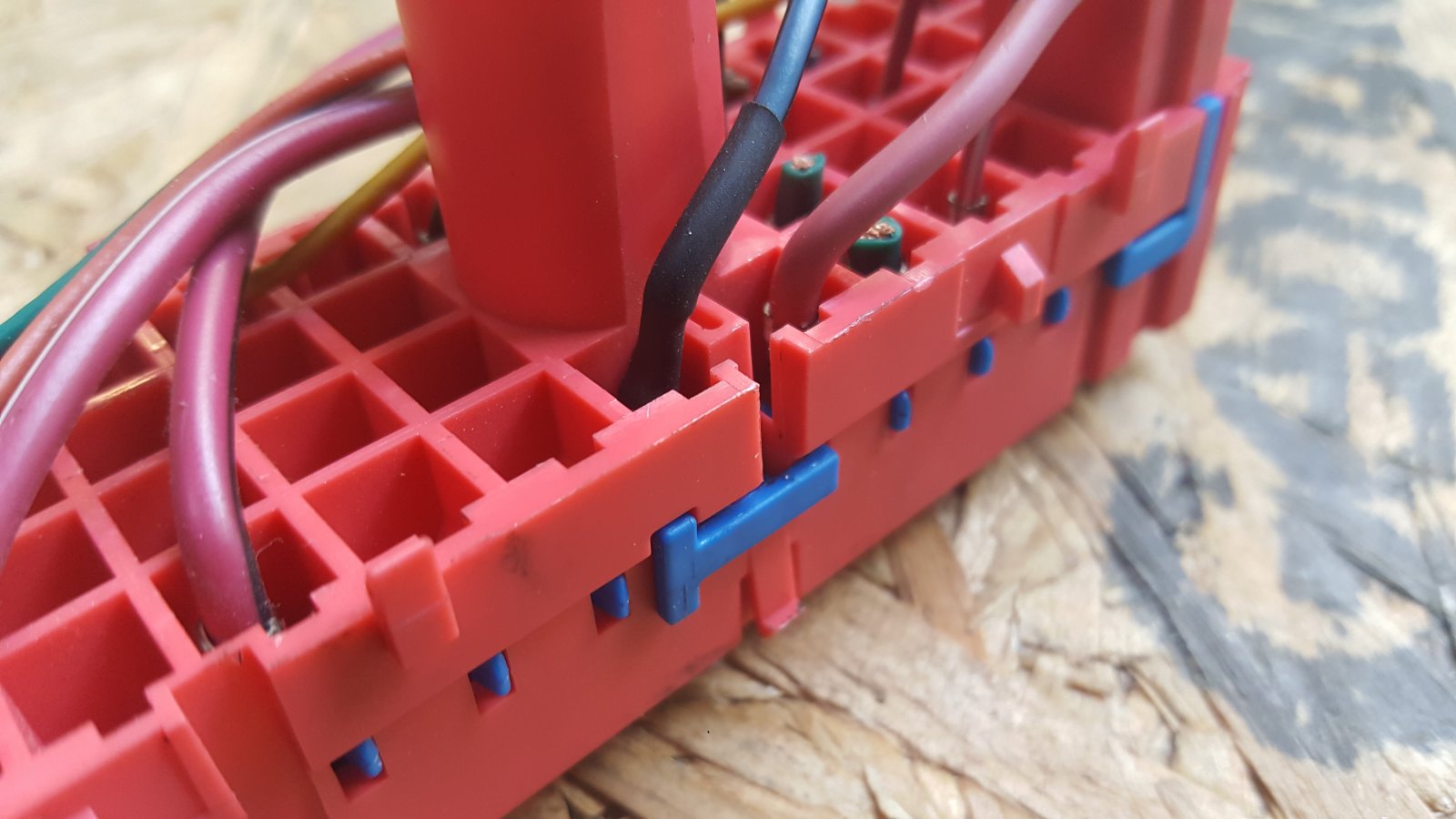

Pry open the tabs holding the pink insulation and remove the insulation to expose the wire. Solder a two foot long piece of rear speaker wire to the exposed wire.
Cover with heat shrink.

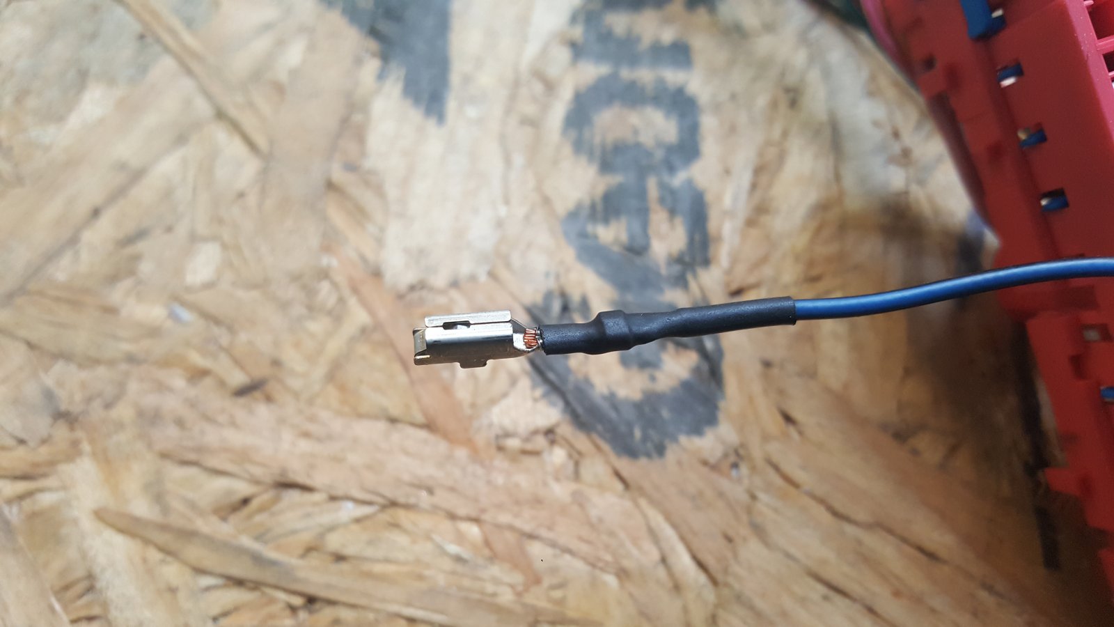

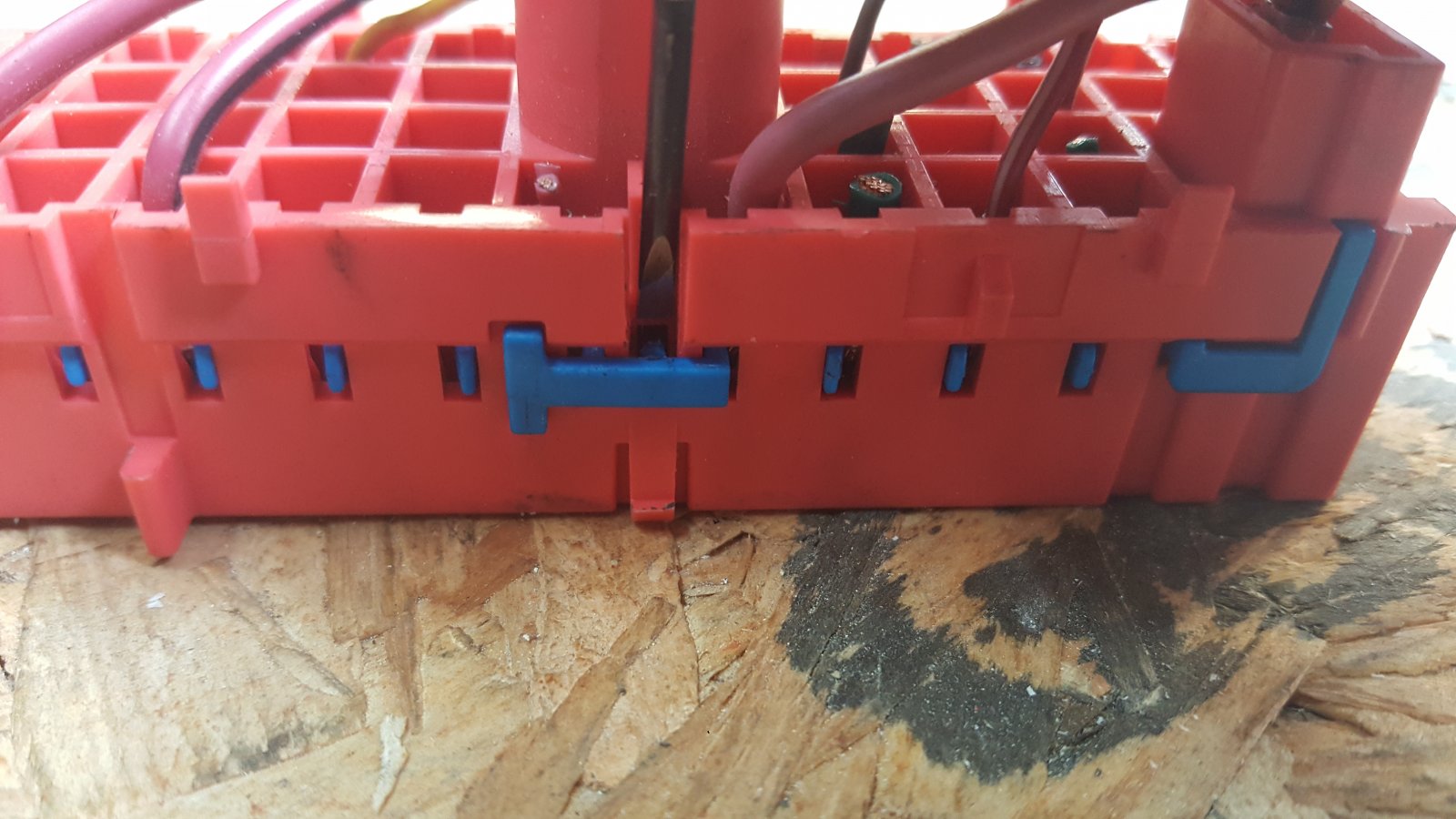

Reinstall connector and retainer.View attachment 5262View attachment 5264View attachment 5263
