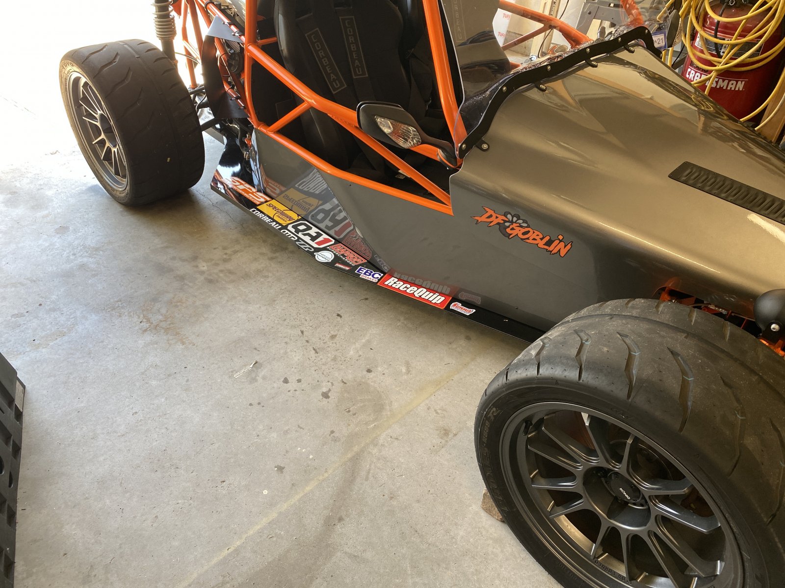

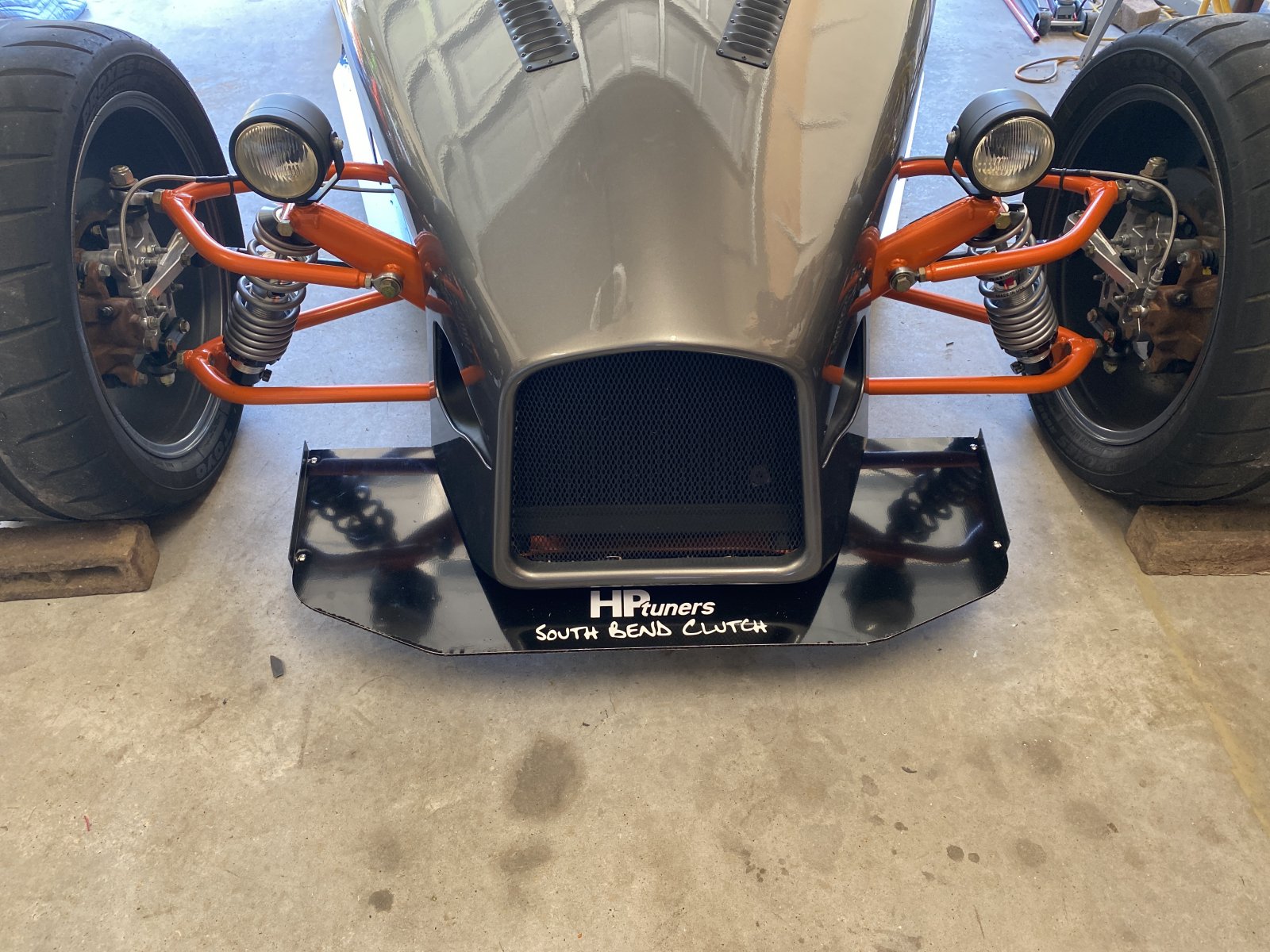

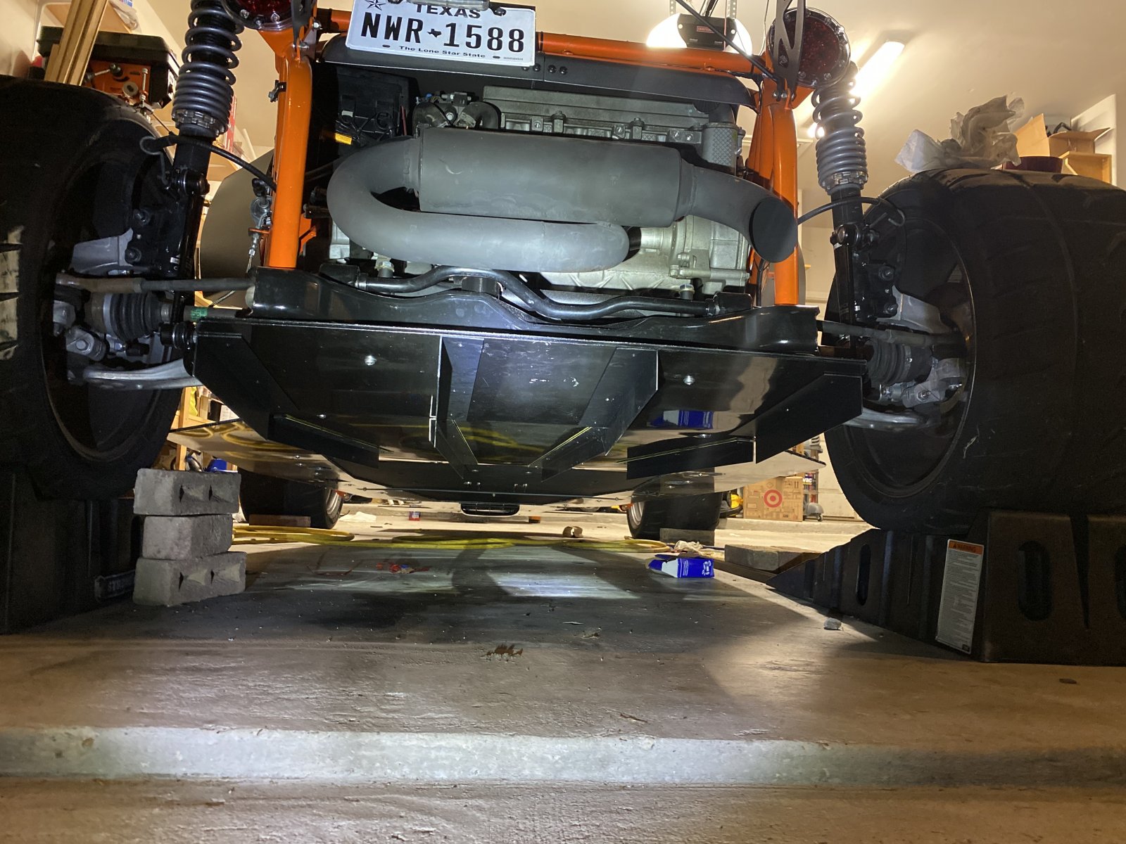

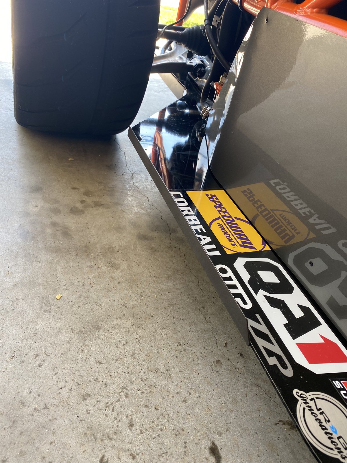

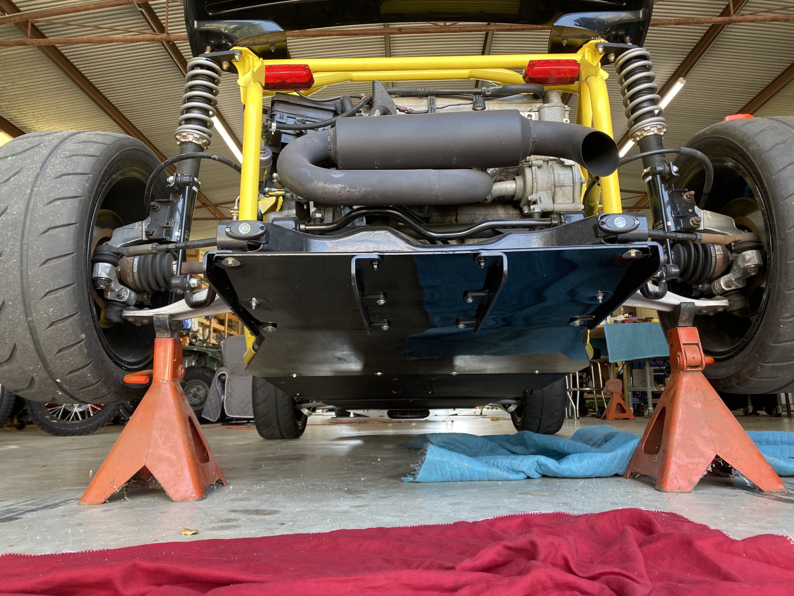

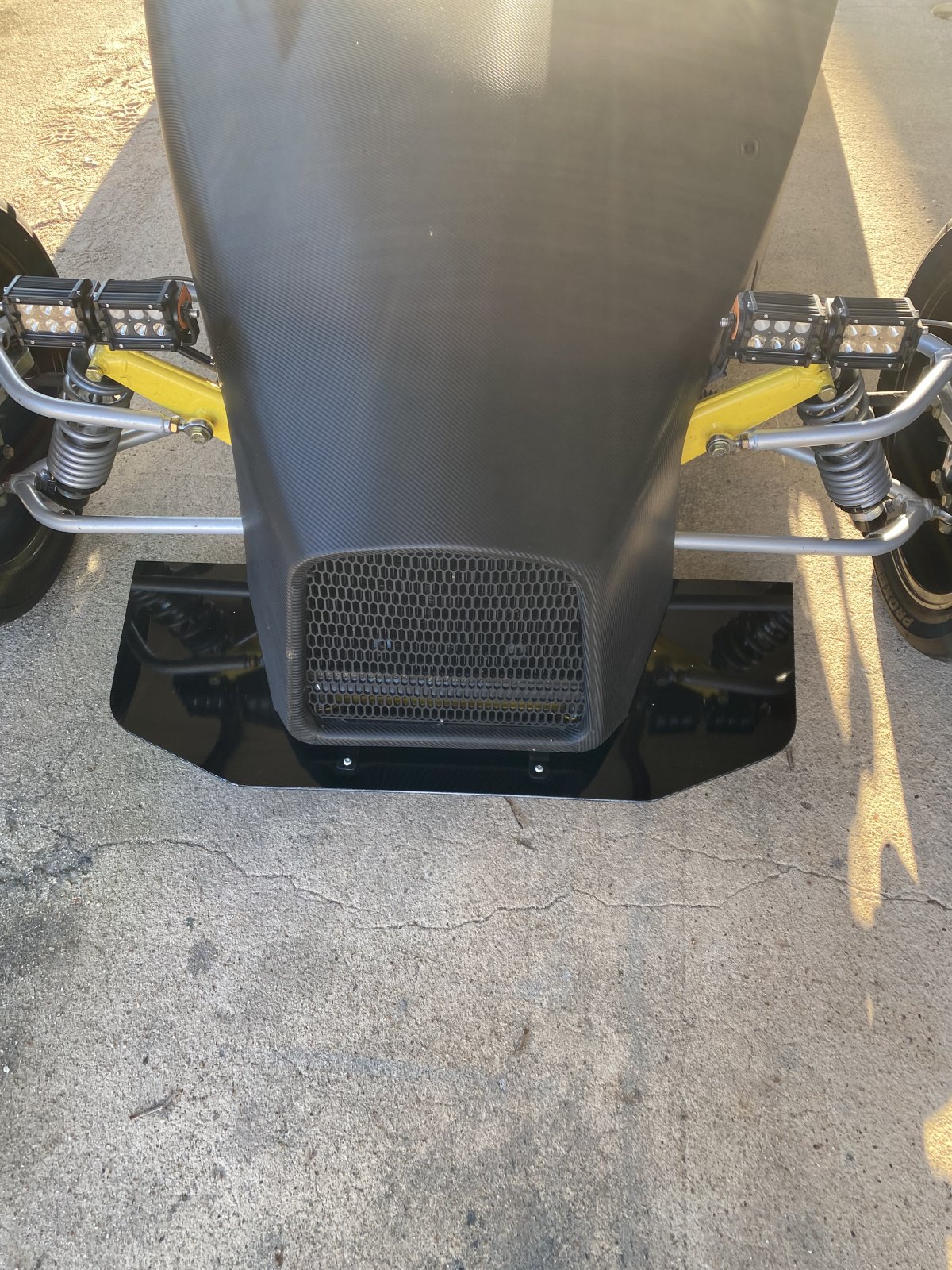

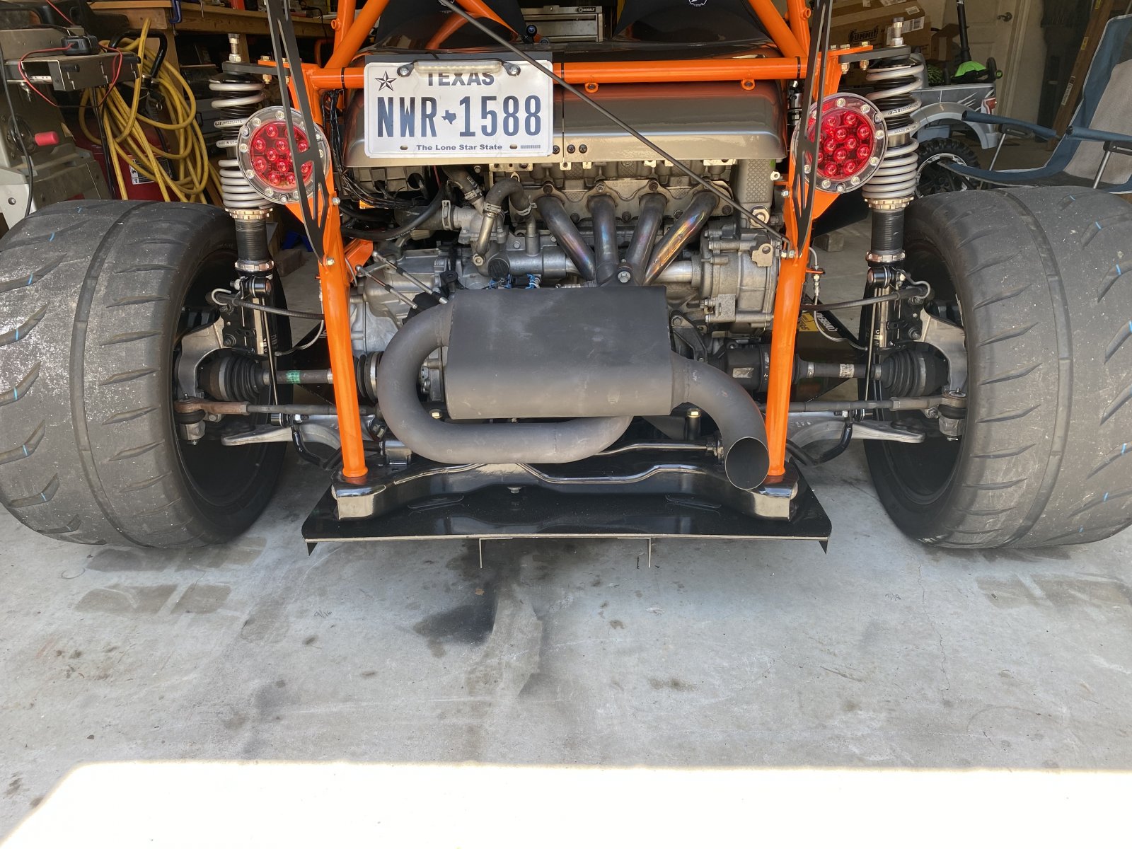

Aero is the key. Hard to believe on a car with the aerodynamic characteristics of this car, but a front splitter and rear diffuser makes all the difference in the world.
The side splitters help extend the floor of the car which gives you more surface area to create down force with. They also help clean up the air coming off of the front suspension and keeps it from going under the car. At least that’s what I like to think that they do :)
My first drive today with the rear diffuser makes the car feel like a completely different car. One hand driving on the highway at 80 miles an hour is now a thing.

I installed the front splitter that SACTX made for his and instantly I could drive 75ish one handed. He cut me a rear defuser last week and I had another friend over engineer some wings for me. I installed them yesterday and now everything is very stable at any speed (tested on a closed course).

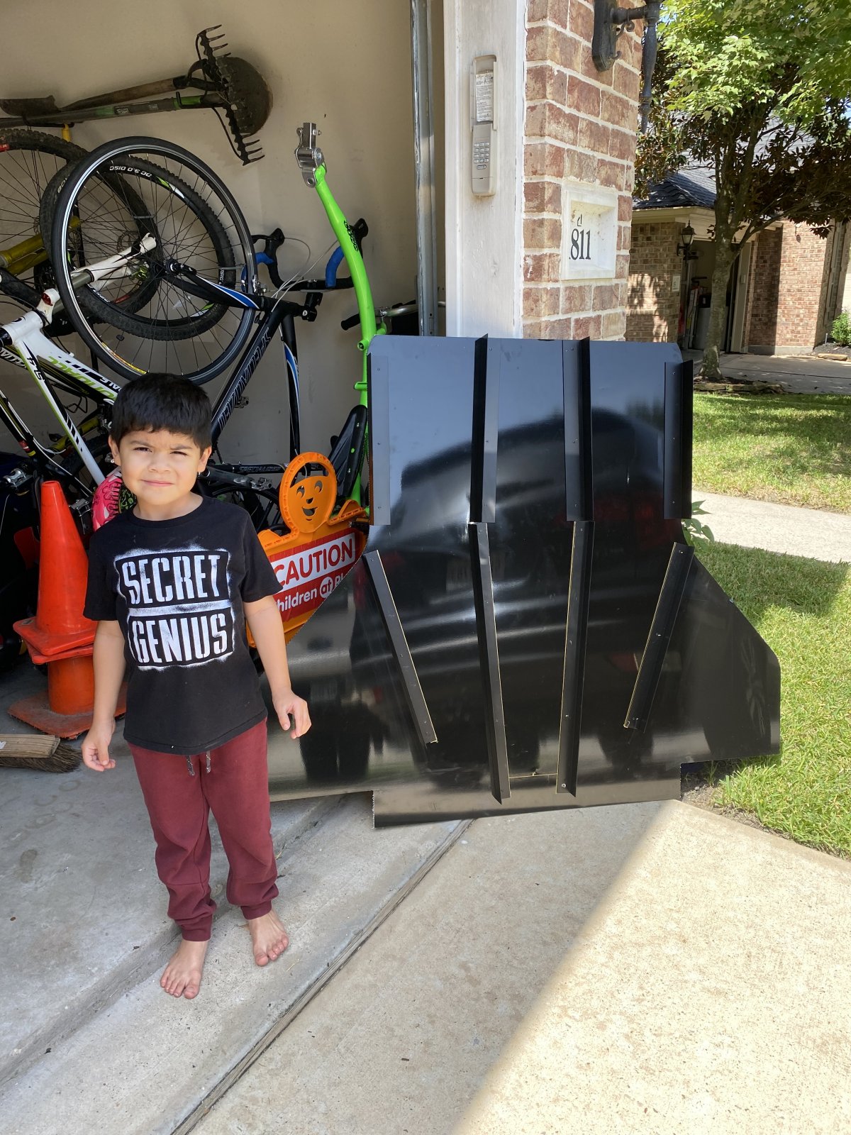

Scott, do you have the layout for the rear diffuser? It also looks like you added some piece parts to the front splitter?
SACTX
I do. I will post them tomorrow. I think I already posted my front splitter and the side splitters in my build log but I’m not 100% positive.
Anyone with the ability to cut this out with a jigsaw could do it pretty easily. You just need a fine tooth wood bit and a lot of patience. You have to go slow or you will start tearing it up. The edges clean up pretty easily with a vibrating or oscillating sander and 150 to 180 grit sandpaper.
If anybody needs them cut out by CNC router, I will be working up a price tomorrow. I have had a few people send me a message so I will look into it. Send me a message if you want something cut out by CNC and I will add you to the list.

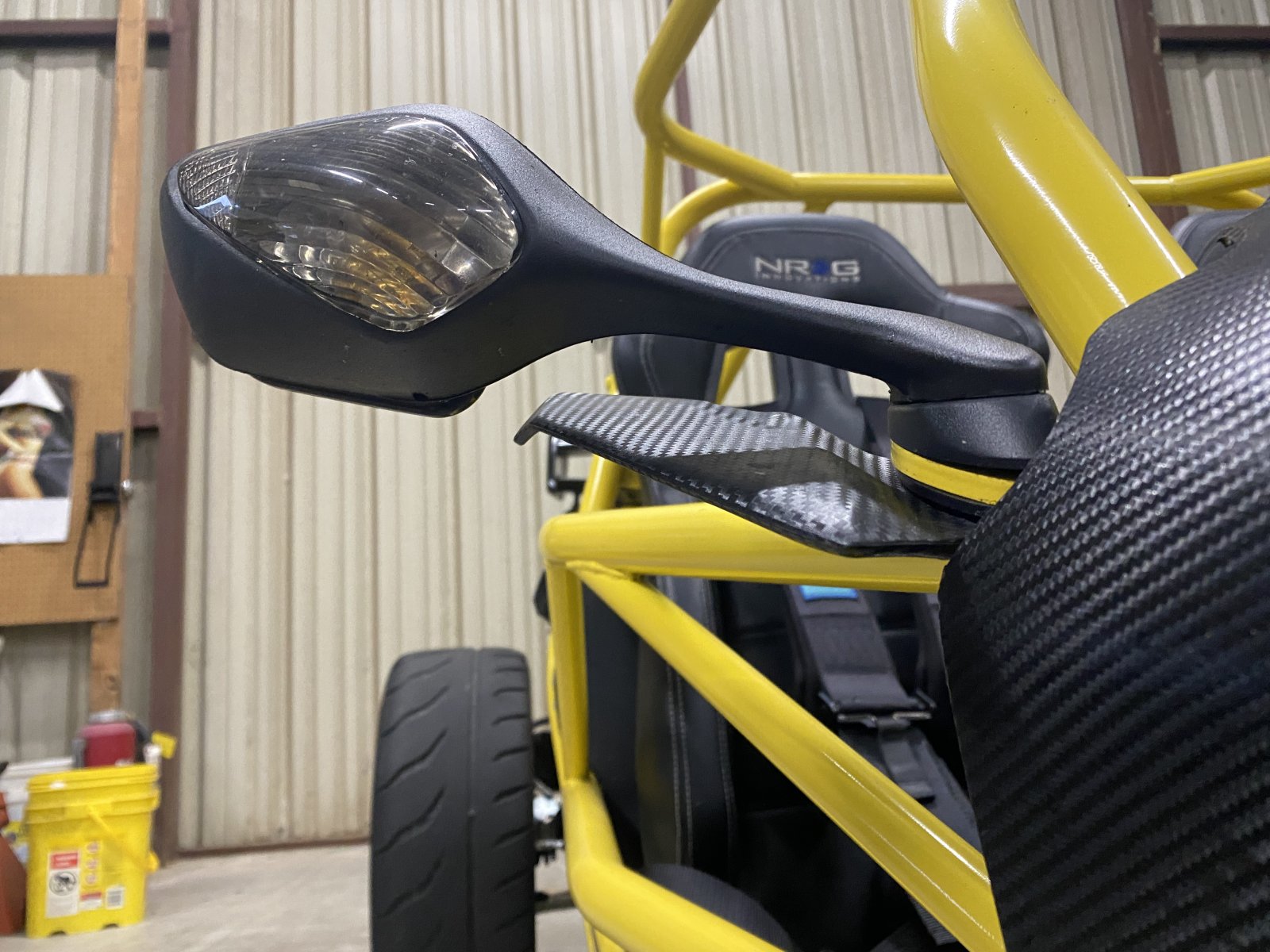

To be fair, it’s an inside joke. I am anti wing, but to goof with the others in my area I bought these motorcycle winglets to put on the front of the goblin. That wasn't going to work easily, so I tossed them on the mirrors, which bolted right up. :D So I left them there. I will agree with Ross, they are more of a mirror protector.…….or is it the key to high speeds??. :eek:
I got them on Amazon, here’s the link.
