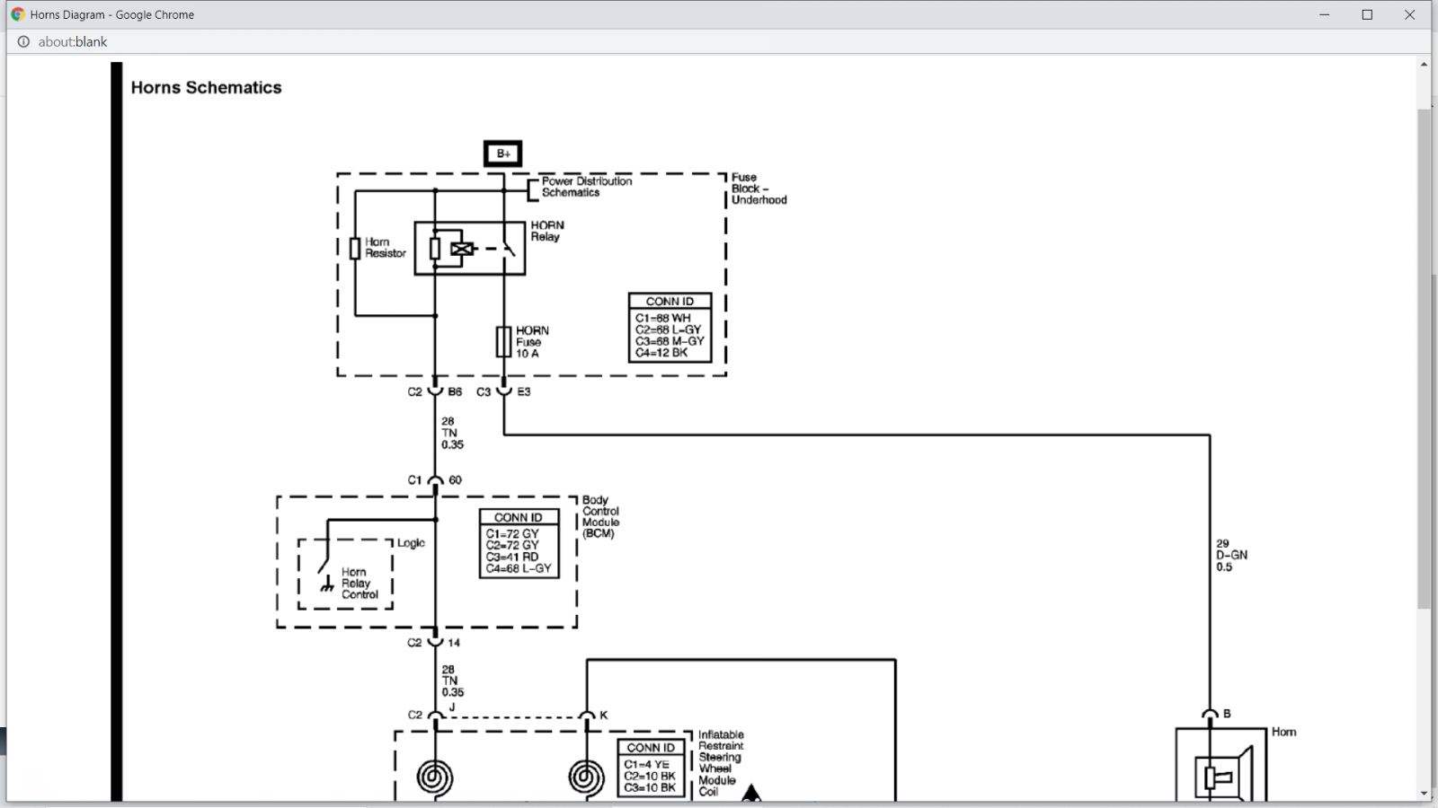

Somehow when I did my writing harness I lost the horn switch wire... And didn't discover this until wiring in the DF button panel. The horn itself is wired on, and I assume it goes through the BCM, but not positive with it all wrapped up. Can anyone help me figure out which plug and pin had the horn switch wire?
You could dig it out of the 2006 wiring diagrams.
Vehicle » Diagrams » Electrical Diagrams » Lighting and Horns » Horn
