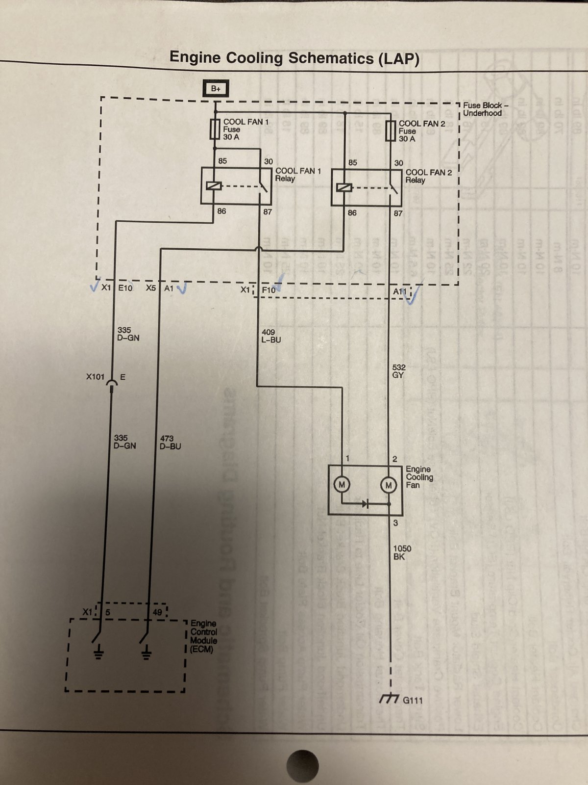

Is it an AC fan or just low and high fans? Most GM 2 fan setups are high/lo setups with the ac triggering the high setting. Of course that doesn’t really change the problem if it’s running on the high relay.

Hi Ross, If I pull the relay for Fan 1 my fan goes off. So unless the wire to relays 1 is changed, it should be all wired correct. I think the settings are also correct, but the ECU still thinks there is an A/C where no A/C is anymore.
