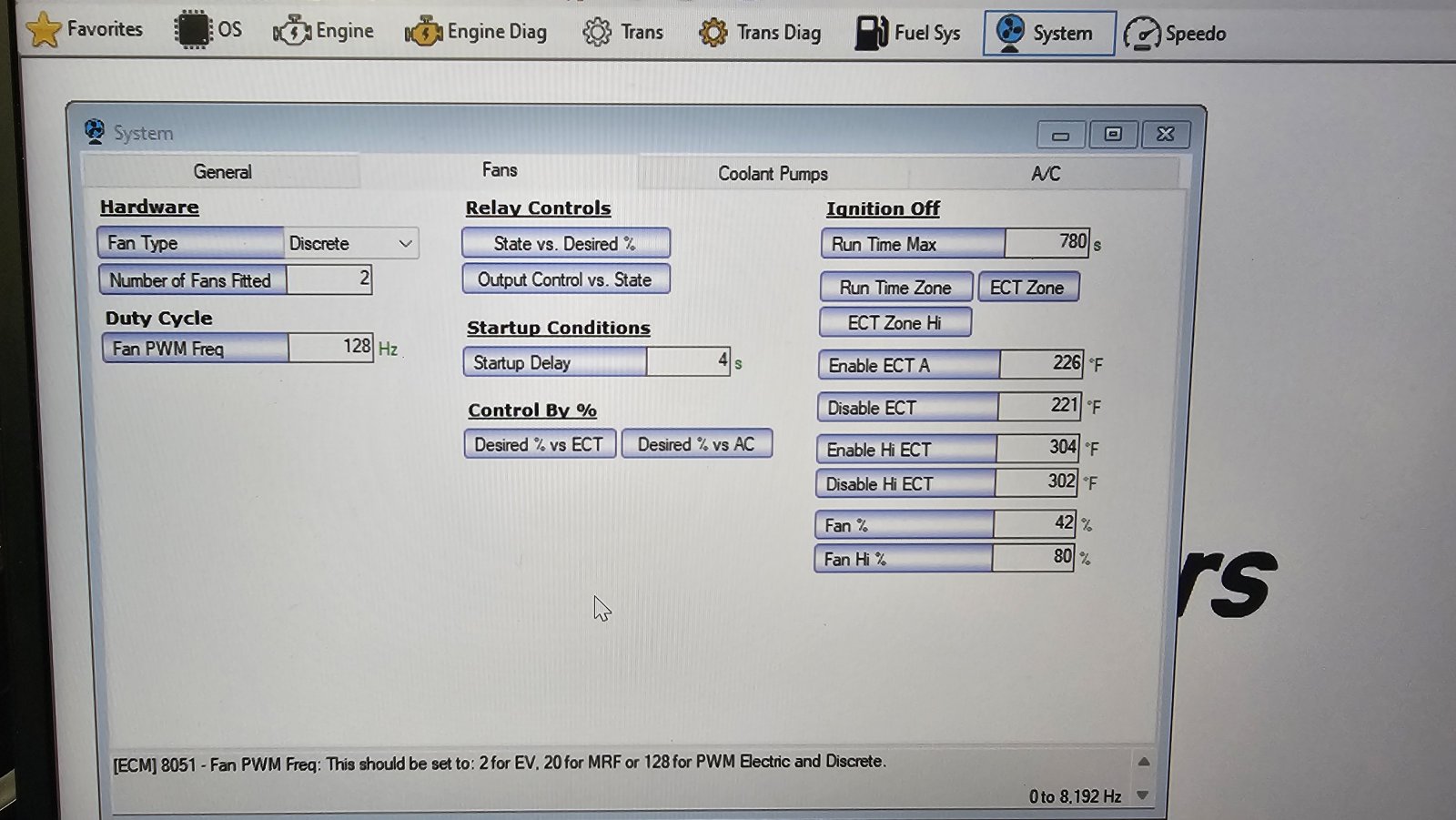

My Fans panel in HP Tuners is much more sparse than what Joebob posted for his 2.4l ... not sure what's up with that. I don't seem to have any settings at all for desired fan cut-on temp, nor anything else really. Not concerned.

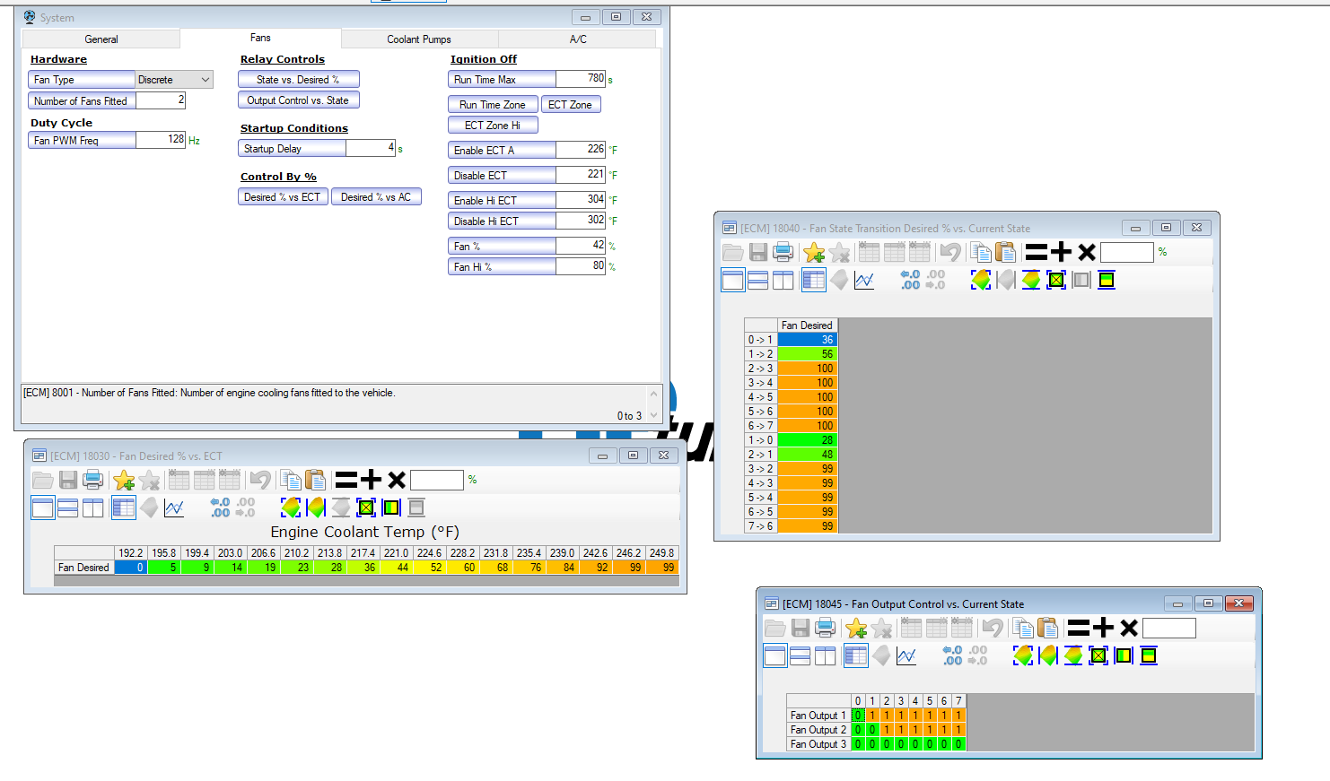

Got the HP Tuner today, this is what my setting looks like. It says 2 fans connected. Tuning file attached as well.

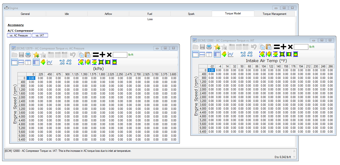

I Zero'ed everything out to not let the A/C pressure drive any engine management

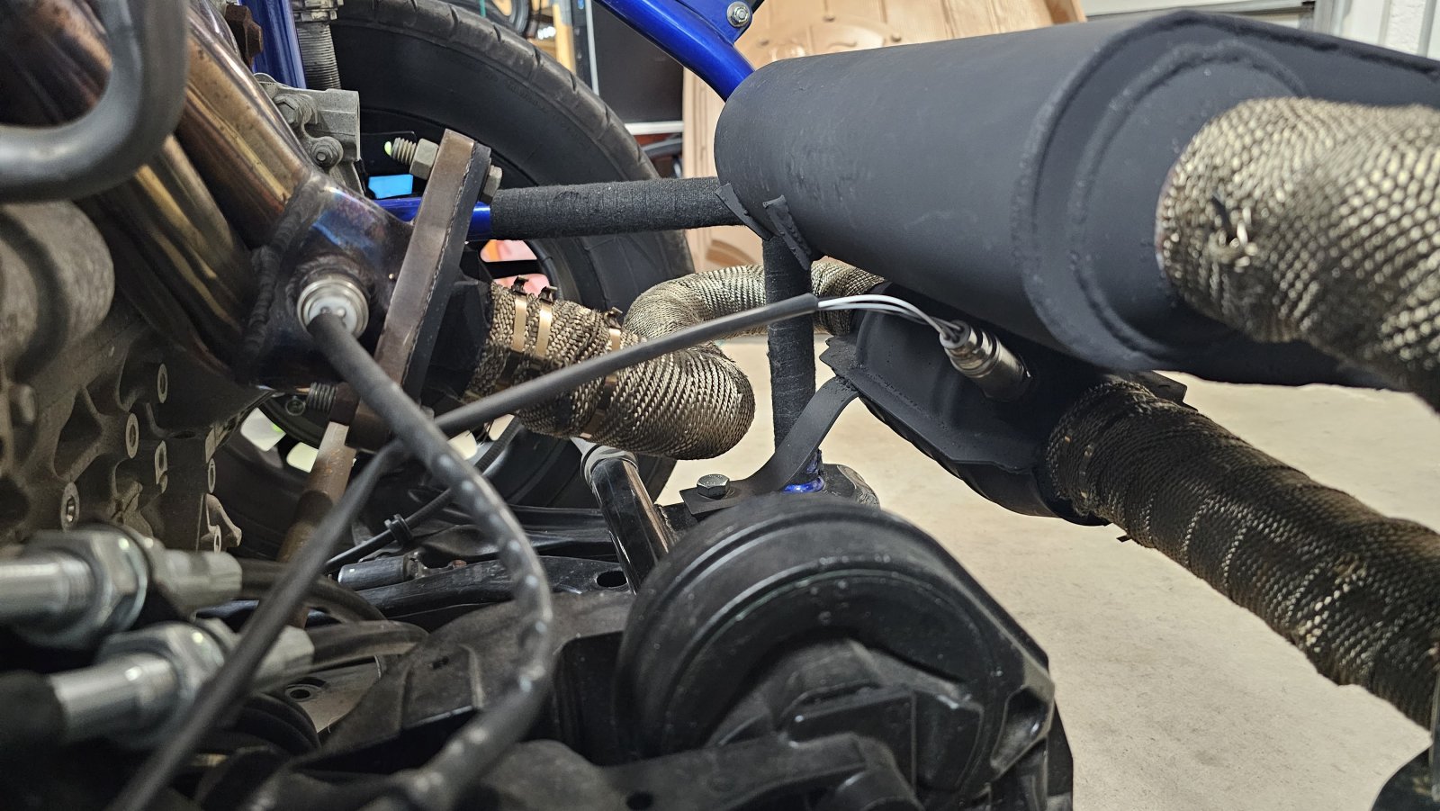

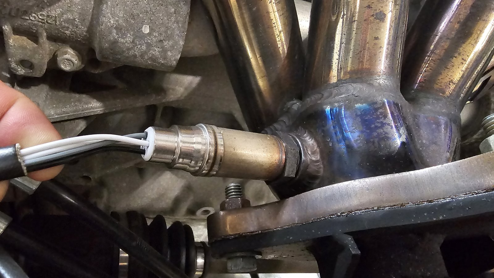

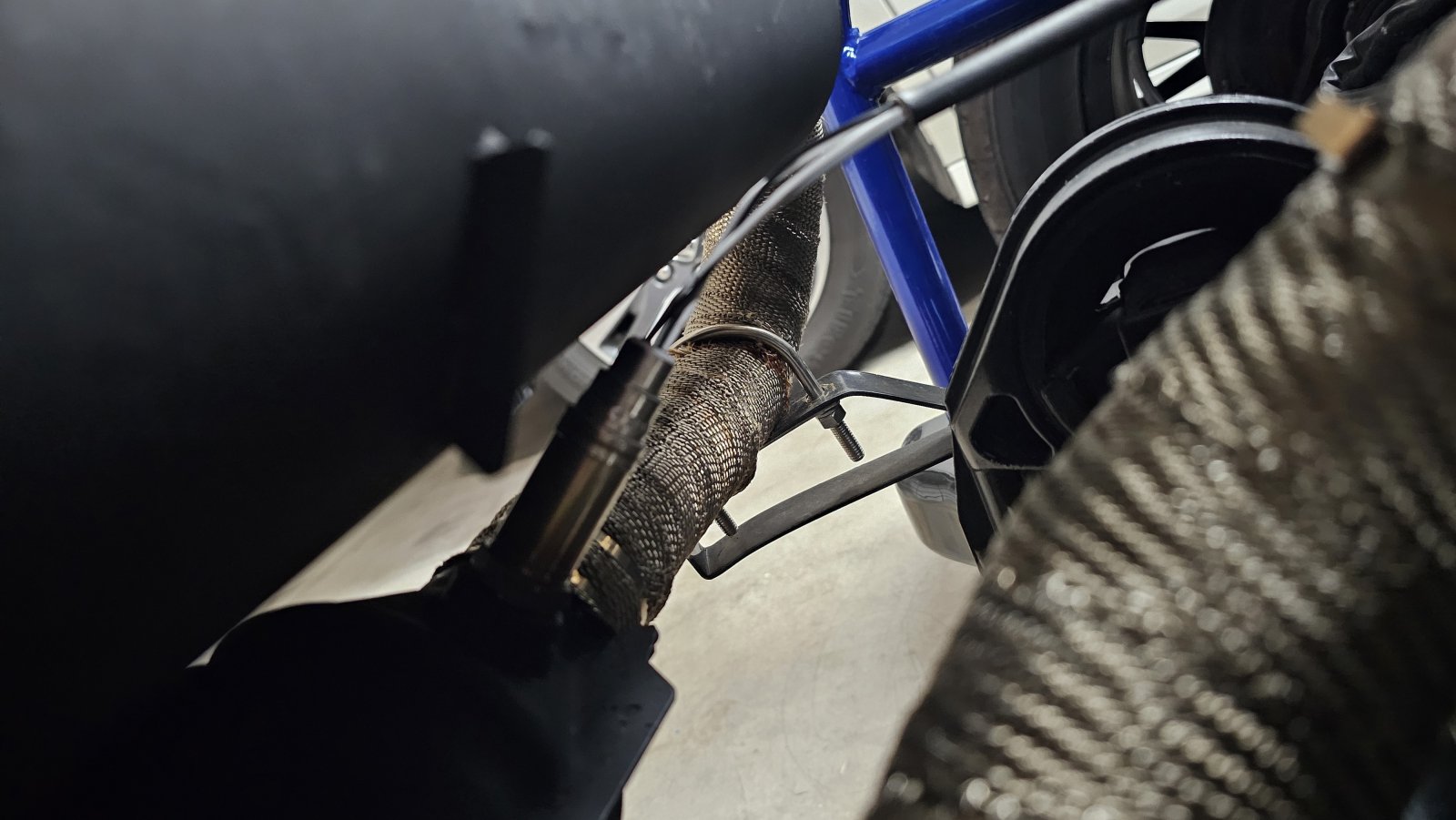

@Joebob I have 2 O2 sensors installed. Both have 4 wires and seems to be similar. One is directly after the engine, one is behind the catalytic converter. Is that standard for this 2.2L ?

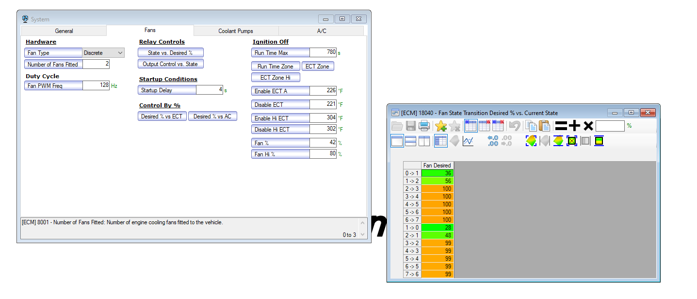

Yes I do know. The 0->1 transition will occur at 36. So 0->1 is from fan off to fan on transistion. The 36 is in the "Fan Desired % vs ECT" table. In my link in post #52 above, you can look up 36 in my picture, and it would be about 212F of Engine Coolant Temperature (ECT).
Your 1->0 transition is at 28, which is about 208F. (Follow the purple lines in my picture)
M
Ahh, now I understand. The other table, which is not on my picture above matches the number from fan desired to temperature. I have to check what 36 might be in my tune.

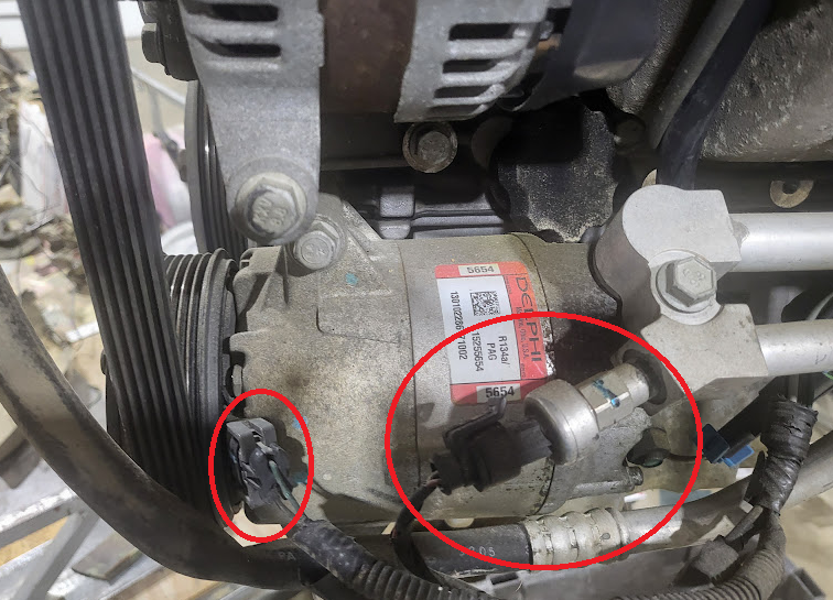

After reading tons of posts in several forums, I believe fan is triggered by not having an A/C pressure sensor.
My first question: Who is everyone else dealing with that? I believe it should happen to everyone removing the A/C.
Is it possible to disable the complete A/C in the ECU?
Next question: Since I have never build my car, I am lacking of all the information which control modules were removed and where the remaining modules where placed. In this post I found some information about the wiring of the A/C pressure sensor and was wondering where this module sits and if simply a few resistors would do the trick wo get a signal in the ECU. http://dfkitcar.com/forum/index.php?threads/ready-for-electric-water-pump-now.4276/post-85398

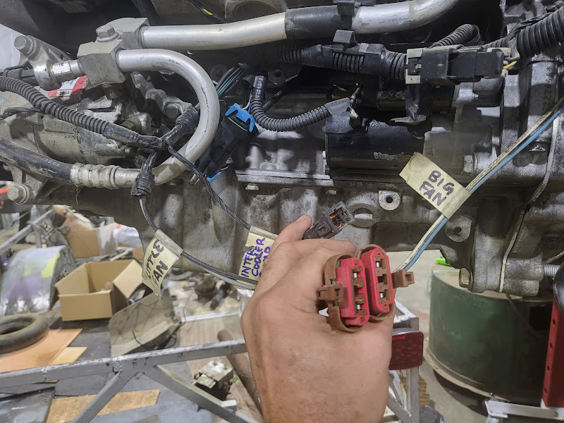

The Cobalt had 2 fans at the front radiator. The Goblin uses the one that is controlled by ECT (Engine Coolant Temperature).
I wonder if your car has the fan wired to the the AC fan 2, rather than engine fan 1.
My post #52 has blue lines for the ECT fan 1 settings in HP Tuners. The purple lines are for the AC fan.
Rather than tricking the AC pressure setting, I would wire your fan to fan 1, so it uses the ECT rather than the AC pressure sensor.
Here is the AC magnetic clutch and the AC pressure sensor.
42390
The 2 radiator fans have the same plug. The big fan is fan 1, the little fan is fan 2.
42391
