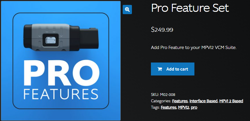

Anyone looking to upgrade to the PRO set for the stand alone data logging? Sounds appealing but if I want to log AFR, I still need my laptop for the USB connection. Unless I can use the analog of the AEM gauge. I need to look into that.
20008
P
If you get the pro features, you can plug the afr analog right into the little dongle they send you when you get the pro set I believe.
Edit: this little guy here https://www.hptuners.com/product/pro_link/
