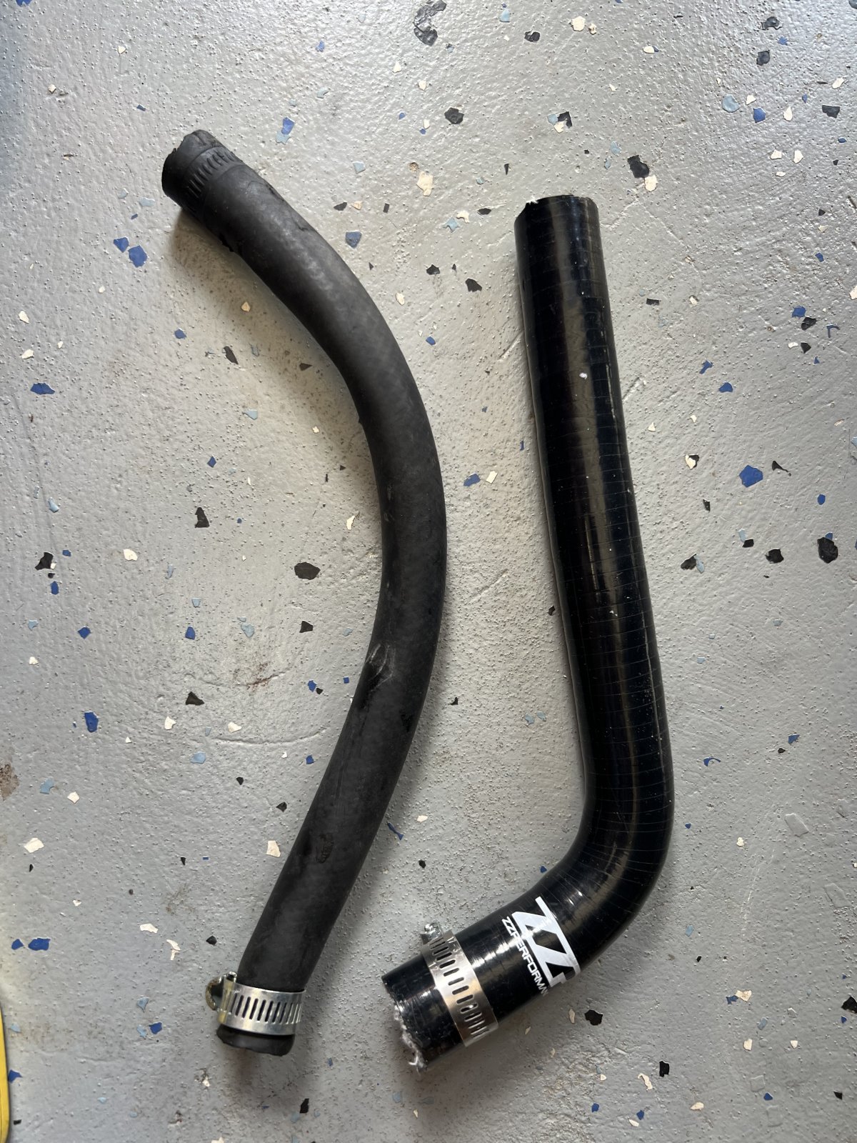

thanks. Still at 12 psi in under 10 minutes I think over 160 indicates an issue. I checked the pump and it’s wired correctly however I noticed the inlet looks a little kinked and slightly collapsed and almost certainly hampering flow somewhat so I’m going to reroute a bit and change the hose tomorrow and then see what happens. I would consider a water meth kit as a possibility later as well. Had one on my evo and it worked quite well.

changed the hose that was collapsing and then from cold with the fan for the cooler on left it idling for about 25 minutes and temps slowly climbed to about 140. Never even revved it. Again not sure what is considered normal but seems high considering the fan was on the whole time and not even driving. I’m lost as to what could be the issue. I don’t think I have any air in the system or at least not more than a few small bubbles here and there. The temp of the coolant remained pretty cool only towards the end could I detect any real warmth after putting my finger into it inside the fill neck but it’s flowing fairly well and pump isn’t overly loud and is wired correctly. The cooler at the front also stayed cool to the touch and both the in and out rubbers connecting to it. Next step i guess is to take it for an actual drive where temps really matter and see. Makes me wonder if I have something hooked up wrong but went through all the diagrams etc I can find before and it seems to make sense. Will post up a video.

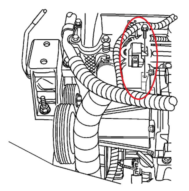

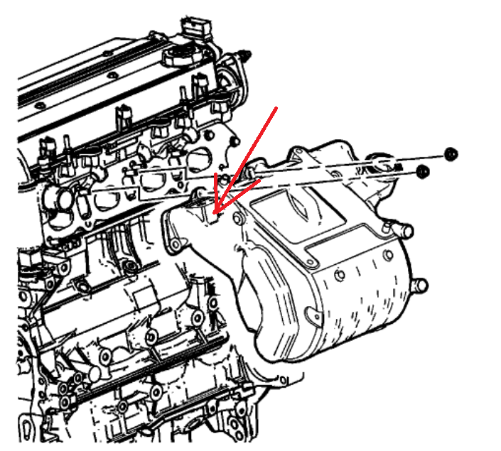

I wonder if your Intake Air Temp from your TMAP (Temperature & Manifold Absolute Pressure) sensor is working correctly.
38544
If you put your hand (or lazer temp gauge) on the intake, near the sensor, does the aluminum read 140F ?

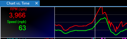

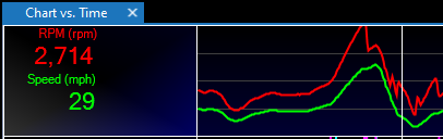

A couple of things to mention here. IAT2 temps aren't like coolant temps that we are all so used to. The IAT2 sensor is mounted inside the high up in the intake area, just outside of the path of the incoming air. This sensor tends to see a lot of heat soak from the engine. The only way to cool this sensor (and to see lower IATs) is to cool it with cool intake air. First, in your log, your intake air temps are 97 degrees, that's not going to cool much. Second, if you are at idle, there is the smallest amount of air possible going through the intake, therefor the smallest amount of IAT2 cooling. It's probably not going to see much cooling at all with the little amount of air coming in.
This is proven in your data log:
At this point in time, mostly-open throttle, you are getting the most air in and the IAT2 temps are fairly low at 127 degrees.
38546
Now just as soon as you chop the throttle, blocking the intake air, and the temps jump up from the lack of intake air, all the way to 149 degrees. No air, no cooling.
38547
The intercooler and HE are designed to cool the compressed air coming in, especially under boost. They won't do much for idle air. Also it cannot cool much closer than 20 degrees to ambient air temps. Again, it has to have air to cool, so you will only seen the cooling effect when the throttle is open. We watch ours using the Aeroforce Interceptor gauge and we can see the temps drop whenever opening the throttle and rising after closing the throttle. This is very normal. Just the opposite of conventional thinking about engine temps and load.
