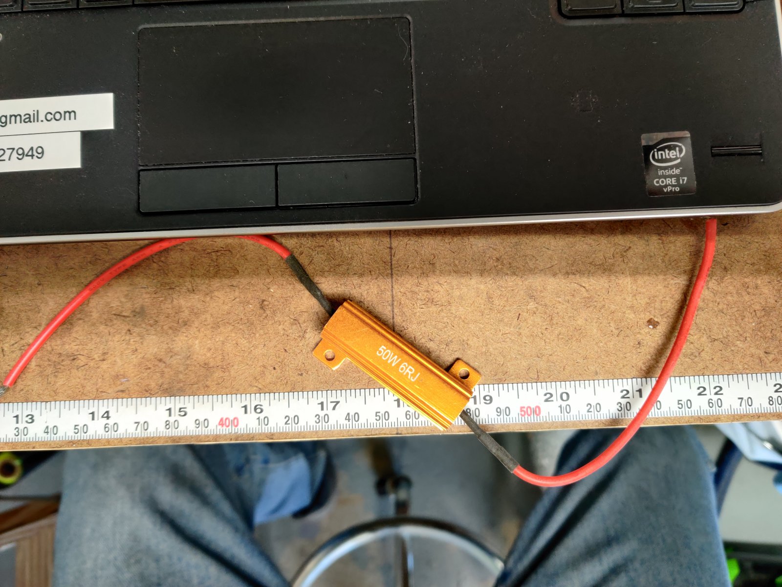

So has anyone else had any luck with installing the resistors for the turn flash speed? I have tried with no luck I get the same speed no mater what I try.
I understand the whole resistance being less with the LED but I do have incandescent turns next to my head lamps, I have the LED mirror turns, and the led STT in the back. Am I missing something? I have even tried 2 of the load resistors on each side with no luck.
Could you make/purchase a rheostat? That way you can tweak and see if there is a particular resistance where it stops. After that you could find a regular resistor of a similar value.
Karter2026
Yep, that should have done it? Did the resistor get hot?
It slowly got warm not hot. I even put a 1157 bulb in line with the resistor still the same speed. it did get hot with this. No change in flash speed.

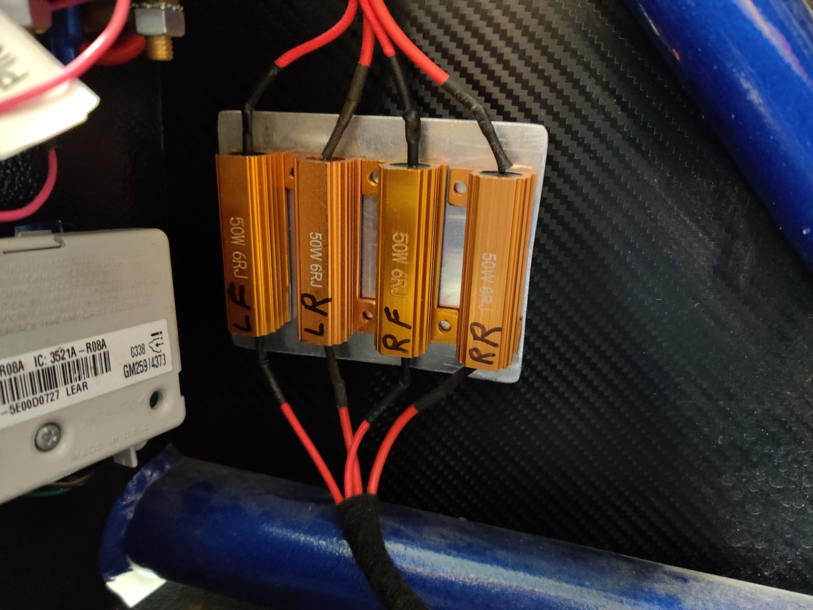

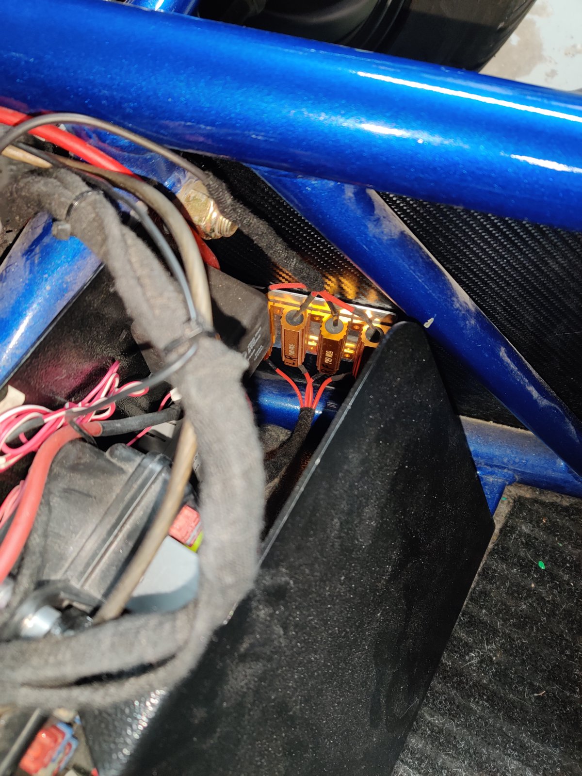

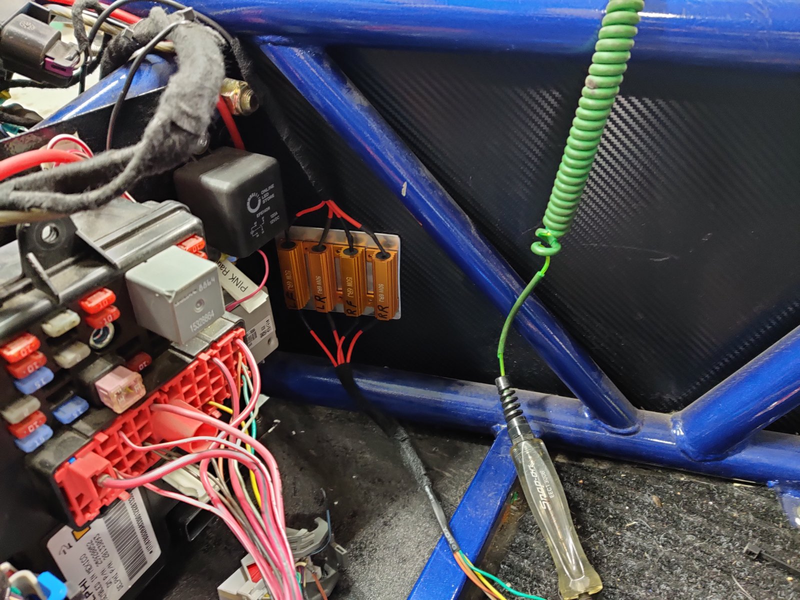

More progress during the stay home order. Here is a bit of a update on the hyper flash issue. A fellow builder shared his solution with me. This worked out pretty good for a location and not having to hide the resistors at each corner.
I ran the ground out to the stud on the side of the battery box.
The LR and RR lights come out of X3 on the red BCM plug. I used about 10-12" of wire total from the resistor.
The LF and RF lights come out of X1 on the BCM (plug under the red one) on this I used 12-14" of wire to the resistor. Some 3M VHB tape to attach the resistors to the aluminum plate and used the same to attach it to the side panel.
All tucked in behind the kick plate.

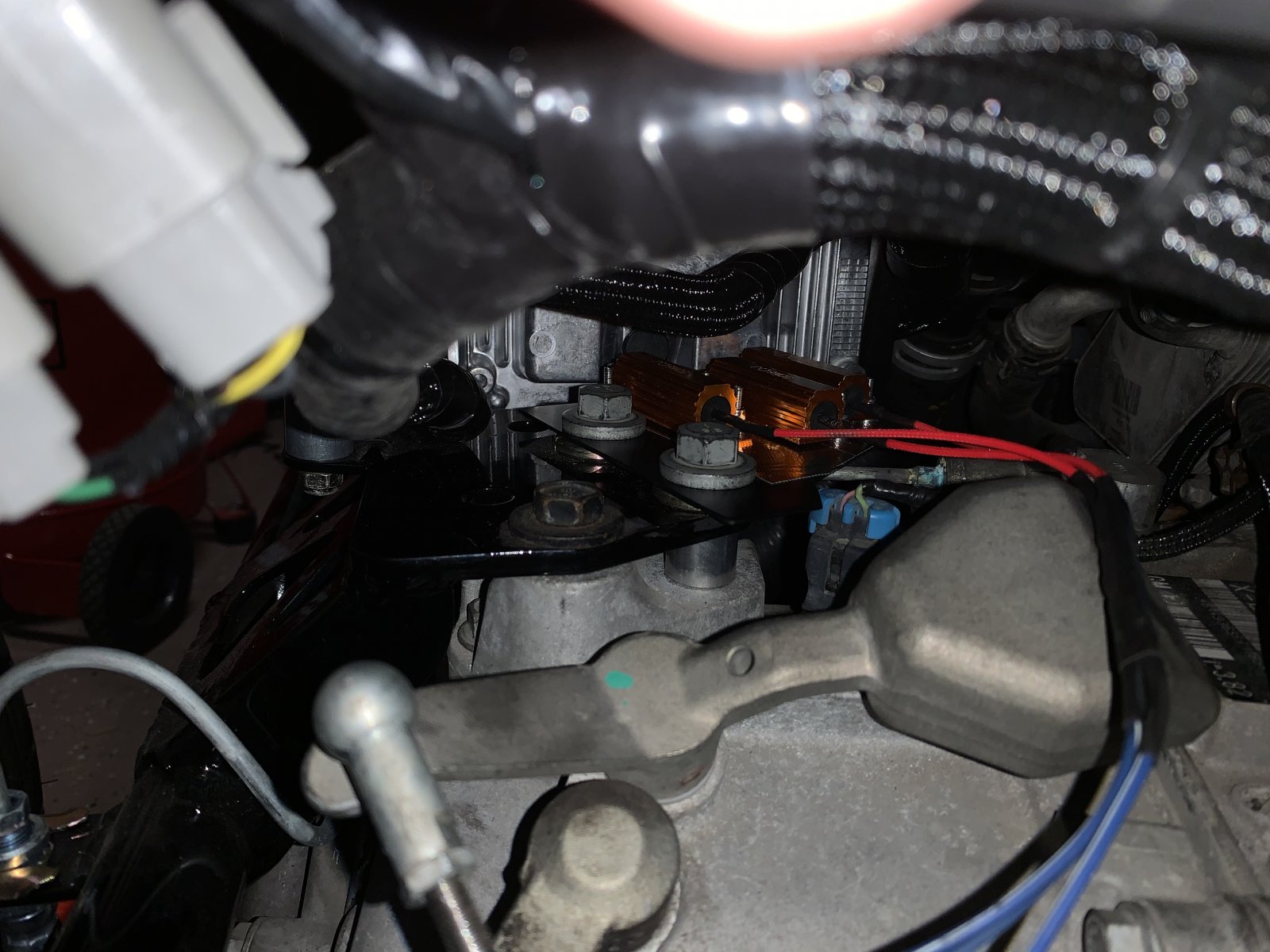

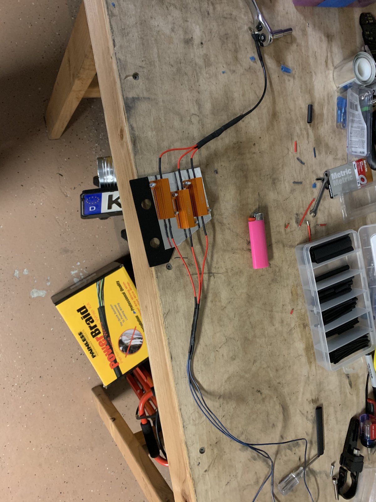

I used the same resistors for my hyperflash and wired them directly into the turn signal wires at the back of my Goblin. Only used two for the taillights. Hopefully they work for you.
