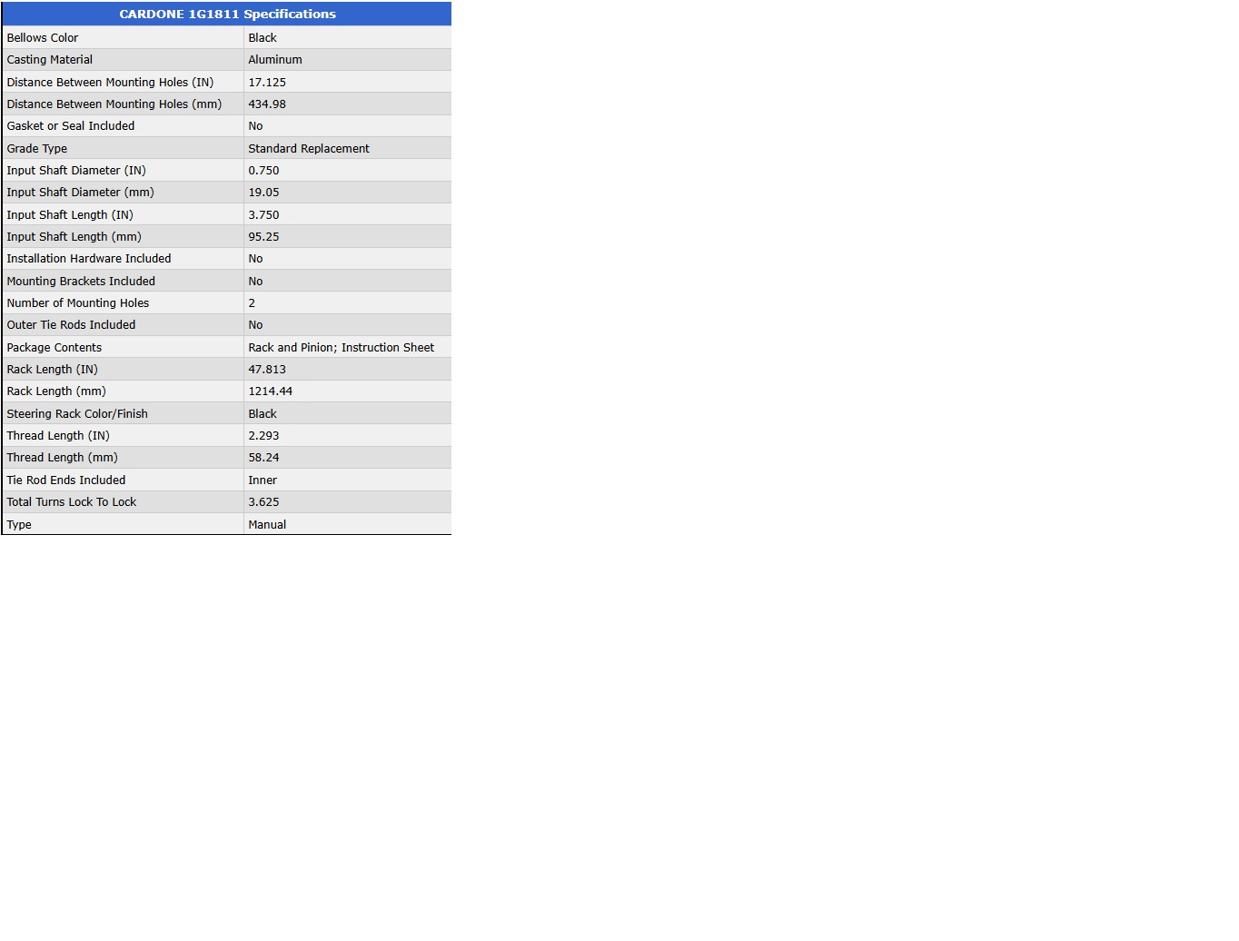

Here is the info I have been looking at.
The FE1 shows to be the +3
and the FE3&5 shows to be -3

So the LE1 rack is 3.625 lock to lock and has about 5 inches of travel. I'm going to bolt it down and get a more precise measurement this weekend along with the alignment on the car.
