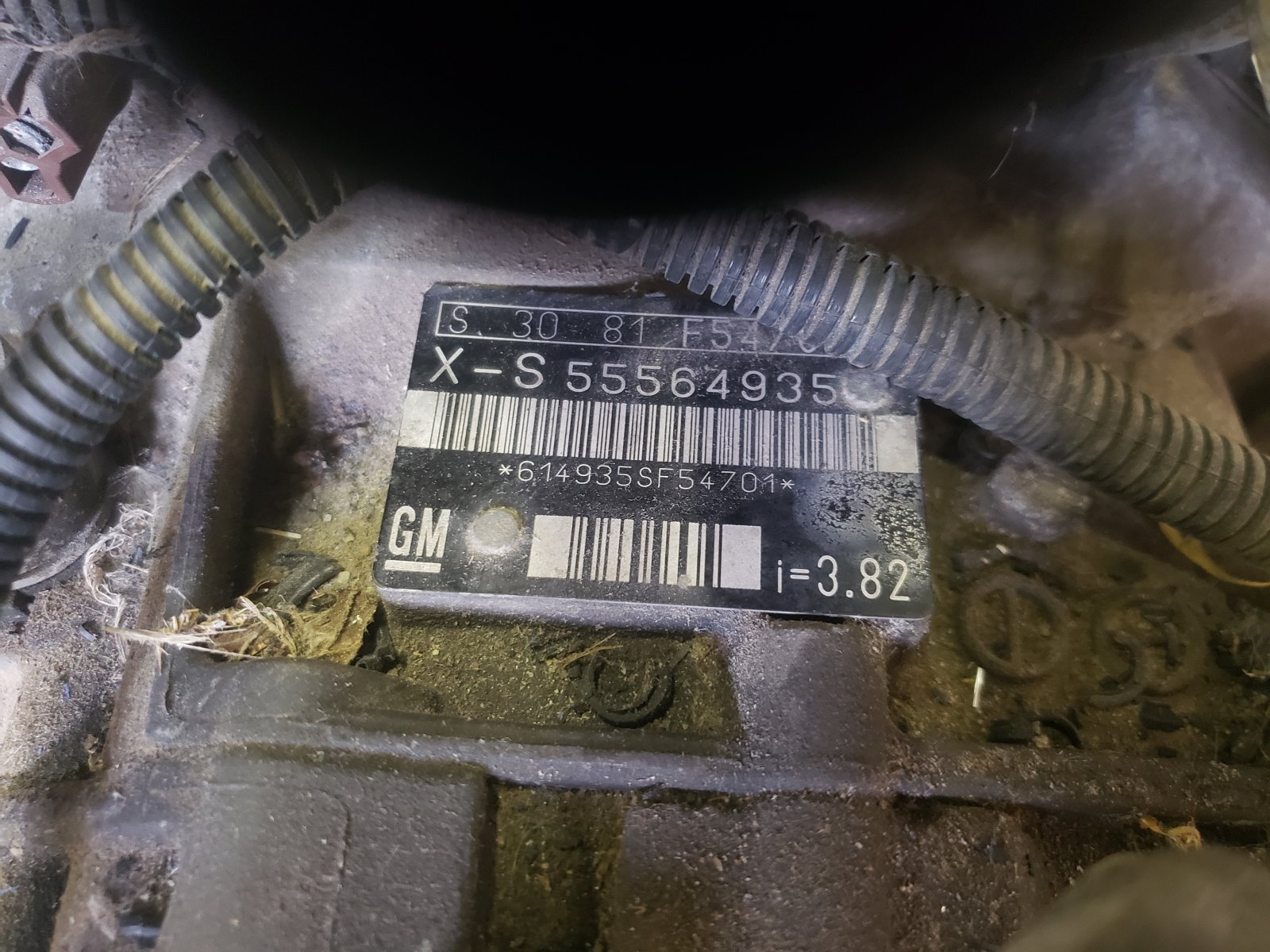

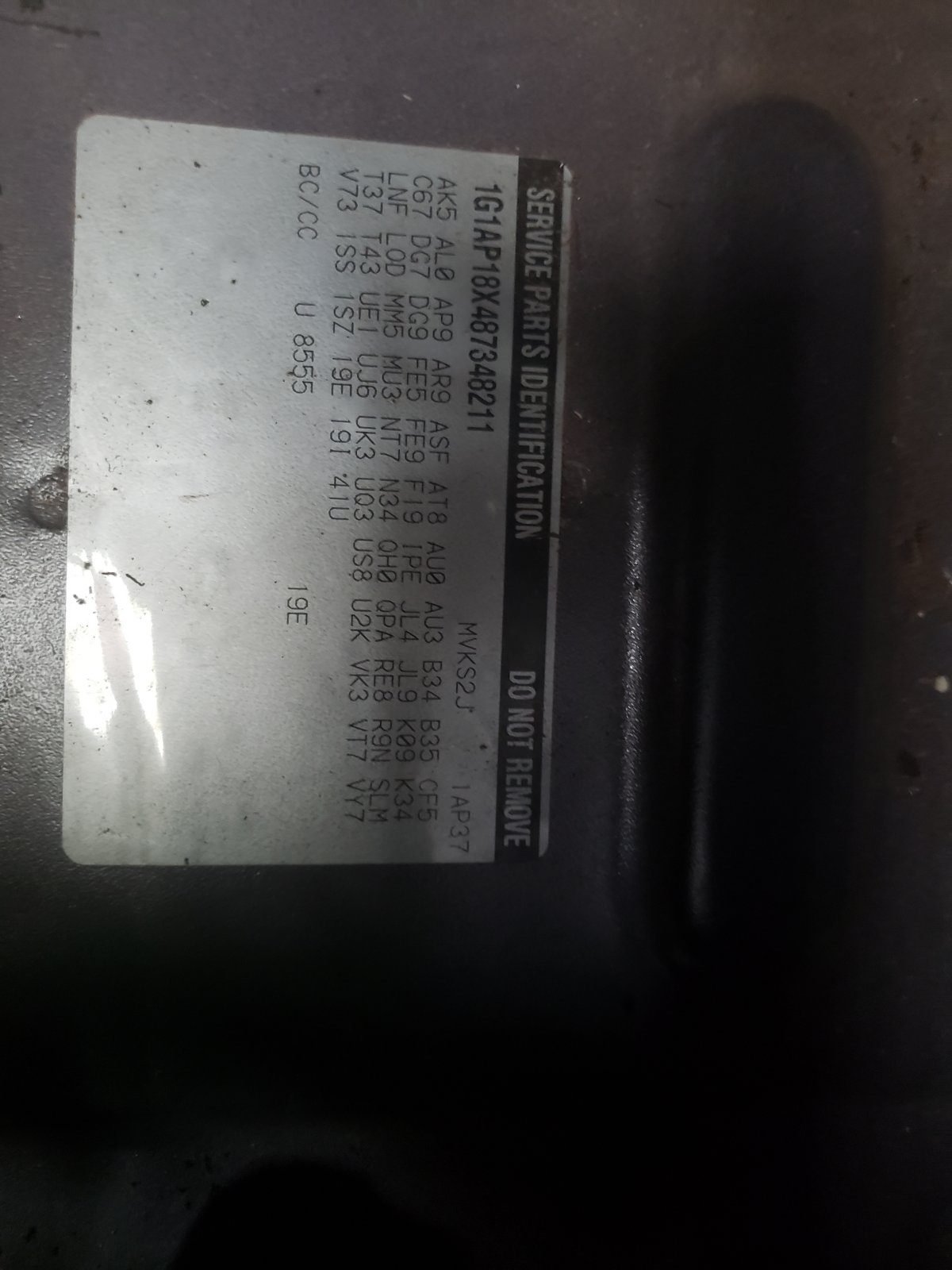

ok so OLDB1 and i have turbo (SS) car we just disassembled for our Goblin build (#109) pretty sure it is a F35- based on the reading of many would be sites it appears to be very voodoo like to be conclusive. before i order the billet shifter i really would like to KNOW vs THINK. these are the tags from our designated donor:
43427
43428
i think this means final drive ratio is a 3.82 and no limited slip expected.

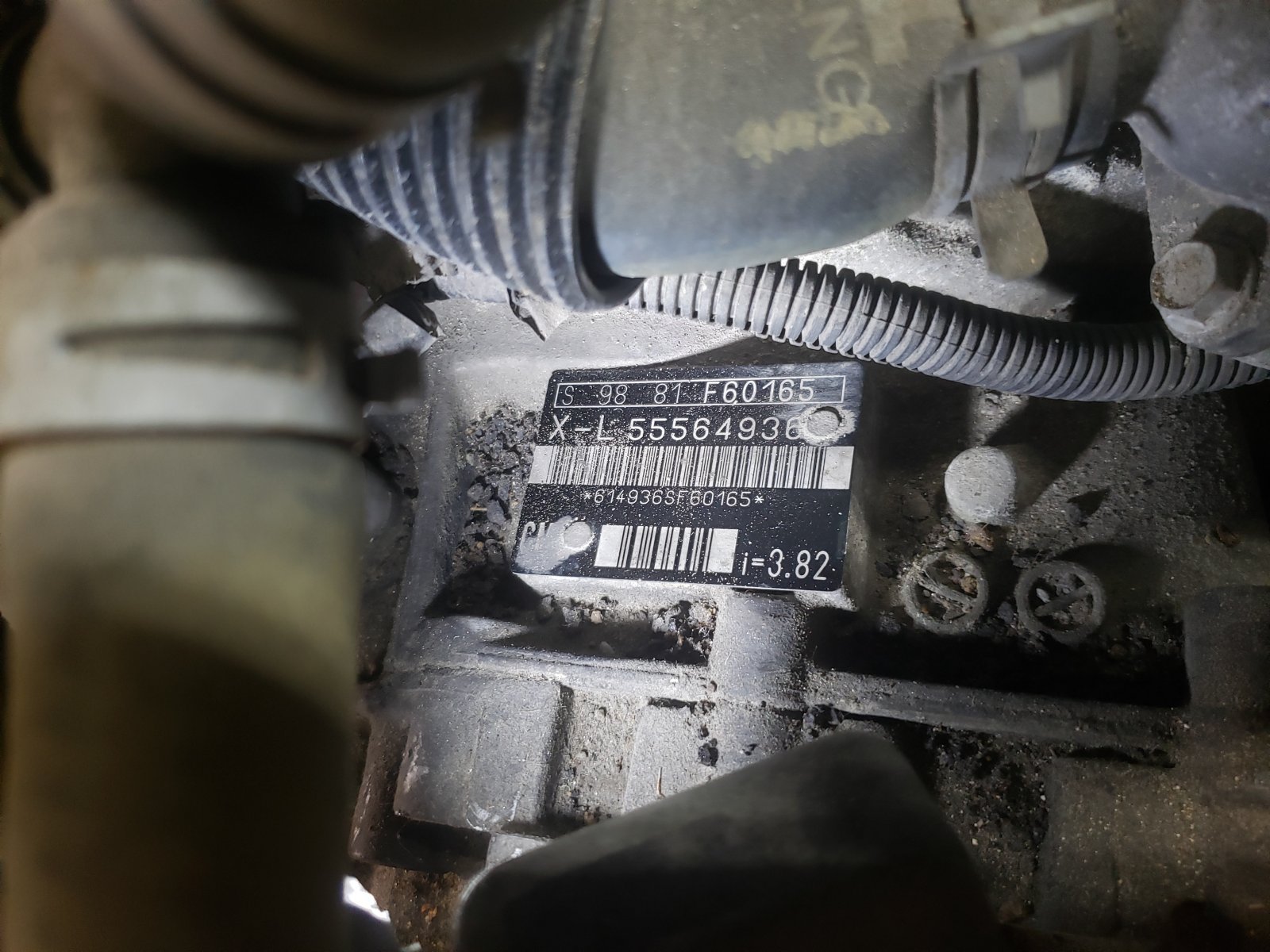

we also have a LOOSE (wasn't in a car when we got it) supercharged engine/transmission combo and another LOOSE turbo engine/transmission combo but I dont remember the order i took the photos. . .
43430
This one i think says it has a limited slip and same final drive of 3.82

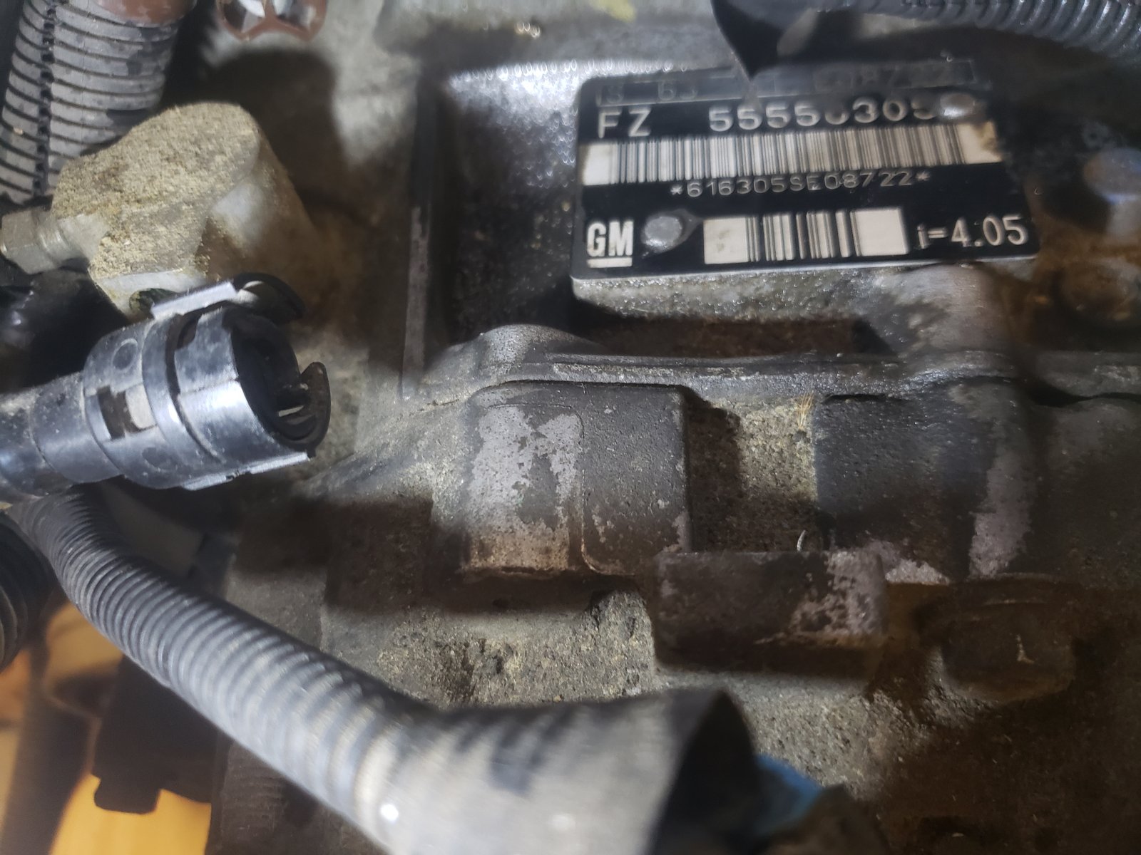

43431
and finally THIS one has no limited slip but a final drive of 4.05
have I deciphered these things correctly?

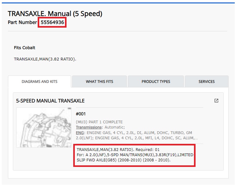

Yes, all transmissions list the final drive ratio on the tag and would also identify if the LSD is installed - it is not in any of these. The trunk tag confirms this with the MU3 code for the 5 speed manual, but no G85 code so no LSD.
You can tell the difference between LS and non-LS by looking through where the axle insert. One you can see through the other you can’t. But I don’t remember which is which. It’s discussed on here several times if you dig.
