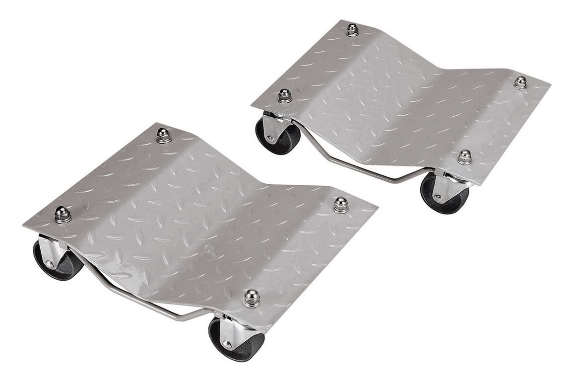

Buy these now, they are useful later. You will be taking the steering column out of the donor... that also will work, but not quick. Drilling the ignition is probably not going to work, as you need to get the lock pin out of the steering column, and if you don't know where it is, you are drilling in the dark.
32150
95Blitz
You can also use a floor jack to get it off the trailer or you can just disconnect the steering shaft from the rack then turn the wheels by hand with the car jack up in the front.
You should be able to remove the entire lock assembly since we have to do that anyway but it might be a slower process than you are looking for. Ross's idea is probably the best if the dollies will work for your trailer ramp situation. Another option would be to pull the wheels and brake loose the front tie rod ends and set the wheels straight but You probably need more people to keep the wheels going in the right direction.
