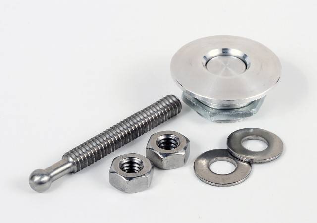

I had my hood nicely installed; but after a couple of speed bumps I seem to have lost the dzus fasteners at the front. What are some other options to mount the hood? Anyone try neodymium magnets or something else?
Frost
Google search 'Push button release latch'. These are bit expensive but worth it. Borrowed these pictures for reference...

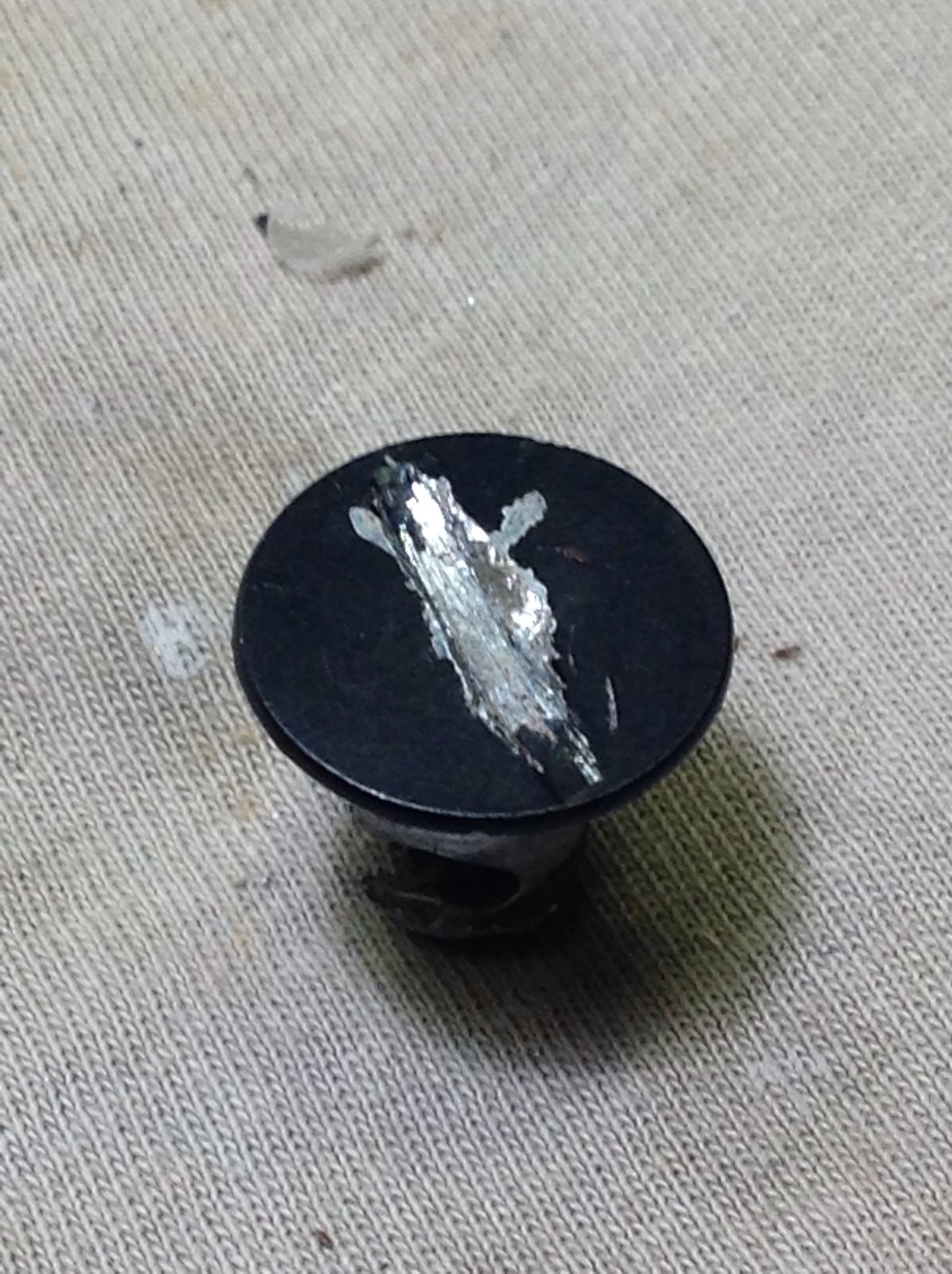

So, for those of us who have the DF supplied ones... how is an allen head any better/easier than a slotted head? Both need a tool. Wouldn't something that's big enough for you to wrap your meat hooks around work best? I like the idea of that button push thing but the pictures are super blurry and I can't tell whats going on.
I presume because the slotted ones from DF have a very wide slot that's also very shallow. Mine are a little beat up already and I've only attached the hood once!

You have to have a stubby flat head which is always that tool that's impossible to find. So by the time you find it you're all crabby and then you go to turn the fastener and end up stripping it because they might as well be made of crayons - you go into top tier rage level at this point. Every.time.
The allen-head experience is not like that. DF should use these as default
You have to have a stubby flat head which is always that tool that's impossible to find. So by the time you find it you're all crabby and then you go to turn the fastener and end up stripping it because they might as well be made of crayons. The allen-head experience is not like that. DF should use these as default
And the stubby is not really even the right tool but it's the only thing you have that's close. I even modified a sacrificial stubby to make it fit better but still not good enough to keep it from buggering it up.

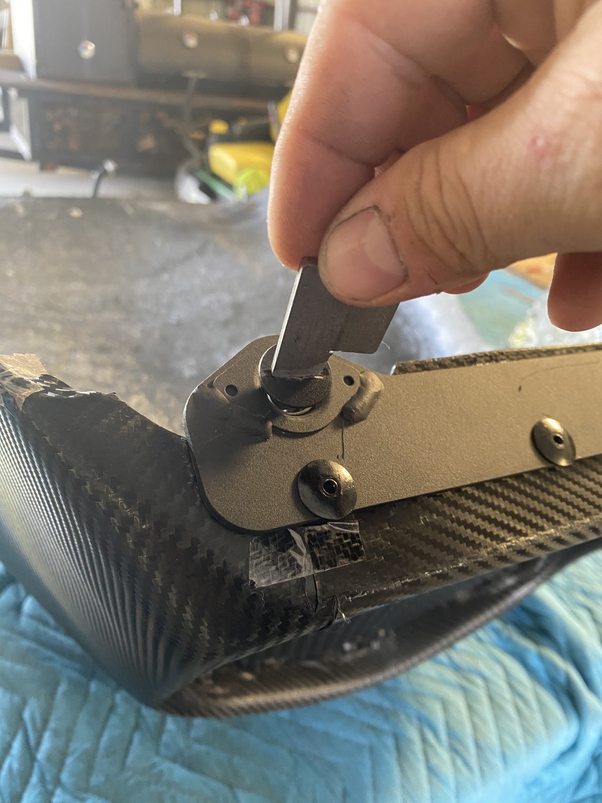

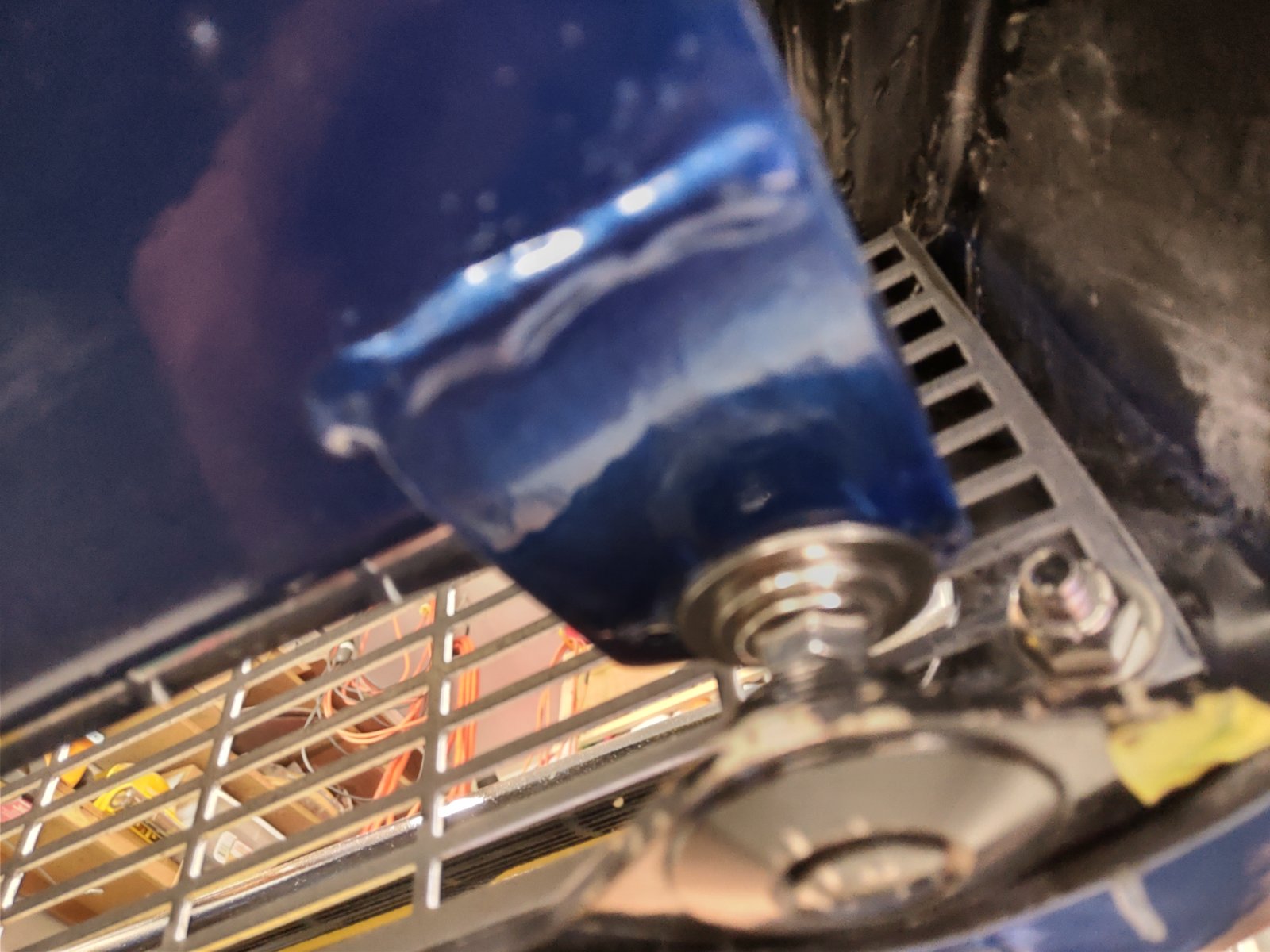

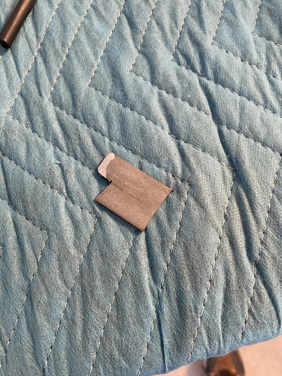

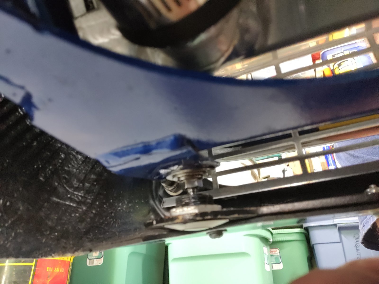

I ended up making a special tool for mine, to fit the fastener.
I also squeezed the spring mount thing so it was easier to lock the fastener in. Works easy now.
