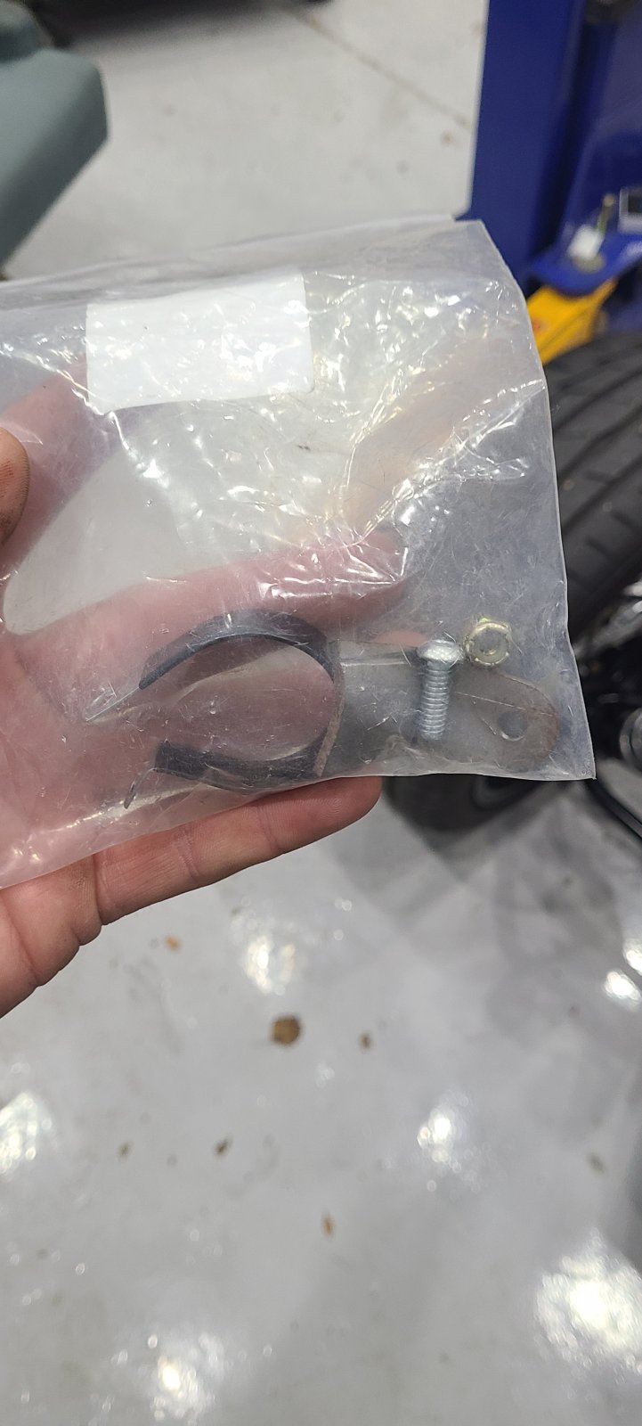

Hey peeps!! Longtime no post as life takes control haha. I ha e a question. The mounting hardware for the intake on a TC Goblin.... where does it go? Hah. I've had zip ties since now and I'm wanting to finish this bad boy. Moving to Vermont at the end of the month and wanting it to be complete for the departure. Thanks a ton.
Kenny123
This stuff

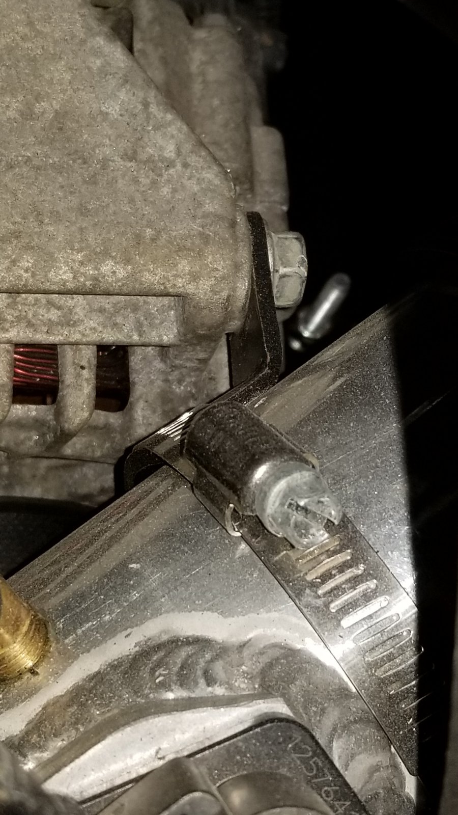

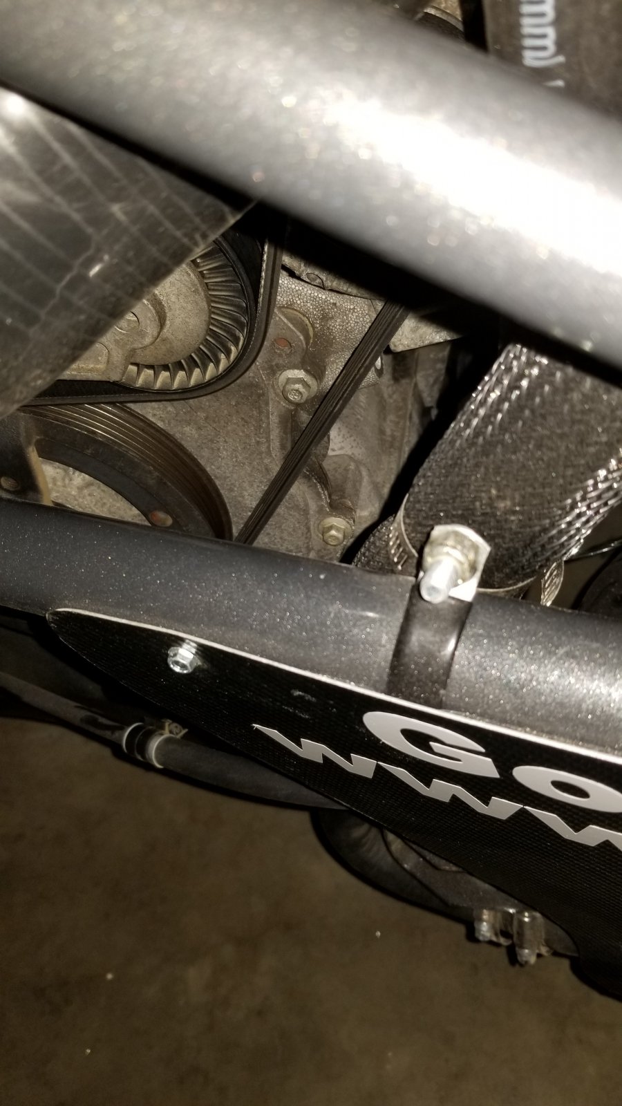

The contents of that baggie go in two different spots.
The metal bracket combines with a large hose clamp to secure one of the intake pipes.
The coated clamp, nut and bolt are to keep your coolant hose off your serpentine belt.
