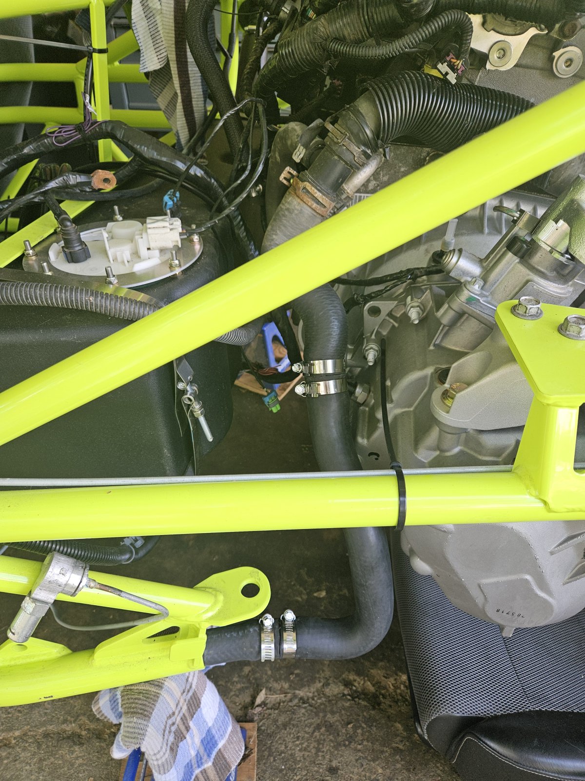

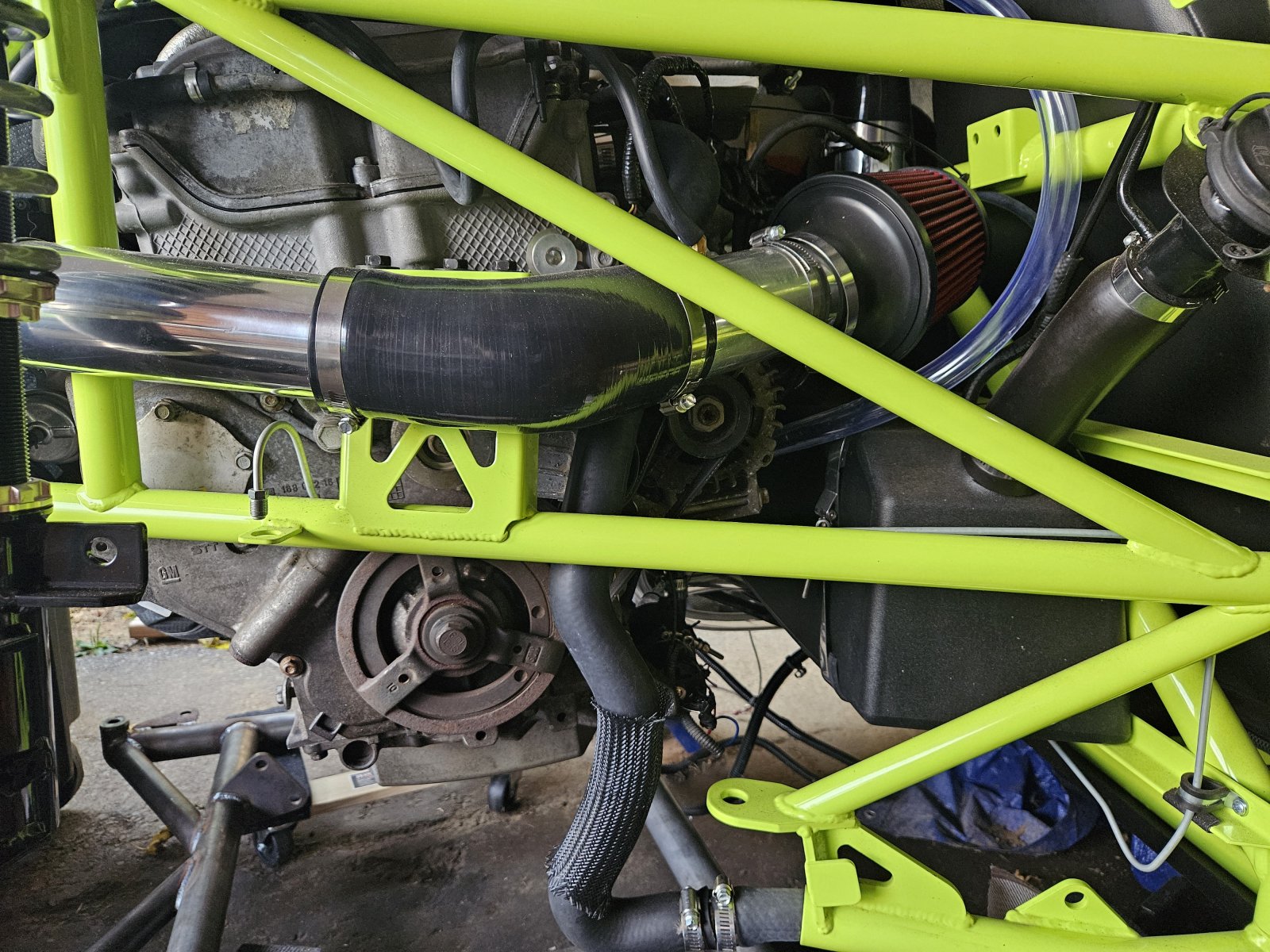

Page 20 and 21 have a couple shots of the passenger side.
Im searching for pictures with part numbers, but im not sure I can find ones.

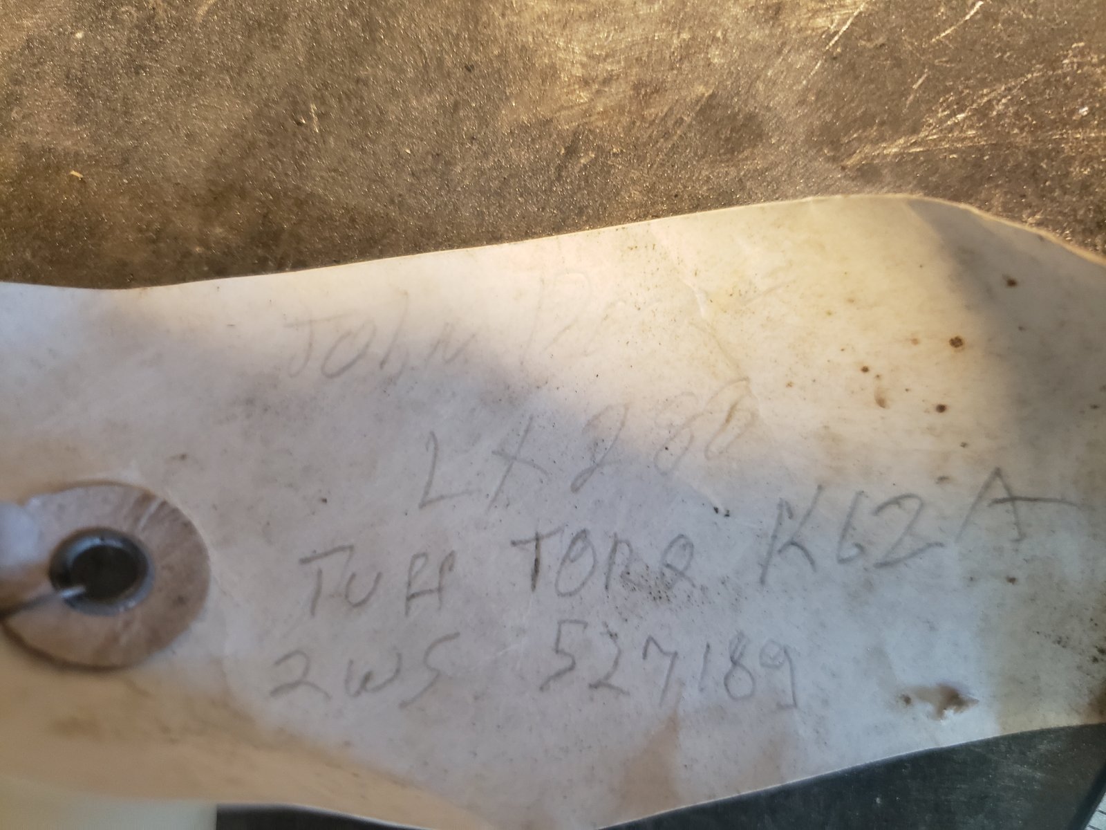

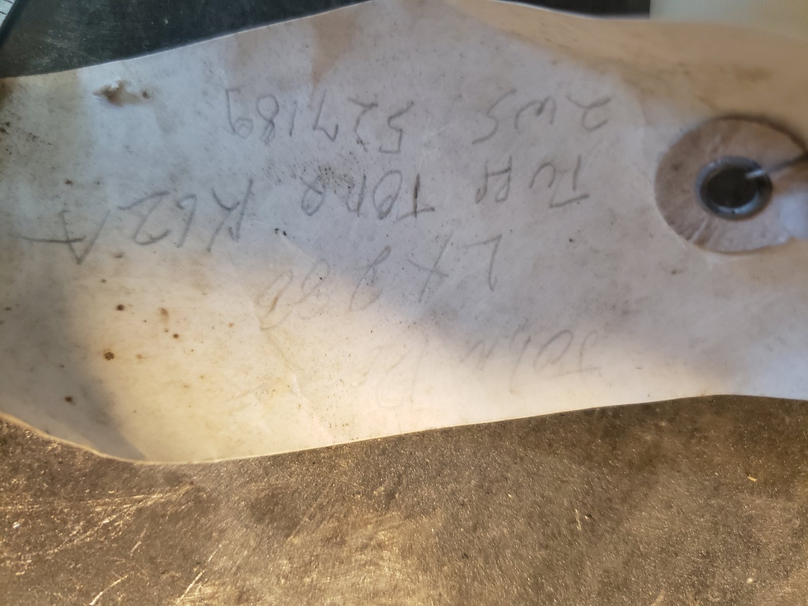

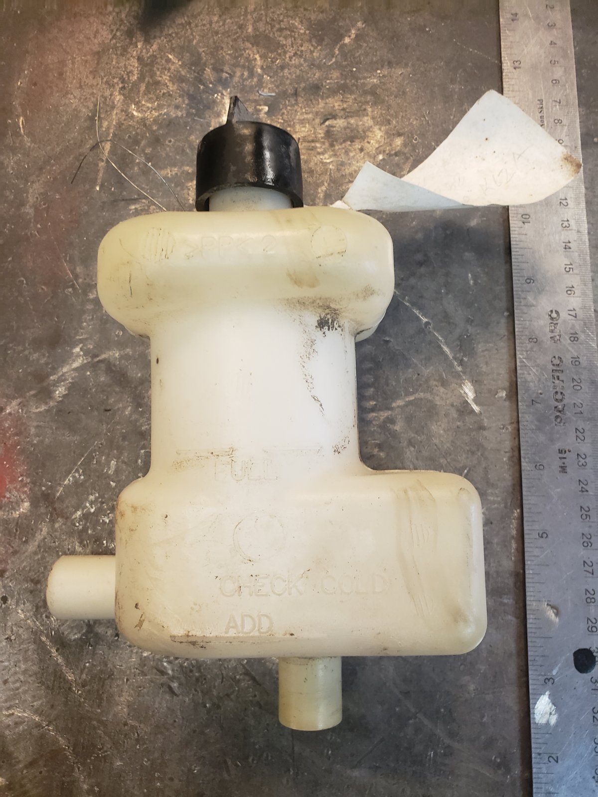

on the intercooler side of things. . . i found an interesting bottle/filler port. the tag is easier to read in the photo than in person. it is from some riding mower.

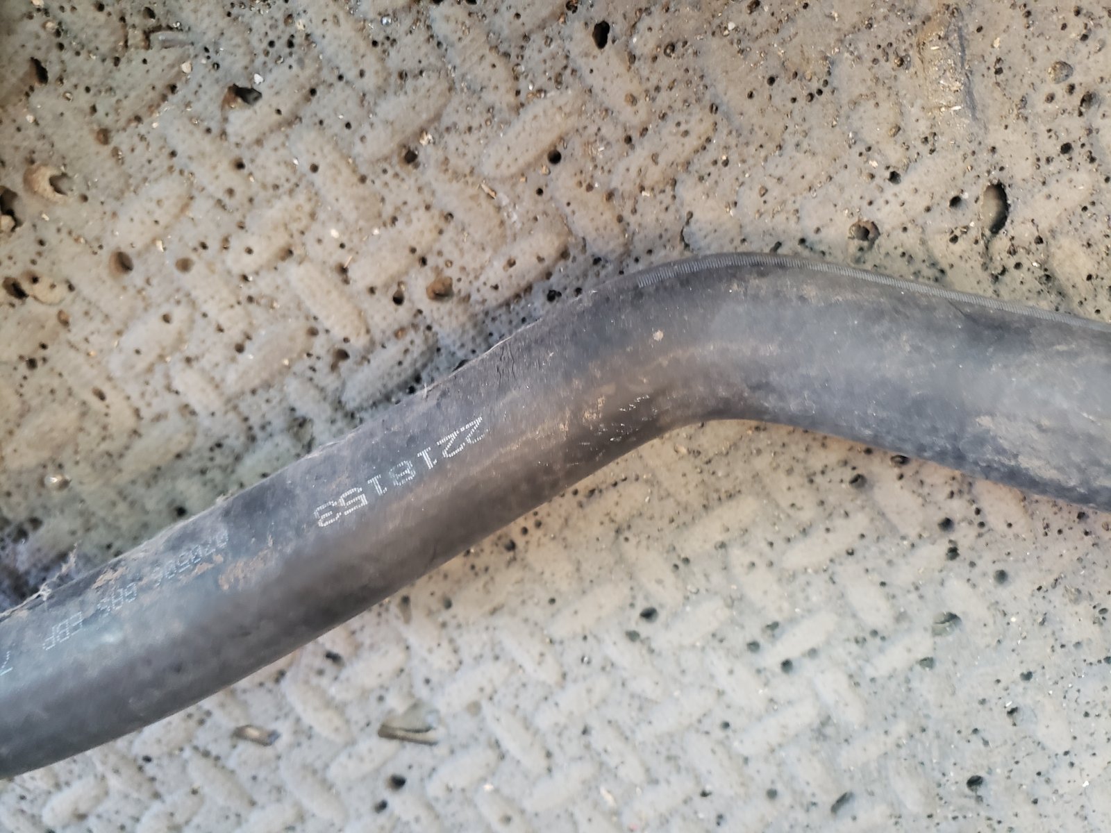

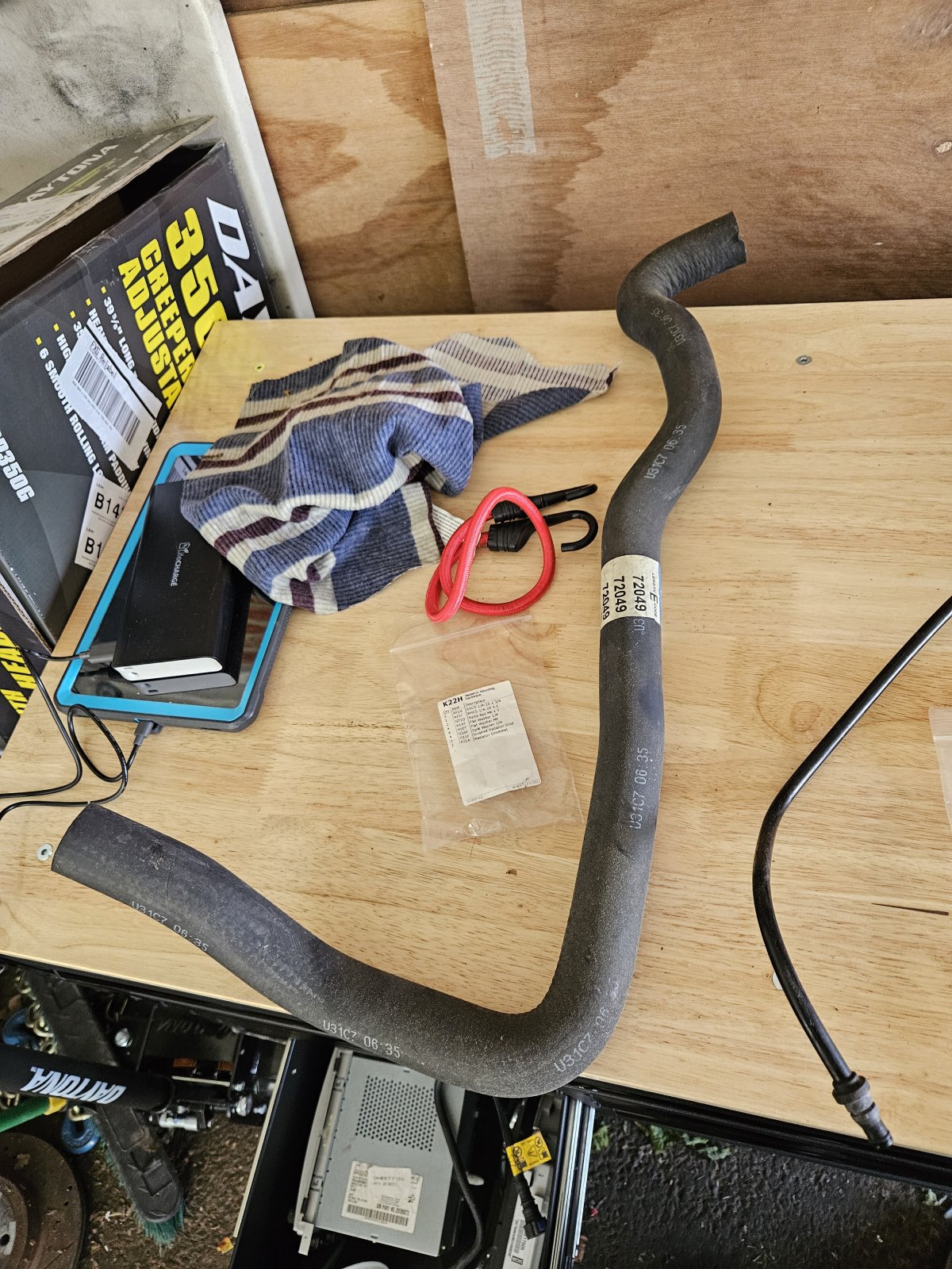

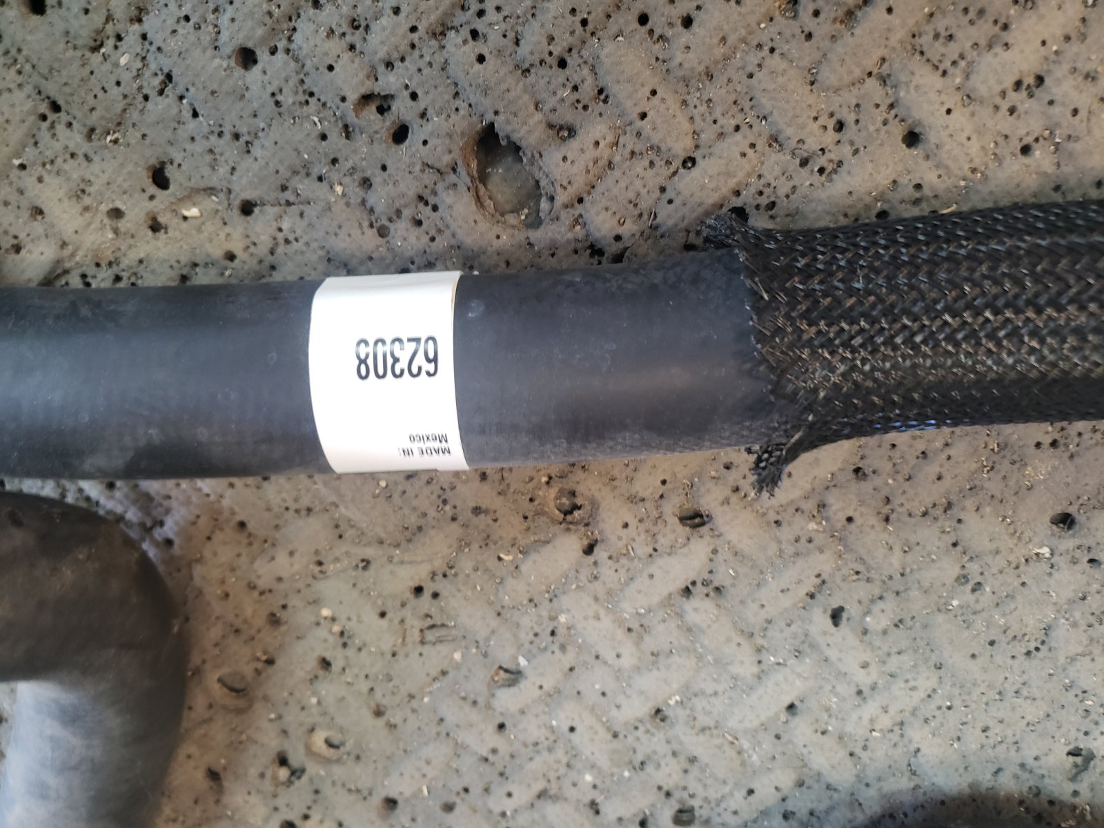

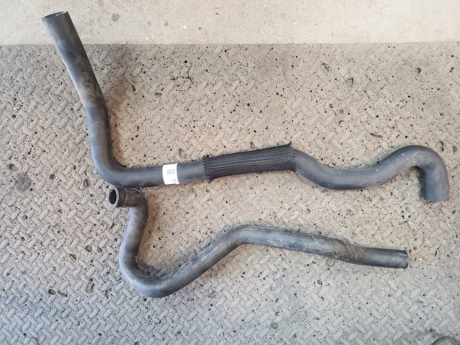

62308 - I could see this being the drivers side hose that mates up with the frame rail hose and goes upwards.

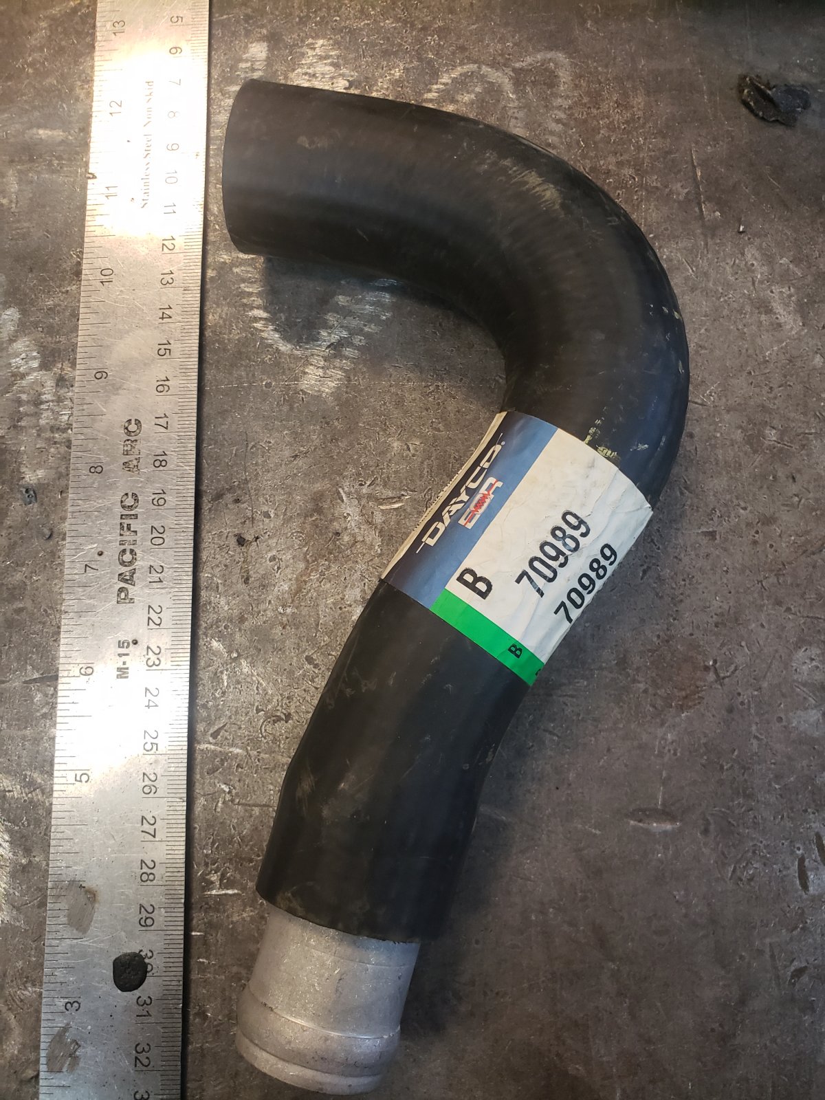

70989 - with the splice, that looks like it would attach to the passenger side of the front of the cylinder head and come down to meet the drivers side hose (72049 I posted) that meets with the frame rail on the passenger side
The tractor bottle could be used as an intercooler fill/expansion tank. Its a good looking piece for that.

S12CReplaced by S12E but can still be used driver side near engine.See S12E70989

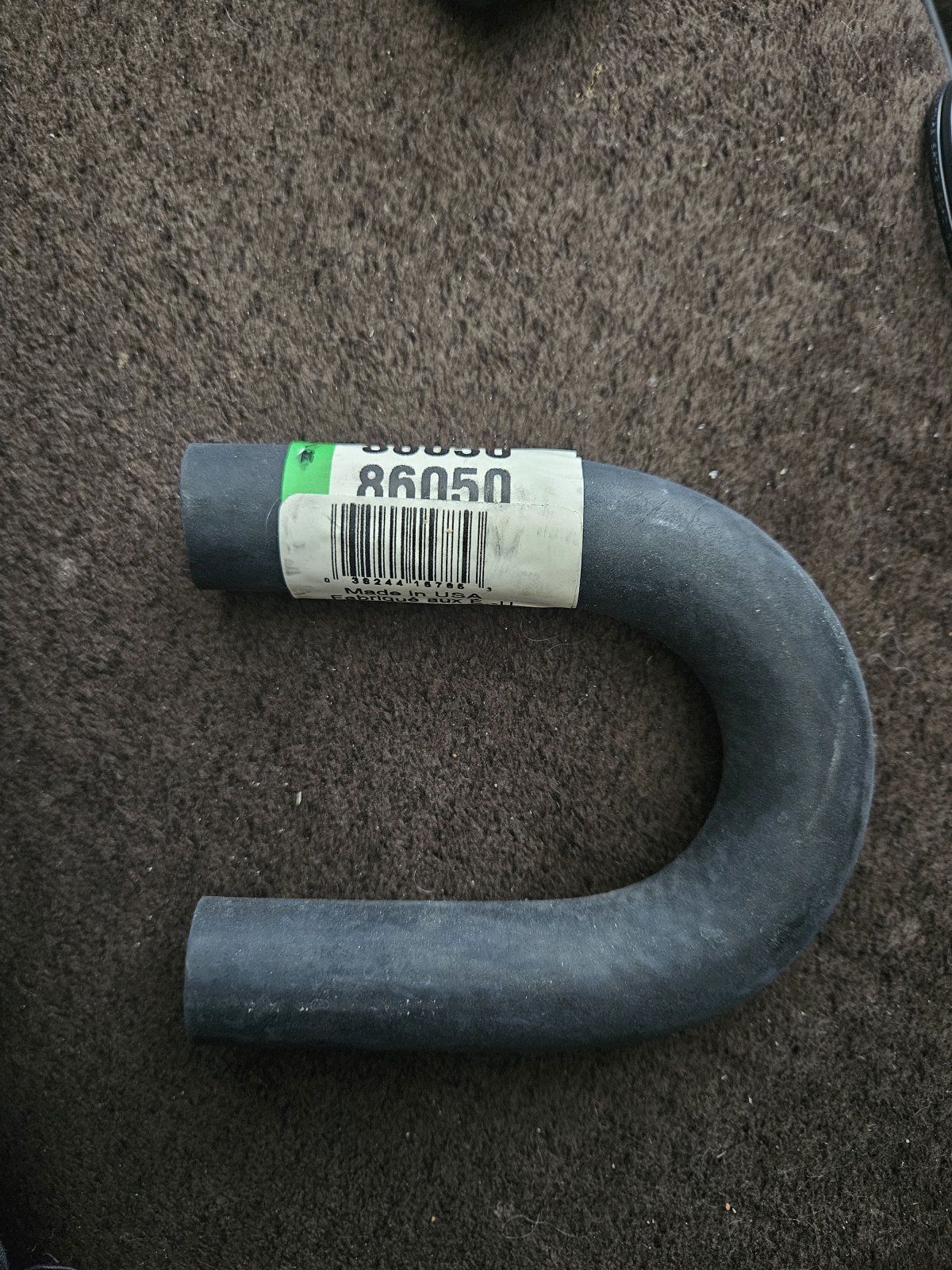

S12GU shaped hose for heater loopDF Goblin Assembly - Basic Engine Preparation - YouTube86050, 63020
