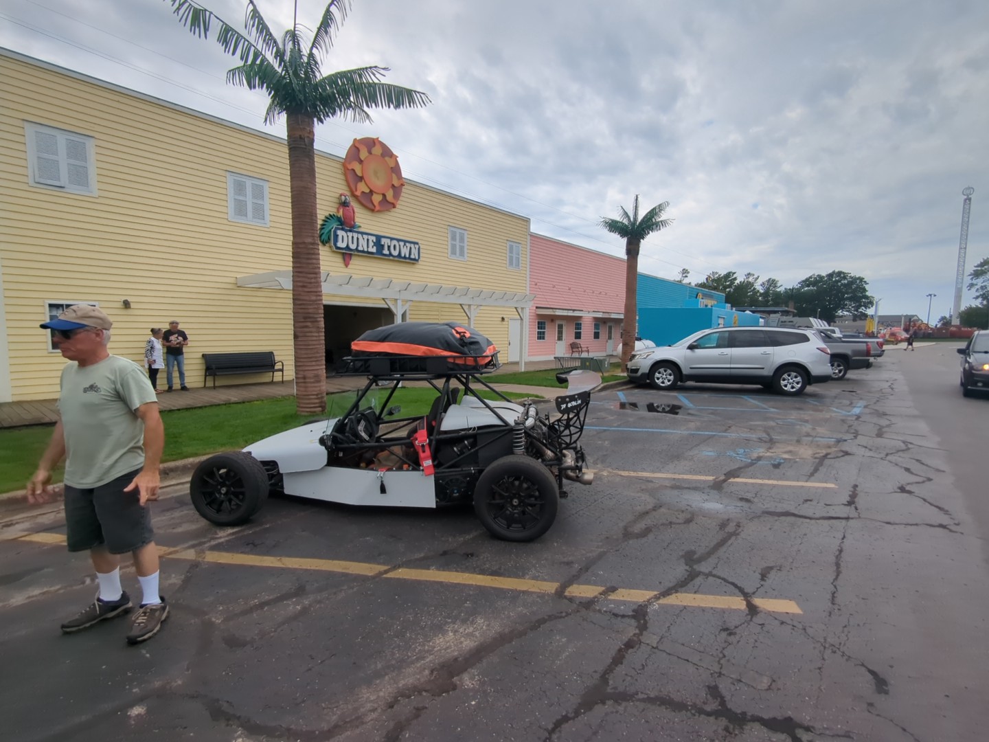

Day 2 Checkpoint 1

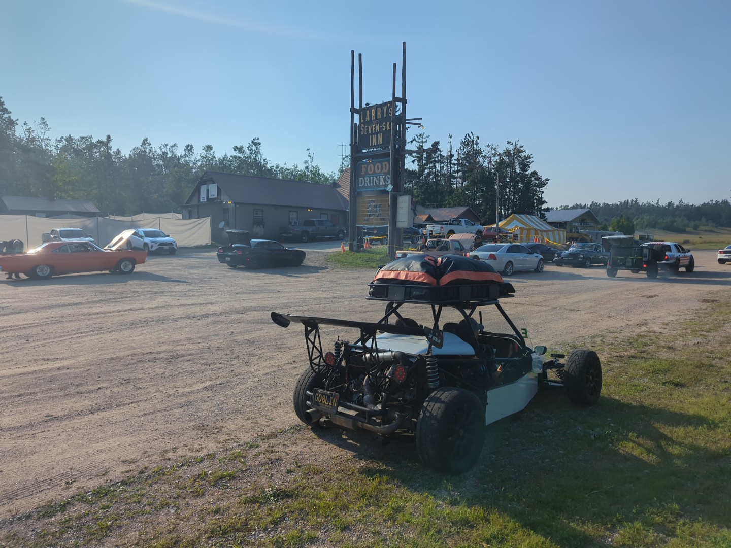

Day 2 Checkpoint 2

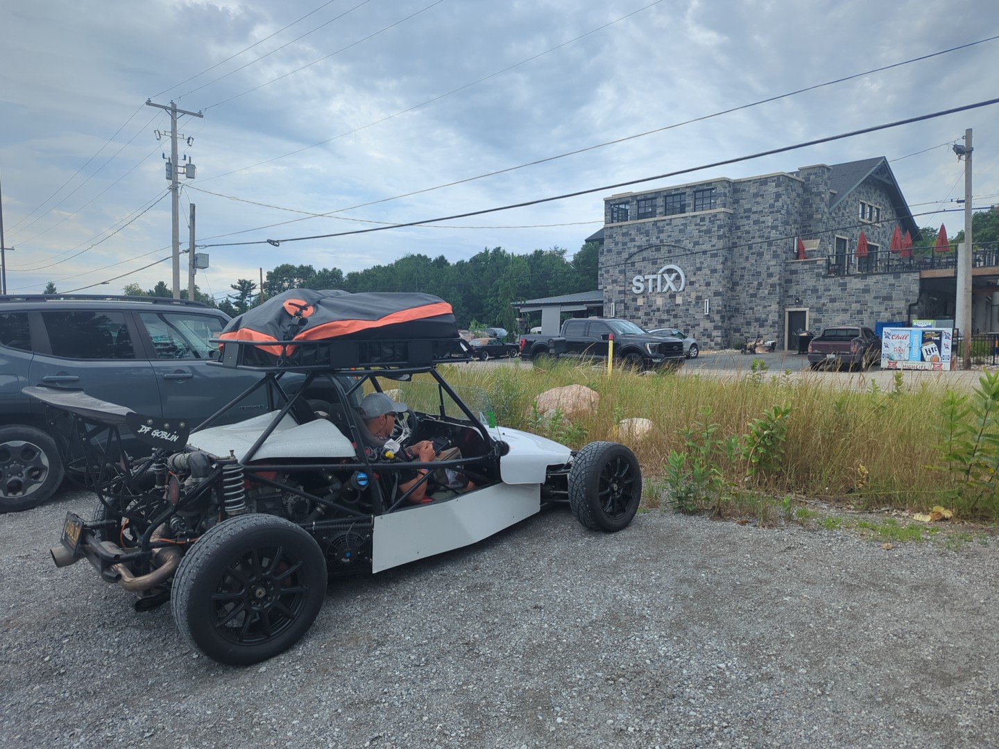

Day 2 Checkpoint 3

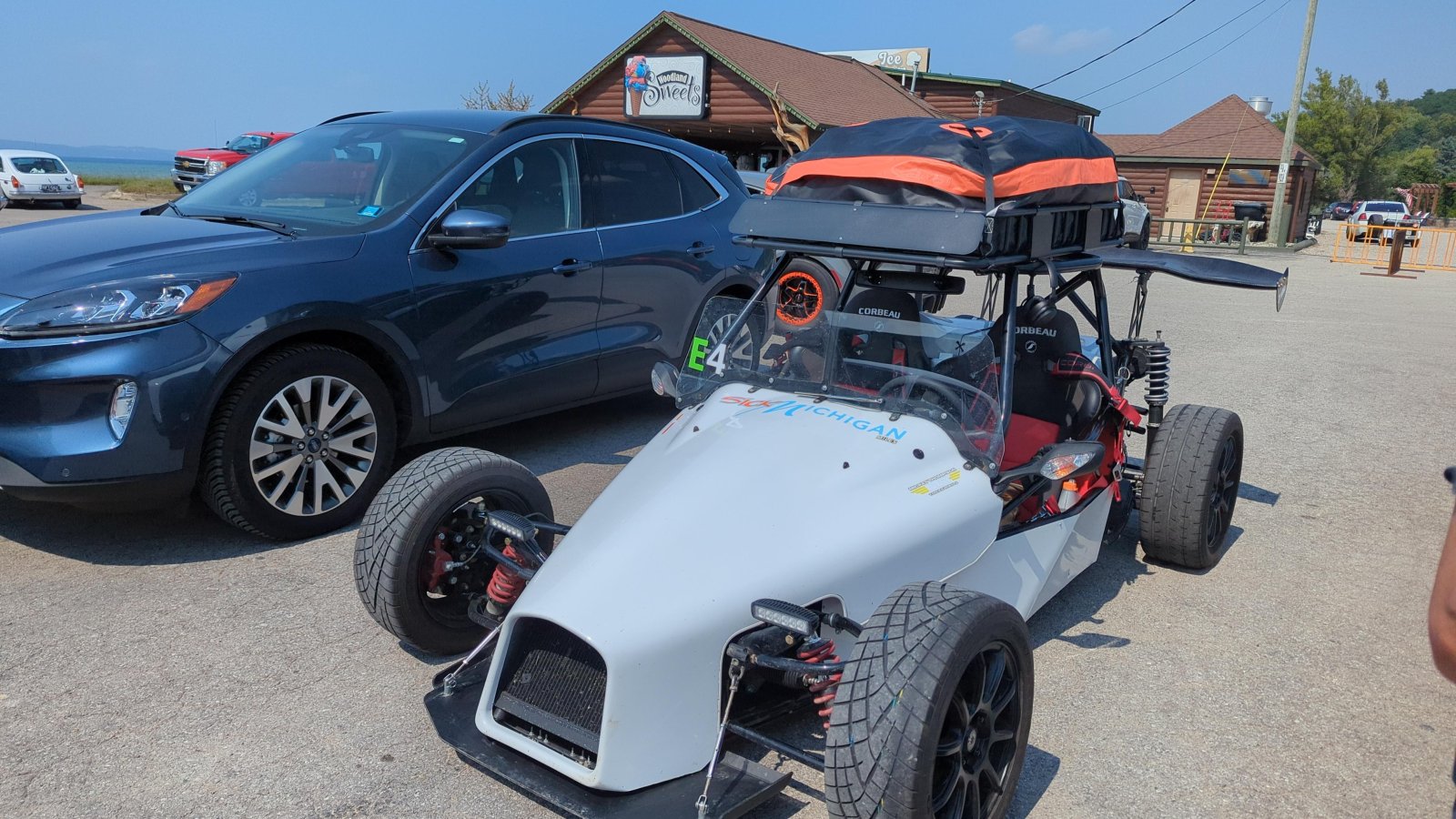

Bonus capture of the Mighty Mac. If you zoom waaaaaay in you can see the little Goblin

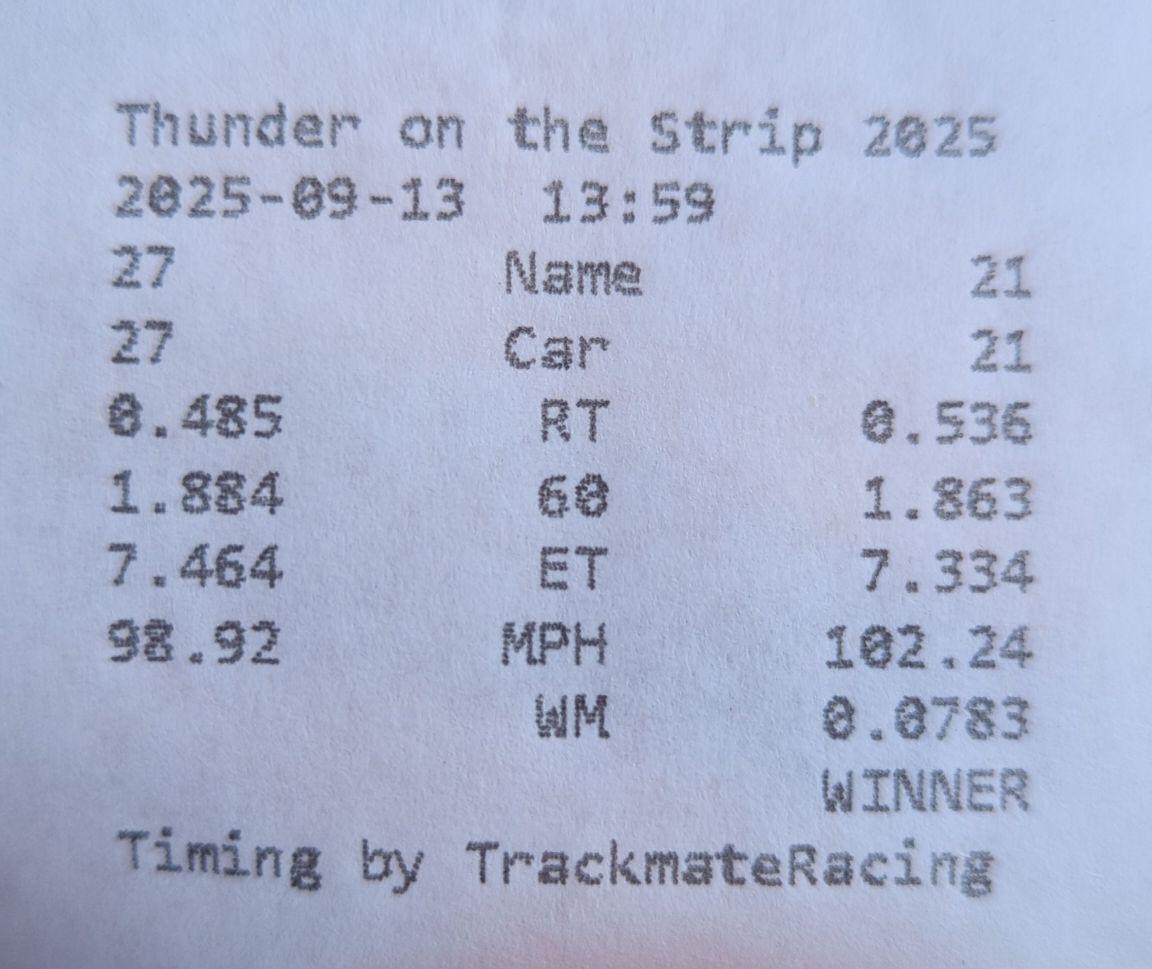

I'm 100% convinced this car is better no-prep now. I've always ran faster at Thunder on the Strip in Gladein, and this year was no exception. Ran faster than I did every day at Sick Michigan Miles, and I was just using my street tires!

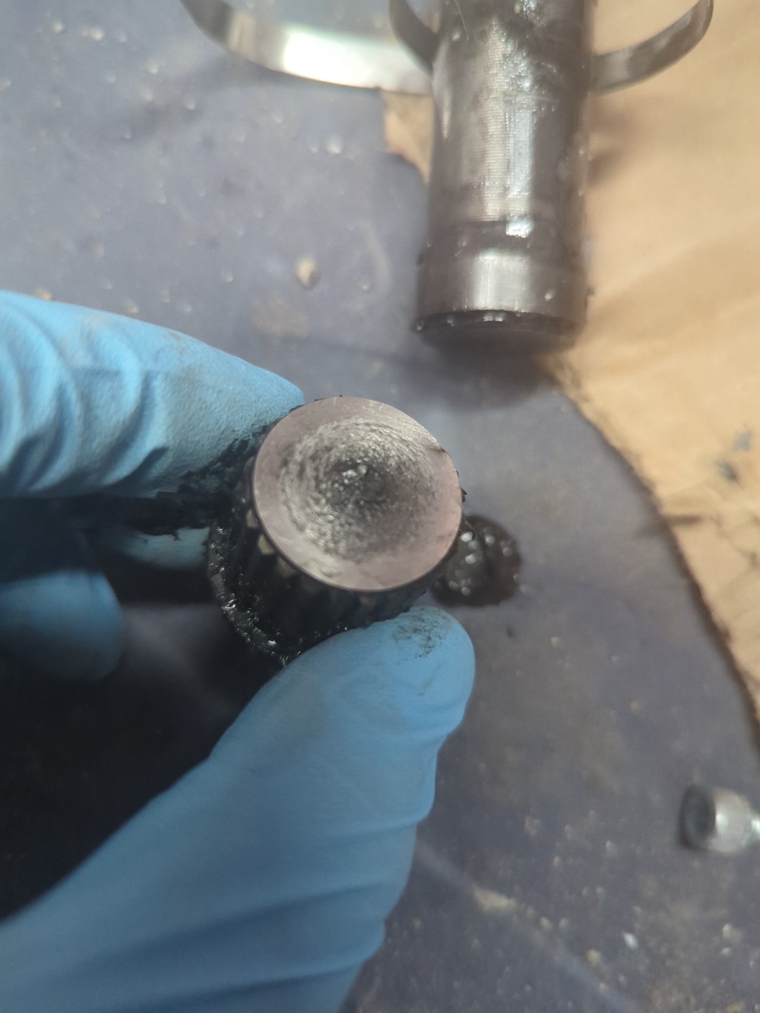

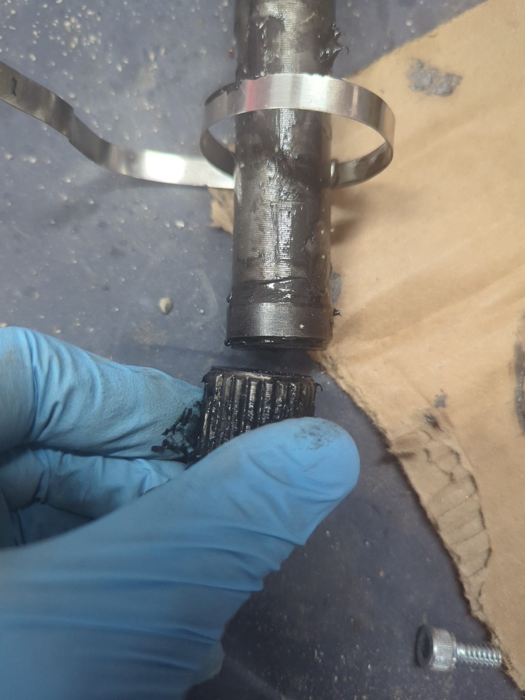

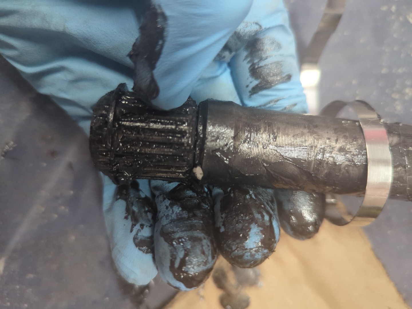

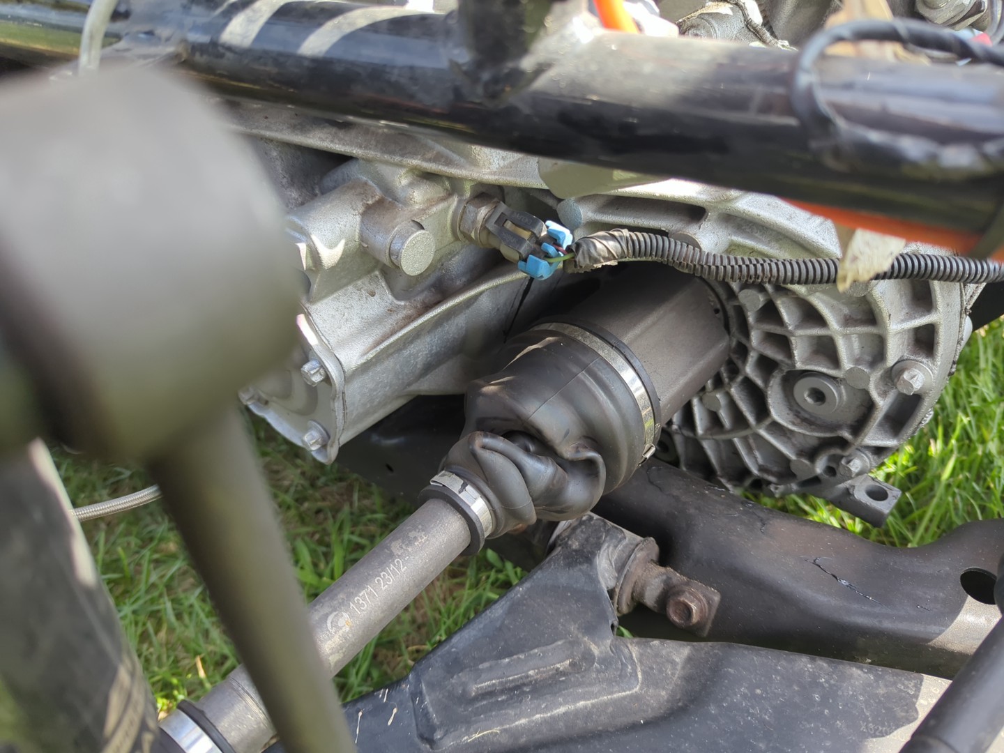

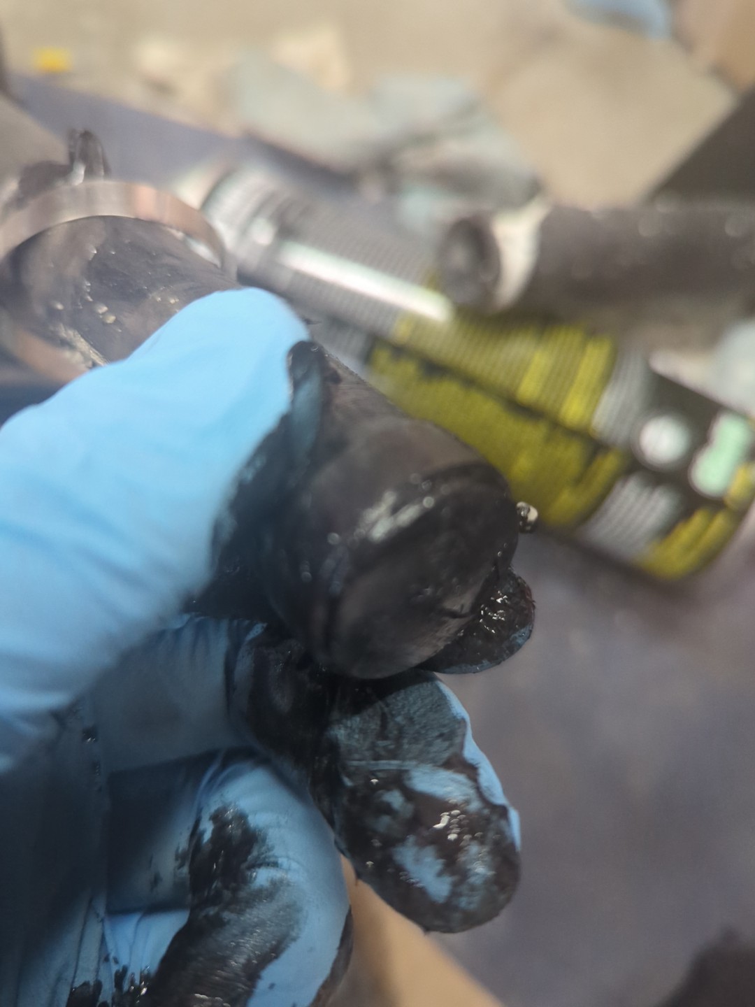

Finally decided to disassemble the broken CV axle. It snapped clean right before the splined part that goes into the plunging part of the axle. Transmission side.
jirwin
It looks like the shaft tapers down at that point so I'm not sure if its meant to break there or not. These are supposedly the "Stage 1" ZZP axles. Upon further research I think these are just old Grand Am axles or similar. They are a little thicker, but still. I'm surprised it broke there, but I guess its the skinniest point of the whole axle
