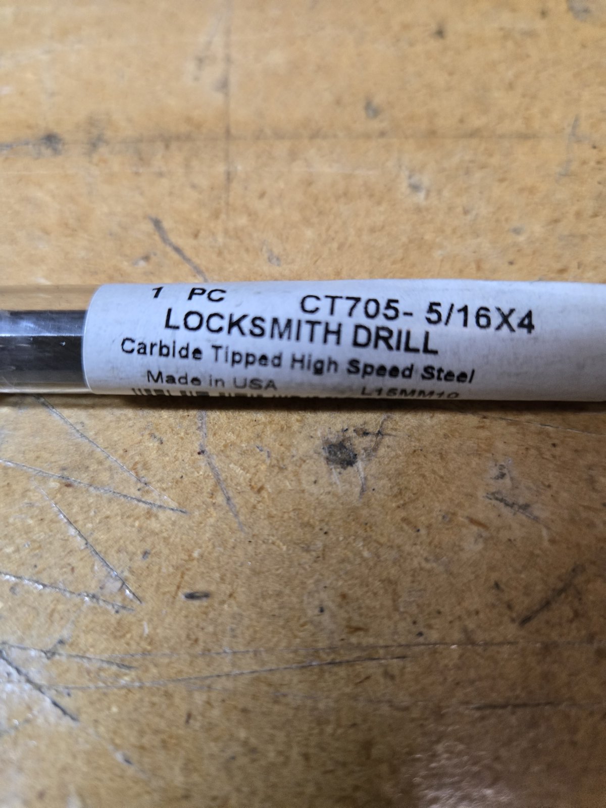

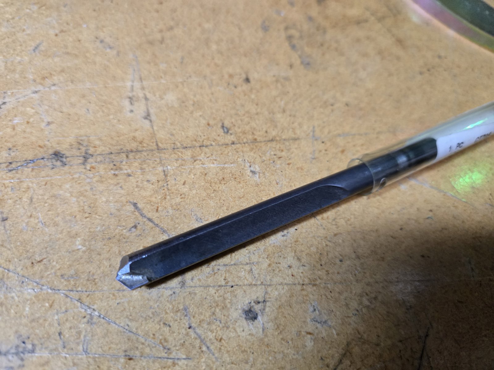

Waterdriver
I had a similar issue on a truck I had years ago. I had located a local machining tools shop supplier near me. Explained the situation and got me the right drill bit. Nothing else will even touch it.
Look for a locksmith drill bit.
