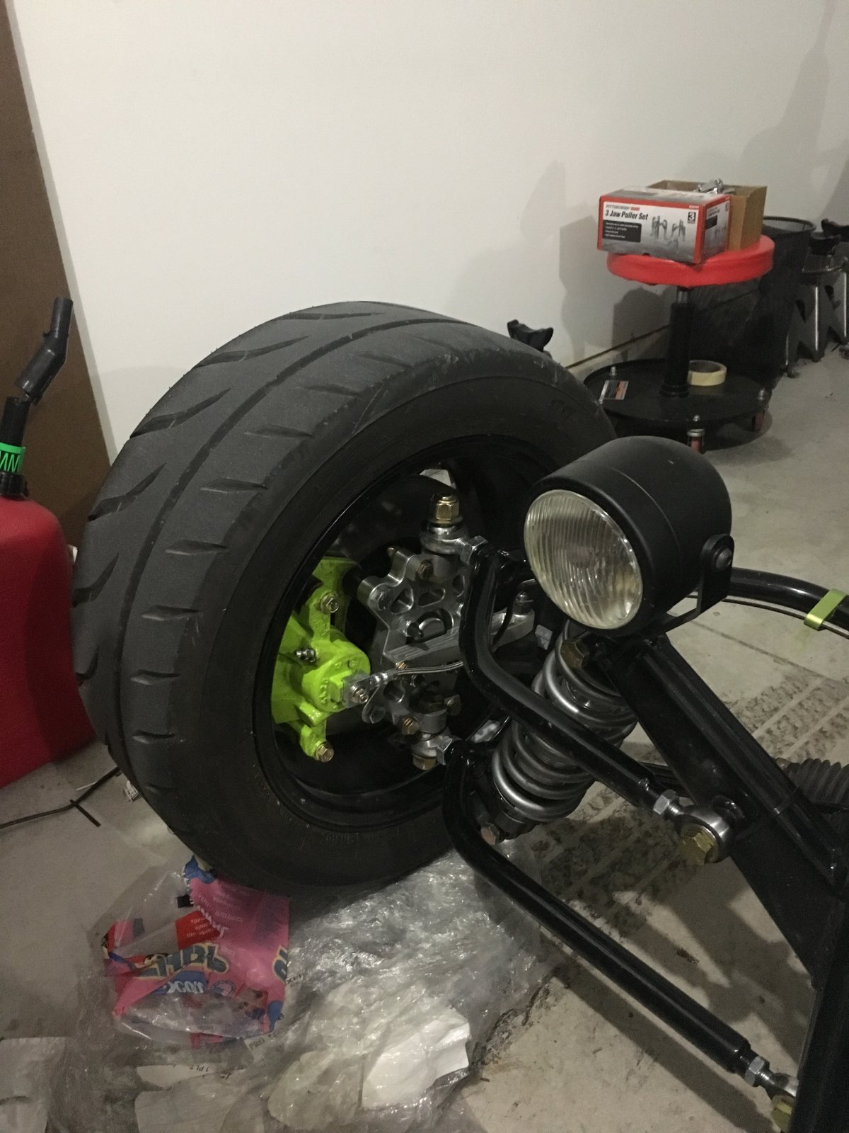

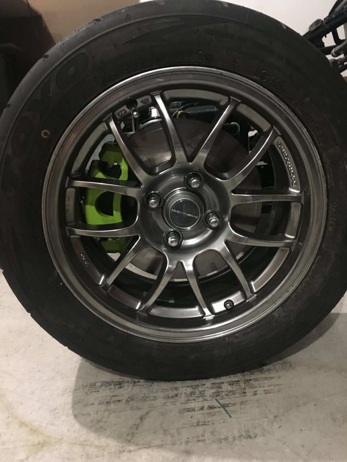

Yeah, I just installed the brakes on the goblin, Sprayed the hell out of them with brake cleaner, taped off the bolt heads and went to town with the little brush. I think it took about 3 coats each. I just went from one to the next by the time I was done with 4th the 1st was ready for a coat again.

On the goblin the whole brake is easy to see you will want to paint the whole thing
