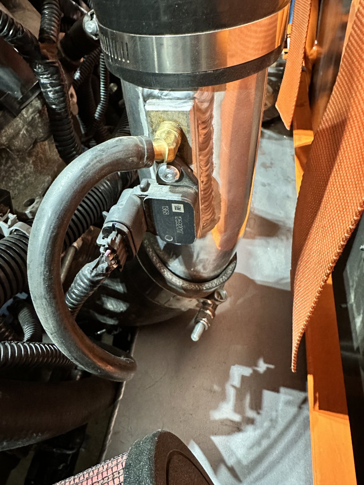

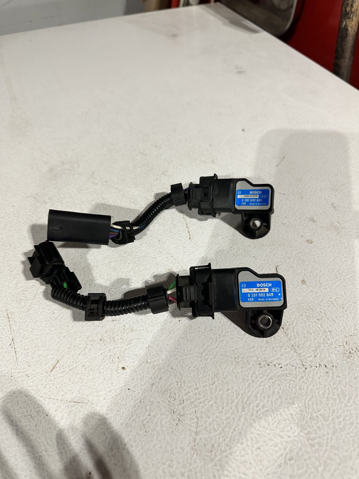

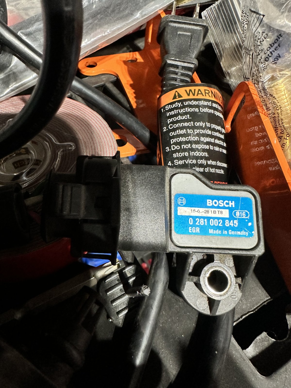

I’m getting ready to install a new pcm I got from ZZP with a tune (my pcm was tuner locked). When I pulled off the map sensors that came on the donor originally they were the Bosch 3 bar maps but the car didn’t run right. Whenever you got out of the throttle it surged through the turbo. So I put the stock ones back on and it ran fine. I thought the original pcm wasn’t tuned for it. Now that I’m getting ready to reuse them I noticed they are the same part number. Is that correct? The have the harness adapters for both that plug right in

I’m not following your same as and new and stock references.
You should have one that includes an iat sensor stock but someone could have modified the vehicle to have a separate iat sensor or used sensors that have iat sensor in both locations but it won’t have the temp wired on one of them. I think that sensor is a 4 wire so it would likely be the latter.
You can search the HP Tuners site to find the correct linear and offset for that sensor in the tune.
I need to add that the HPT description for linear for the map values is incorrect and the value is actually per volt not per 5 volts. You need to divide the linear value linked above by 5.
SmsDetroit

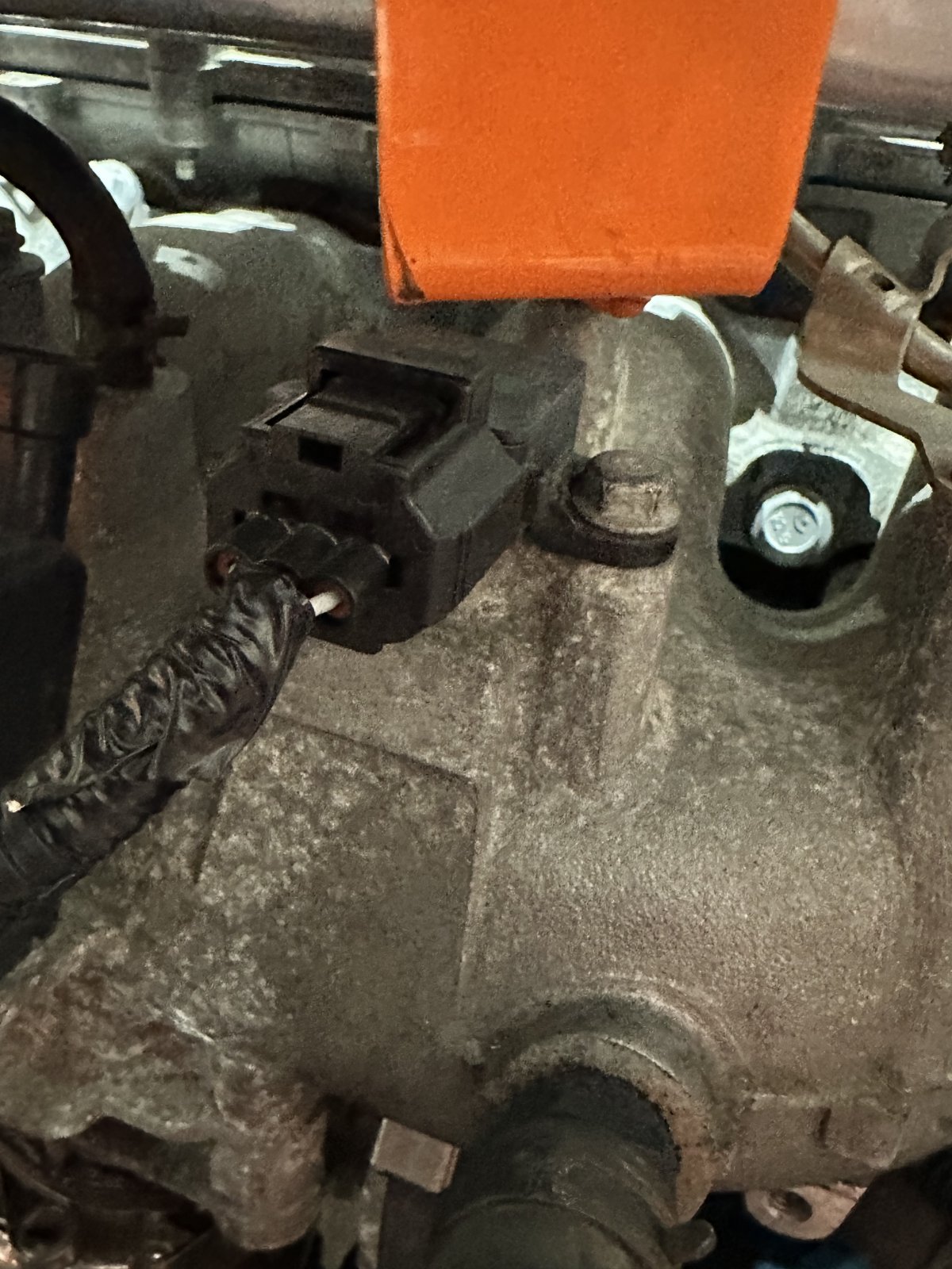

What I was talking about with the “stock” sensors are the first 2 photos. The 4 wire is on the cold side charge pipe. The 3 wire is on the intake. What came off of the engine when it wasn’t running right are the 3rd photo which are Bosch 3 bar maps with the same part number. You can see in the photo they have harnesses attached. One coverts one of the sensors from a 4 wire plug to a 3 wire. The other just concerns the plug end on the 4 wire to match the engine harness. I just want to make sure this is correct. It looks like that is what ZZP does

The 12592017 is a stock LNF 2.5 Bar and is sometimes referend to as Low Res Boost Sensor.
The others are 3 bar. As long as the settings are changed in the ECM to match them, they are fine. I'm running a 4 bar in the Intake Manifold since that was in my new motor and a 3 bar in the other.
