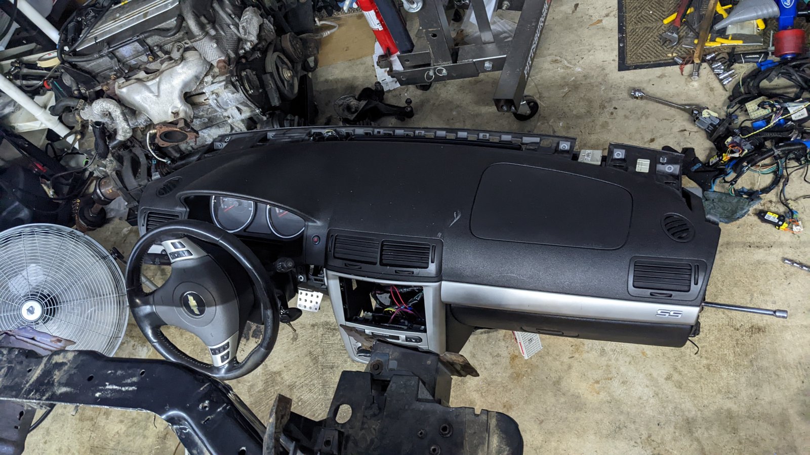

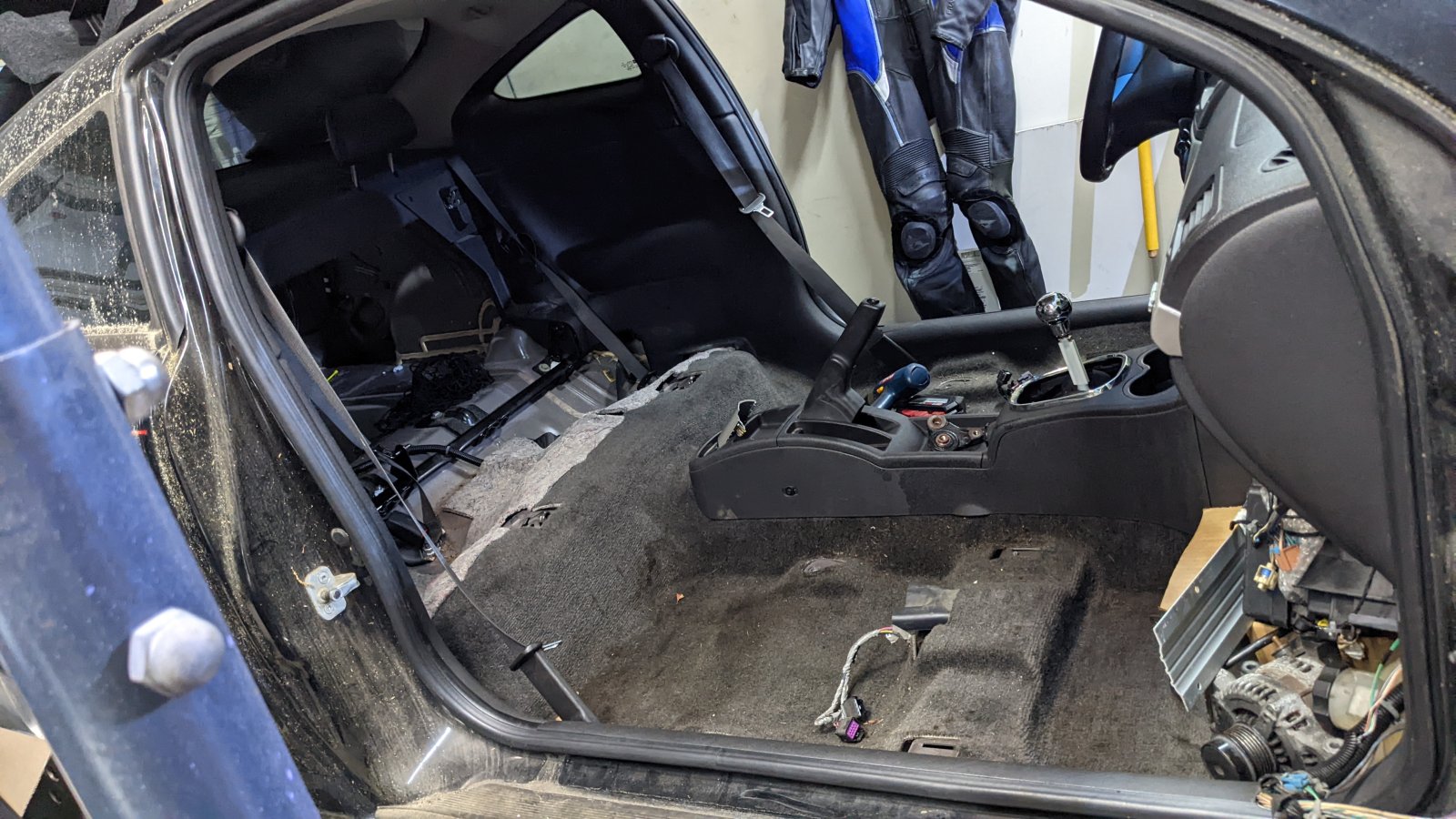

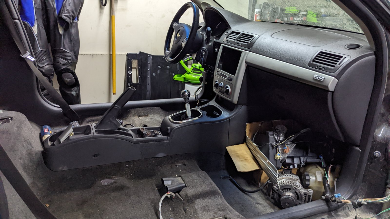

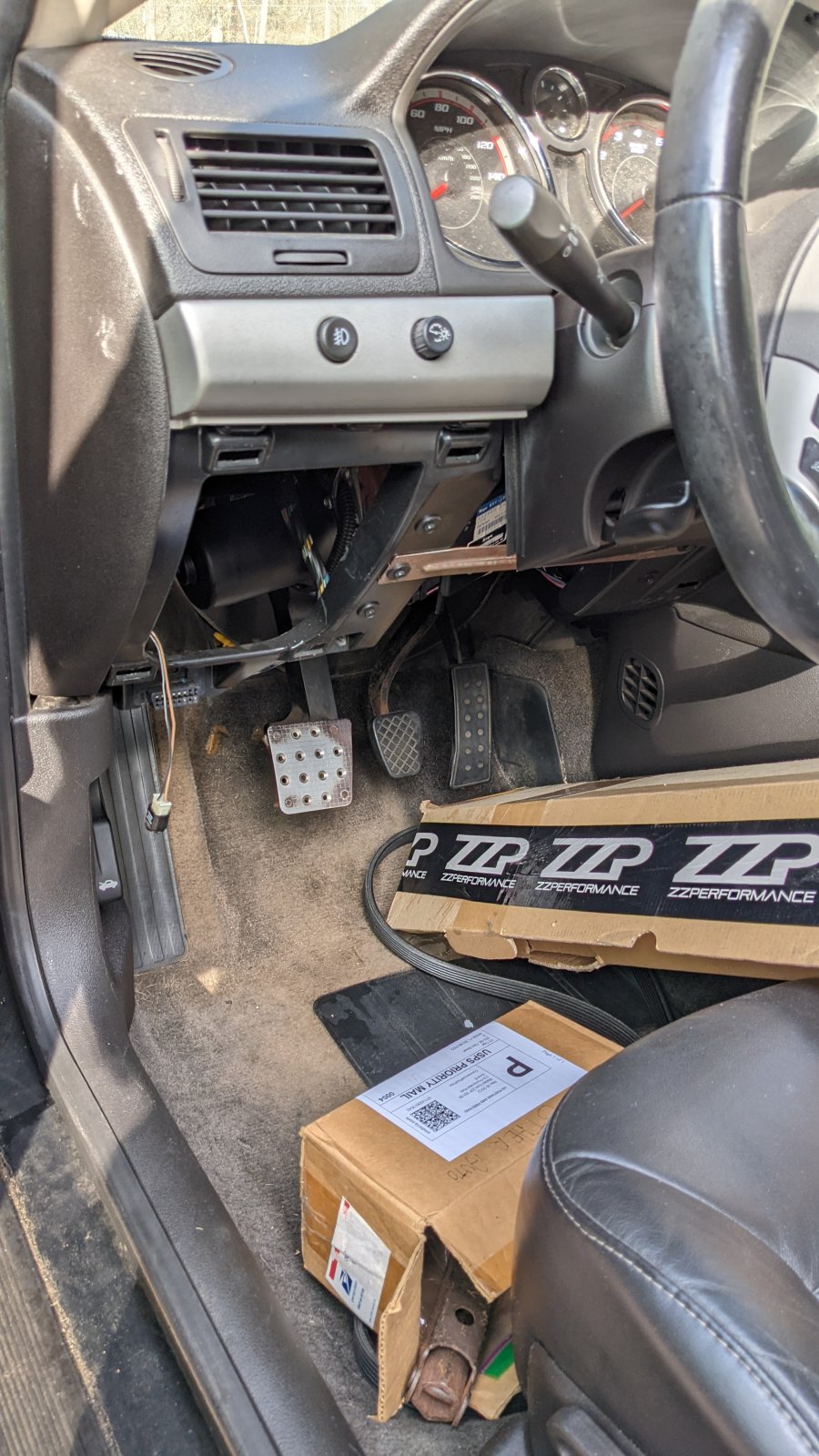

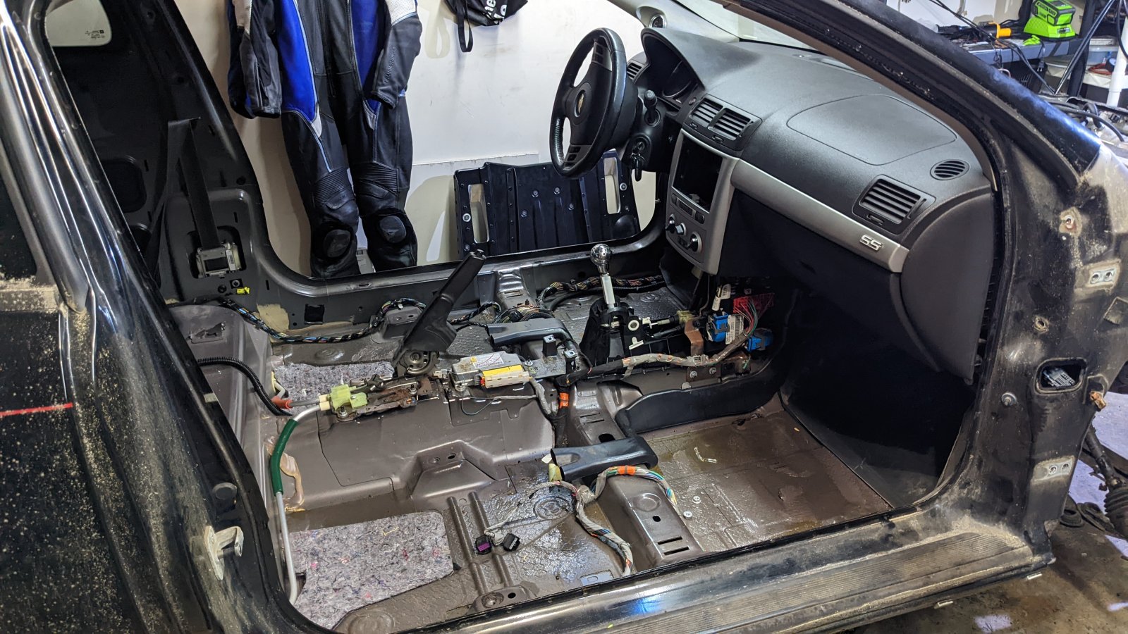

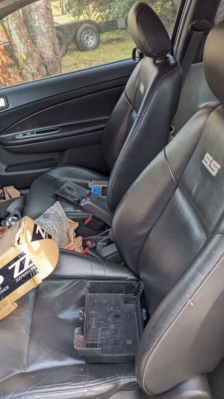

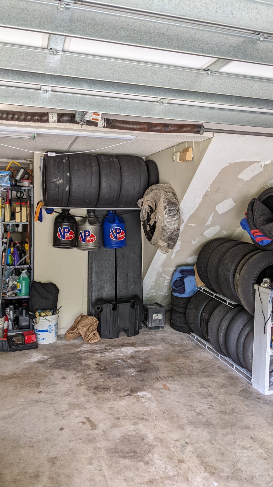

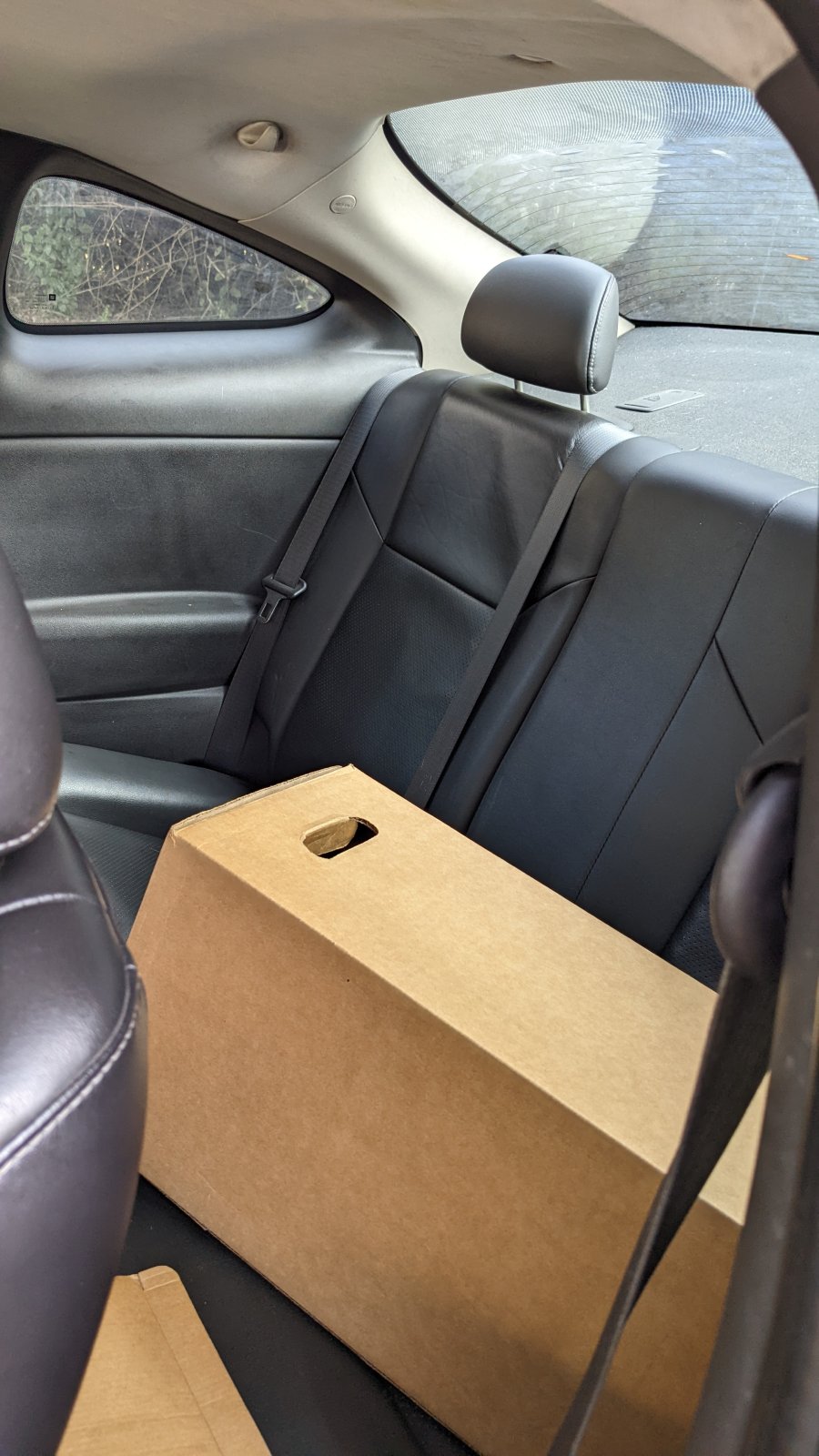

I got the car home and in mid-December and I placed my order for my goblin. I had some delays with tearing into the donor. I needed to make room in my garage. Another car I had needed to be moved out and finding an adequate location took some time. Plus I already had a few track days scheduled with motorcycle and car so maintenance and some prep work needed to be done on those. Also, given the time of the year, the cold was not motivating to work on the donor outside.

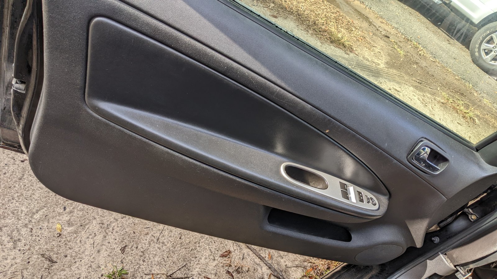

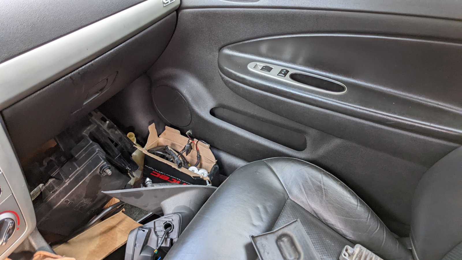

Some quick pictures of interior (not sure about thumbnails vs full image but also don't want a massively cluttered thread):
PXL_20211231_151802542.jpgPXL_20211231_151756846.jpgPXL_20211231_151748793.jpgPXL_20211231_151808881.jpgPXL_20211231_151754346.jpgPXL_20211231_151744575.jpg

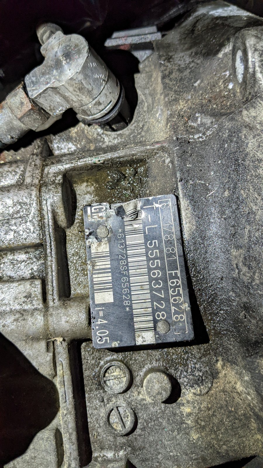

One thing noted from the previous owner of the donor was that the car was not a G85 optioned car so it did not have a LSD transmission. Knowing that I was building a track setup, I began my search. The old redline and cobaltss forums are quite useful if you dig well enough. I came to find out the HHR SS/TC shared the same LSD transmission as the ss/sc. Having the part number(55563728 or 19301859 ), I was able to source one online at a junk yard and bought it.

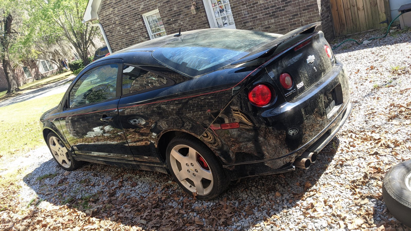

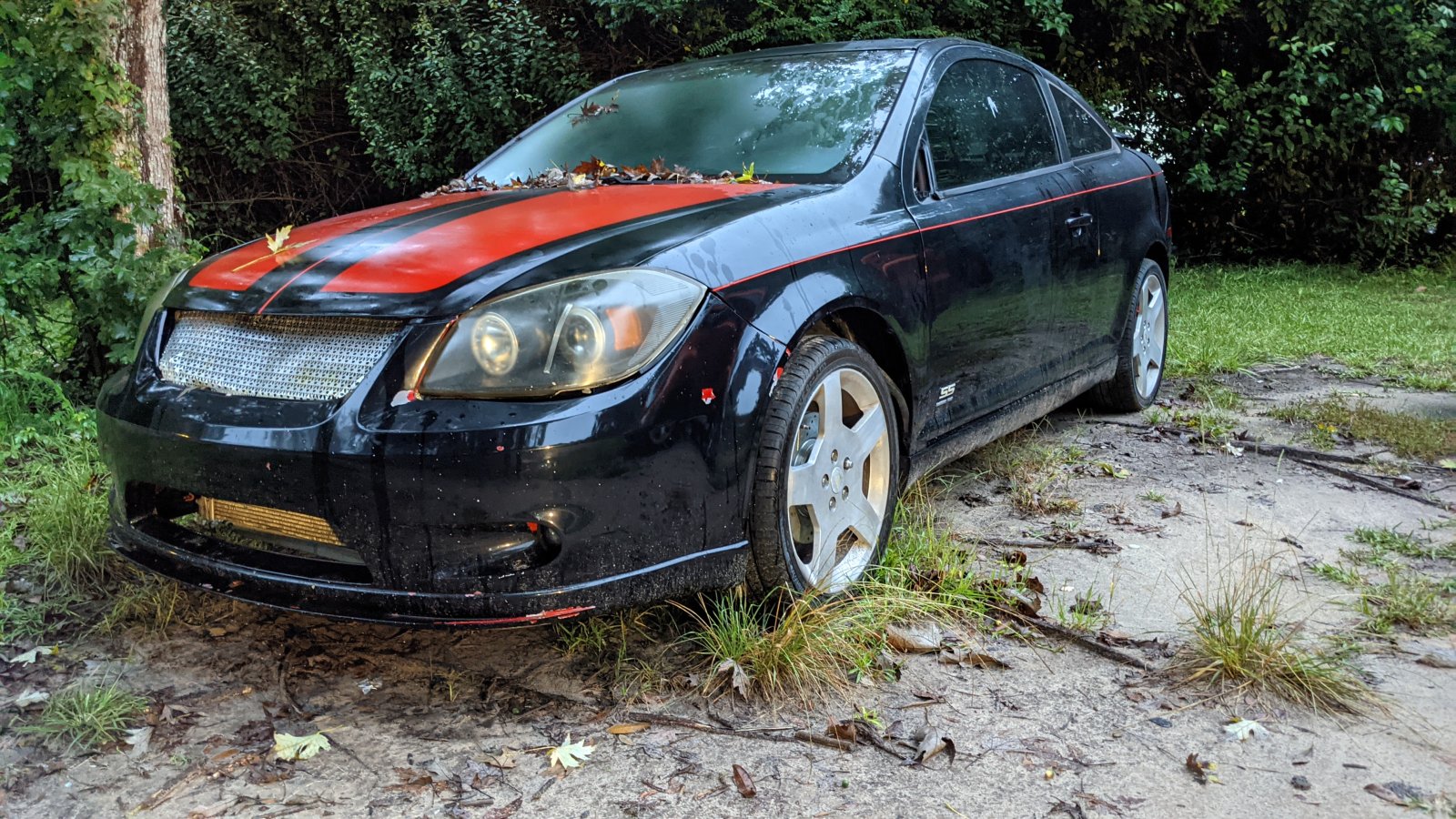

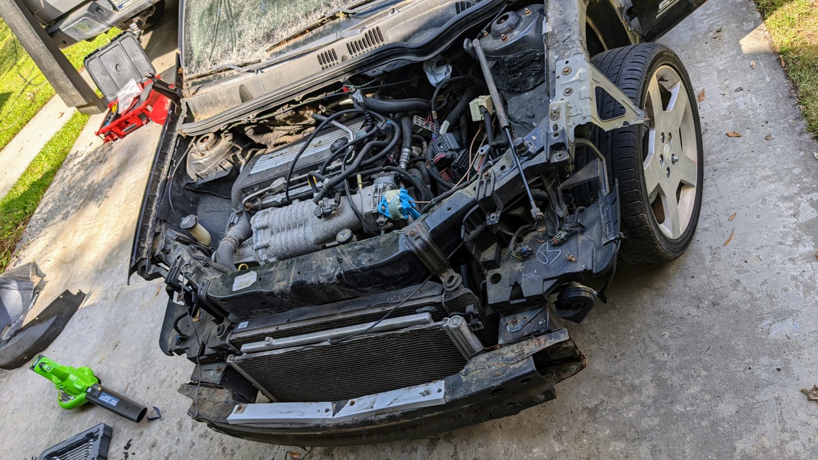

Fast forward to around May 2022 time frame, I finally found some time to begin tearing into the donor car. And this is where the fun begins...

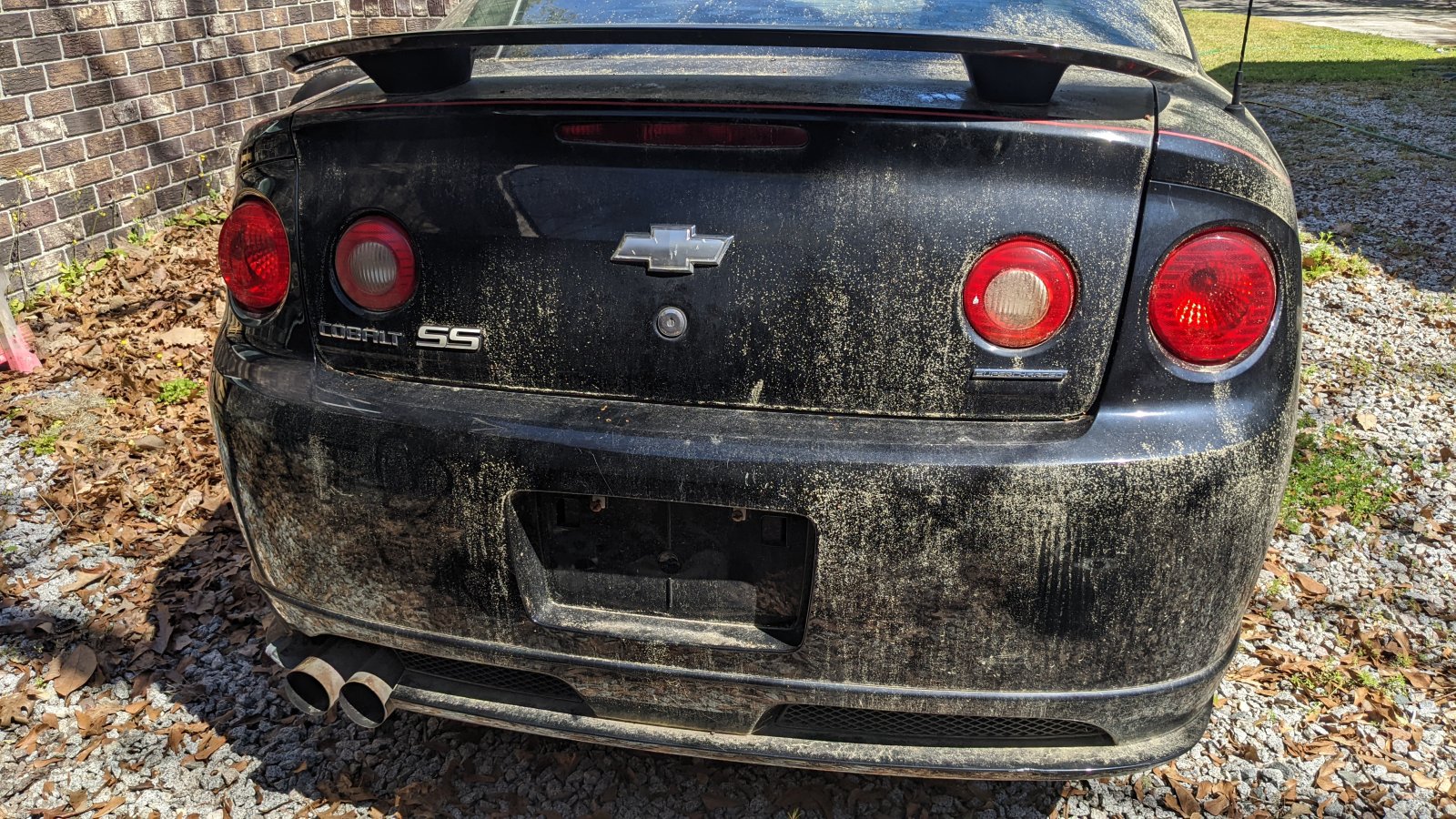

Before I brought it into the garage...

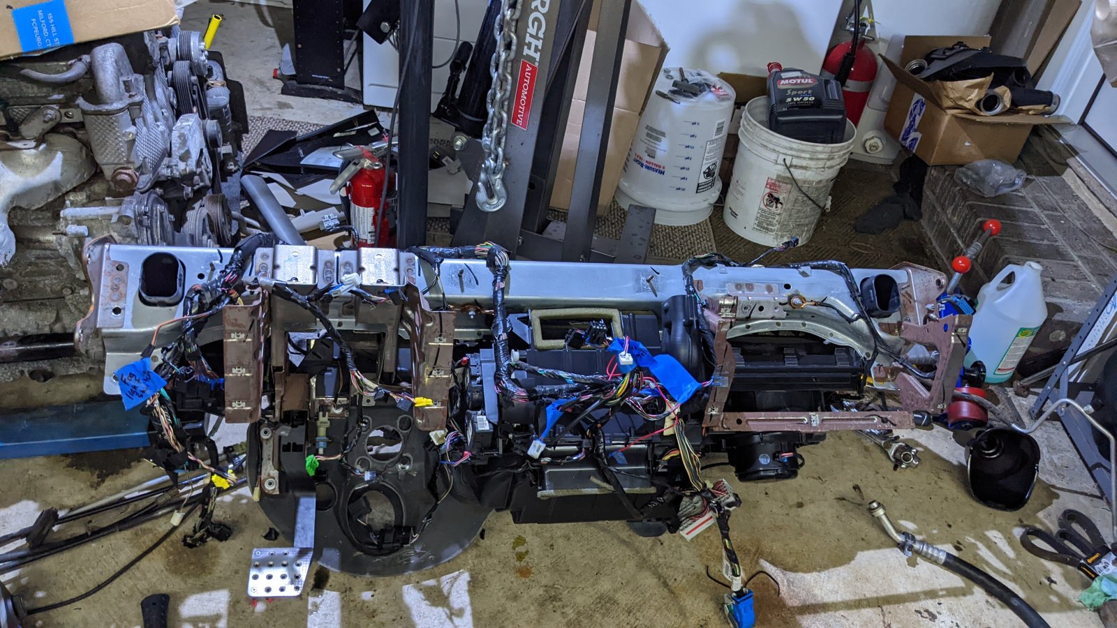

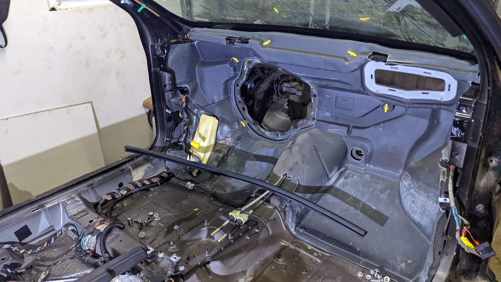

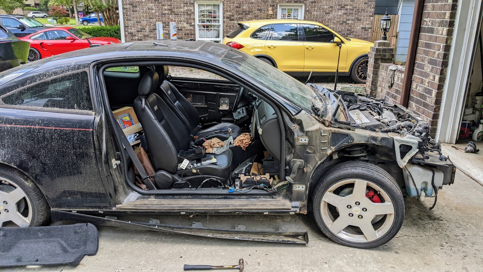

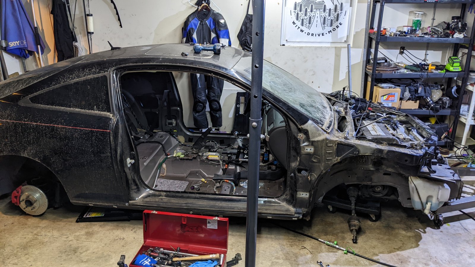

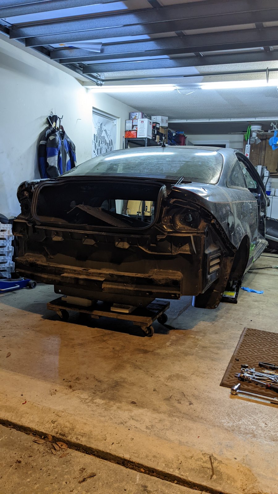

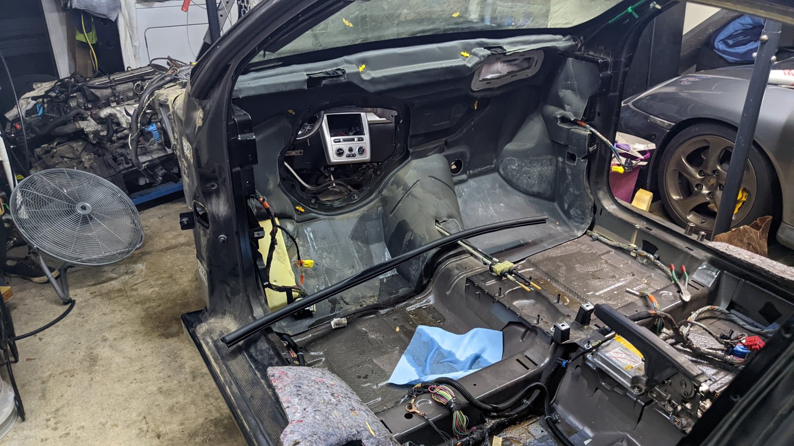

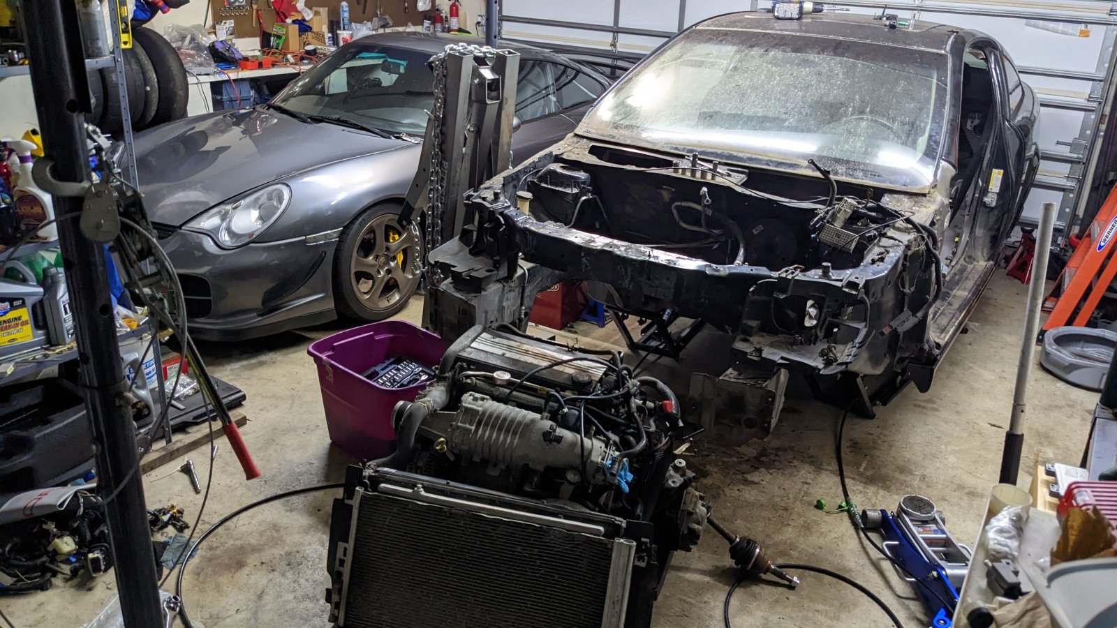

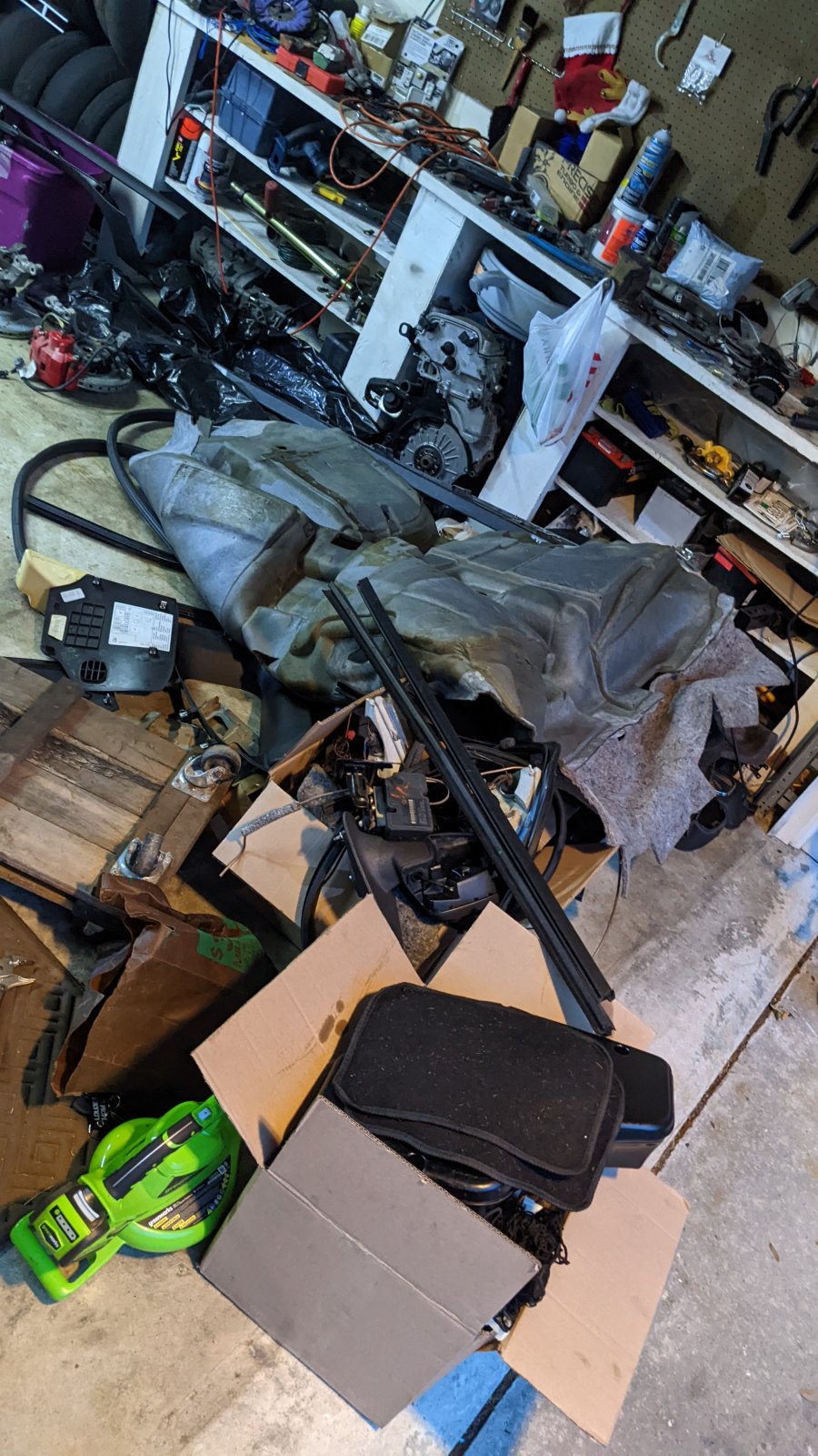

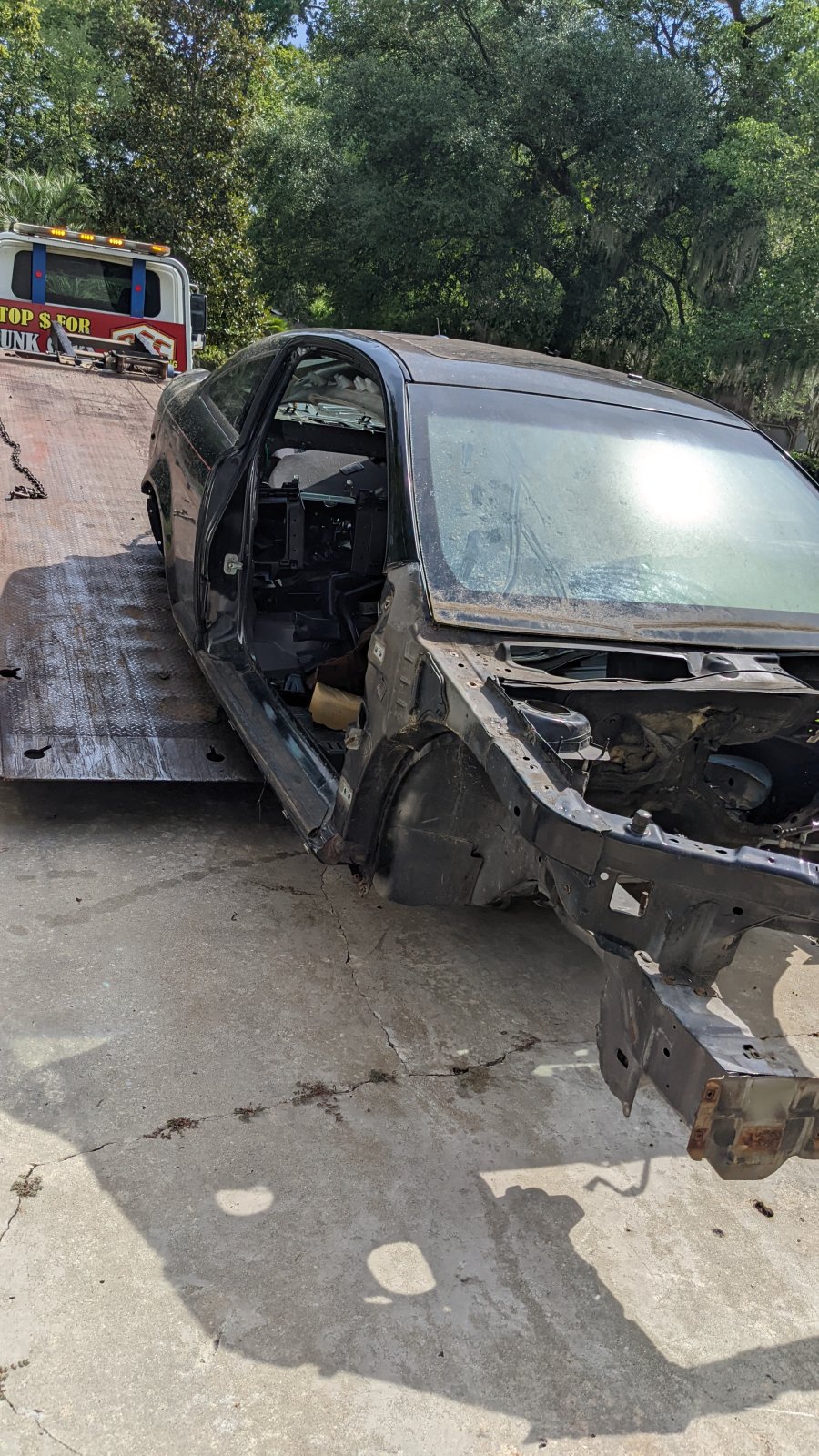

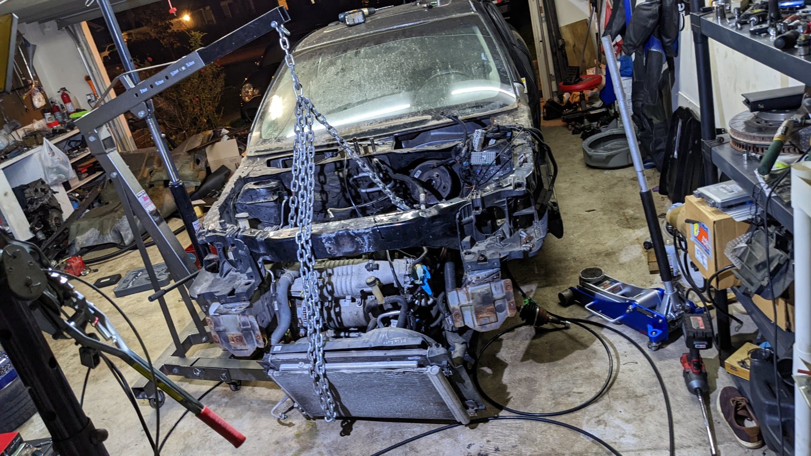

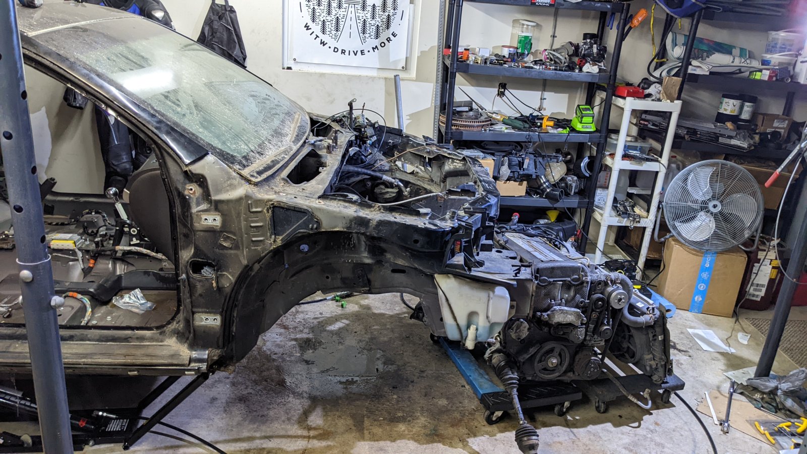

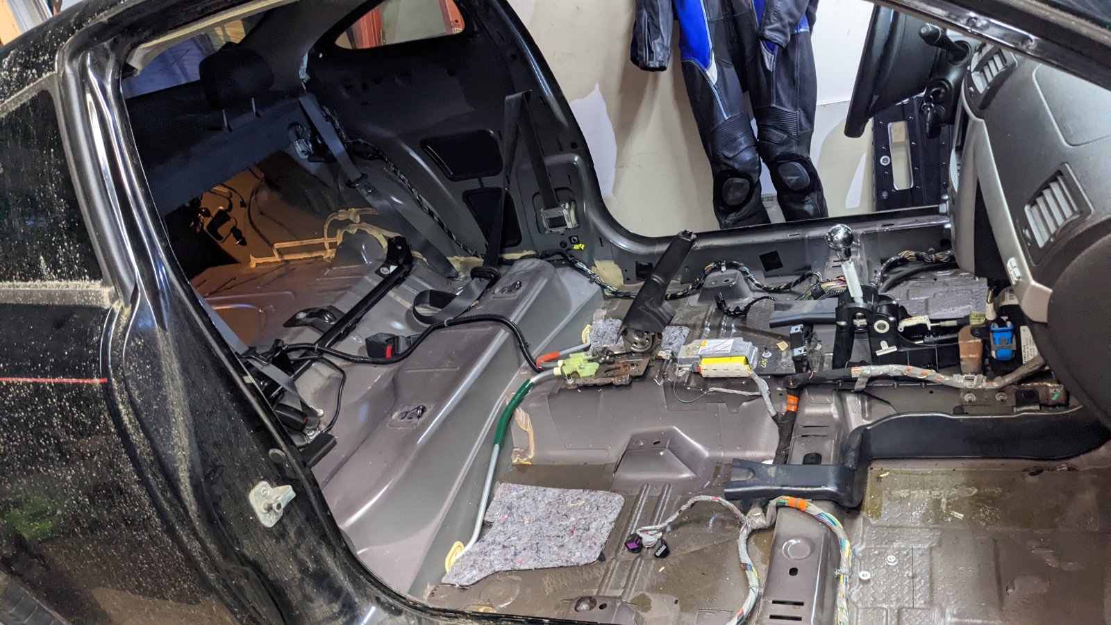

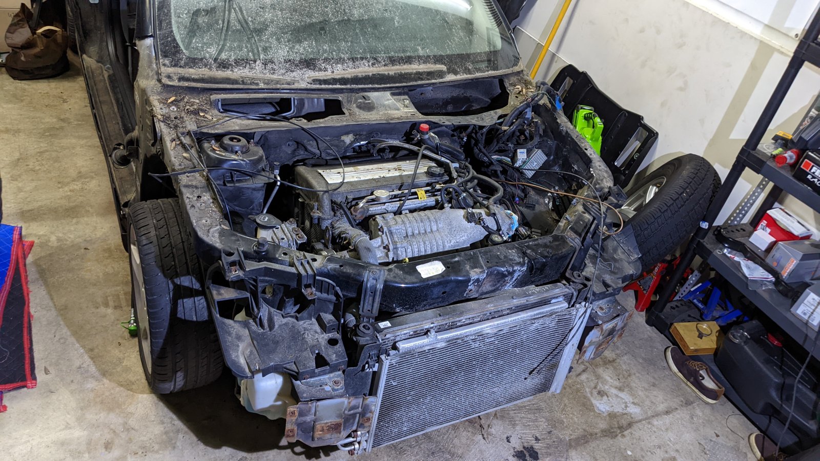

Okay, so as May rolled around and I had room in garage cleared out. A good friend of mine and myself worked on getting the donor stripped and parts "organized" as best as possible.
Worked on getting major body parts off outside first before rolling it into the garage. Might be some picture overload but also trying to clear out my memory storage! :p
Into the cave she goes and the remainder stripped!
PXL_20220518_021123262.jpg PXL_20220518_022304642.MP.jpg PXL_20220522_002408743.MP.jpg PXL_20220522_002414802.jpg PXL_20220523_013854535.MP.jpg PXL_20220523_014933979.MP.jpg PXL_20220523_013901321.MP.jpg

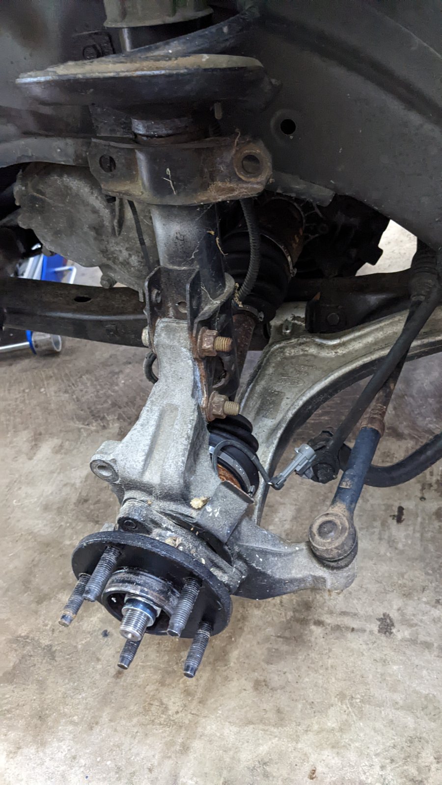

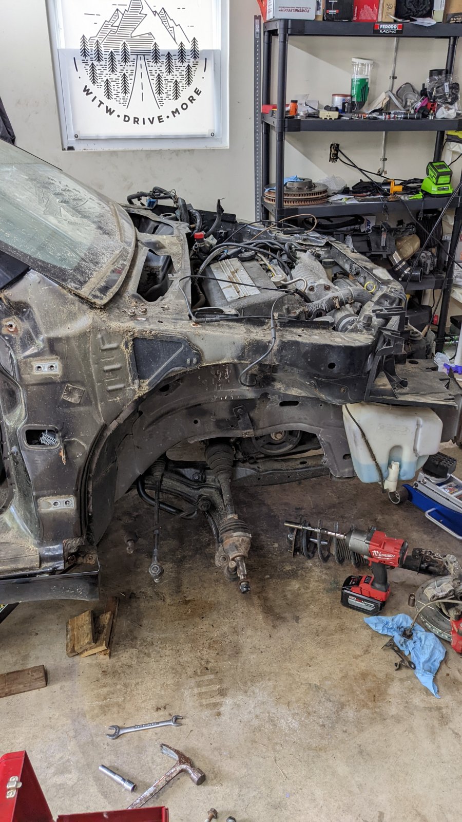

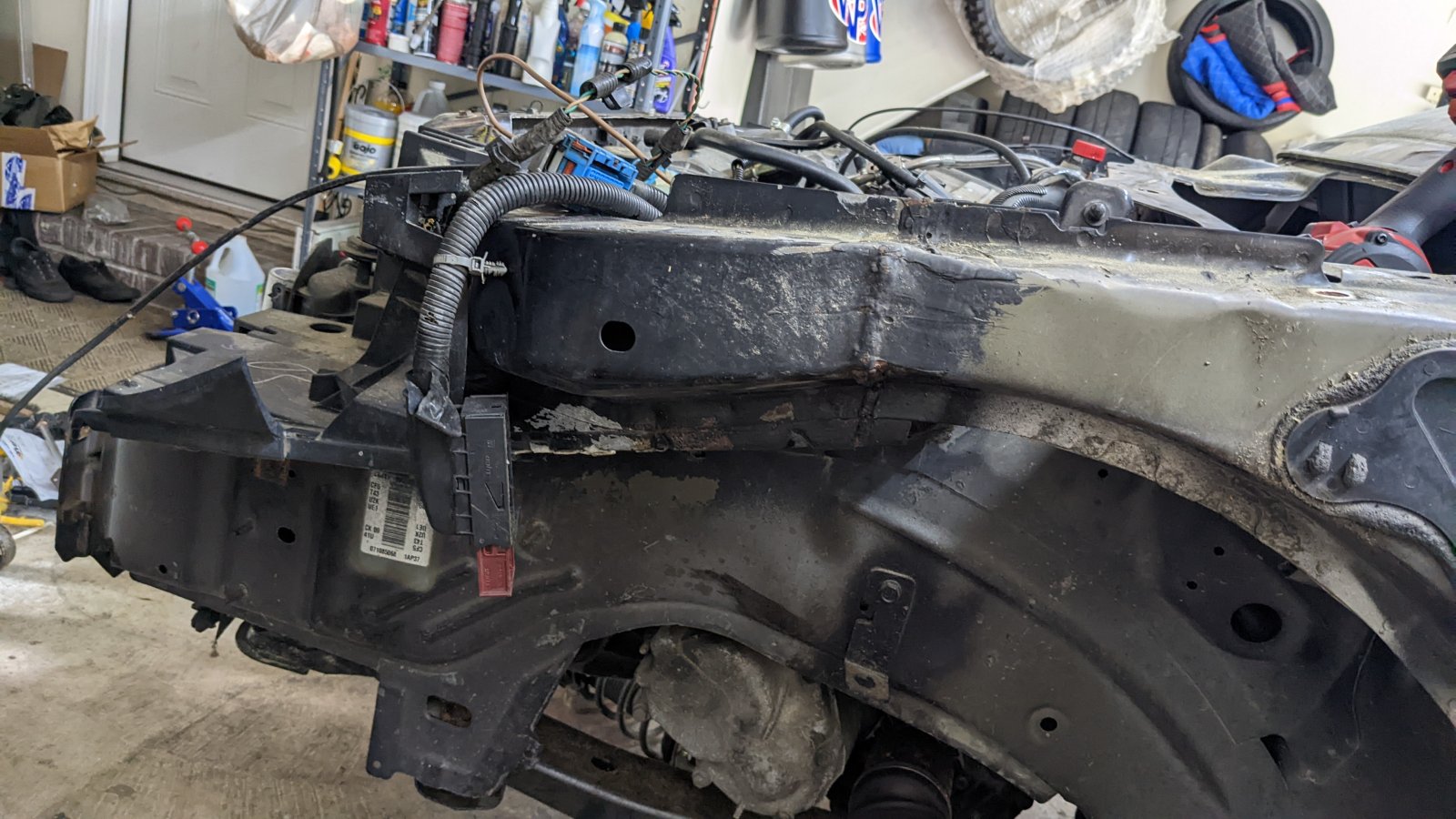

On the body and engine removal, I started spotting a few red flags including frame damage...
PXL_20220518_021138727.jpg PXL_20220521_210428443.jpg PXL_20220521_211302855.jpg PXL_20220521_215555451.MP.jpg PXL_20220521_211306024.jpg

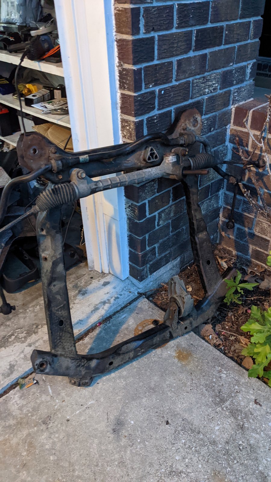

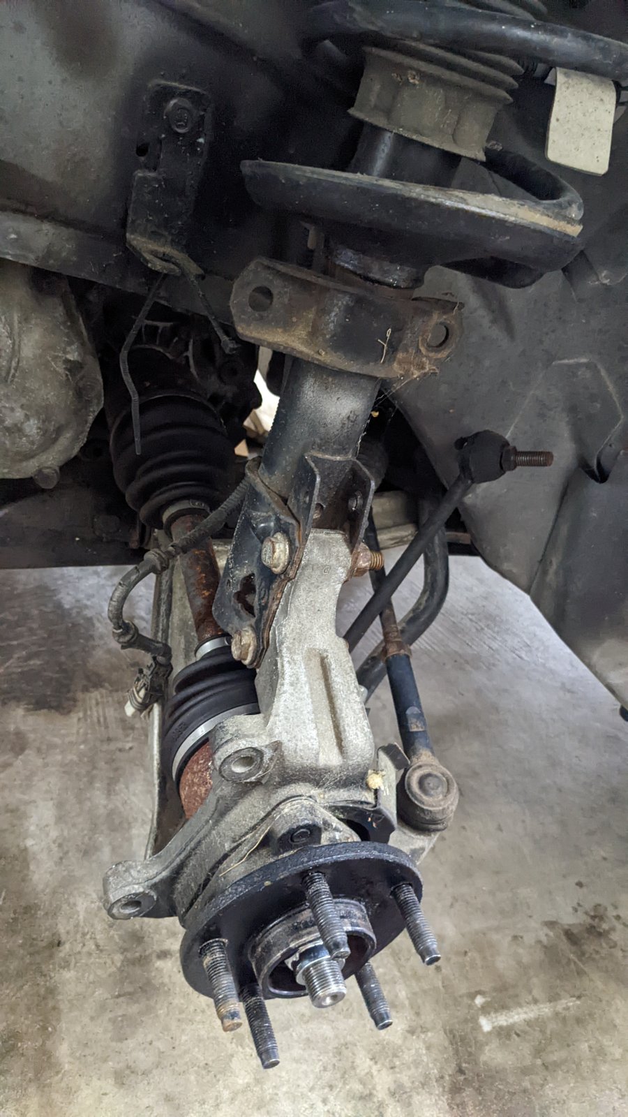

Then to the engine and subframe:
PXL_20220522_020531982.MP.jpg PXL_20220522_002013054.MP.jpg PXL_20220522_022519522.jpg PXL_20220522_023449036.jpg PXL_20220522_042813089.jpg

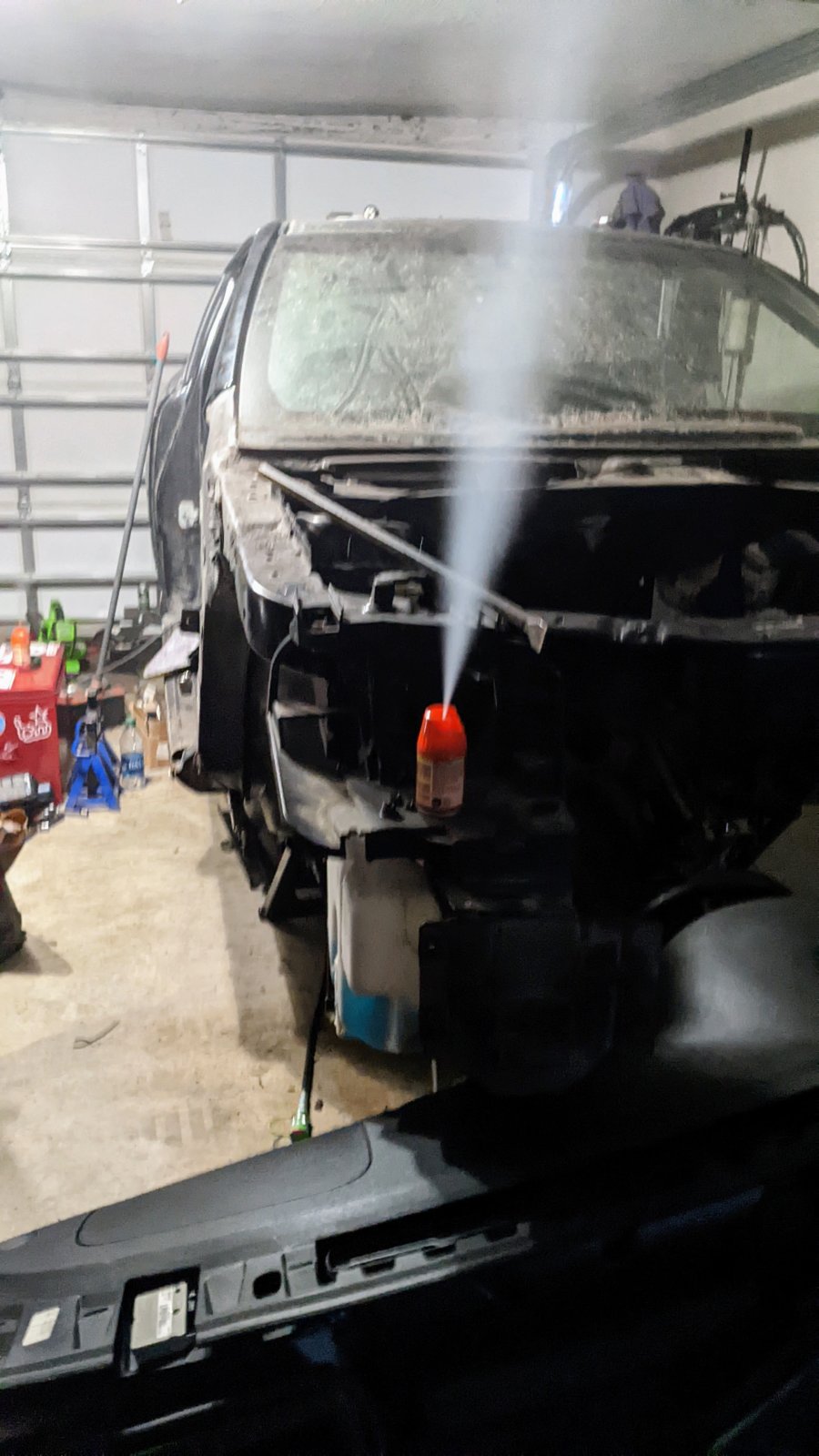

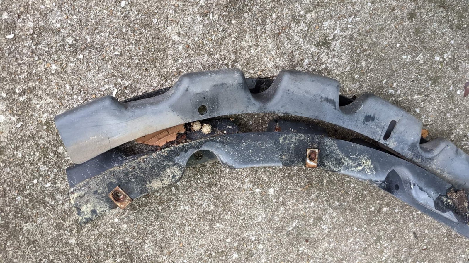

At the end of May/early June I had a week long trip out of town scheduled and tried to get things wrapped up but happened t notice these in and around the car and parts...
PXL_20220522_002154257.jpg received_252705160392730.jpeg IMG_20220530_084529.jpg

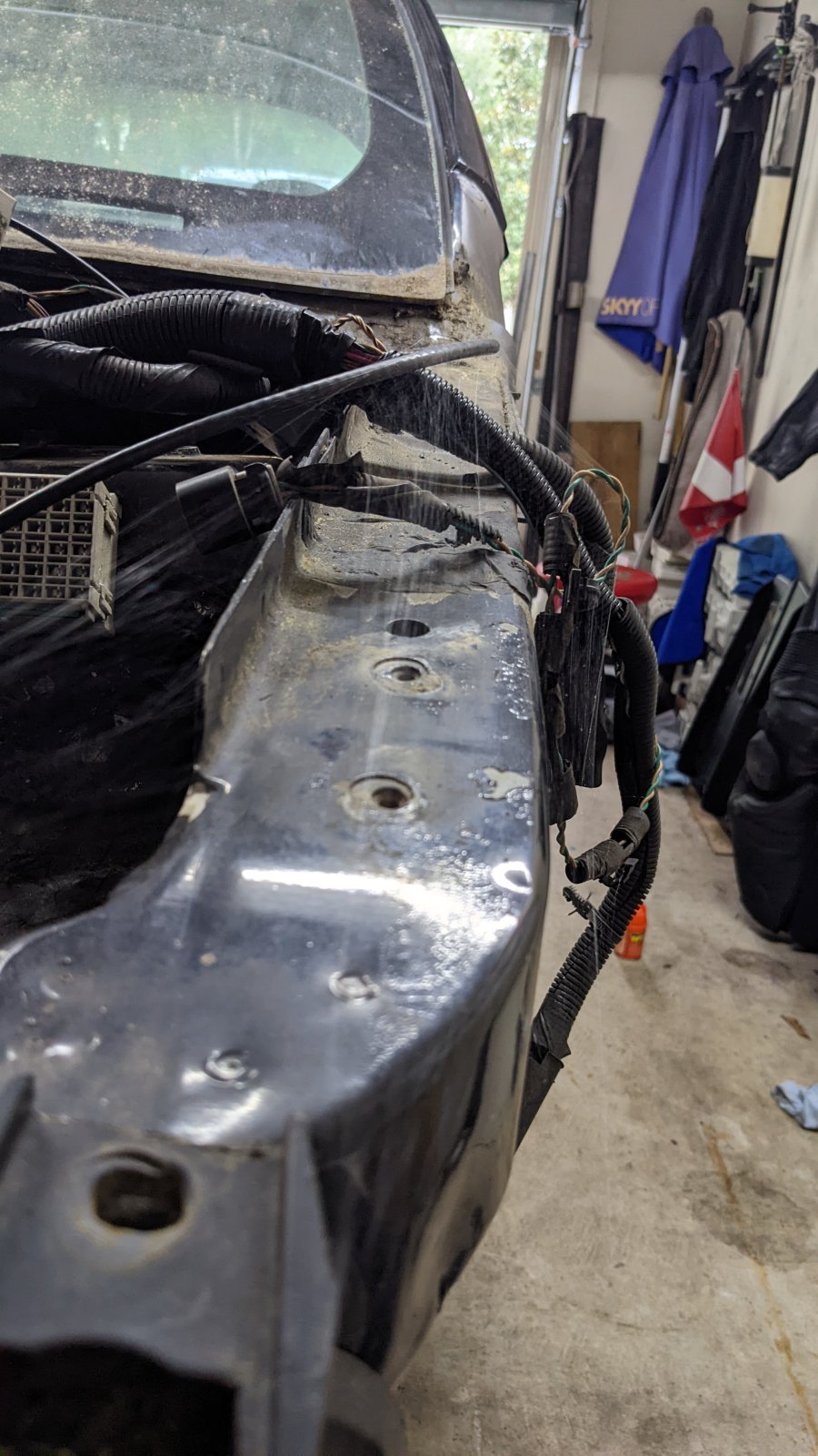

So, I headed to Walmart and on the day I was headed out of town, I went full genocide on these widows!
Got back in town and let e few more off again just to be on the safe side as I saw some webs which led me to believe some survived. I'm pretty I got them all after that last round!

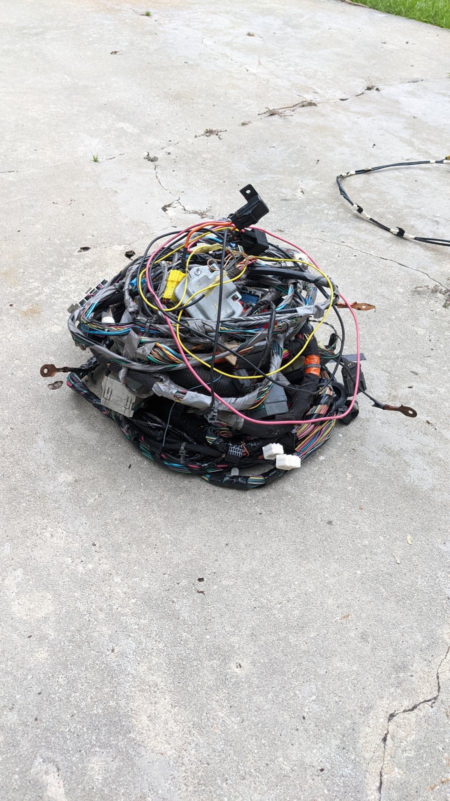

I wrapped up the stripping the dash and miscellaneous items on the donor, got frame on dollies ready for junk yard pickup and had harness boxed up to be sent of to DF in hopes to be ready when I went to pick up my frame and parts.
PXL_20220615_033622546.MP.jpg PXL_20220615_014412273.jpg PXL_20220617_141114775.jpg PXL_20220614_224917291.jpg

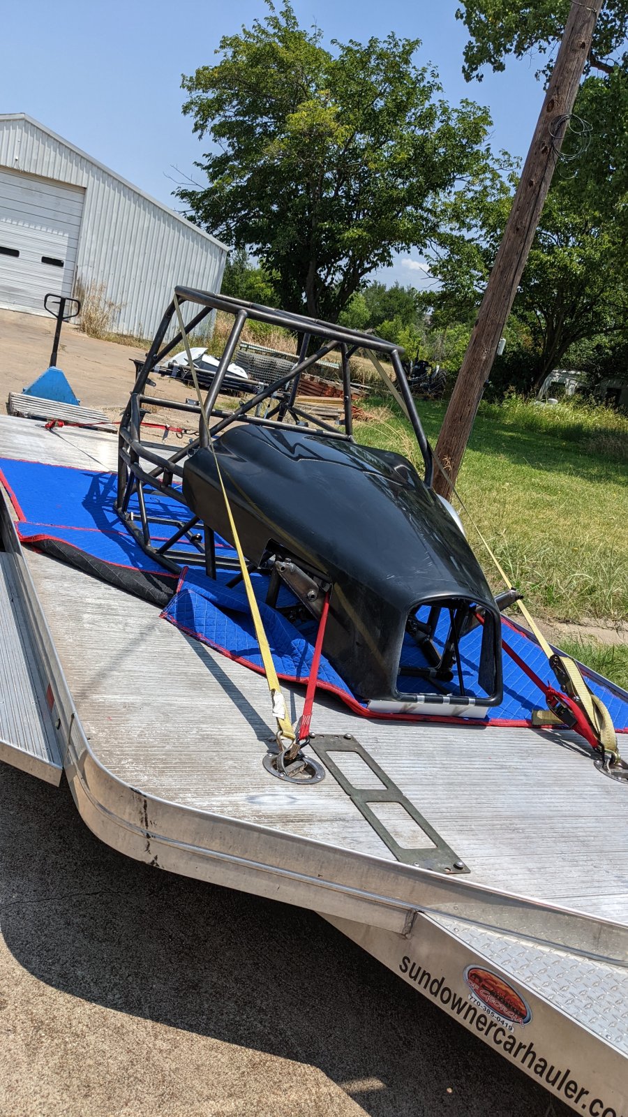

I had also gotten my pick up scheduled tentatively for end of June. I requested to get a ride in one of their SC cars so I can get first hand experience with one. I was really starting to get excited with progress!

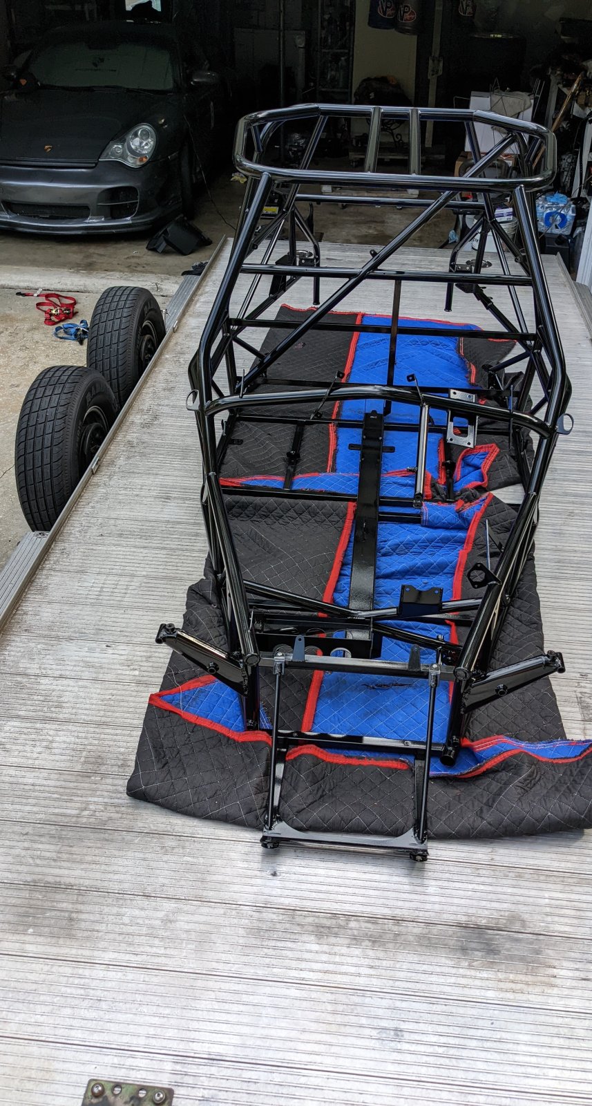

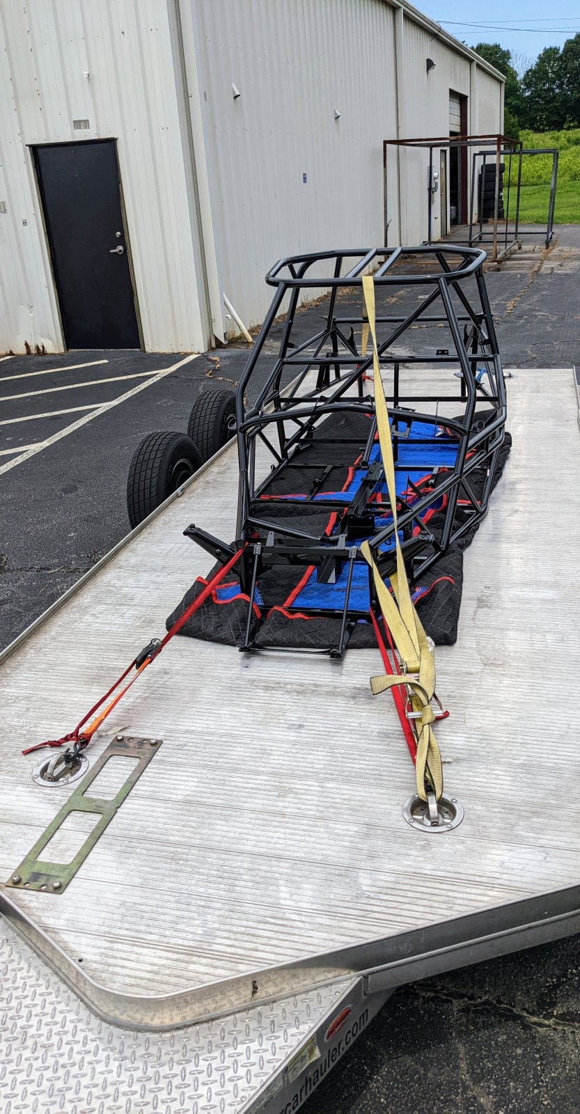

Pickup time rolled around pretty quick and I planned the road trip with a best friend. The plan was to drive over to TX to pickup parts and on the way back, make a pitstop at Barber Museum, then drop off my frame and other parts for powder coating!
I didn't get to take as many photos I would have liked to on the trip but it was a great time. The only disappoint was that the SC goblin was not available when I went to pick up as Lonny had taken home to be able to go to a show that weekend right after. They were nice enough to give me a ride in a 2.2 turbo though. So, I did get some enjoyment. Had awesome chats with the Doyle family and got a good preview of the facility. I also had a sneak preview at the V2 goblin. I can talk about it now that it's been mostly announced. haha!
PXL_20220627_173540737.jpg PXL_20220627_233816915.jpg PXL_20220628_173034145.jpg PXL_20220628_174305065.jpg

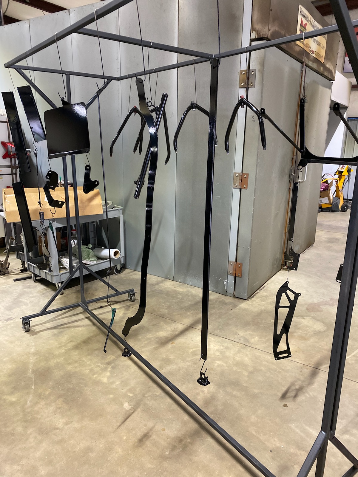

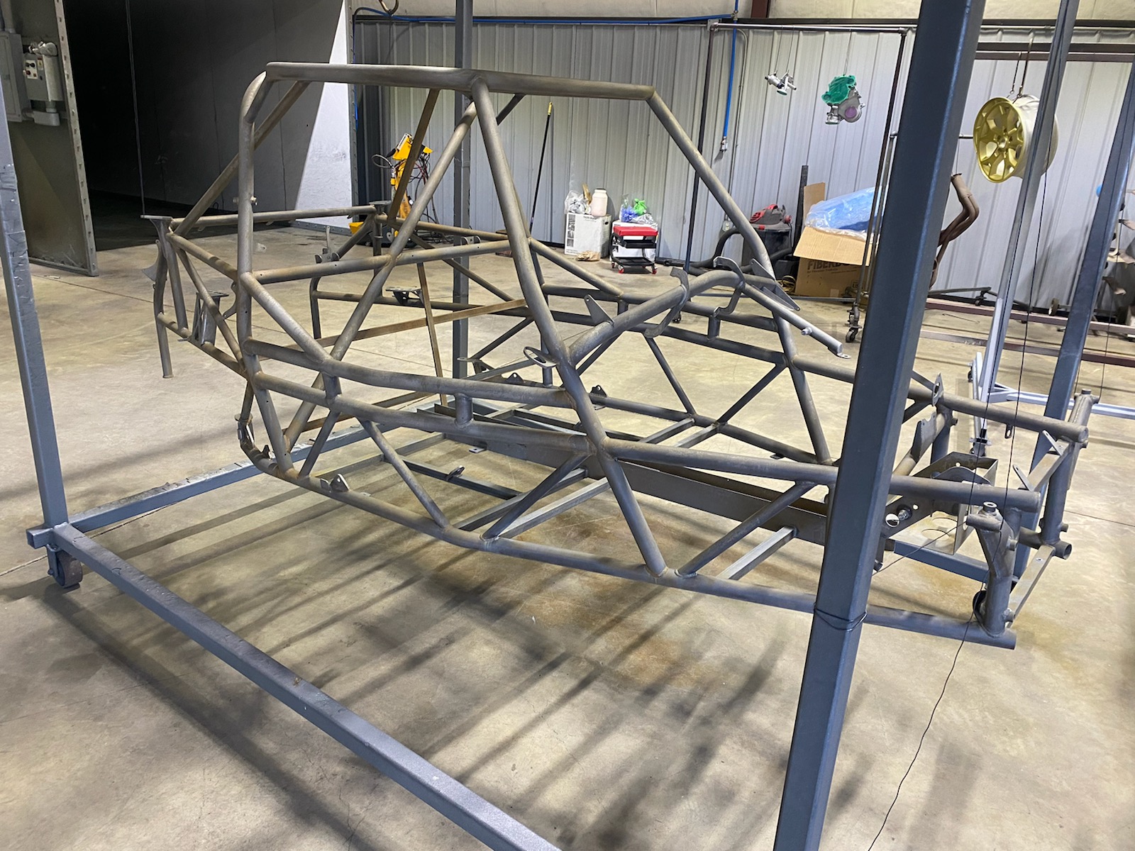

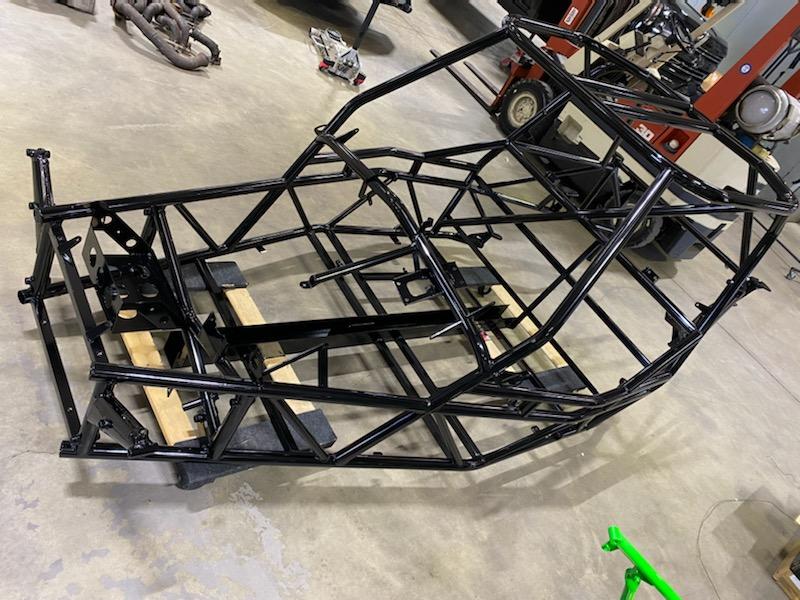

Later, at the very beginning of July, I got the call from powder coat shop that my frame and parts were ready! I scheduled for a week or so later pick up. I kept it simple with black. Mainly for cost but also I knew it would be used for track and didn't want to make her a show queen. I'd likely be doing some wrap graphics on the body panels.
IMG_20220707_225303.jpg IMG_20220707_225322.jpg IMG_20220707_225312.jpg PXL_20220716_165213713.jpg
Back home in the driveway and ready to begin assembly! I had only hoped...

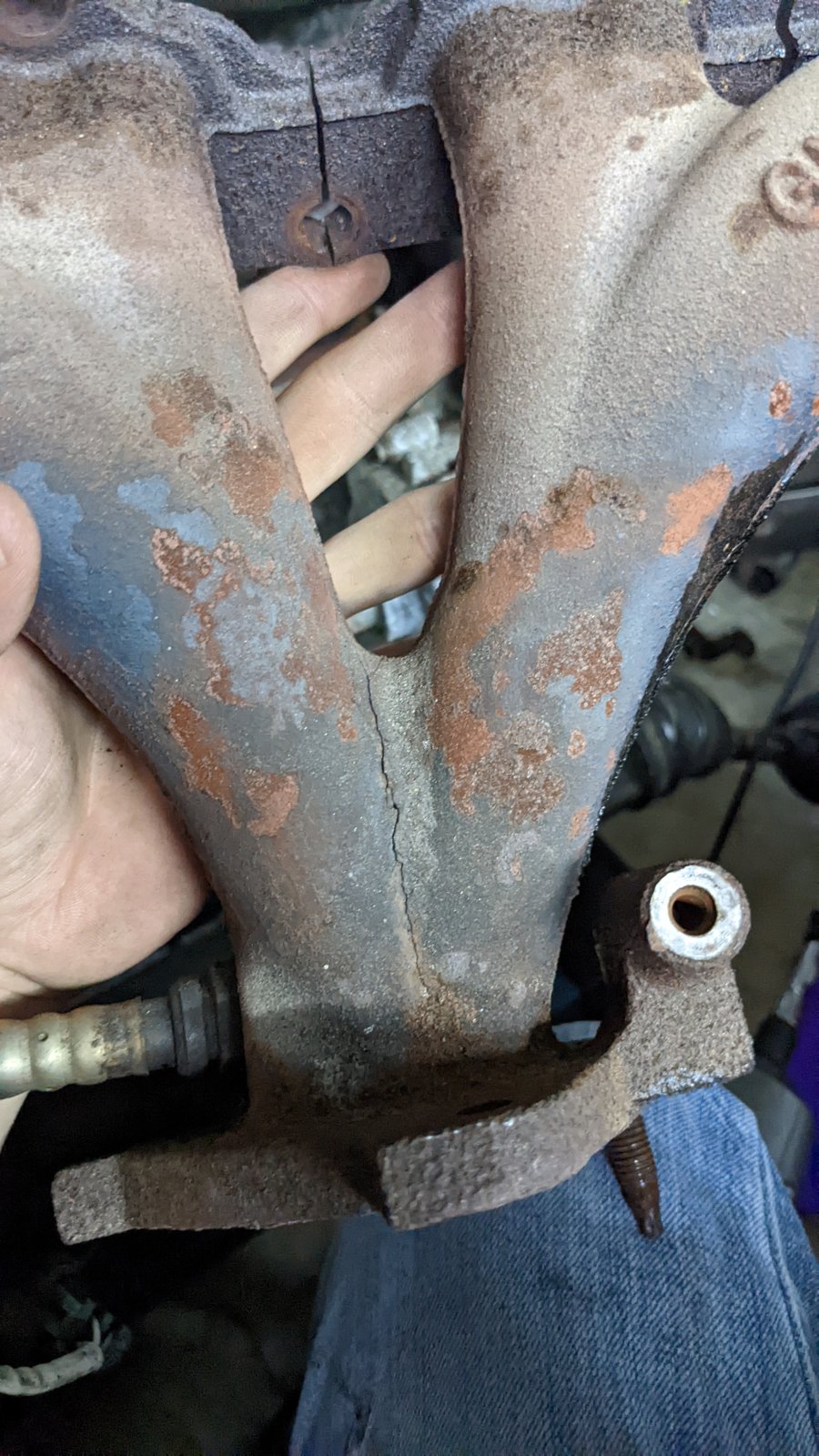

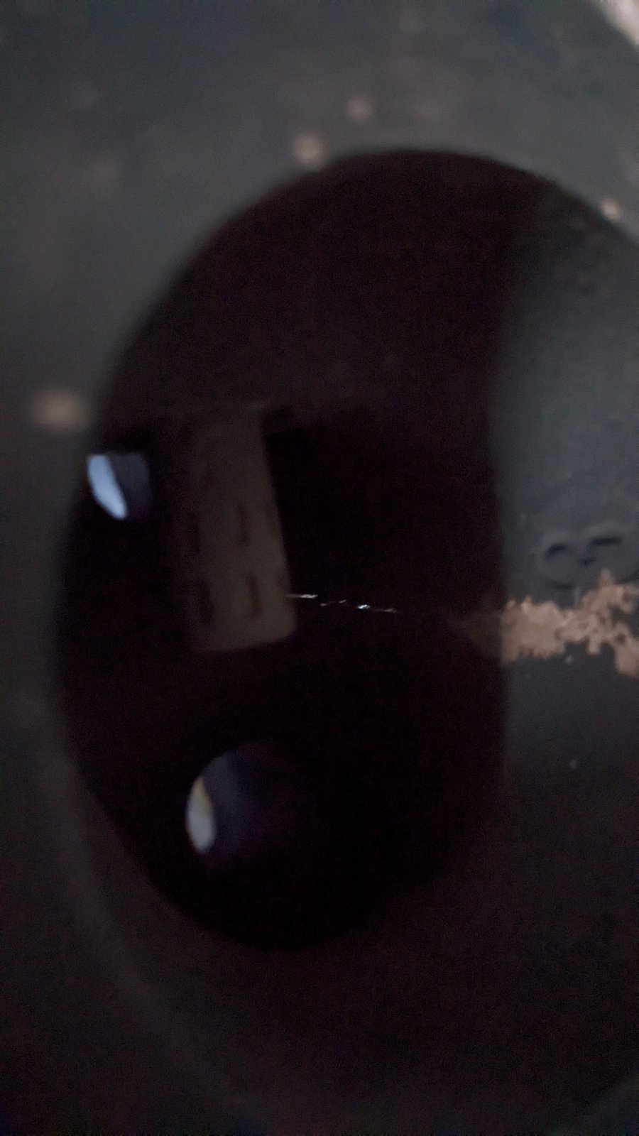

I was following along on the DF Goblin YouTube videos and got to the point of prepping the engine when I noticed this on the stock header. I pulled it off to inspect further.
You could see light shining through. Sadly, I'd need to replace and I wasn't too upset because this meant an upgrade. Being a northerner car, I wasn't too surprised but decided to do some further inspection on the engine while I was there...
