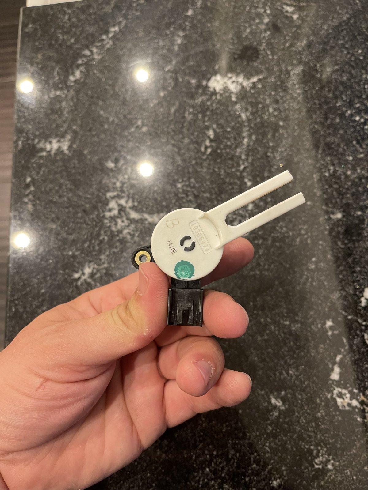

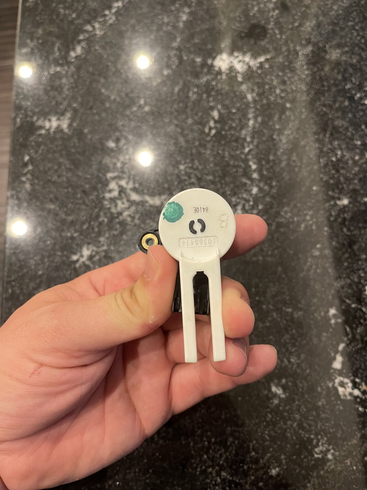

I need to know in what position the clutch and brake pedal sensors are installed.
1. When the brake pedal is NOT pressed, is the sensor Loaded or unloaded? (Loaded meaning the spring in the sensor is trying to move the arm)
2. When the clutch pedal is NOT pressed, is the sensor loaded or unloaded?
This is only applicable to the LNF position sensors
This position is LOADED
This Position is Unloaded
Thanks!

The Brake Pedal Position Sensor, when the Brake Is NOT pressed is about 90% Loaded
The Clutch Pedal Position Sensor, when the Clutch is NOT pressed is 0% loaded
If you power on the car with the BPPS @ 0% or 100% Loaded, the BCM sees it as a failed sensor and turns the brake lights on no mater if you change the position of the sensor. You must unplug the battery to reset.
The BCM is looking for about 1v from the BPPS to keep the brake lights off. At about 1.4v it will turn on the brake lights. If the sensor output drops below about .75v or goes above 5v the BCM sees a failure of the BPPS and turns the brake lights on until you unplug the battery.
For the CPPS, the BCM is looking for about 1v to call the pedal active. This relates to about an 80-90% loading of the sensor.
At 100% loaded, the BCM see the sensor as not active, but does not create a fault.
I think this is all the pieces I need to figure out how to wire in On/Off pressure sensors to use with Tilton pedal box.
