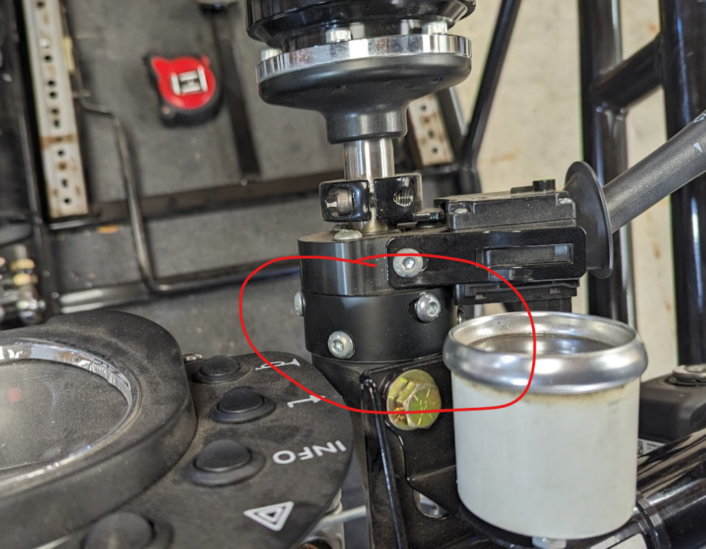

Anthony, I think any 3 hole mount steering wheel will work with the DF adapter. 5, 6 & 8 hole mounts will require an aftermarket adapter - as well as any quick disconnect will need to be adapted too.
I don't want to go with the quick release. It makes the wheel feel to close to me...
I agree, but shortening this tube is an easy modification that fixed the wheel position with the QD
49870
I took 2 inches out of it, positioning feels just right for me now.
