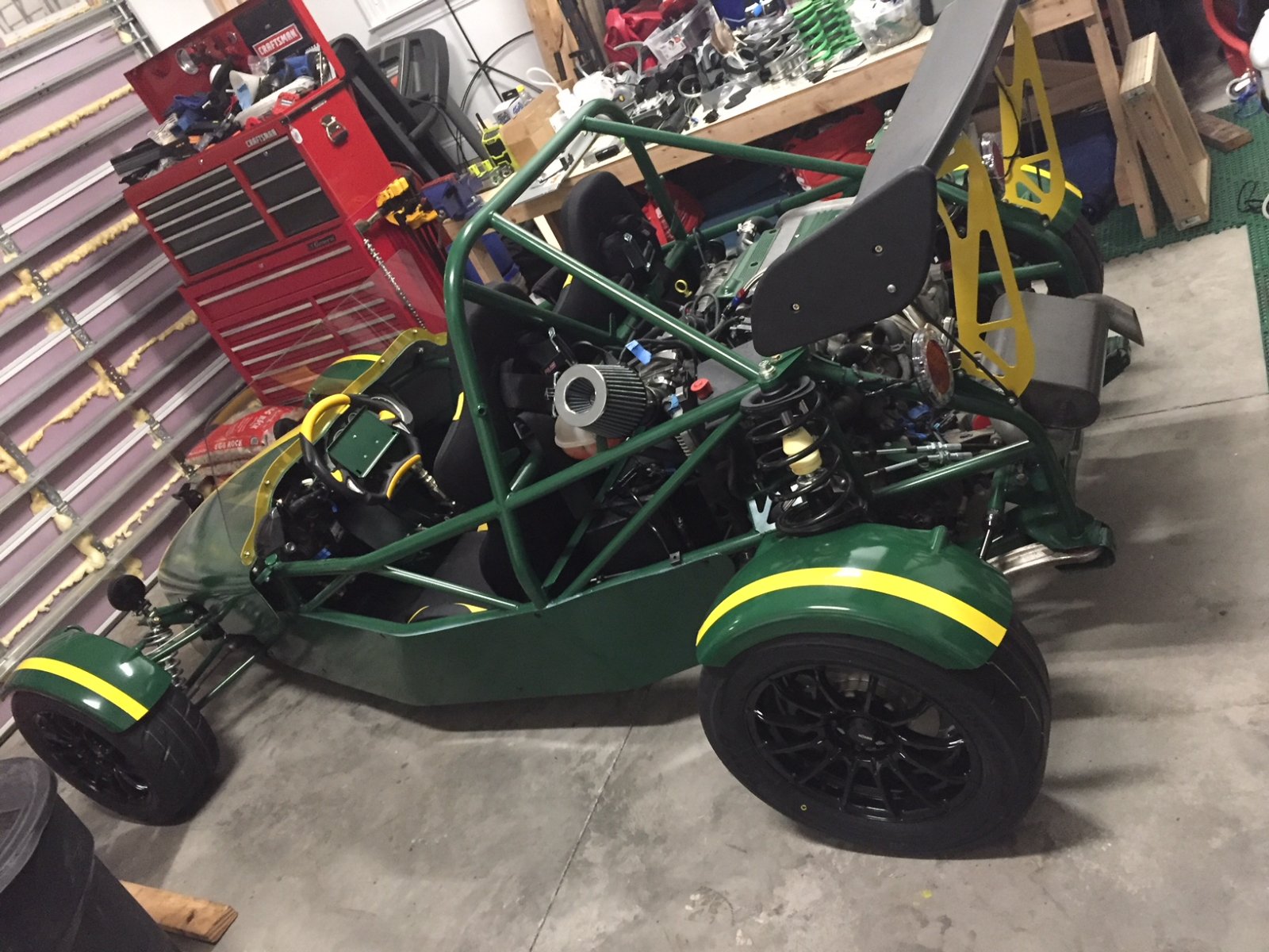

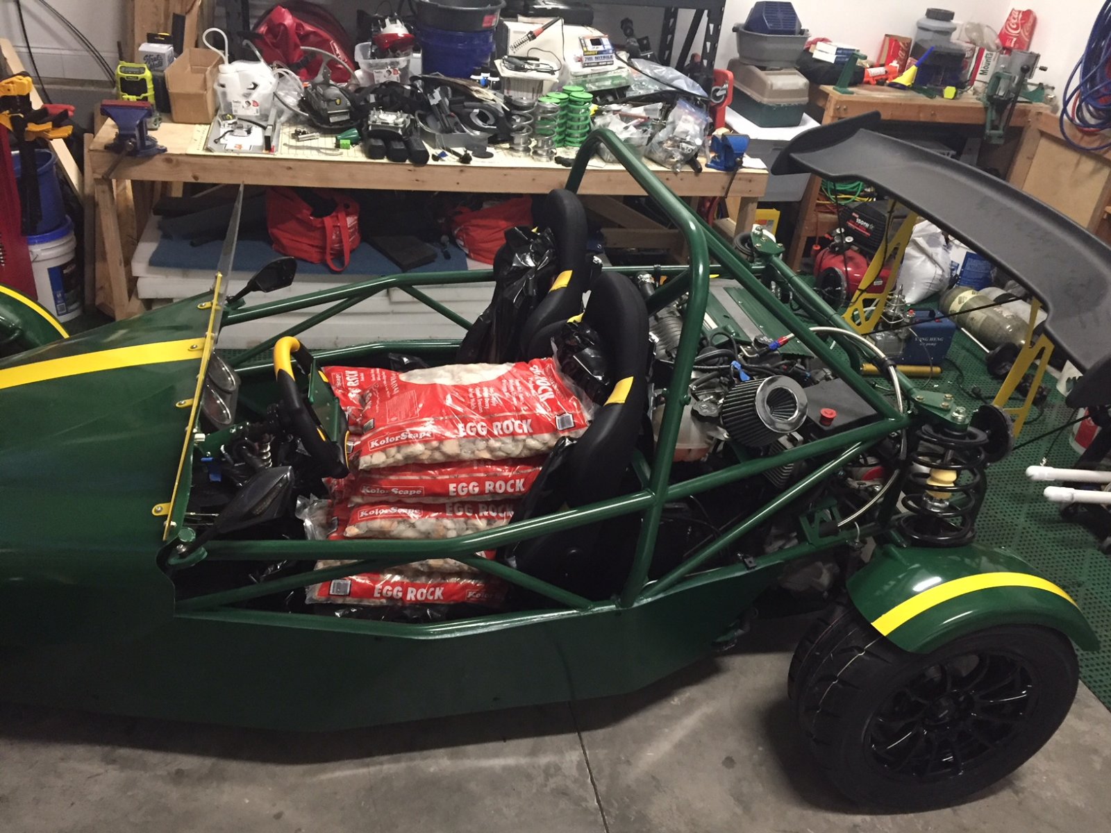

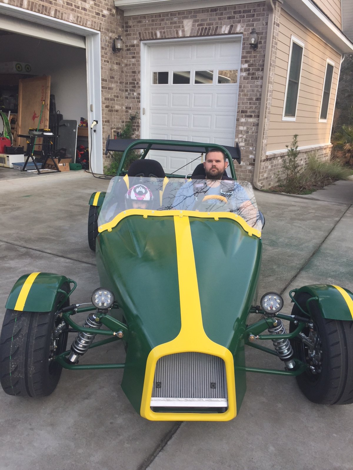

Always meant to do a build log. Too late now.

Wow! Nice! I like the way you tied the yellow in throughout the seats, steering wheel, hood, etc... If possible, please post more pictures out in the sun with some side shots and close ups! It looks really good! Next time, do a build log! ;)

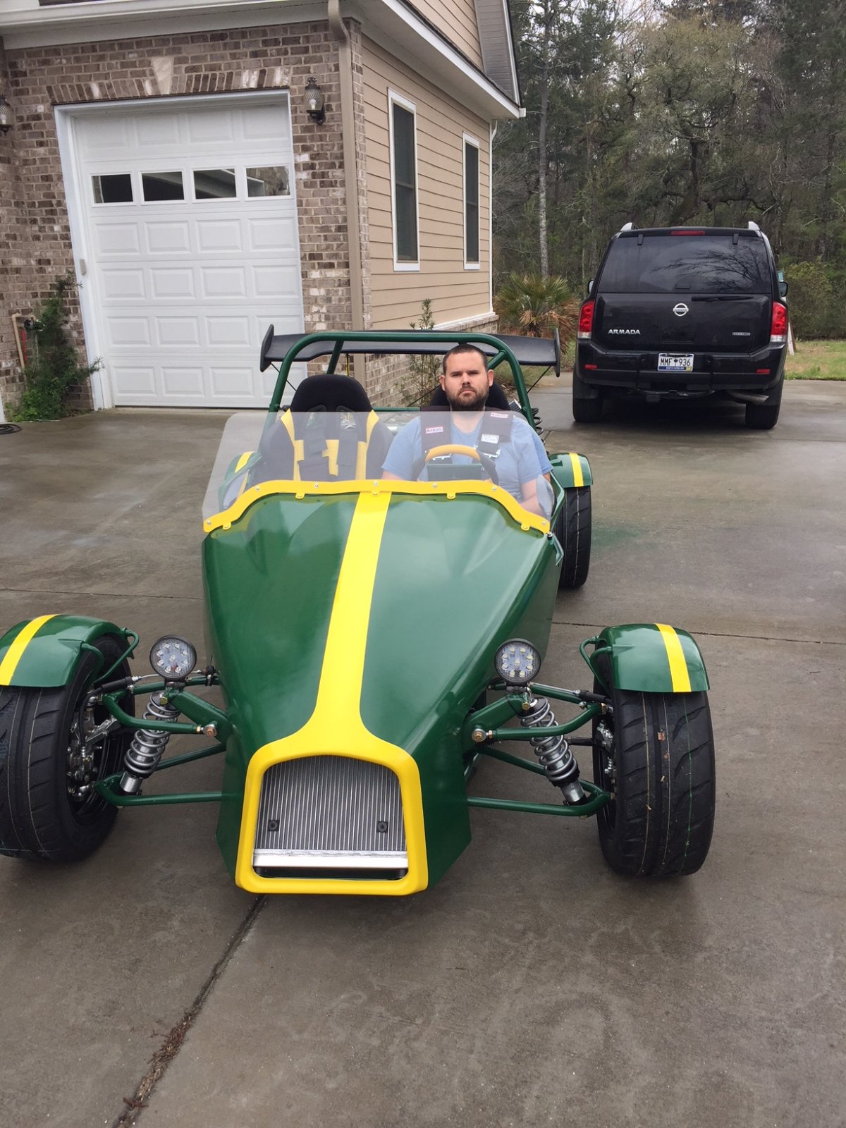

The head lights are cheap non-dot approved headlights. They are LED off road work lights off of amazon. They put out a good amount of light but I will be upgrading in the future.

I got the kit in late October already had the donor stripped. So it took me about 5 months for the build. I really enjoyed the whole build. Only tip would be really know what little extras you want to add and do it before you get almost done with the car. Also while my wire harness fit the final fit could have been better if I did it all in the chassis. I do recommend to run a low gauge wire common to all the grounds and to the motor. Ground issues suck to trace and the additional 2 pounds of wire make no difference.
