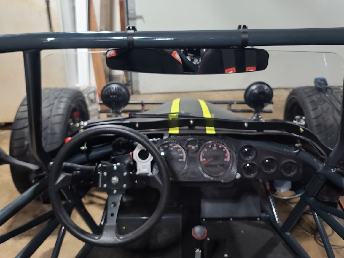

What rear view mirror did you install?
Mahkoi
I grabbed this one off of Amazon and angled the brackets toward the front of the car so it tucked up tight to the halo. Only thing i dont like about it so far is the massive brand name on the other side of the mirror. So i might paint the other side later on.
Universal UTV Mirrors, Aluminum Alloy Material,2022 New RZR Rear View Mirror for 1.5" to 2" Roll Cage, Adjustable for Best View, Compatible with Polaris RZR,Can Am X3,Kawasaki Mule,Honda Pioneer SXS https://a.co/d/8MRTvq3

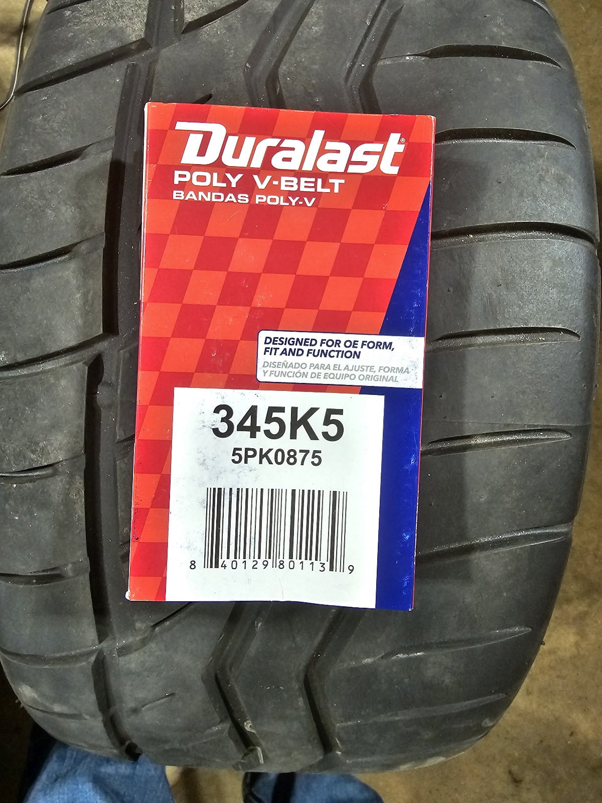

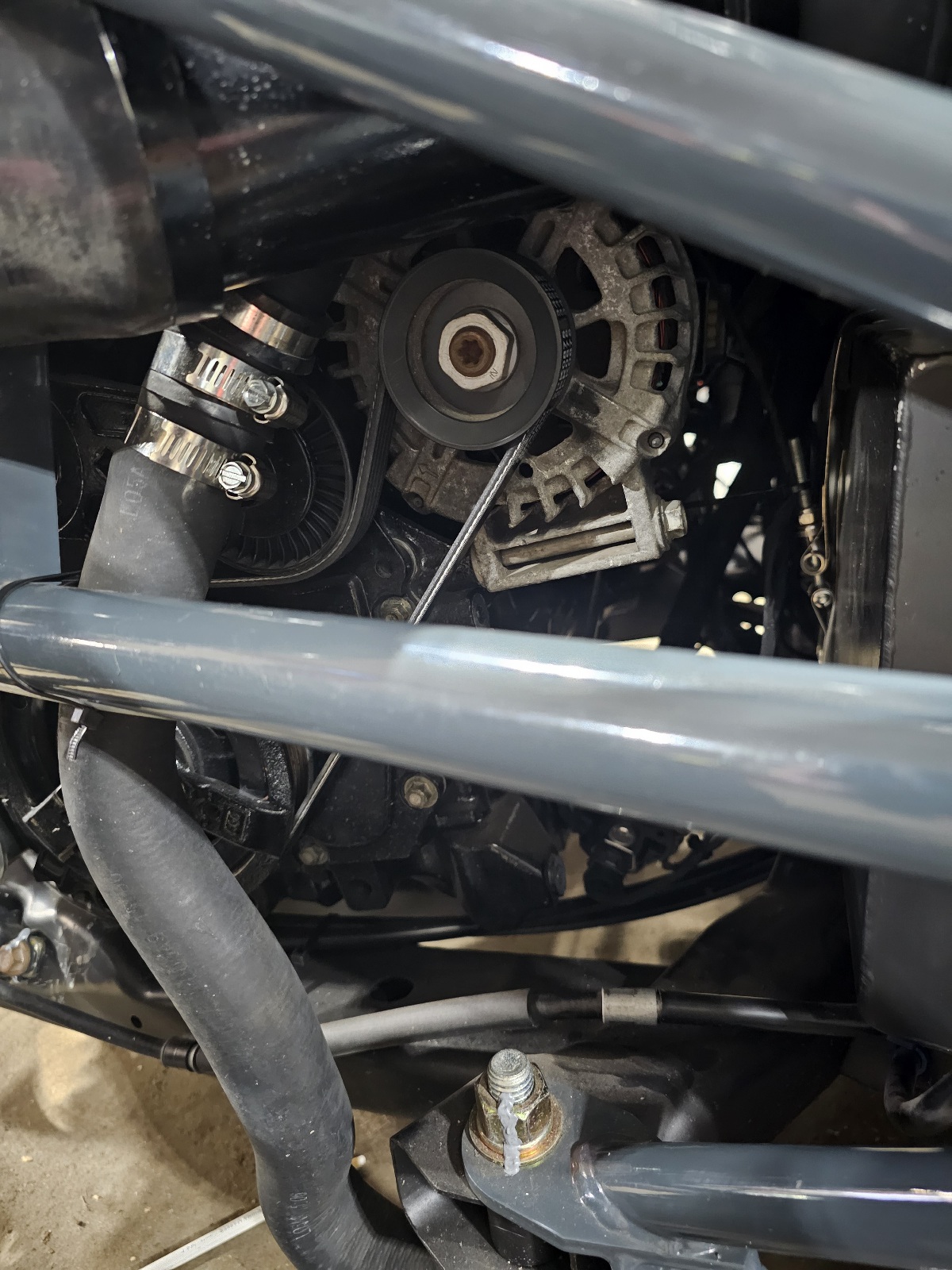

I ditched the gutted A/C compressor and went to the shorter belt. No real reason other than less moving parts to fail and I was bored since I haven't had great driving weather lately. Autozone p/n in the pics if it helps anyone else out.

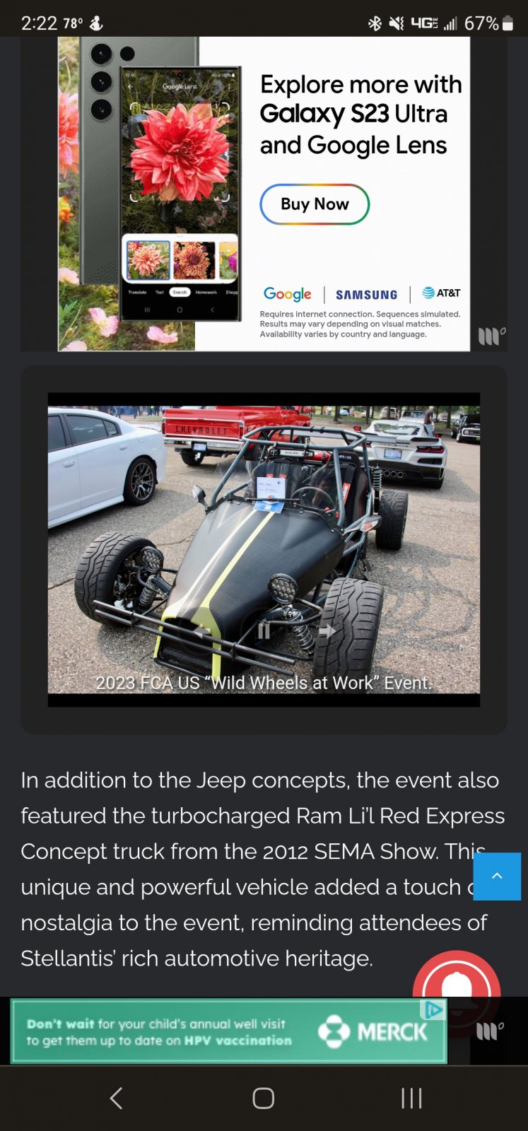

The goblin made it on the moparinsiders website.

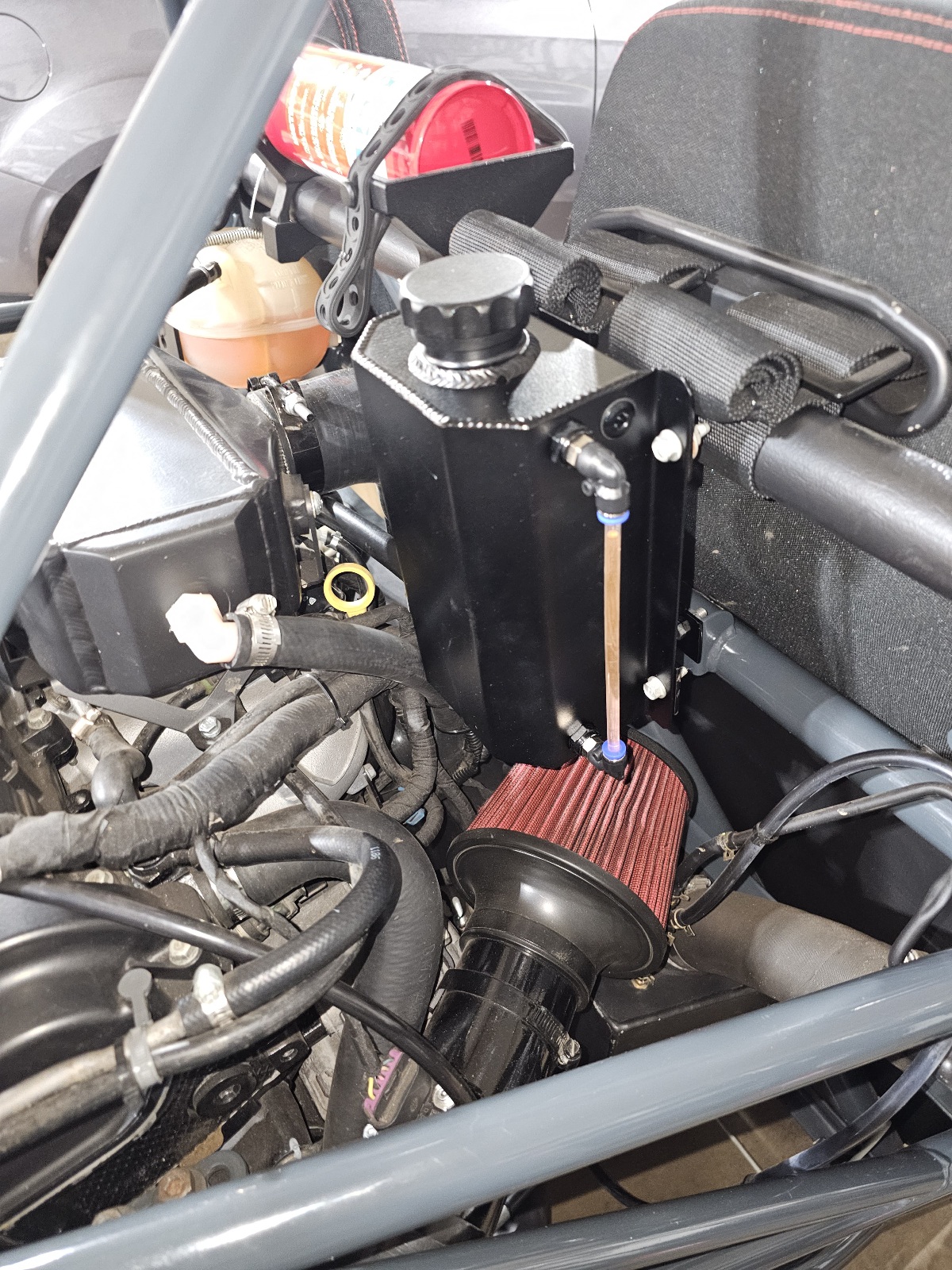

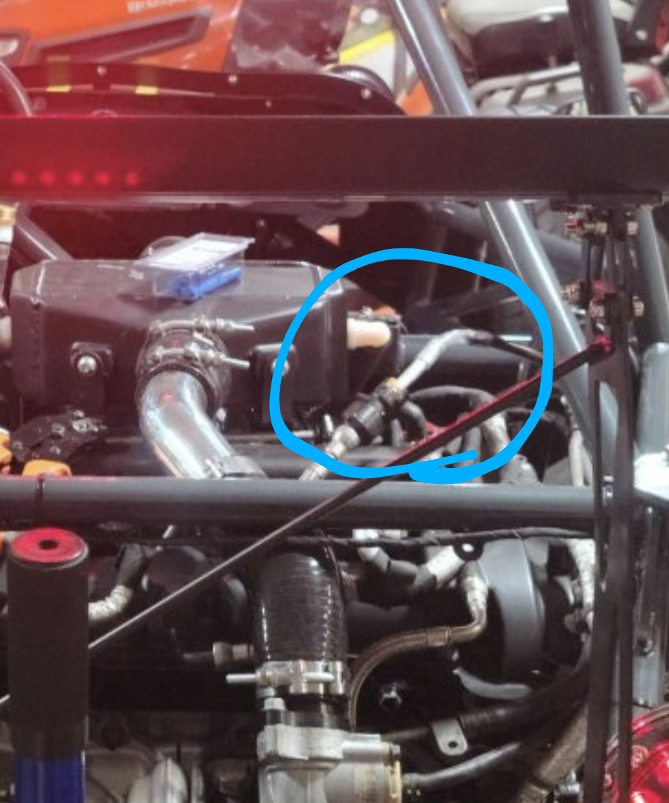

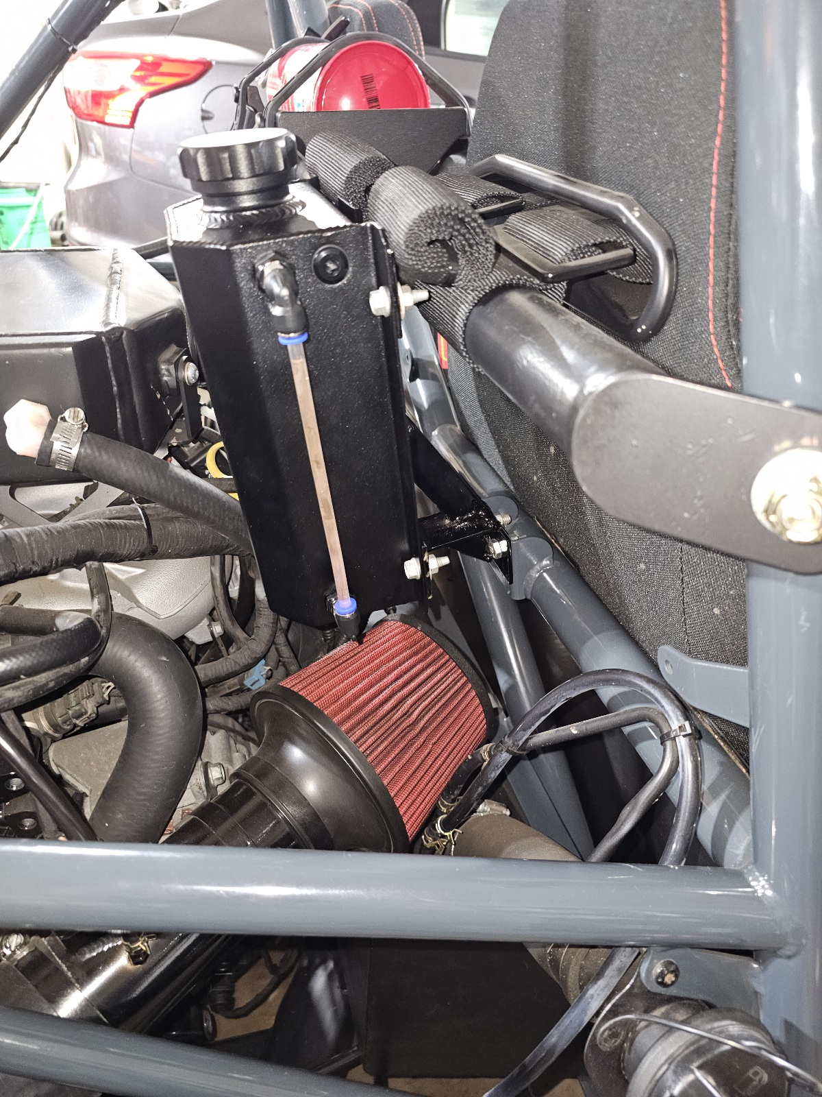

Changed up the intercooler plumbing tonight. I'm not sure if I was missing parts from DF or that's how it was supposed to be but I got rid of ace hardware supplied T and cap by the intercooler along with the half dozen hose clamps and switched it over to a reservoir that feeds in by the intake of the pump. There's still a t and half dozen hose clamps but they aren't up top and noticeable anymore. Reservoir is mounted on the passenger side with a homemade bracket and looks a lot cleaner than what was on there.
SmsDetroit
Changed up the intercooler plumbing tonight. I'm not sure if I was missing parts from DF or that's how it was supposed to be but I got rid of ace hardware supplied T and cap by the intercooler along with the half dozen hose clamps and switched it over to a reservoir that feeds in by the intake of the pump. There's still a t and half dozen hose clamps but they aren't up top and noticeable anymore. Reservoir is mounted on the passenger side with a homemade bracket and looks a lot cleaner than what was on there.View attachment 41524View attachment 41525
Where did you get that tank from?
