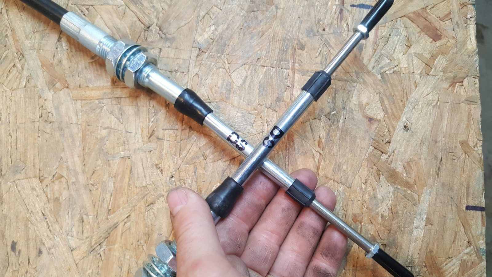

Step three
Identify one of the cables on both ends with a sharpie mark or piece of tape.
14090

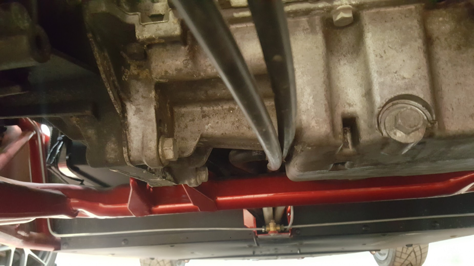

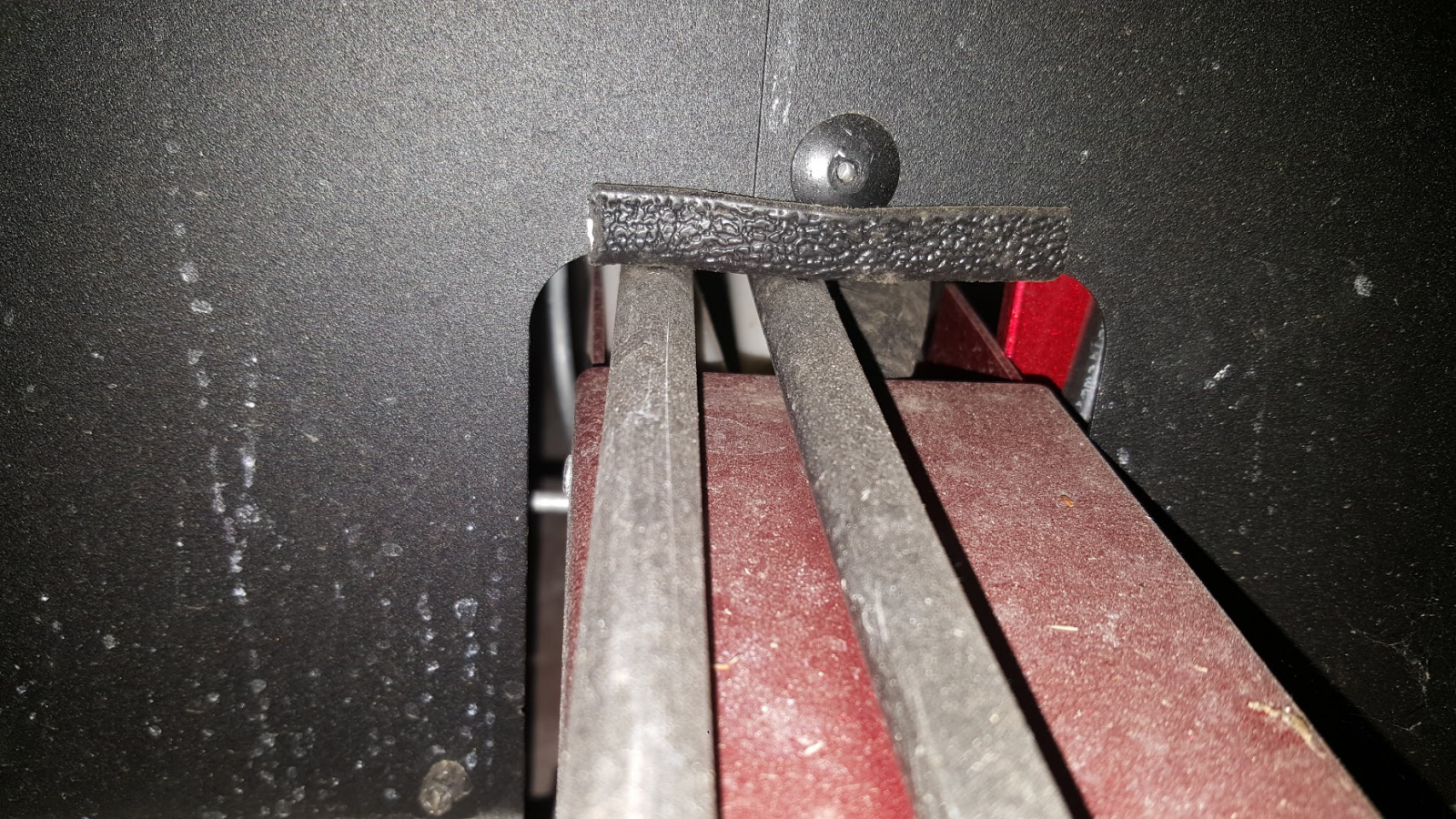

Route your two shifter cables along the tunnel and through the opening in the firewall.
14085
The cables need to be positioned above the subframe and below the fuel tank.
14086

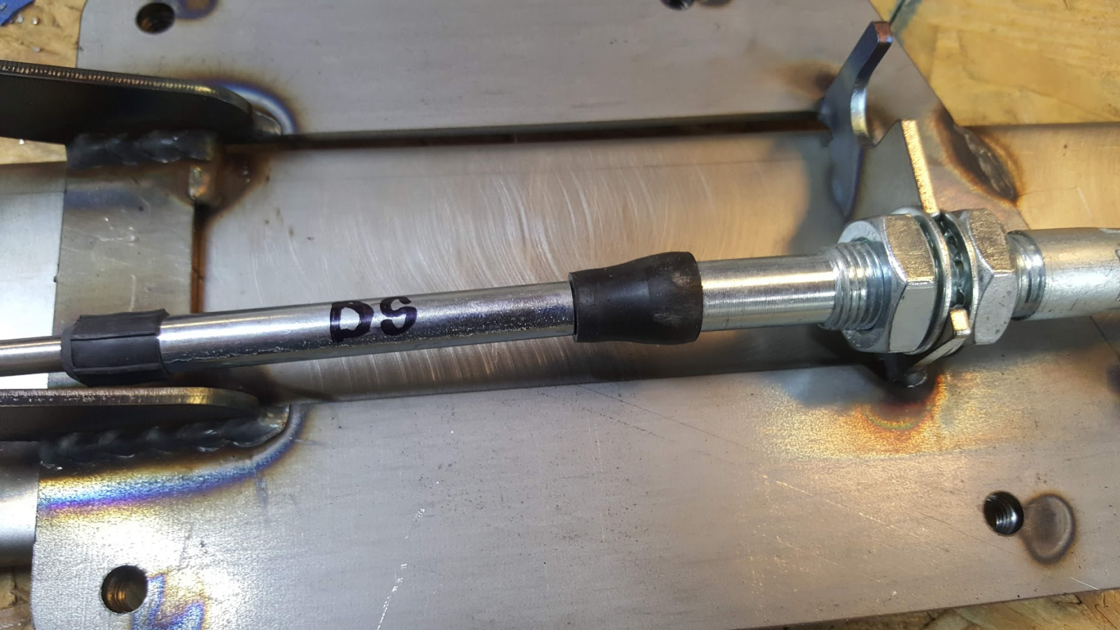

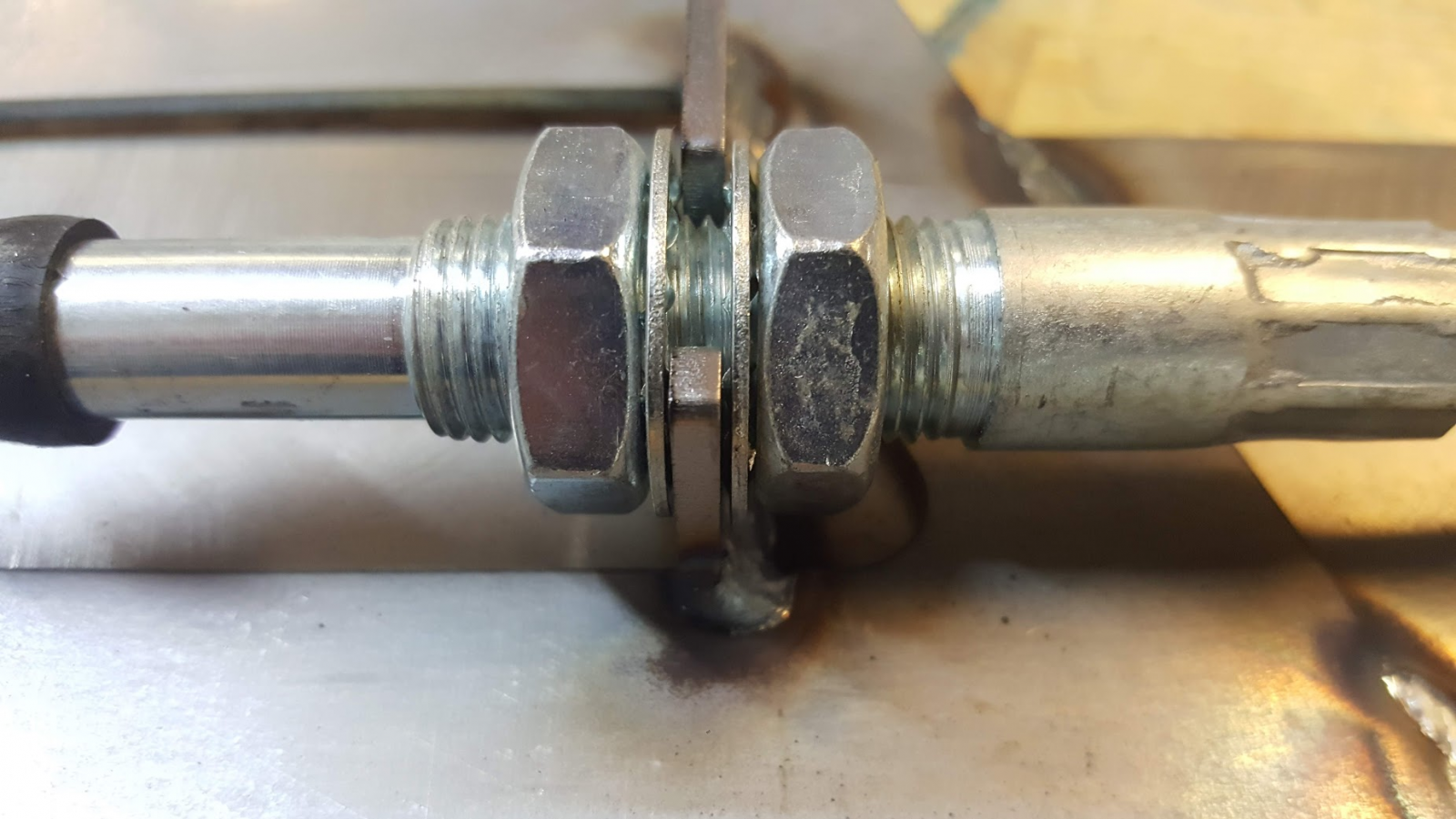

Step four
Place the cable with the sharpie mark or tape in the "U" shaped slot on the driver's side tunnel mount.
14091
Adjust the lock nuts so there is about the same amount of threads showing on each side of the nuts.
Snug the two nuts to hold it in place. These will need to be adjusted later.
Now do this again with the unmarked cable on the passenger side.

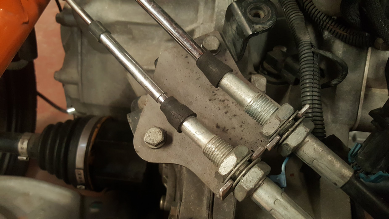

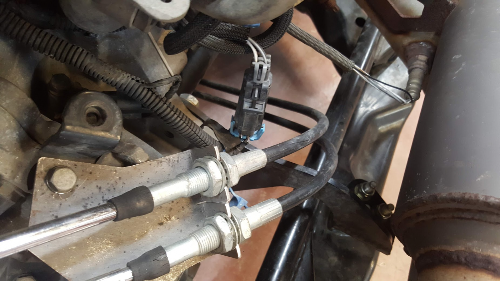

Step five
Attach the shifter cable that you identified earlier to the shifter cable mount bracket near the transmission on the driver's side.
As you do this, route the cables so they make as smooth a radius as possible.
14089
Make sure it doesn't get too close to the exhaust system.
Adjust the lock nuts so there is about the same amount of threads showing on each side of the two nuts.

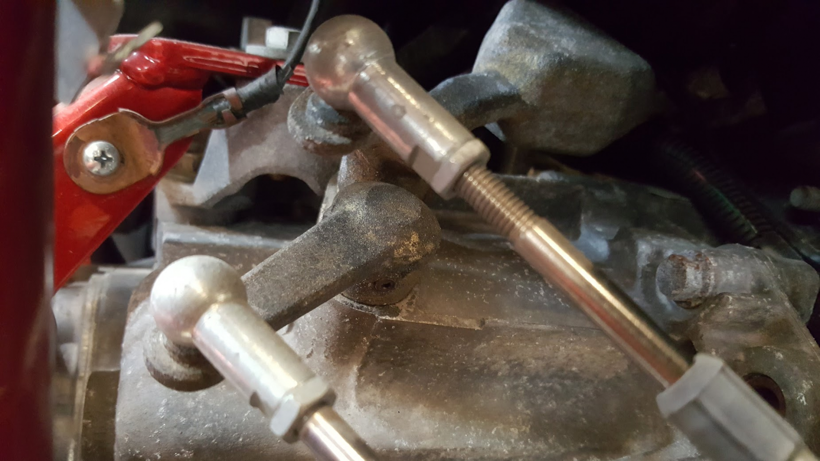

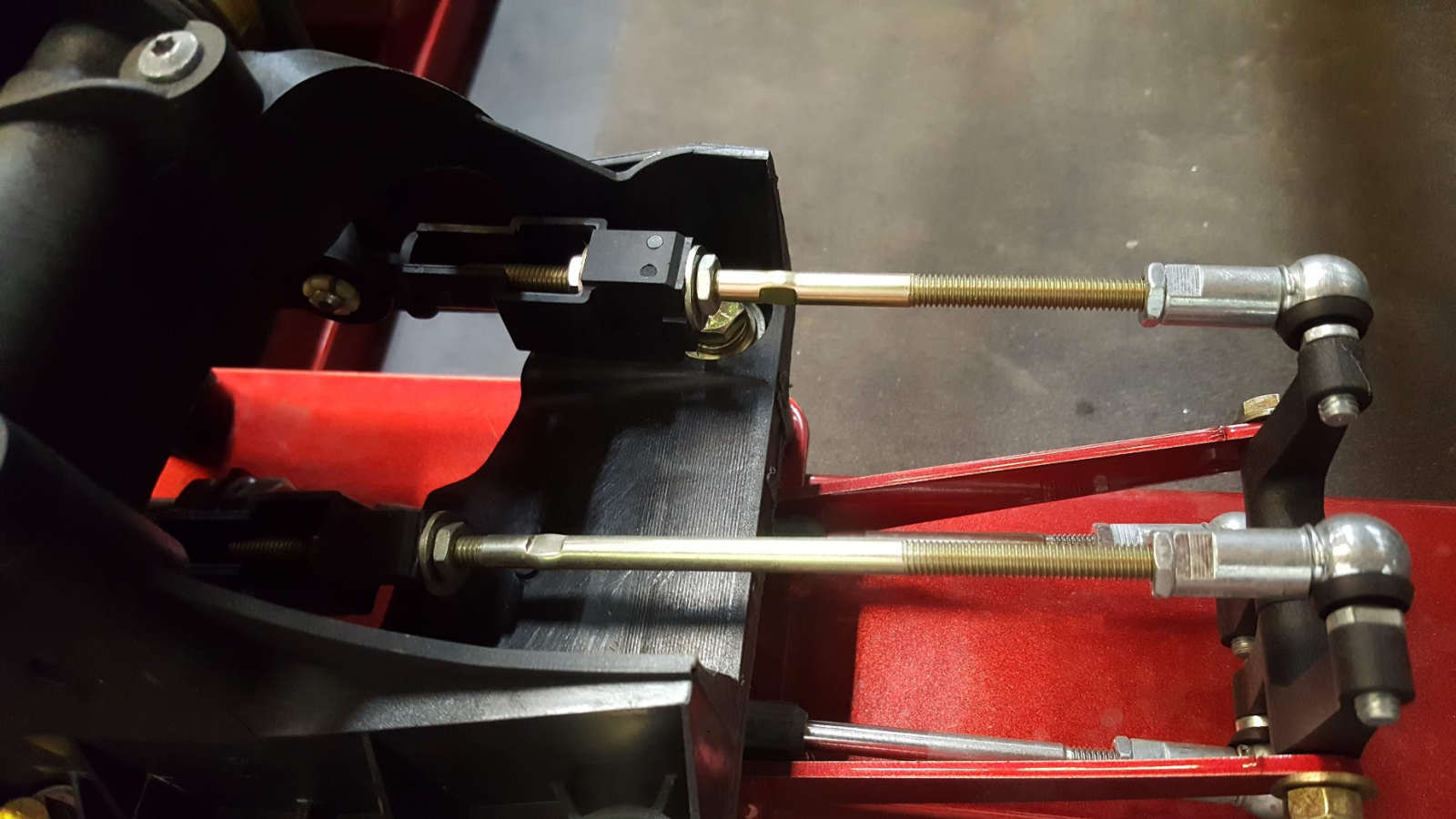

Attach the rear cable ends to the transmission shifter arms using the supplied rod ends.
14092

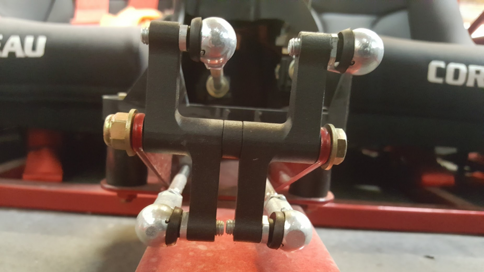

Assemble the bellcranks to the tunnel.
Leave the nut for the long cross shaft bolt loose enough that is doesn't cause the bellcranks to bind.
14094

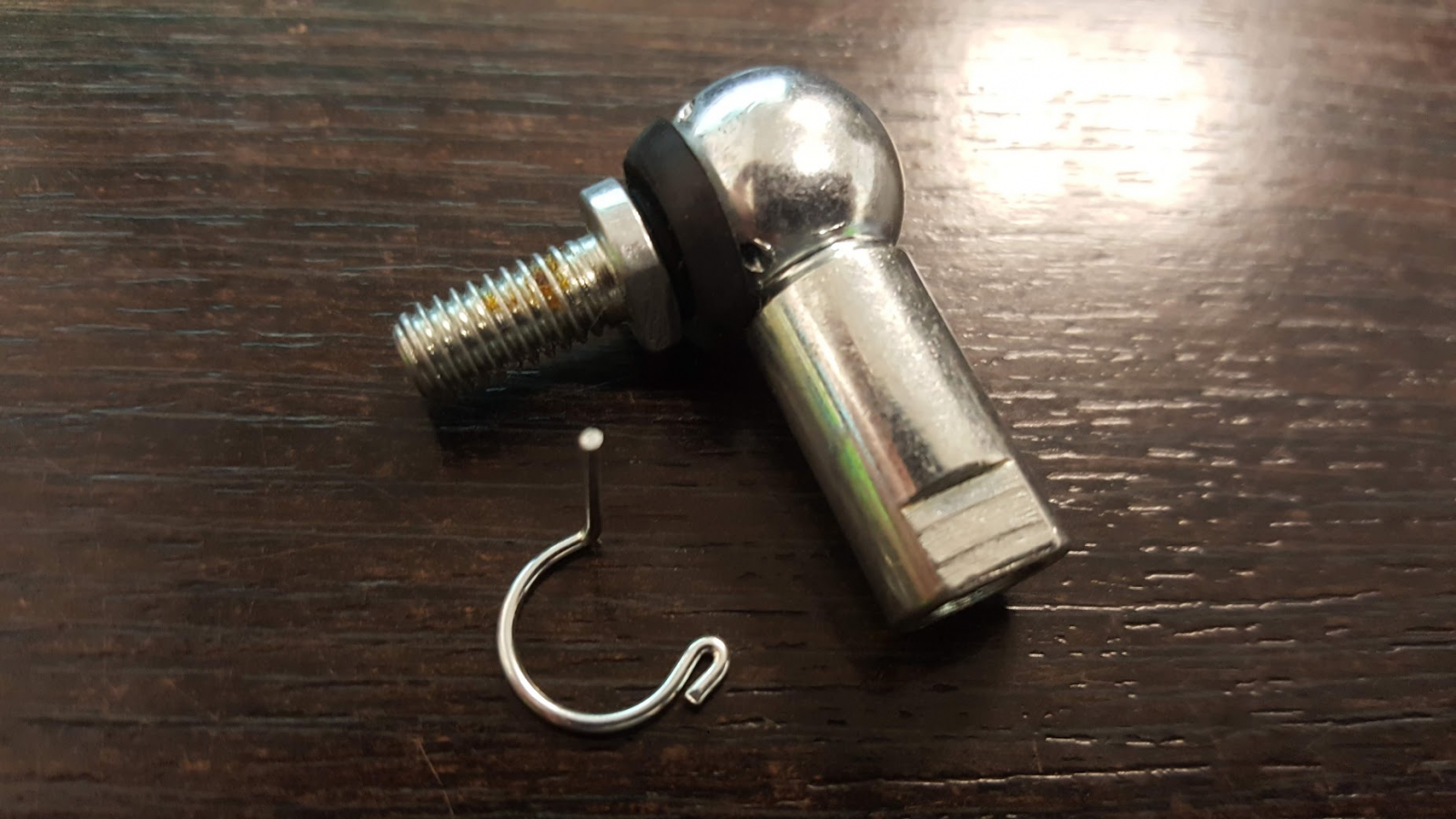

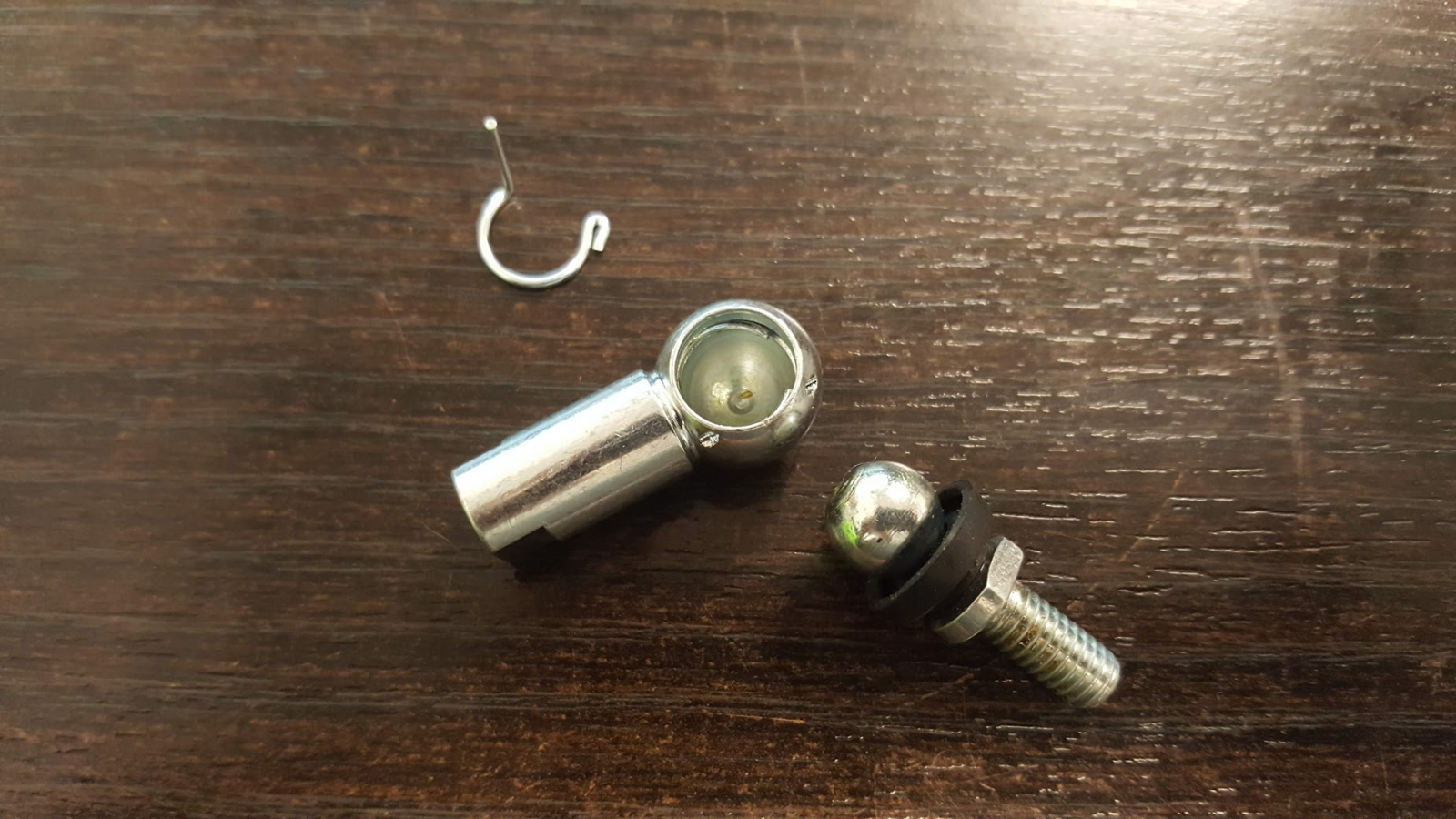

Remove the rod end retaining clips.
14095
Pull the ball studs from the rod ends.

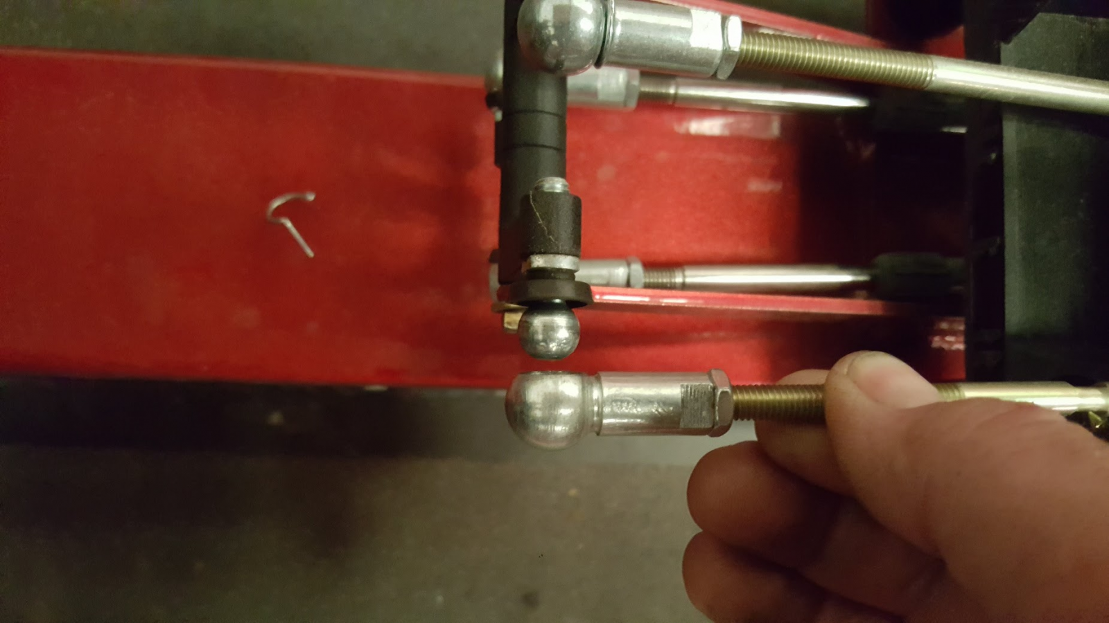

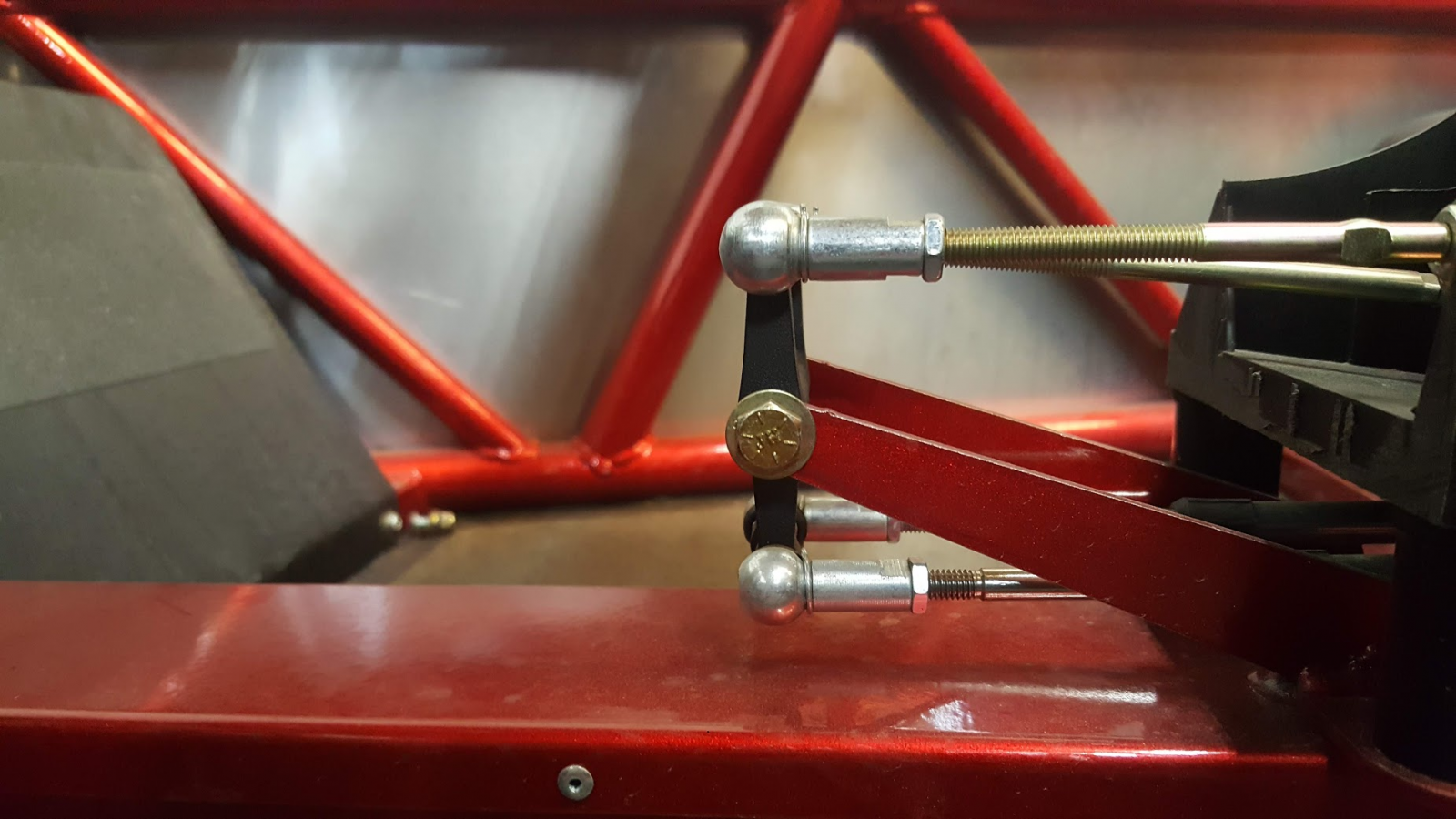

Attach the rod ends to the cables.
Attach the rod end ball studs to the bellcranks.
Do not reattach the ball studs to the rod ends at this time.

Adjust the cables by repositioning the locking nuts closer to one end of its threads or the other.
The cables need to be adjusted until the bellcranks are straight up and down. Perpendicular to the tunnel.
14097
You will likely need to adjust both ends of each cable to achieve this.
DO NOT PROCEED TO THE NEXT STEP UNTIL THEY ARE ADJUSTED PROPERLY.
