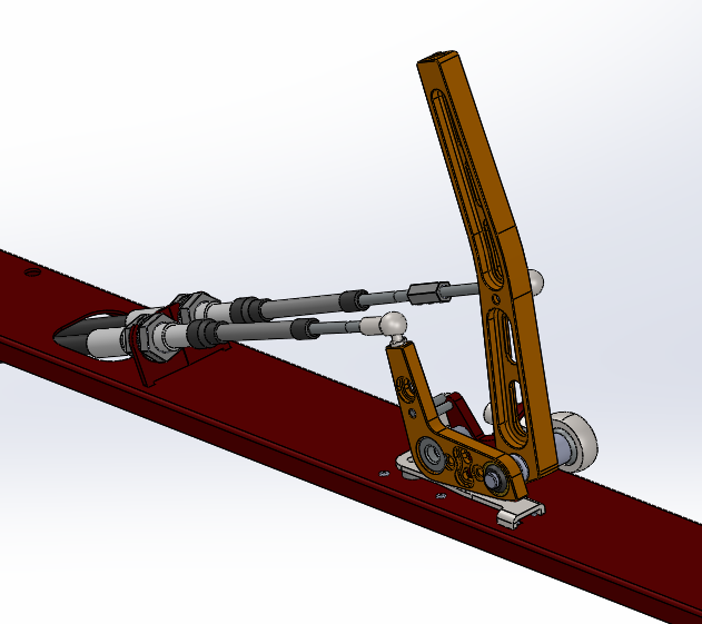

For some time now we have been designing a shifter to replace the worn-out stock shifters and reverses and have now finalized a design.
23448
It has changed a little from the image below. After testing we redesigned it to be closer to the passenger side of the Goblin.

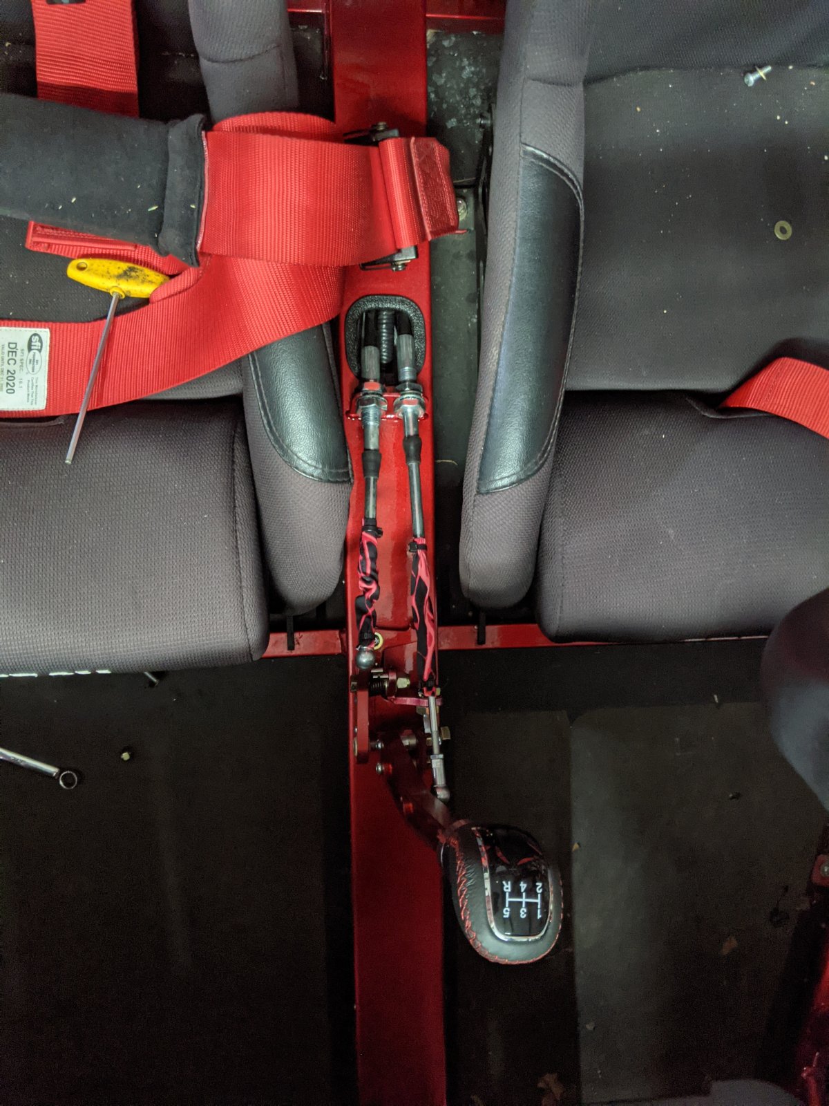

We have the prototype installed in Adam,s Goblin.
We replaced the rubber dust covers with flexible socks to reduce the drag on the cables.
We will be testing it around here and if all is well we will have it in while at the meetup next week.

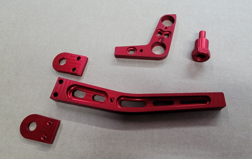

They will be anodized in various colors and clear.
The kit will include a replacement tunnel cap.

And how about the “feel” versus stock?
How does the throw distance compare to stock?
reuses the cables already on the goblin?

I would suggest sticking with the stock shifter for most people. Especially for the ones that do not care as much about smooth, quick-shifting because with the stock shifter the reverse lock-out can be moved without taking your hand from the shifter knob.
Our shifter is designed more towards performance and would not be for everyone. The lock-out has two functions, it allows you to go into fifth gear without hunting and it keeps you from accidentally going into reverse.
Originally we had thought about using a gated plate design but were worried that we could end up with the shifter shaft rattled against the slots unless our builders got everything adjusted perfectly.
We also felt it would be best to lock out reverse because if you are topping out in fifth (178 mph) and try to grab sixth we don't want you accidentally grinding reverse. :cool:

I got to swing by DF today on the way up to Dallas to visit family for Mothers day.
As always Lonny and Adam were excellent hosts.
Below is a top view of the shifter.
A couple of notes.
1. You do not have to install the reverse lockout. However the reverse lockout switch plate also makes shifting to 5th gear very direct and positive.
2. While the height looks taller than the stock shifter, it is basically the same height. It is an optical illusion based on the big black bits of the stock shifter we are all use to.
3. If you feel like you might need reverse, before you get on your way, you can always move the reverse lockout plate to the "reverse" position and the car will still shift like normal, just engaging 5th becomes more of a "guess". Other than on the highway, we really dont use 5th that much. I know I never made it to 5th in mine.
4. The effort to shift is minimal. You can flick your wrist to go from 3rd to 4th.
I see no issue with the parking brake even though it is not in the car I sat in. I think it might need to be shifted further back.
