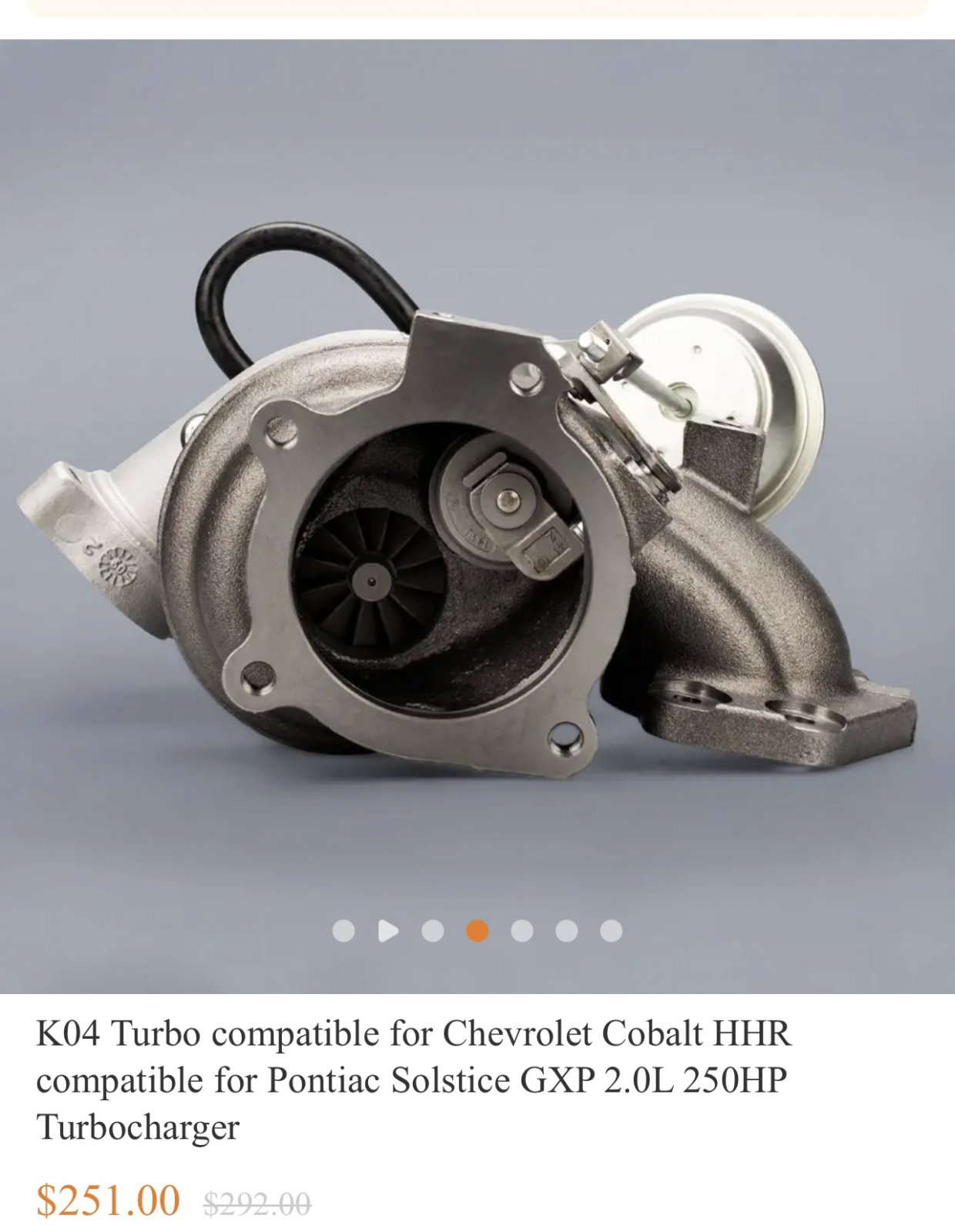

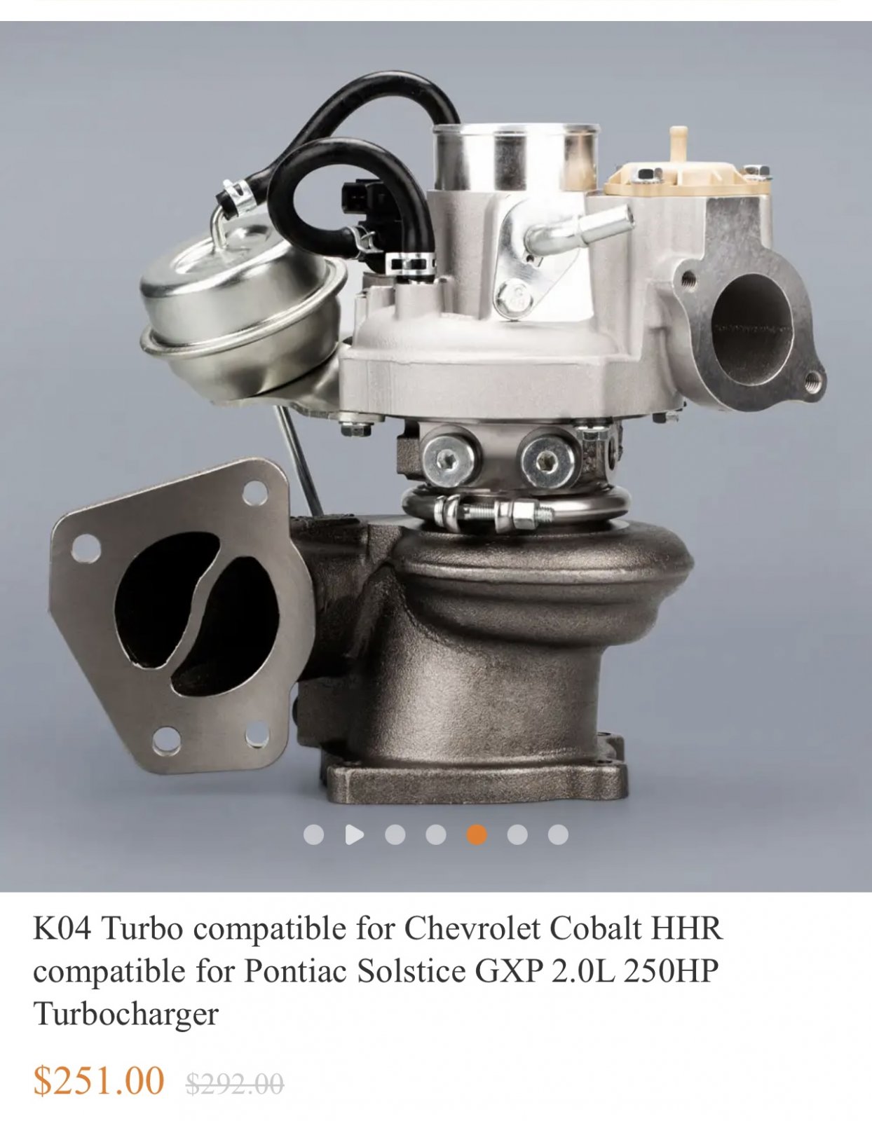

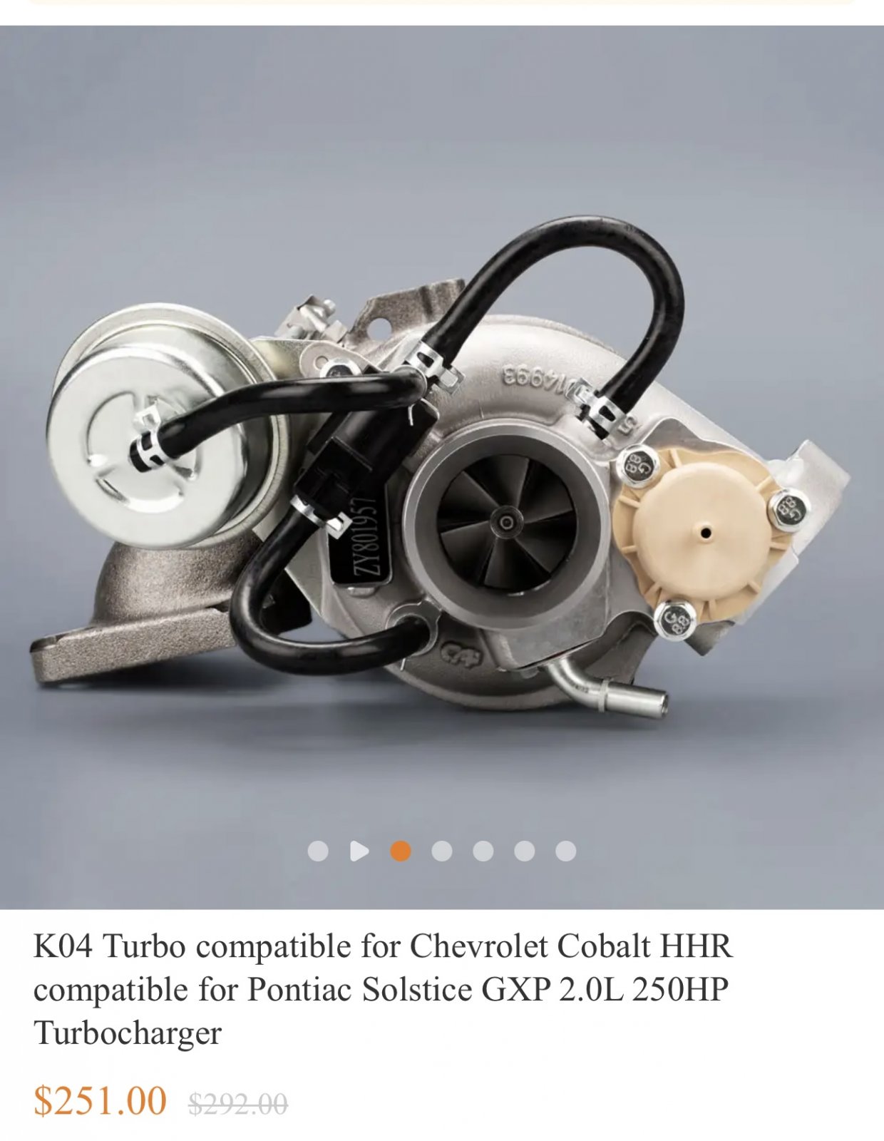

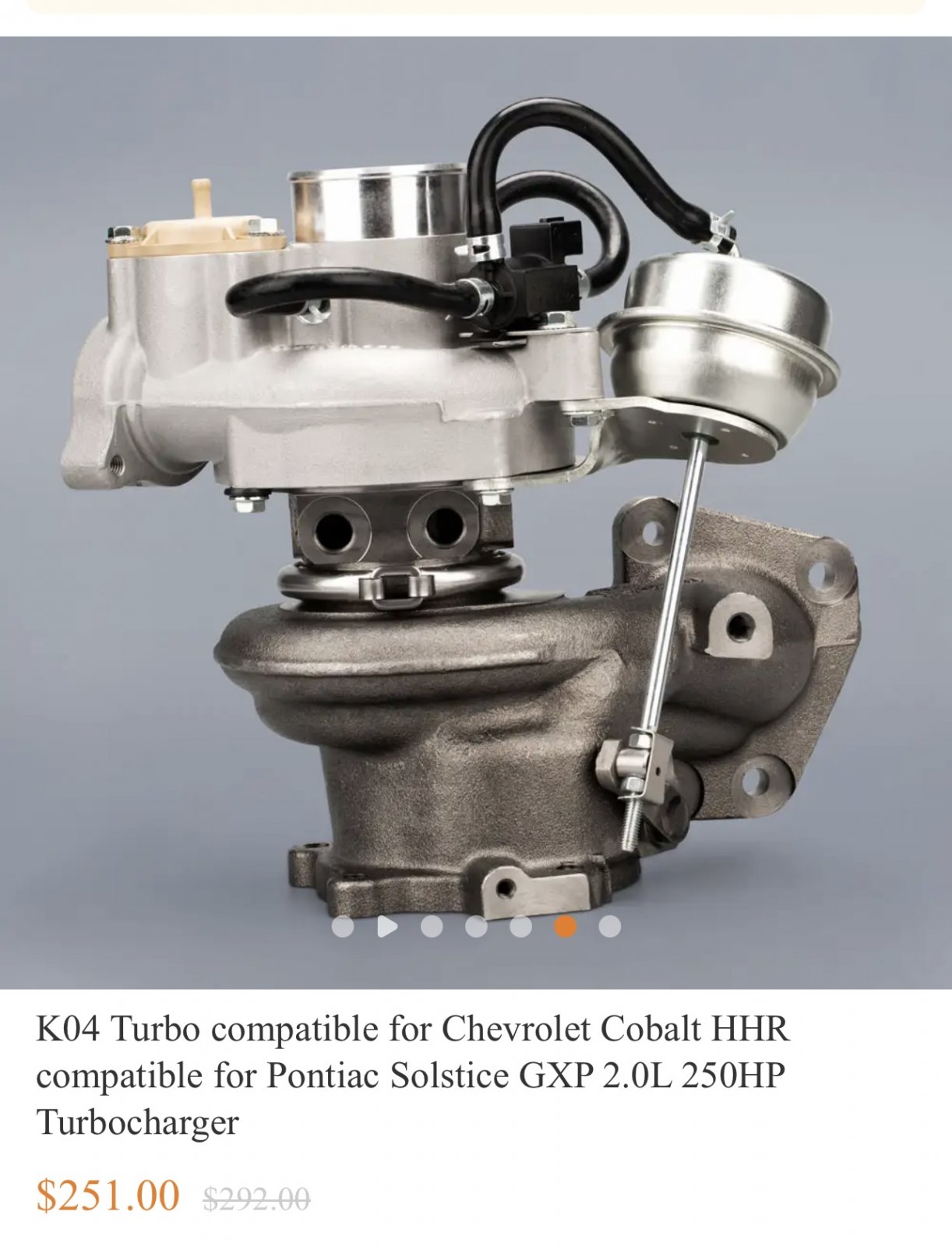

Iam gathering internals for a 2.2 lap. Has anyone been able to figure out which turbo kit can be used from maxpeedingrods? Zzp has been out of stock for a year now
D&dgoblin69
Here’s maxpeeding rods colbalt ko4 turbo Iam looking at

Turbo exhaust manifold, O2 down pipe, boost sensor, wastegate controller, radiator coolant feed and return, oil tapped feed and return, charge pipes, intercooler (including coolant pump, heat exchanger, coolant lines), ECM programming and probably a half dozen things I'm forgetting. Thus the reason it is much easier to purchase a turbo kit - unless you are good at scrounging and matching parts to work together.
