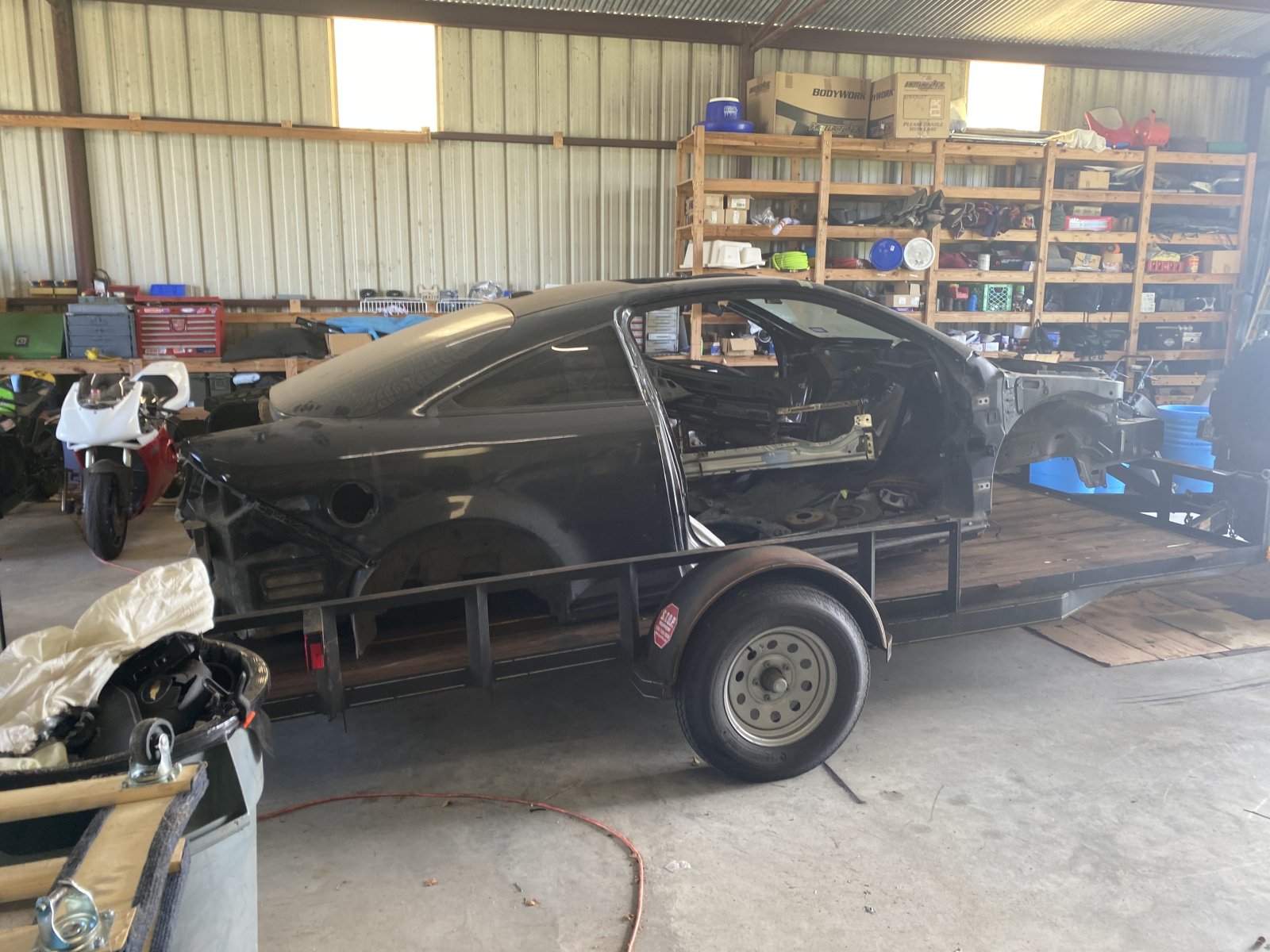

But in the mean time, I am getting this to be my test mule for me to cut up and plan on
17005
Classy
I plan on running the factory subframe up front, and the aluminum LS4 subframe in the rear. As of now, I am planning on using the factory shock mounting points and making longer front LCA’s to increase the front track width

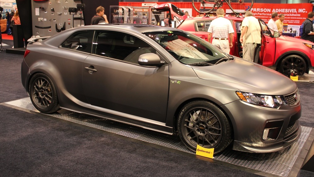

So, I have been reviewing this build in DETAIL! And I have decided not to build a cobalt, there are too many issues with doing it... I would have to widen the front track to meet the impala front (now rear) track. This means widening the body front and rear. I need 5x114.3 hubs, venting was going to be a nightmare on a cobalt. So I went in search of another FWD Coupe that would fit my needs better and look better in the process. (Never really liked how cobalts looked). In my search, I found the Kia Forte Koup. It almost looks like a modern Fiero, it has the right track width, and 5x114.3 hubs. The best part is venting will be much simpler over a cobalt. So, I will be on the hunt for a Kia to LS swap

I have seen the twin engine impala, I am using a lot of the pictures for reference. I was actually planning on taking the rear side windows out and making an inset louver. I know that you can make anything work, but this is much simpler. Being the right track width, I won’t need to do any body modifications for wheels except maybe some rolling and pulling, flares in the worst case scenario. I will make body modifications for venting and scoops.
And at the end of the day, I think it looks MUCH better
