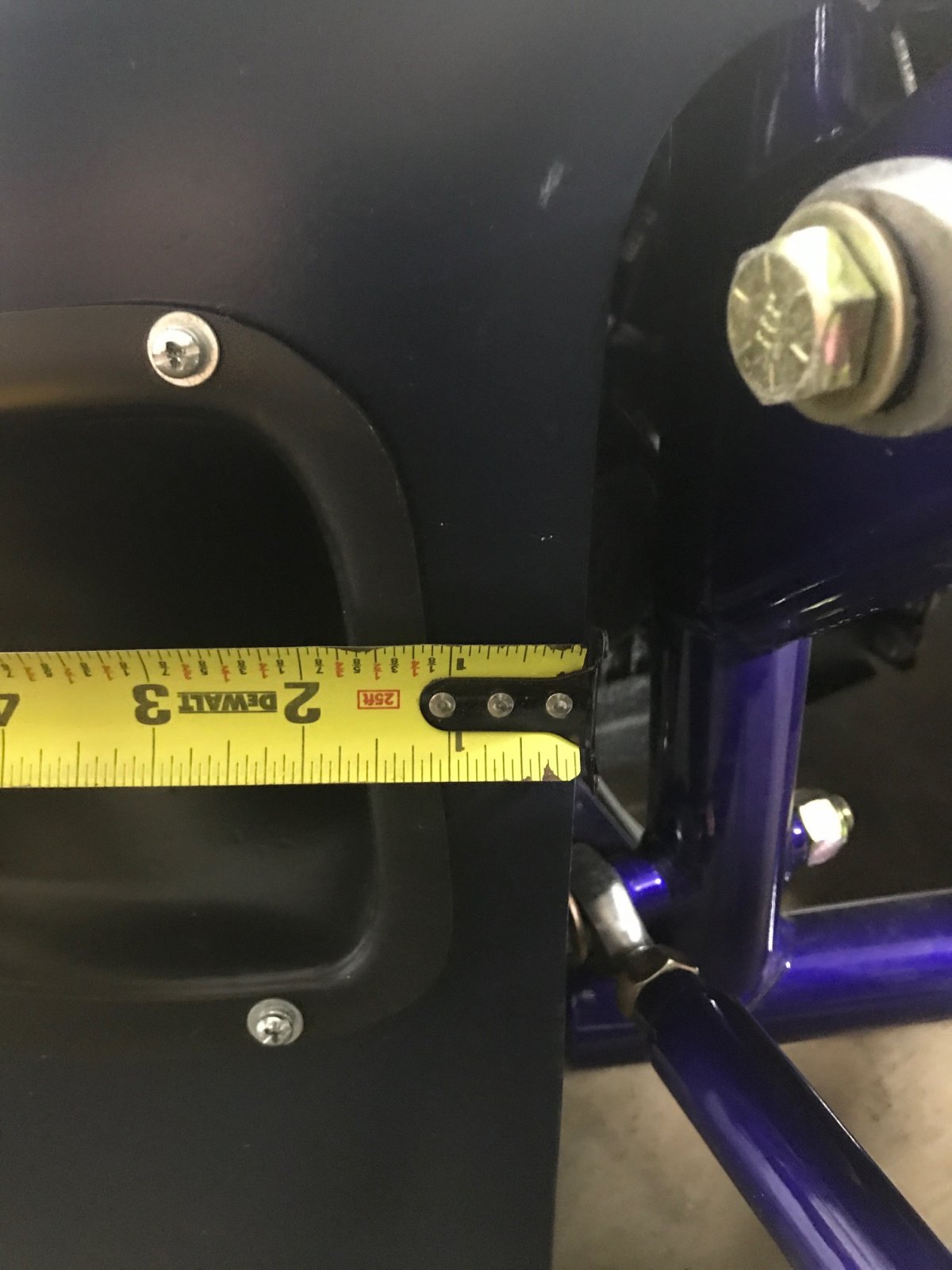

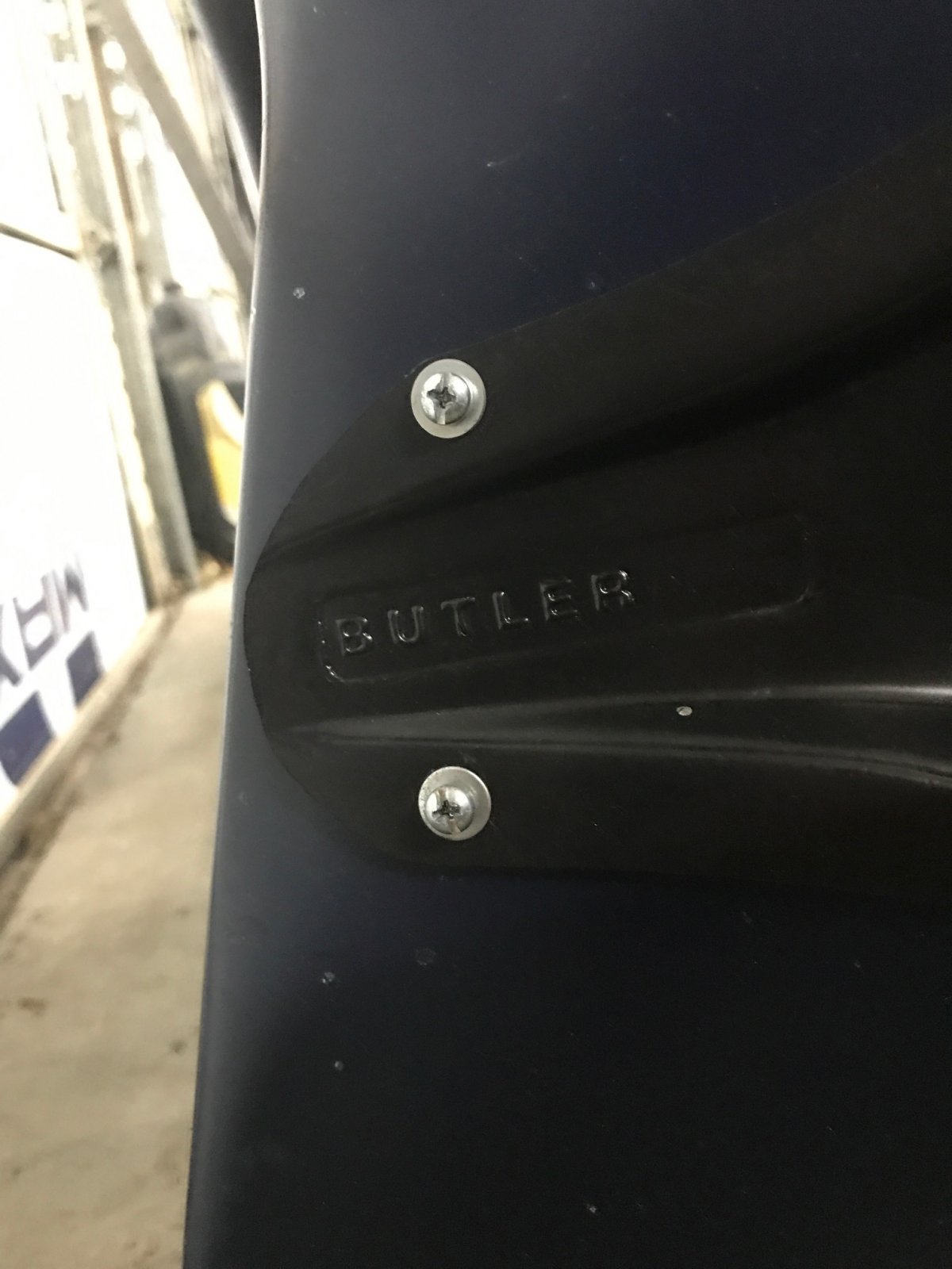

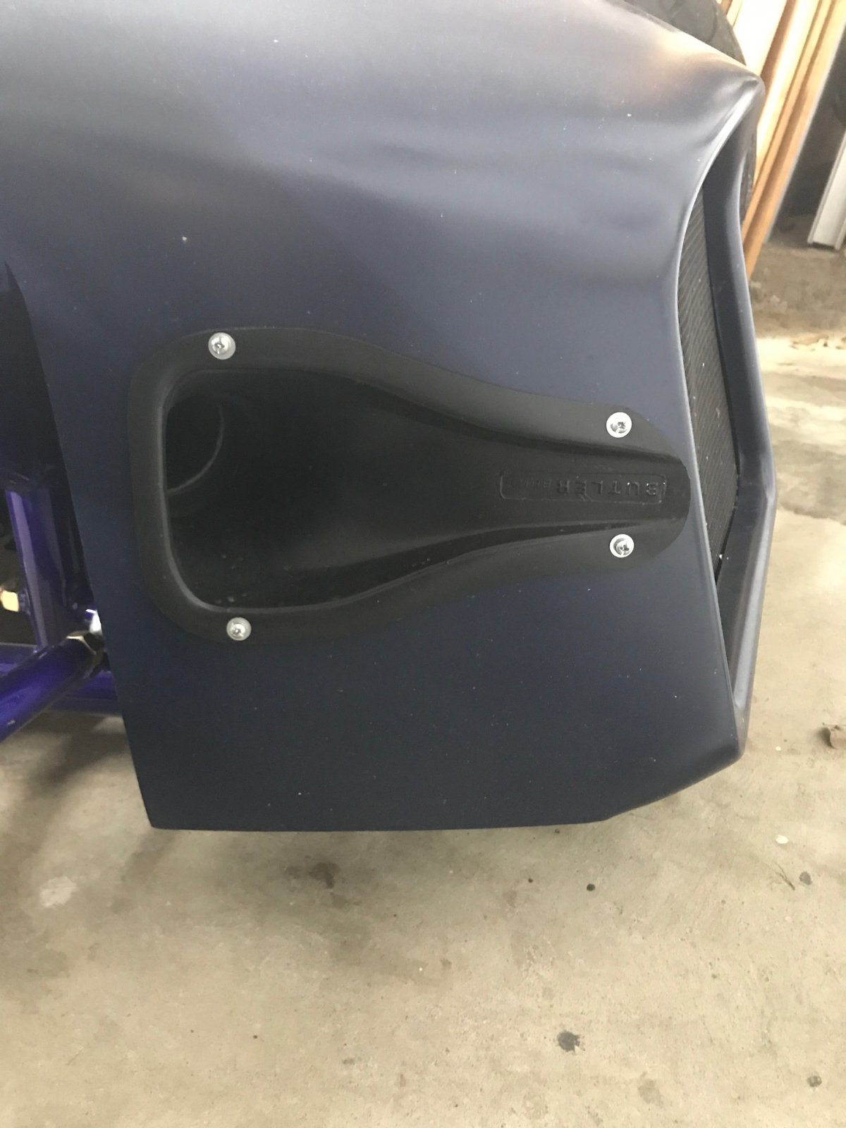

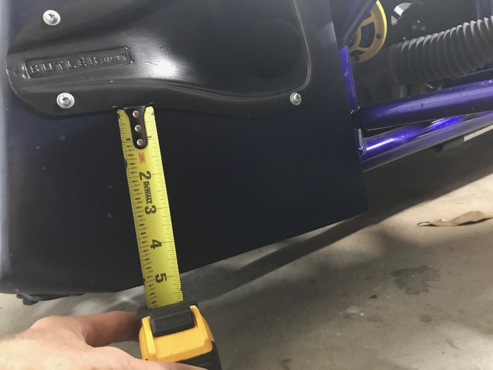

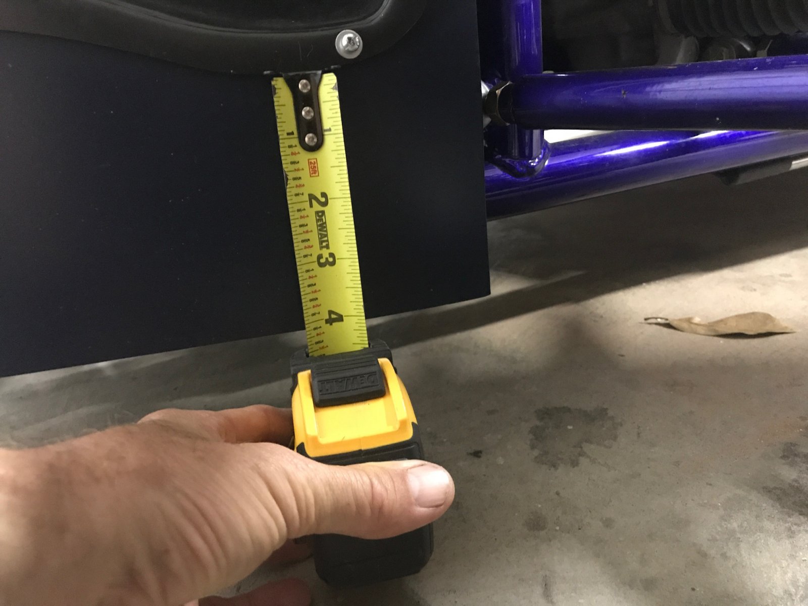

How did you get your vertical alignment?
Trace your duct on some paper. Offset it in about 3/4" and draw another line. Cut on lines leaving a "ring".
