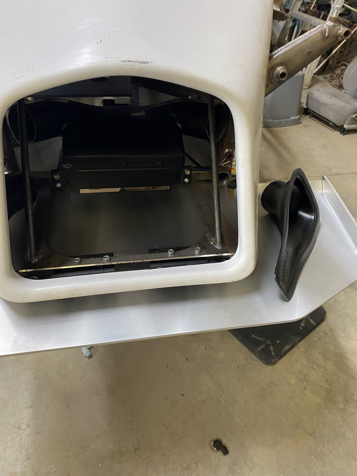

Has anyone tried mounting the naca ducts on the inside and also had their hood tilting? I need to mock up the radiator to check clearance but I’m optimistic it can be accomplished

How would you make the NACA duct to heat exchanger plenum to disconnect and reconnect? Would be awkward at best, unless you fab up an angled face plate with a foam seal for the plenum and duct to join when the hood is closed.
And I've seen a few builders mount the NACA ducts to the inside of the hood too. Troll around some builders logs to search for 'NACA'.

The angled flange is what I was thinking also. I have trolled around and found the ducts mounted on the inside and the wife likes that clean slick look. Now to think what to make flanges from

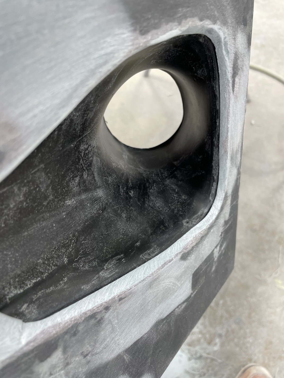

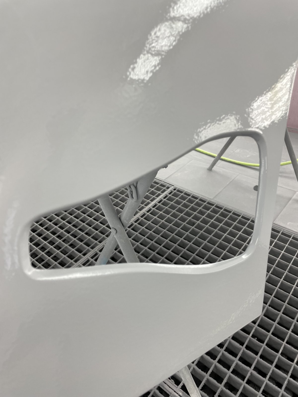

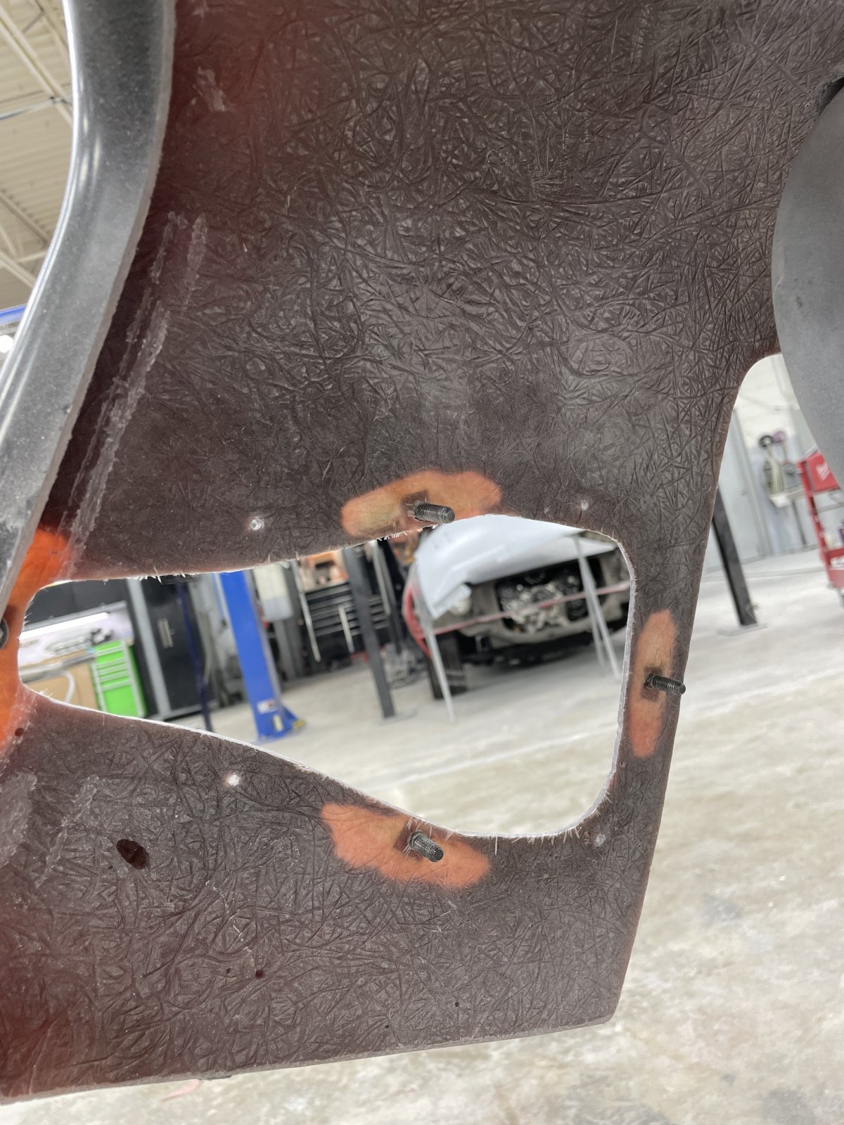

I glassed in studs inside and then body worked the opening for a smooth finish 66715041194__7ED77415-CA17-4CCB-A0A6-FCF7CB36E889.jpeg
