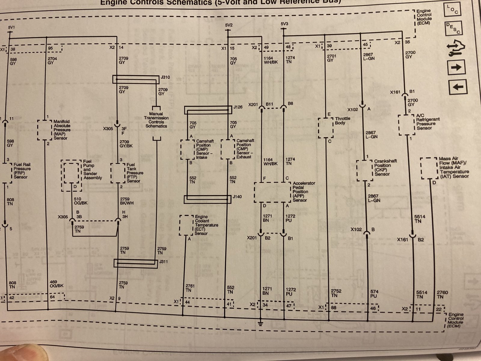

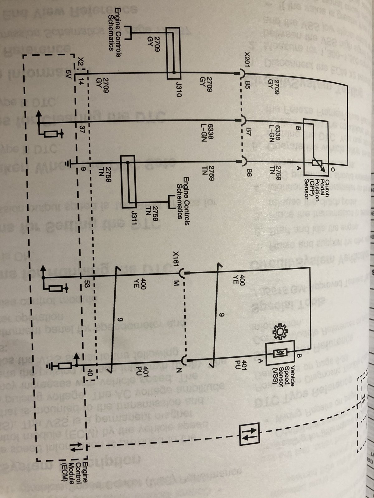

During the thinning of my main harness I somehow cut the Grey B5 and Tan B6 wires on the body to dash harness. I think these wires go to the 58 pin ECU connector but I have no idea where on the Molex plug these pins are, I think the Grey B5 goes to position 14 but I am not sure and I have no idea where the Tan B6 wire goes. Not sure how I ended up cutting them out in the first place. Any help is greatly appreciated.
Gray is circuit 2709, tan is circuit 2759.
