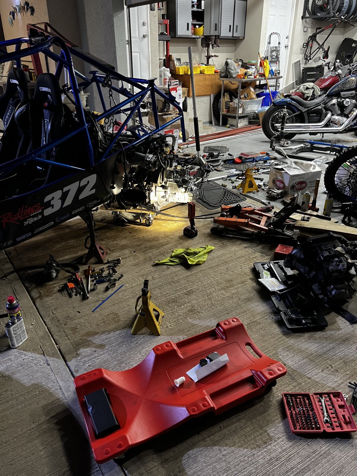

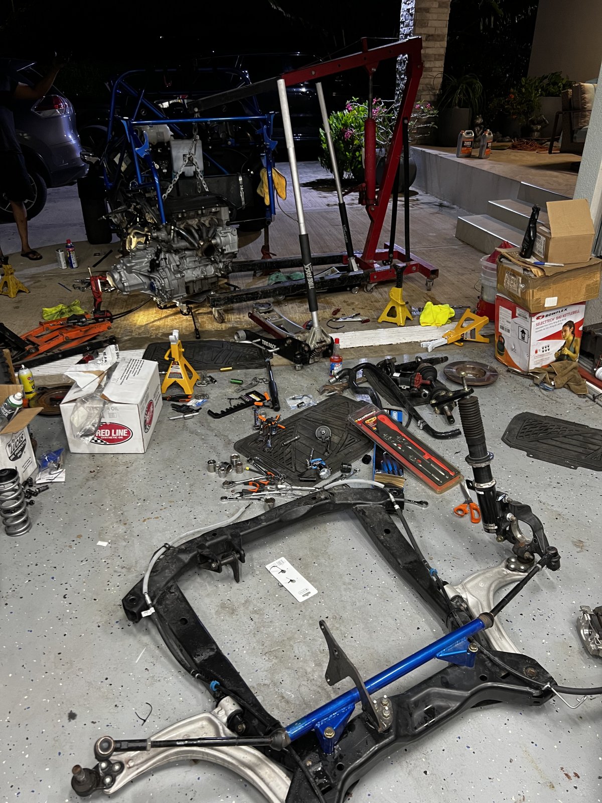

Thanks. Started last night and did more than was necessary but more or less figured out what you just said would be the best way next time. I ended up using my bike jack to actually line up the gearbox and that worked well. Freaked out at first cause the fidanaza flywheel wasn’t lining up with the bolts and I assumed it was an evenly spaced bolt pattern but they are actually slightly offset so I had to rotate it a bit to get it to line up correctly. Got to put back everything together now between tonight and tomorrow. I ended up using the zzp throw out bearing spacer they recommended so since my measured air gap was about half inch so I hope that works out for me.
GoblinGuyZ
This was the carnage that was last night lol

To bolt it all back I’m going to lift the engine with the hoist, slide the subframe under onto 4 jacks stands then bolt the engine back onto the subframe and transfer the hoist onto the chassis and drop that back down onto the engine and bolt it back to that and the subframe. Then I have to bleed the brakes and clutch with my pressure bleeder and refill coolant and see what’s what.

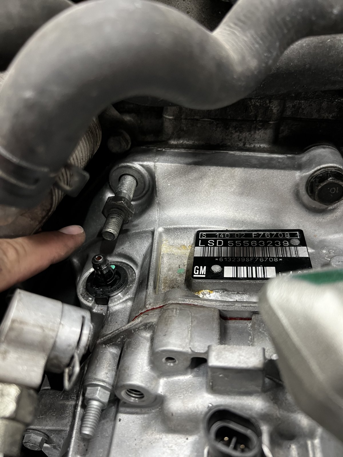

Hi all so trying to get this thing fully put back up to go for a drive and see what’s what but can’t remember the exact location for this bolt / stud with the ground thread extension. Thought I had a pic but can’t find it. Can anyone confirm this is the right bolt hole for it right behind the clutch elbow. Thanks.
46259
GoblinGuyZ
It doesn't really matter as long as your wire will reach it. It's all the same electrically.
yeah that I know I just haven’t put back the wires yet they are all in a heap so gotta figure that one out and I’m guessing it won’t reach it if it’s on the other side. I’ll just have find the correct ground and work from there.
