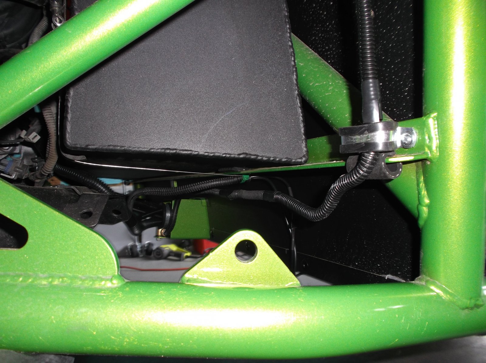

I went to someone who is very knowledgeable about state inspections.
Classification I need to use = all purpose; same one that's used for a SUV or Jeep (other options would be automobile, motorcycle, moped, pickup, farm, commercial, and a few others)
He gave me some very good info and he would have given me a VIN, just not a pass right then.
Given the items needing attention, I would have been able to do them in 30 minutes and come right back.

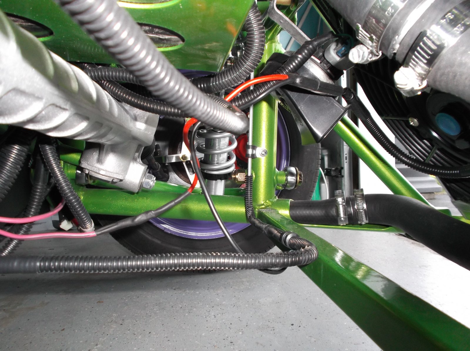

3 things he said might be noticed:
  • The rear brake lines underneath need to be bent closer to the fuel tank to prevent being ripped out if you go down a dirt road and hit a rock or stump; Class 6 roads in NH are not maintained by the city, town or state. They should also be wrapped in 1/4" cable wire loom as a primary protection.
  • The front brake line needs another clamp 1/2 way down the vertical run coming out of the master cylinder to prevent movement and again covered in wire loom.
  • The dash panel I made has 4 pointy edges, file them down or put more of the door edge guard on it.
I will wait for the body panels before I try again.
