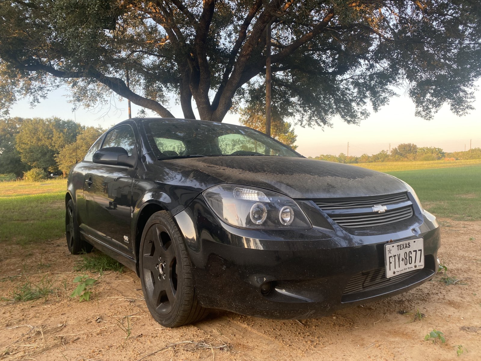

I guess I said that wrong. My goblin is not for sale, but I have a cobalt ss that is. It was going to be extra parts for the goblin, but I haven’t done anything with it in a couple of years, so might as well let it go, if someone needs it. I know they are getting hard to find.
