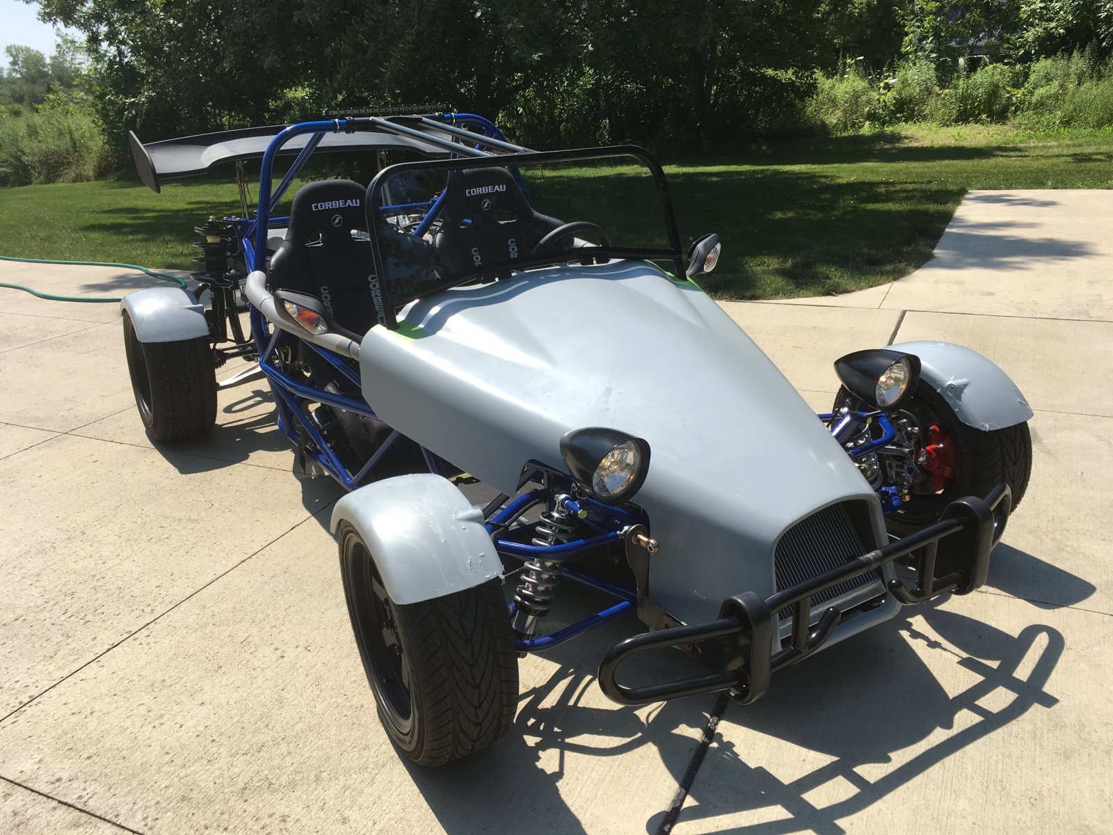

BAR-AIR
PA and NY I believe are pretty close on the DOT inspection requirements. So here is where I'm at ....
Steel front and rear bumpers (that have to be a min. Height of 16"), DOT stamped lights all (actually stamped on the lenses) the kits taillights, and the mirror light are DOT stamped... headlights were not, wipers powered only, safety glass windshield, (padded visors also), third taillight, emergency parking brake (need to fabricate handle and cables), fenders (waiting on mounts) and the last is the emissions (emissions compliant with the year of the engine used) min. of catalytic converter. (The catch here is the car needs it but it can't be tested because it is no longer a Chevrolet Cobalt) the only thing that will be tested is a sealed gas cap.
Mine is not inspected yet... but getting closer just be ready to fabricate the additional requirements.
