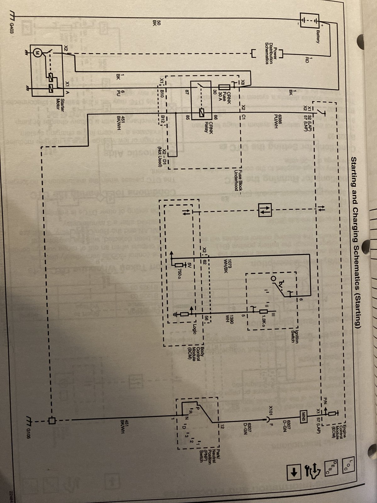

I have power to the relay that activates the starter but the Starter will not turn.
my test light shows power coming out of the output side of the relay terminal in the fuse box and it would stay lit once you let go of the key (I assume this is the cars way of continuing to crank to start the car and would stop once it was running)
I can jump the purple wire from the battery and the starter cranks.

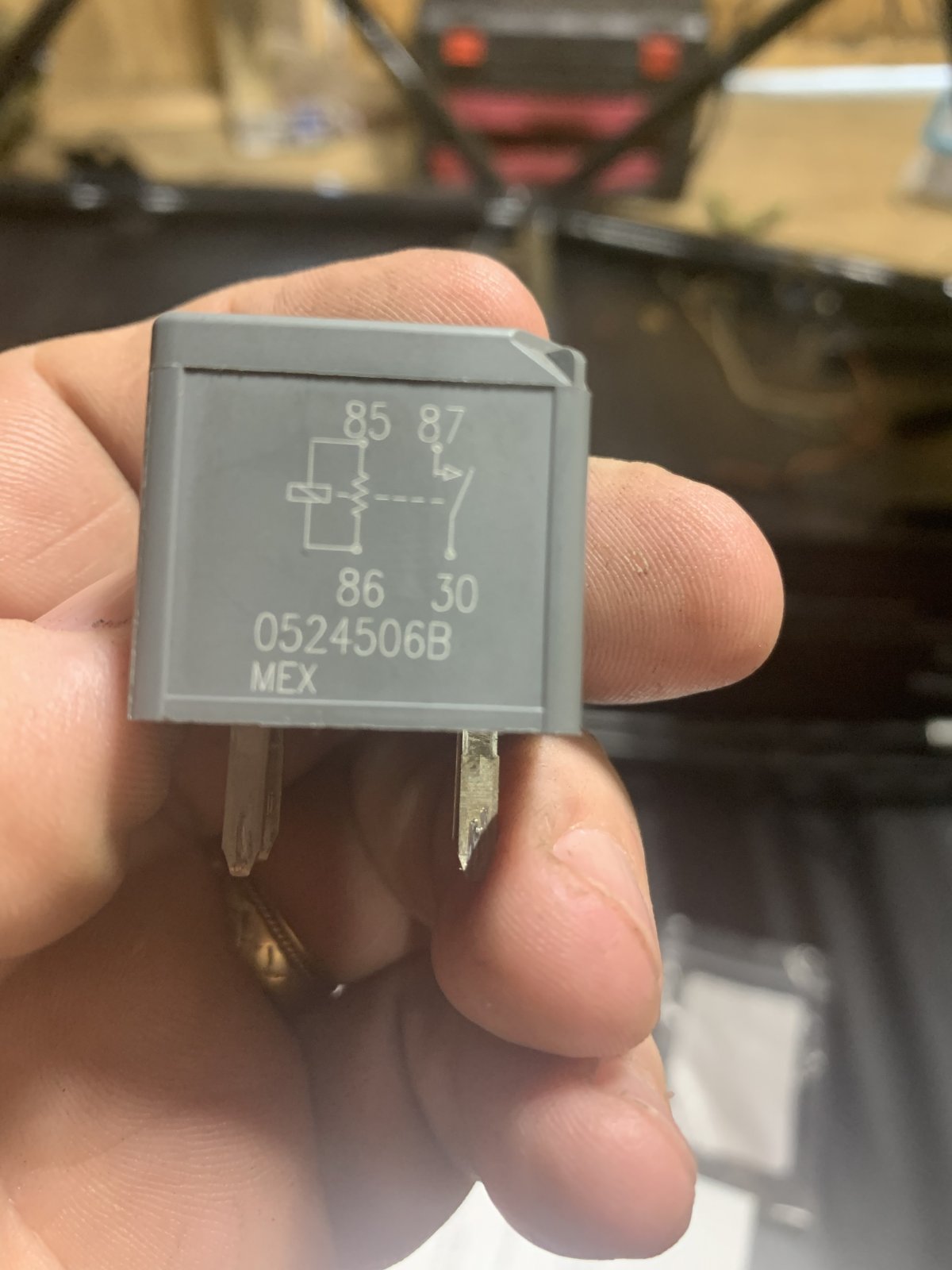

I tested the relay with a 12v power supply and it clicks.
if I jump the terminals where the relays sits in tjethe starter cranks.
I have continuity from the relay terminals down to the purple wire at the Starter.

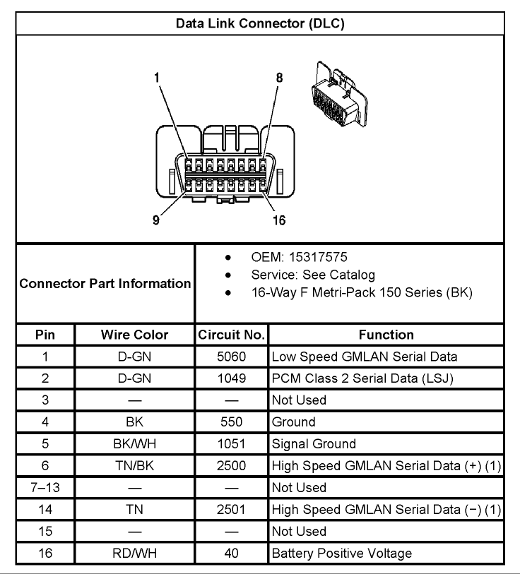

I have continuity between the data wires at the OBD
