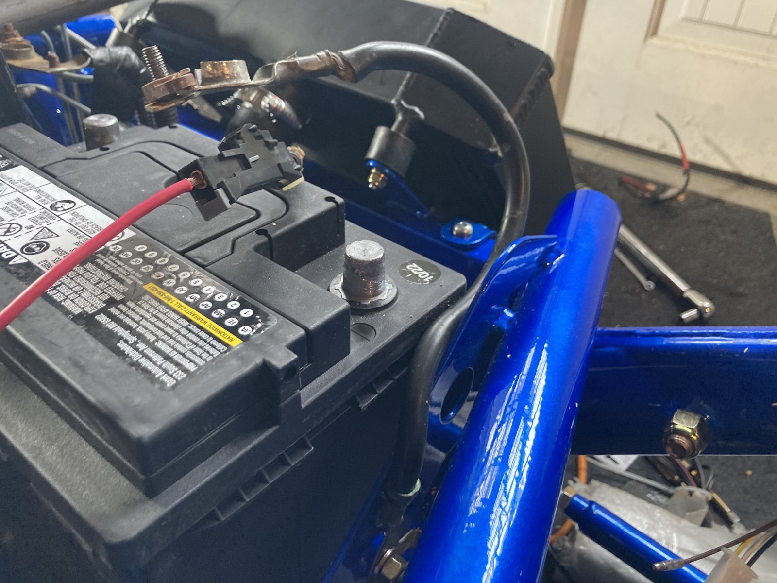

Today I am going to run through some tests. To answer some of the questions above I would say they are bigger than normal sparks? I might take a video, there is some smoke coming up when connecting it. In terms of it not doing anything, when I turn the key I am looking at the dash screen and nothing is popping up, I also hear no electrical noises or at least I have not heard any yet but I will test for that as well. My first course of action will be to test the grounds and try to get some more powder coat off the bottom of the studs, I will also check that large 50 amp fuse going to the battery. After that I am pretty in the dark, but I am hoping its just the grounds. I did follow the YouTube videos for attaching the harness, some of their connections were a little different, specifically the large positive cable. My large positive cable's end radius was not big enough to fit the bolt through so I ended up having to drill it out a little. That large positive cable connects at the same spot that the cable that goes from the positive stud of the fuse box goes to correct (that is the best way I can describe it). I also had to extend that cable that goes to the fuse box so I suppose there could be a bad connection there so I will test that as well.
If you have smoke you could have major problems. I would suggest you start with my suggestion above. Having bad grounds might be saving you from a fire or at least a burnt up wire harness.
Post some pics of the battery, grounds and back by the fuse box in the rear. Not real close pictures, a little further back so we can see things.

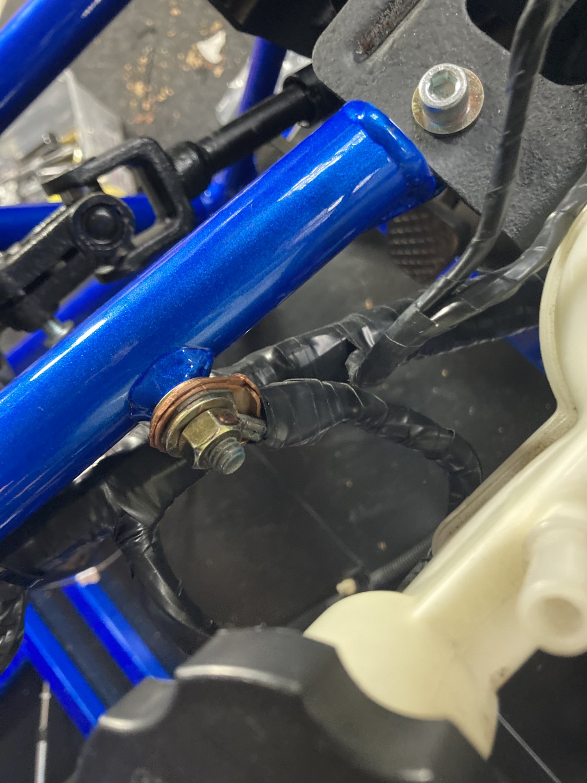

Ok so started going through and testing things, plugged in the battery terminals again and heard what sounded like clicking from the fuse box area and some noise from the bcm. Then after about 10 seconds or so the negative terminal ground from the battery started to smoke a little and we quickly disconnected the terminals. We tested that ground and it had continuity, is it just not good enough? We got about .5 ohms from the multimeter at all of the grounds.
K

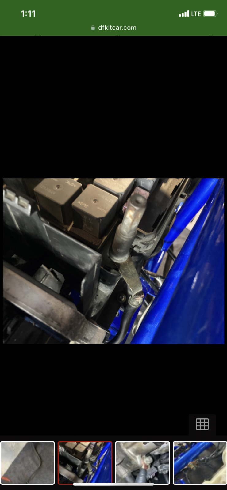

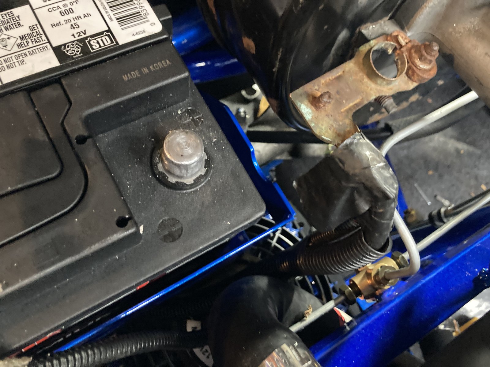

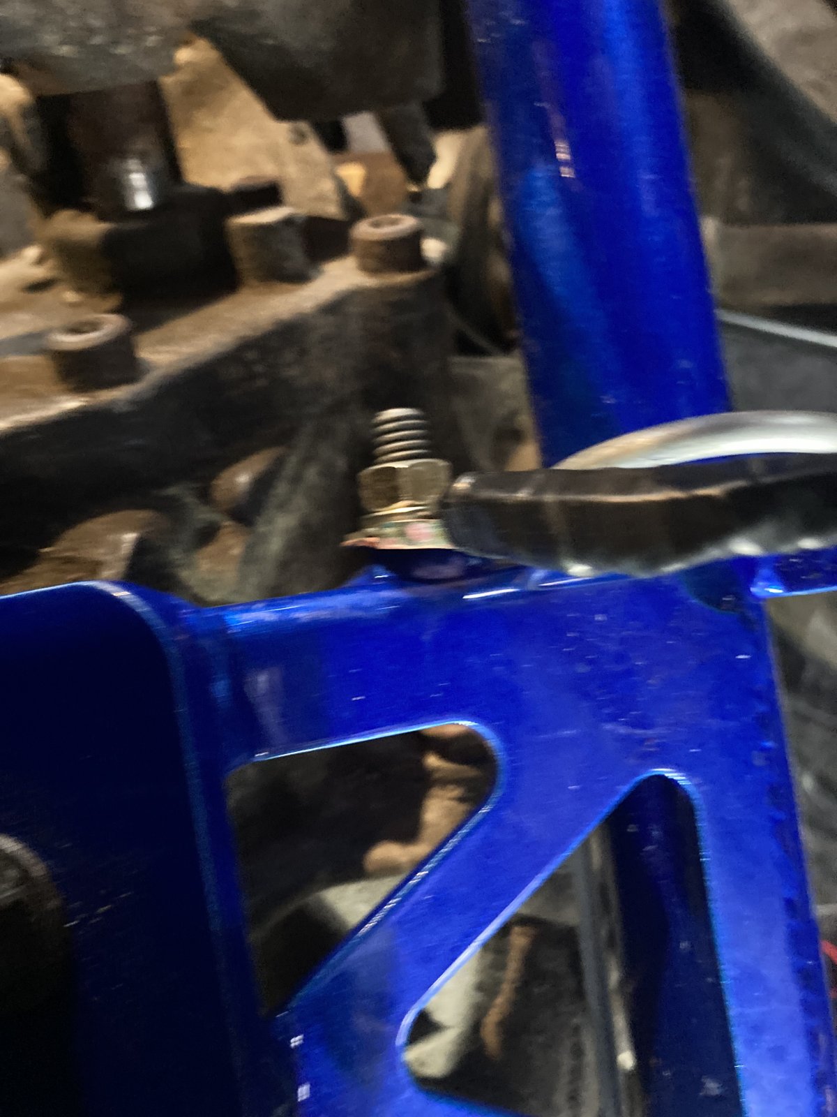

The first photo is of a donor wire we found, is that a ground wire from the engine to the frame? We only just found it and I assume it’s important.

I think the wire in the first pic is supposed to be used where you took the second pic.

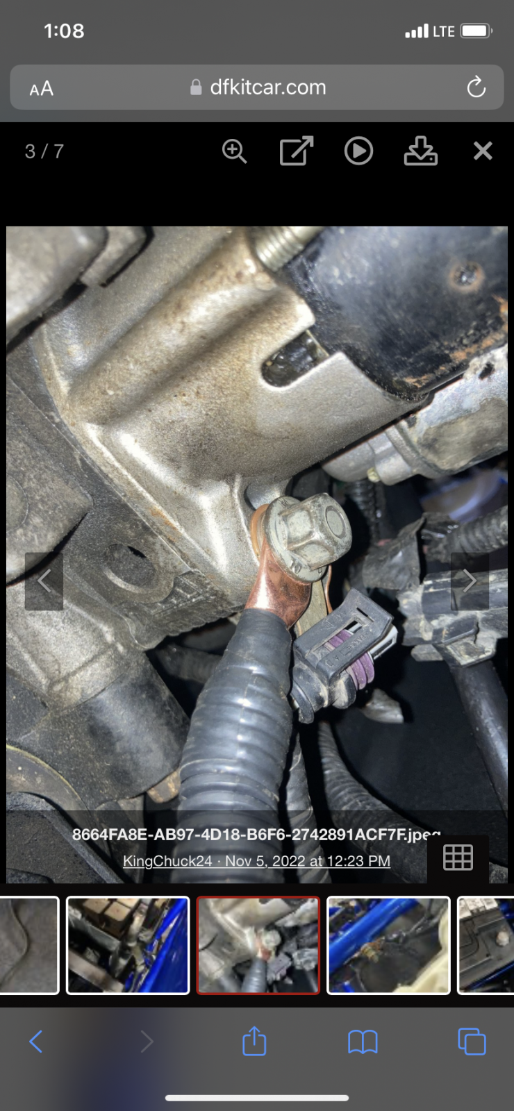

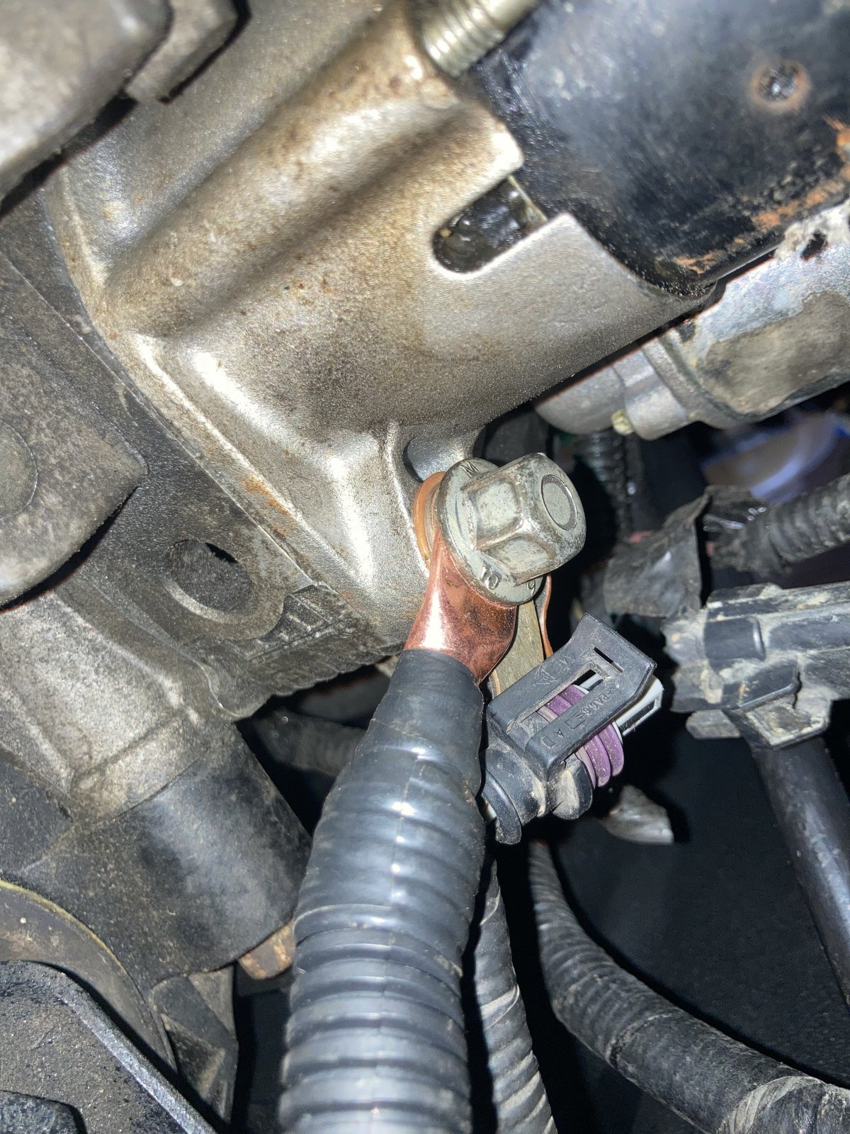

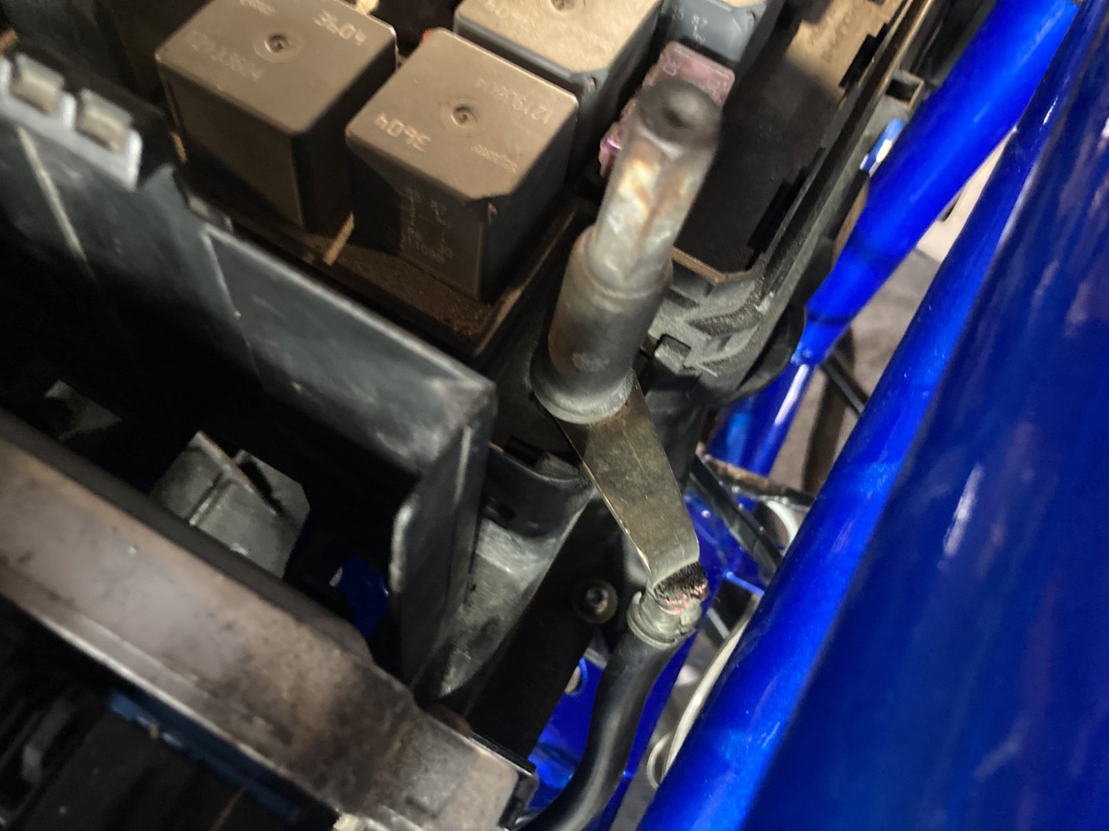

Where does this wire go? That’s probably hot from the battery that goes on the starter positive terminal not starter case. Nothing goes off starter case that I can remember.

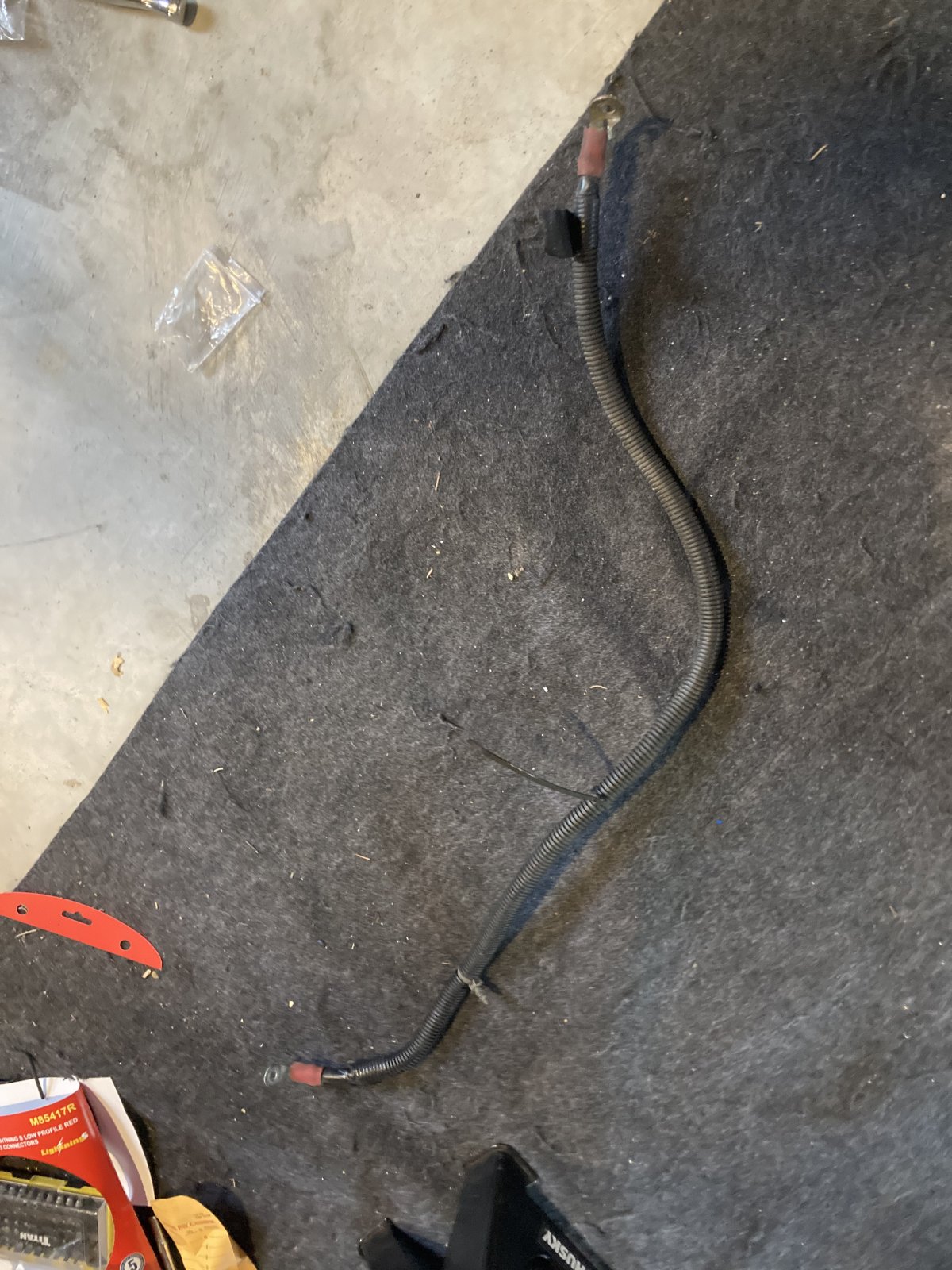

Where does this wire go? It’s a positive wire.

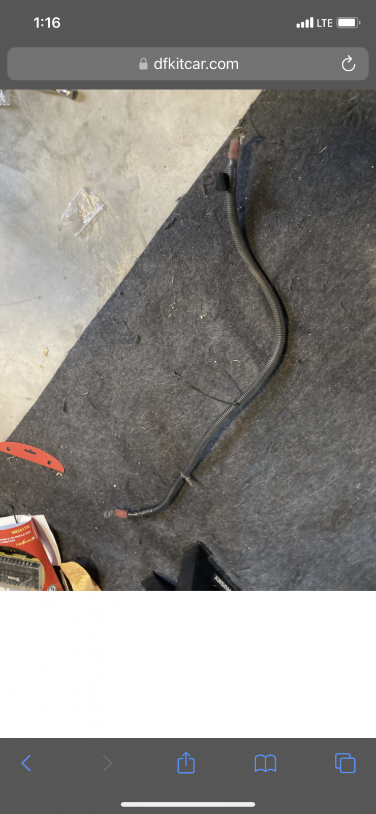

This goes starter positive terminal to fuse box if I remember correctly
