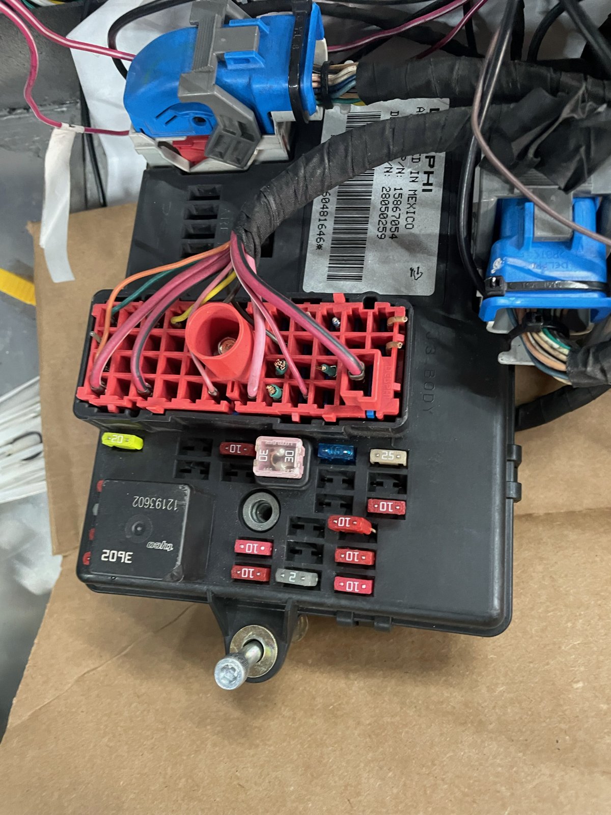

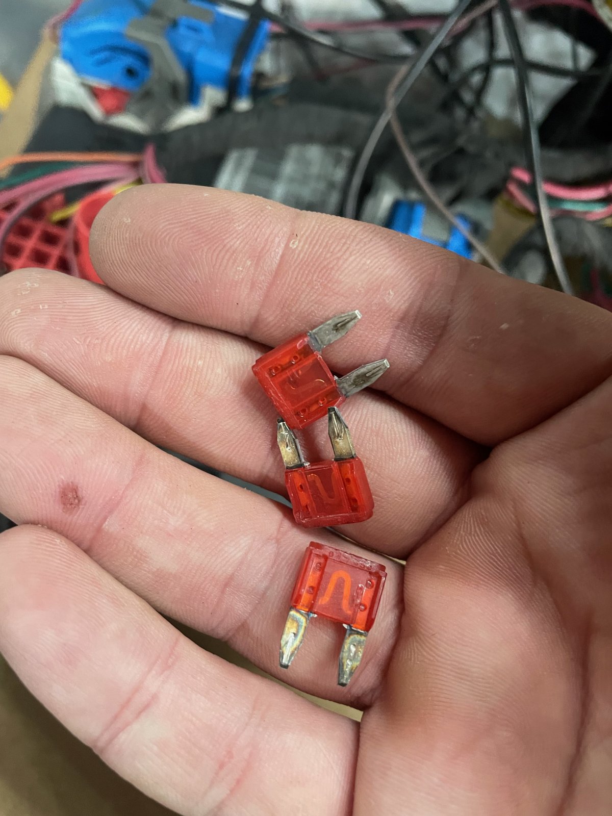

Tested for spark using an old plug and the first cylinder coil pack - seemed to get spark and almost started up. When I reinstalled the coil plug to try again, I literally watched a fuse blow out on the front fuse BCM(red 10 fuse, third row over directly under another red 10 fuse - position 15?)...maybe I'm still having ground issues?
C
All the fuses at the bcm are burnt to some degree...most of them don't look blown but something is amiss

Is it possible that when you were working on the coil pack that some of the tail light wires got against bare metal. That would pop fuses on the BCM up front.
C
I will try replacing all the fuses and making sure that is not the issue. I have a bunch of headlight and tail light wires that are all over the place and that is of high probability. The rear fuses look fine. Hopefully I didn't blow up my bcm.
