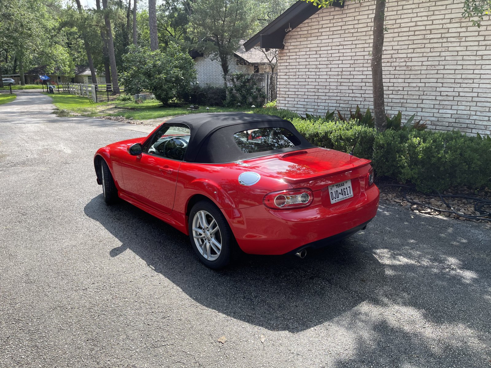

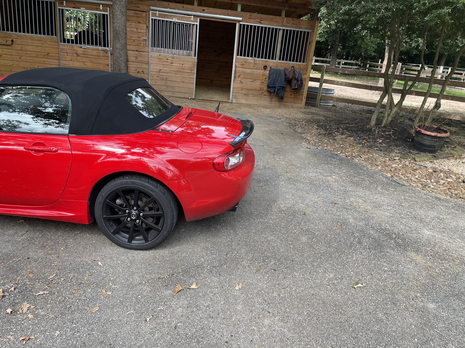

So, the car stuff got put to the side while I concentrated on my business. Then I took my truck to a shop to get the headers installed (again, I don’t have time anymore) and I met the guy who would steer my interests on accident. At the end of may, an older woman was selling her 2009 Miata sport in true red. The car had never been modified and other than some blemishes, that car was great. I negotiated a deal I had no idea would work, but it did! I drove home my Miata at the end of May.

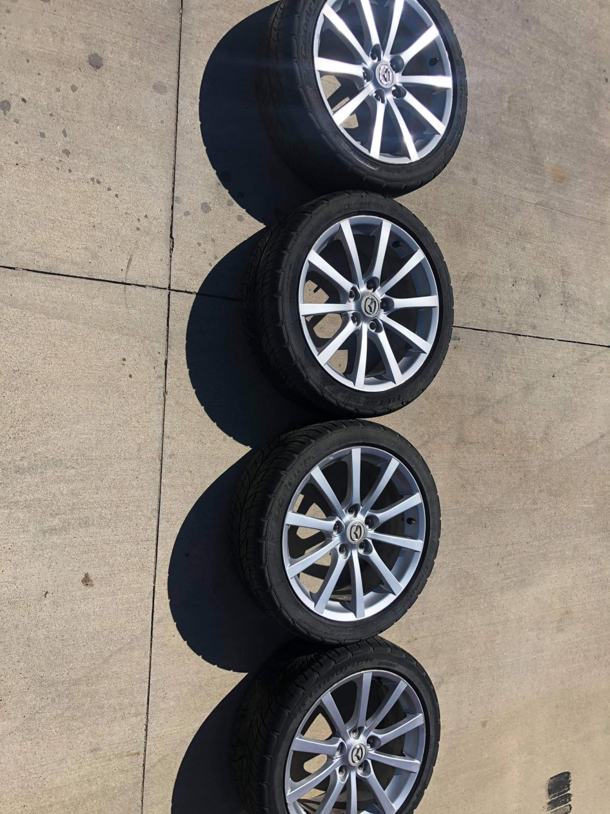

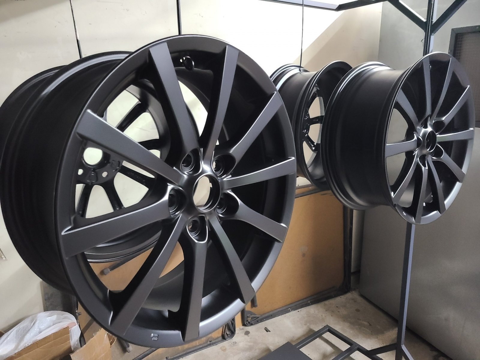

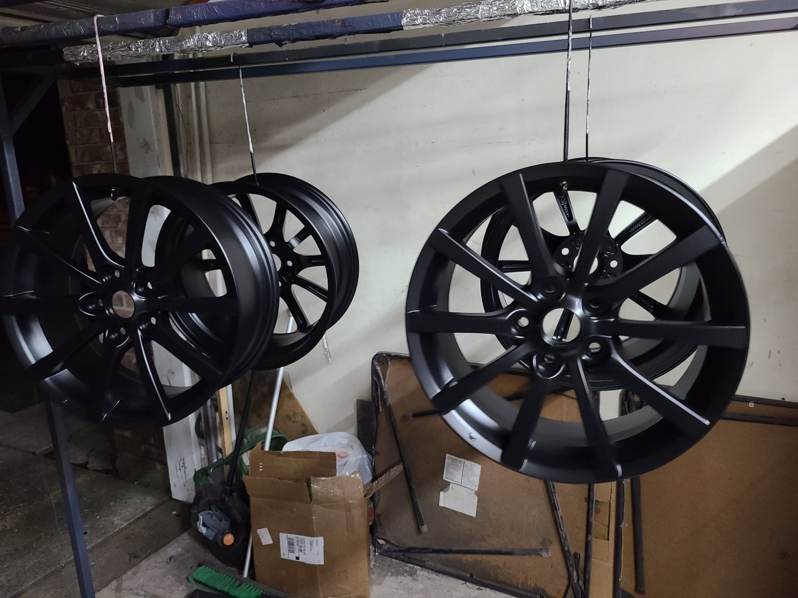

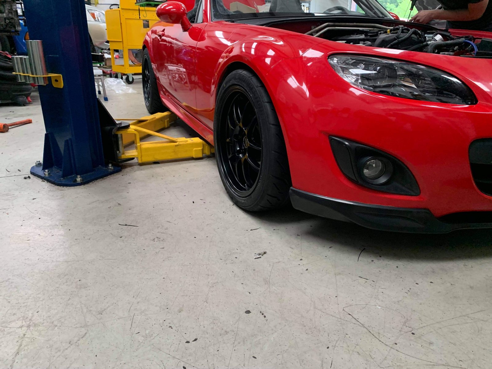

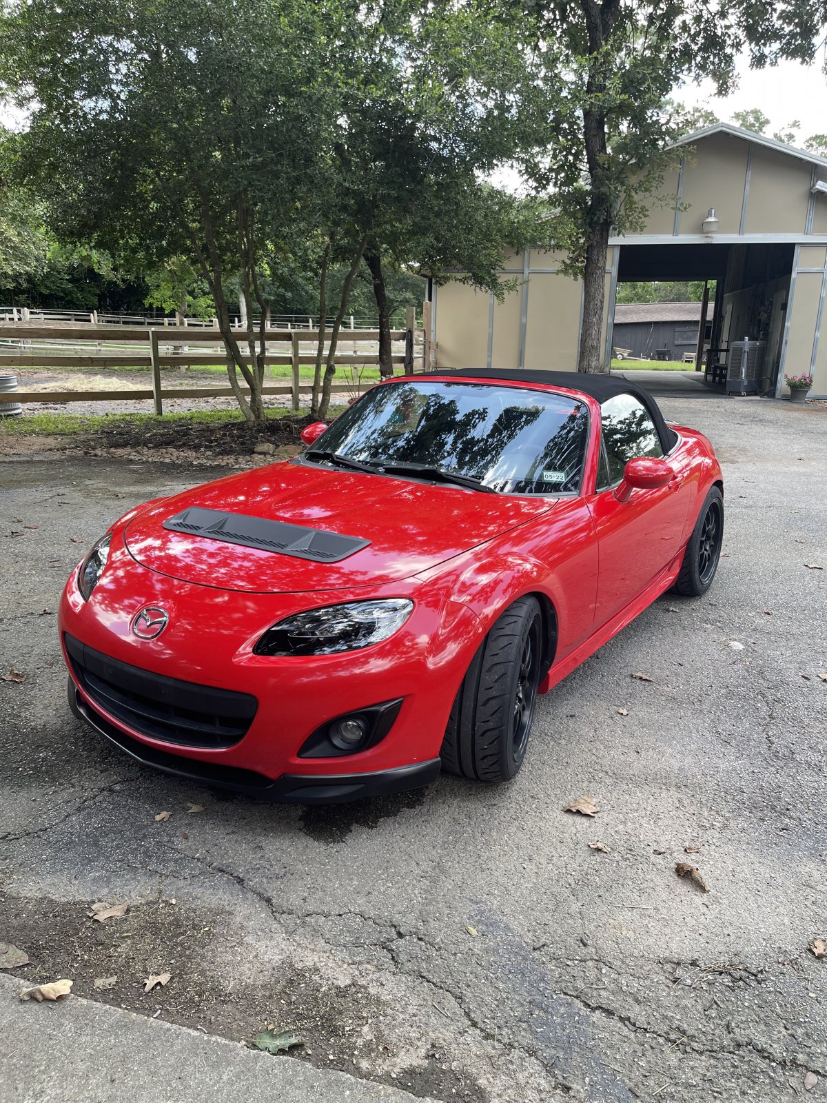

I did some cosmetic mods, I swapped out the hazed headlights for newer black housing headlights with LED bulbs. I also ditched the beat up front lip for a new black one. I also installed a carbon fiber rear lip spoiler. A front sway bar, much better brake pads, and free factory 17” wheels I had powder coated and fitted with 205/45/17 tires and I went to auto cross! I had fun, I pushed harder than I thought I would with a car I barely knew and I wanted soooo much more.

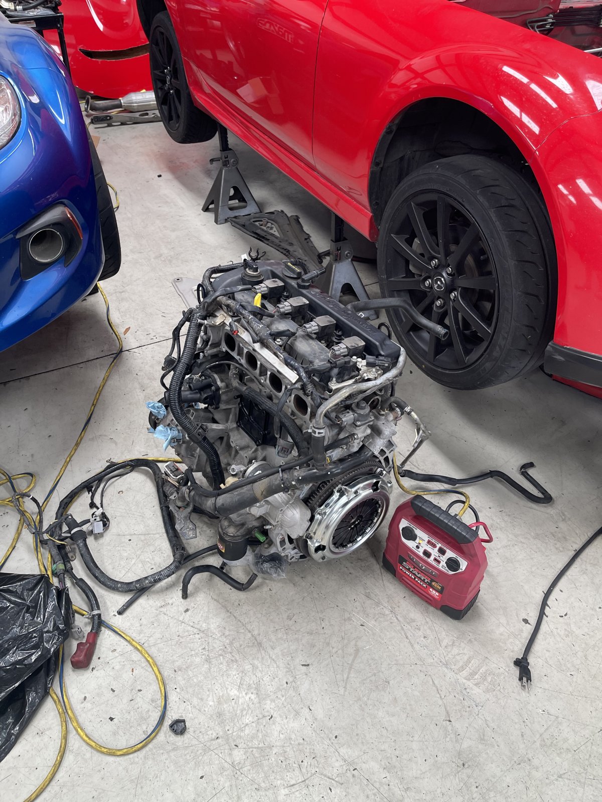

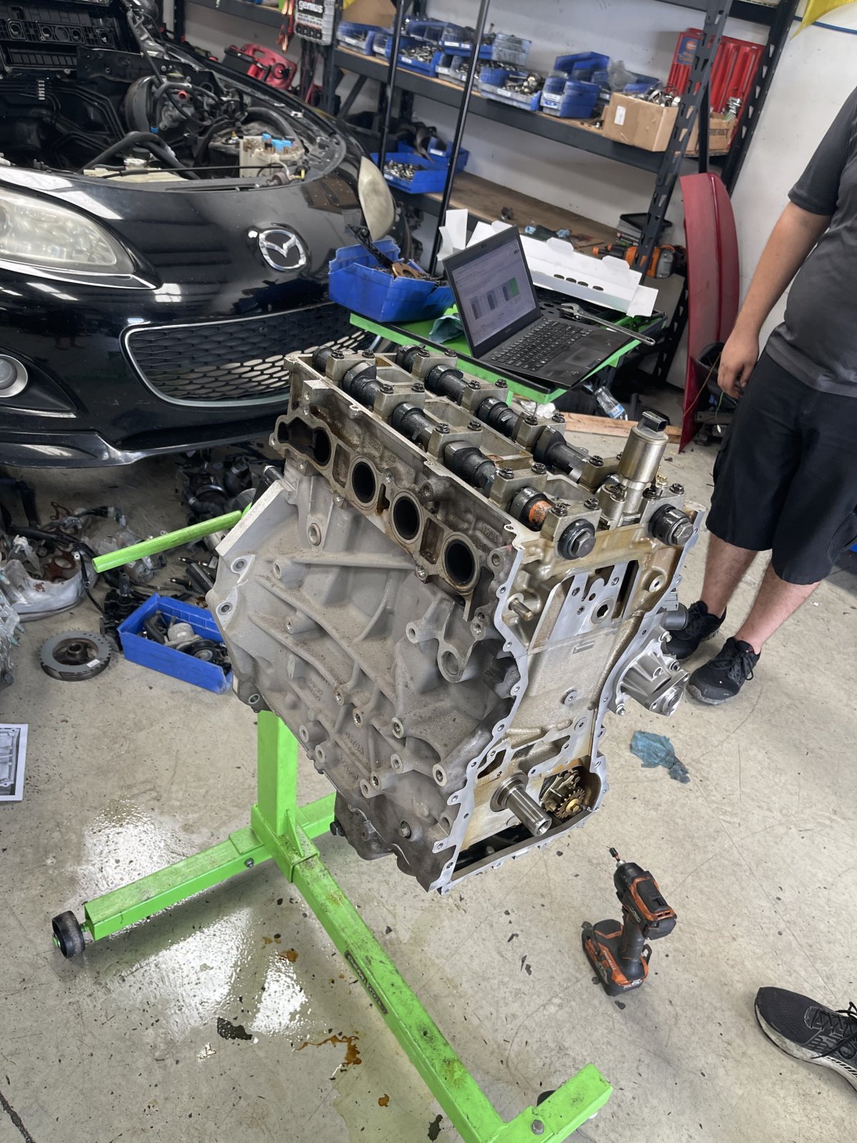

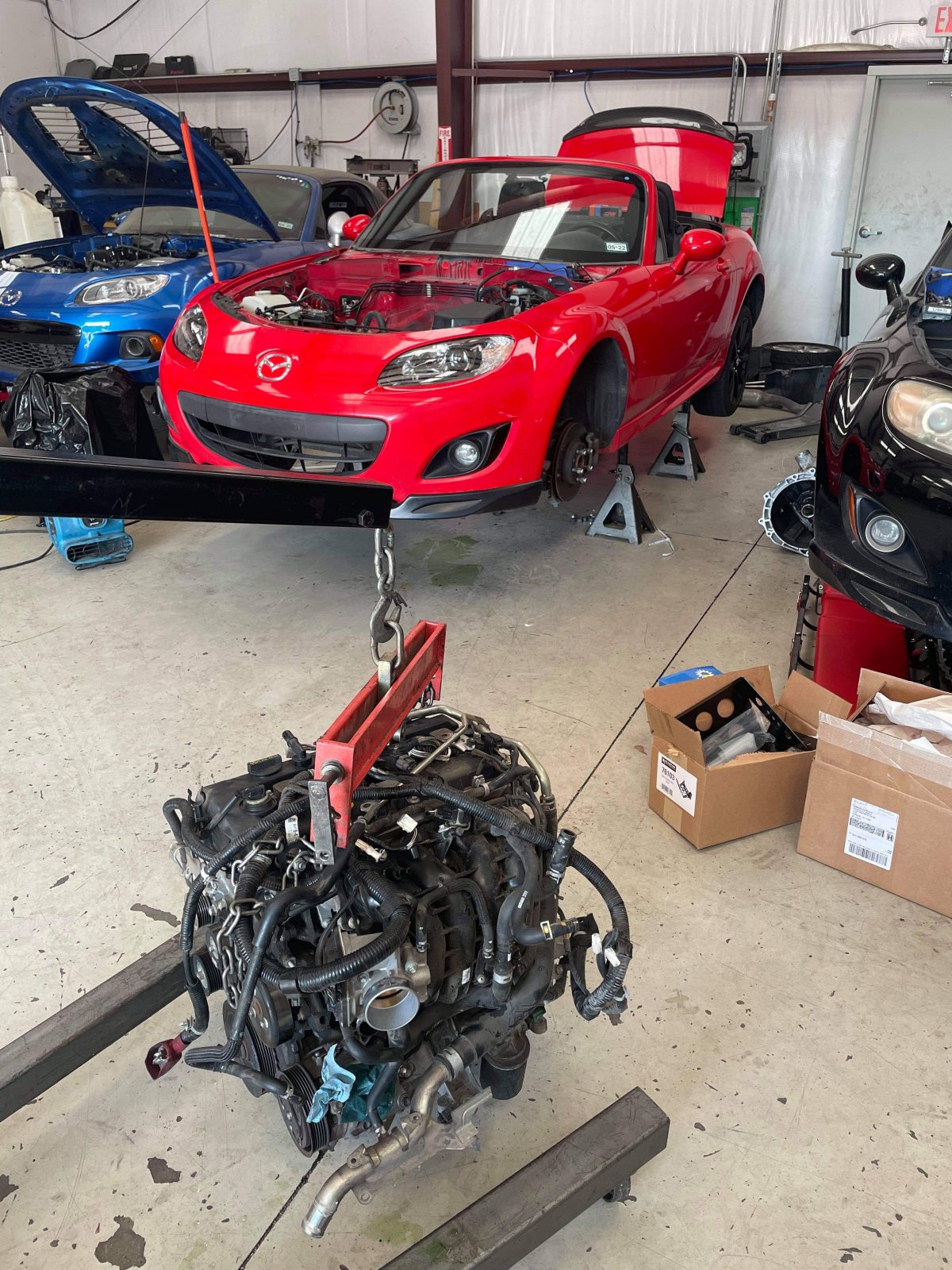

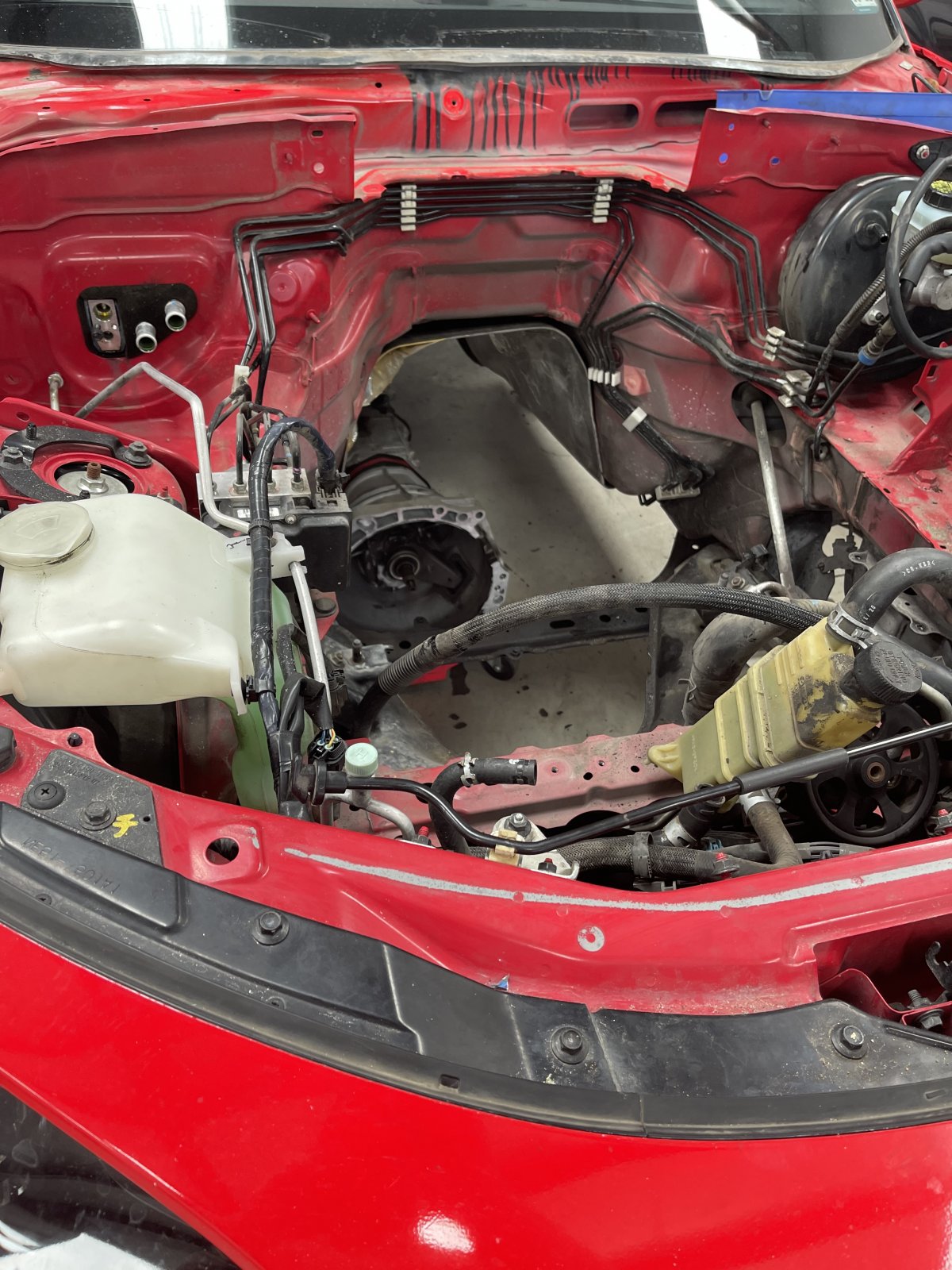

At that event there was another NC Miata there that was having engine problems. Turns out they ran the oil low while on the track and killed some rod bearings. We negotiated a deal and the motor from my car was removed to go in her car.

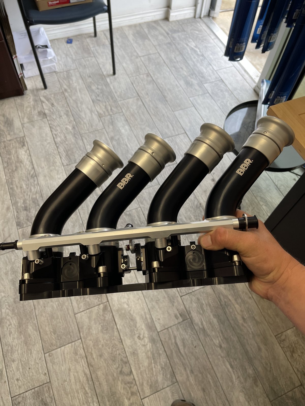

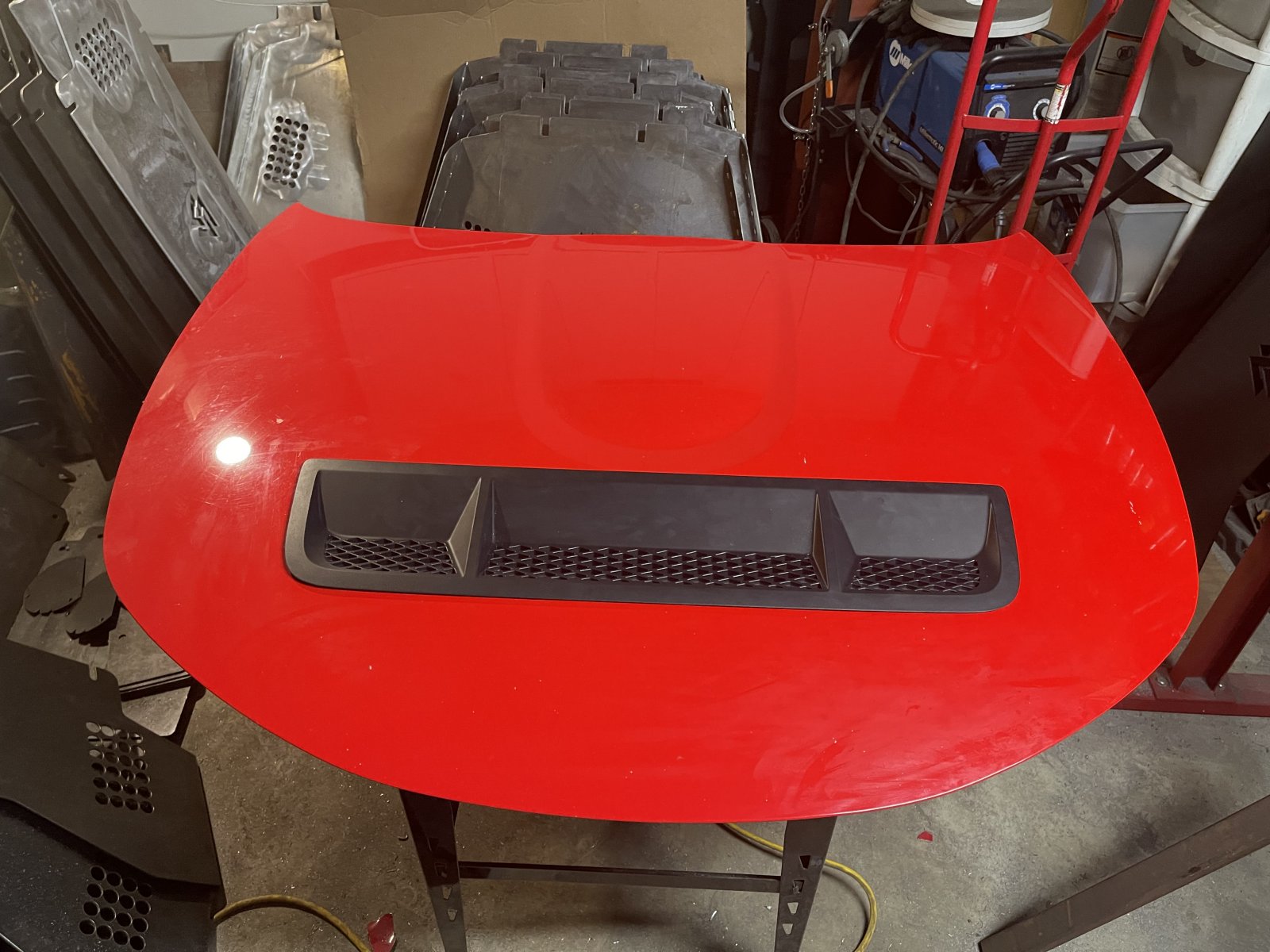

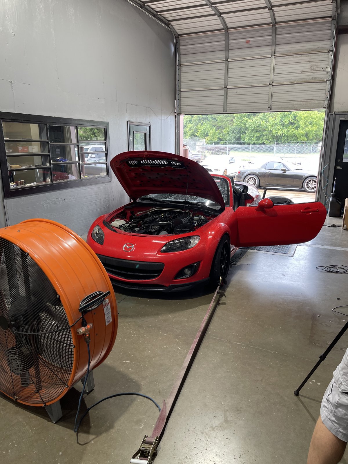

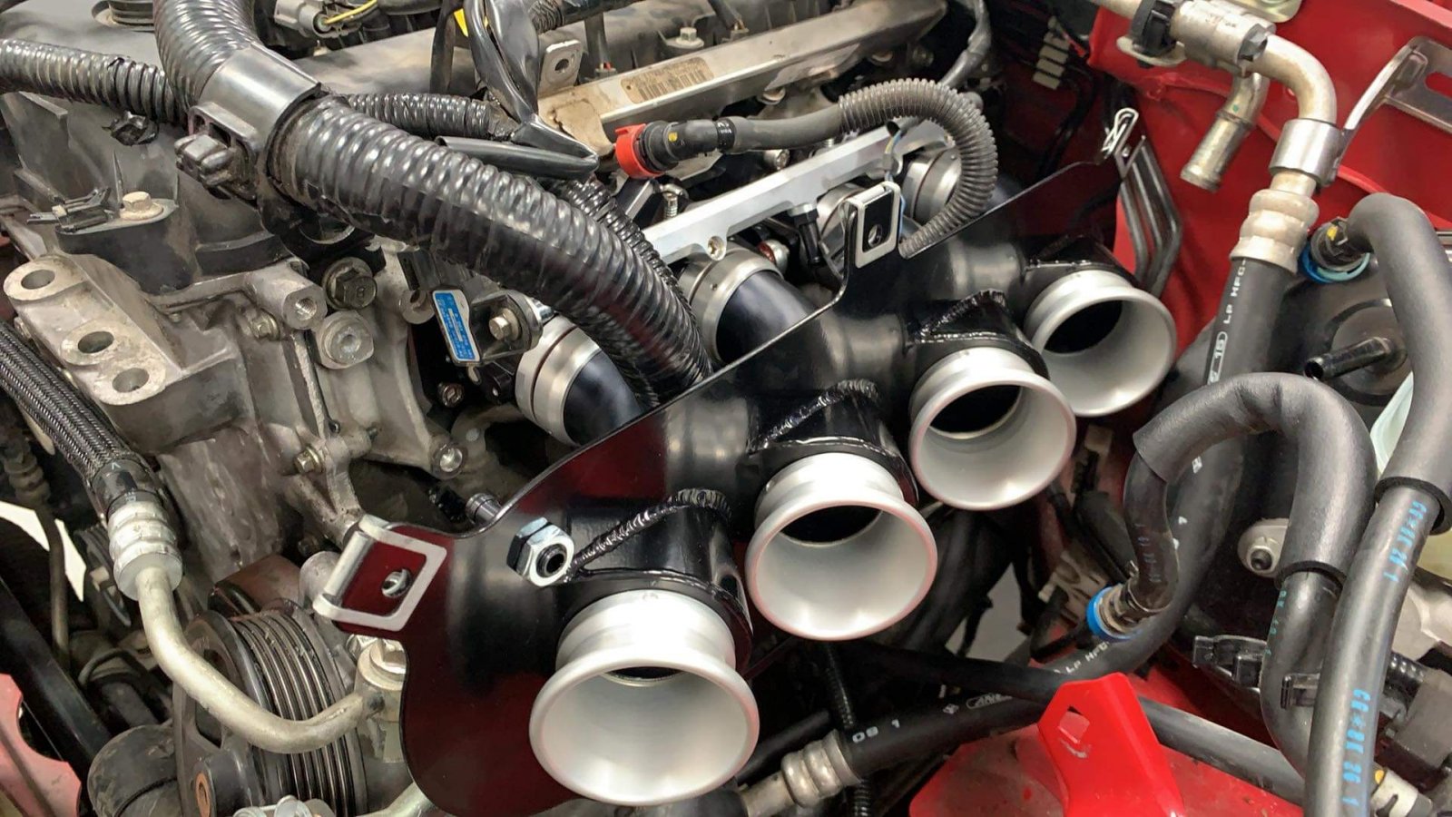

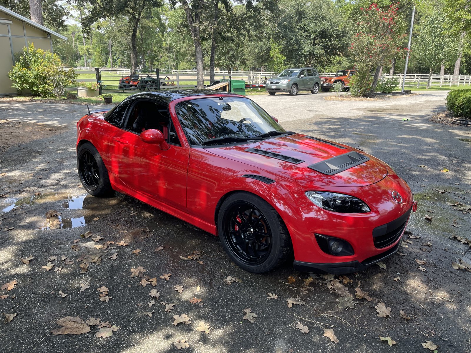

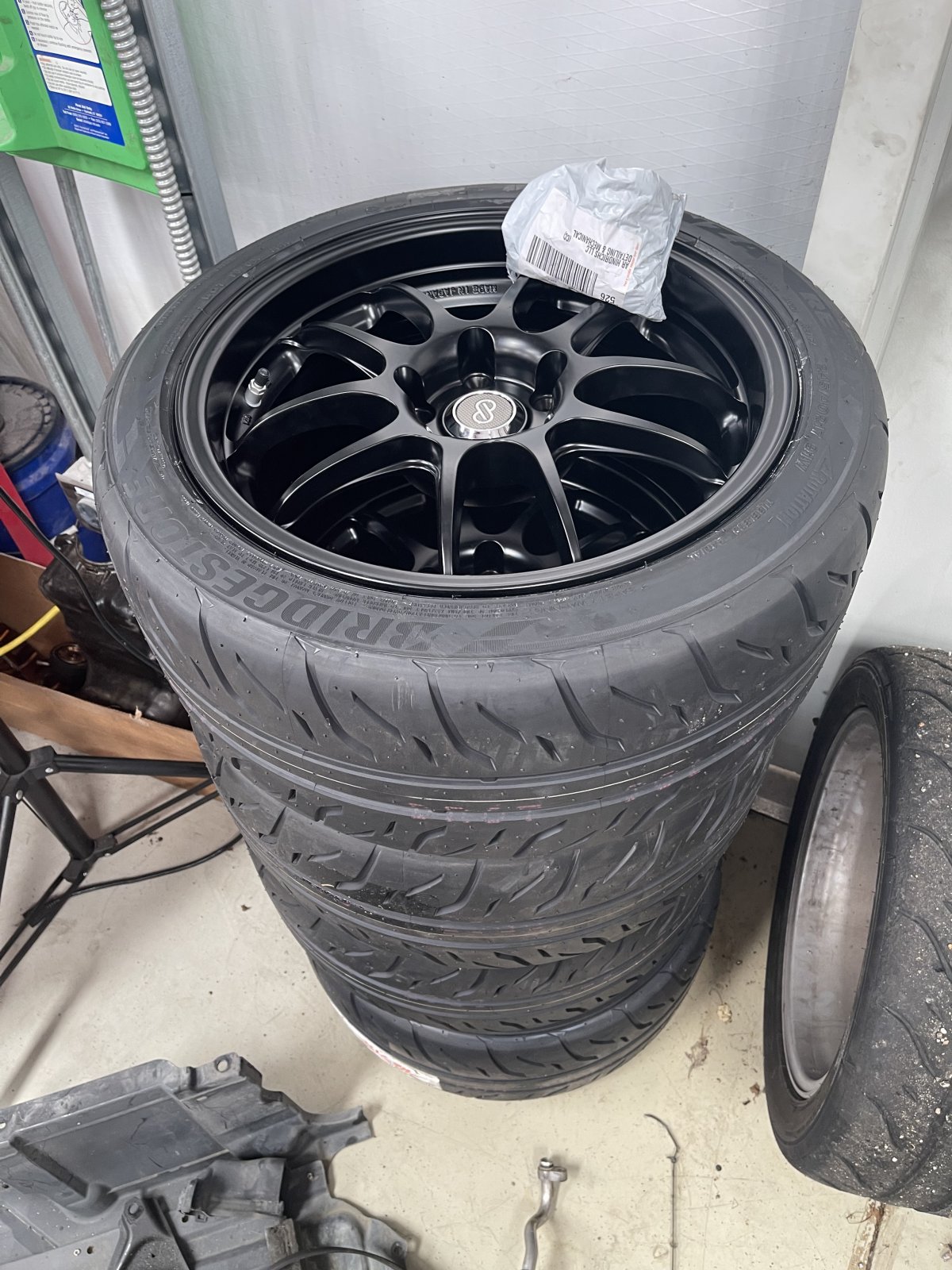

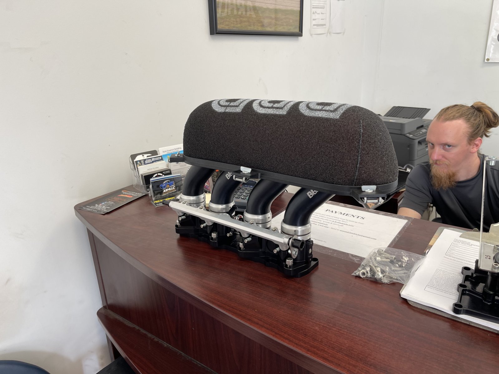

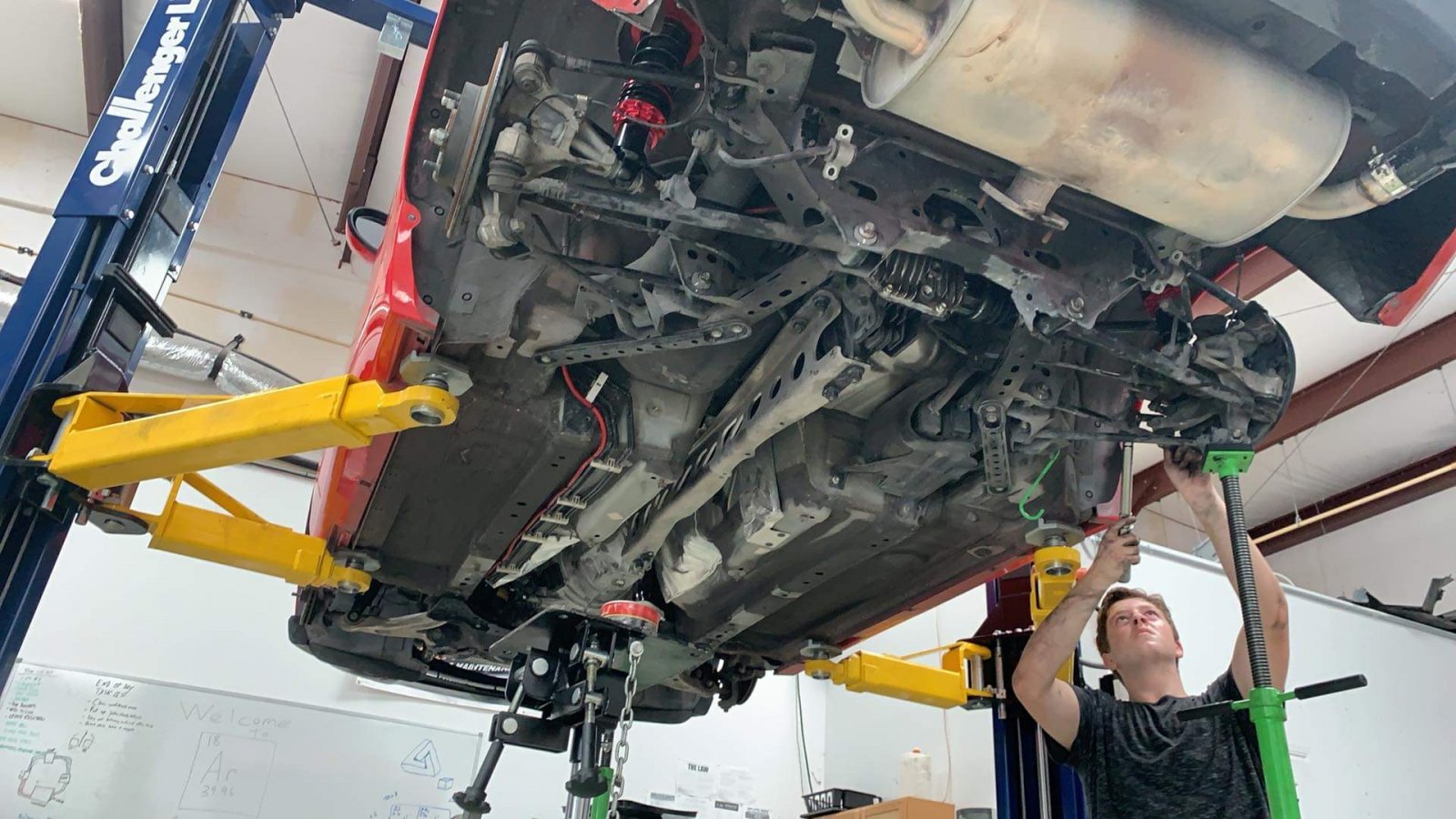

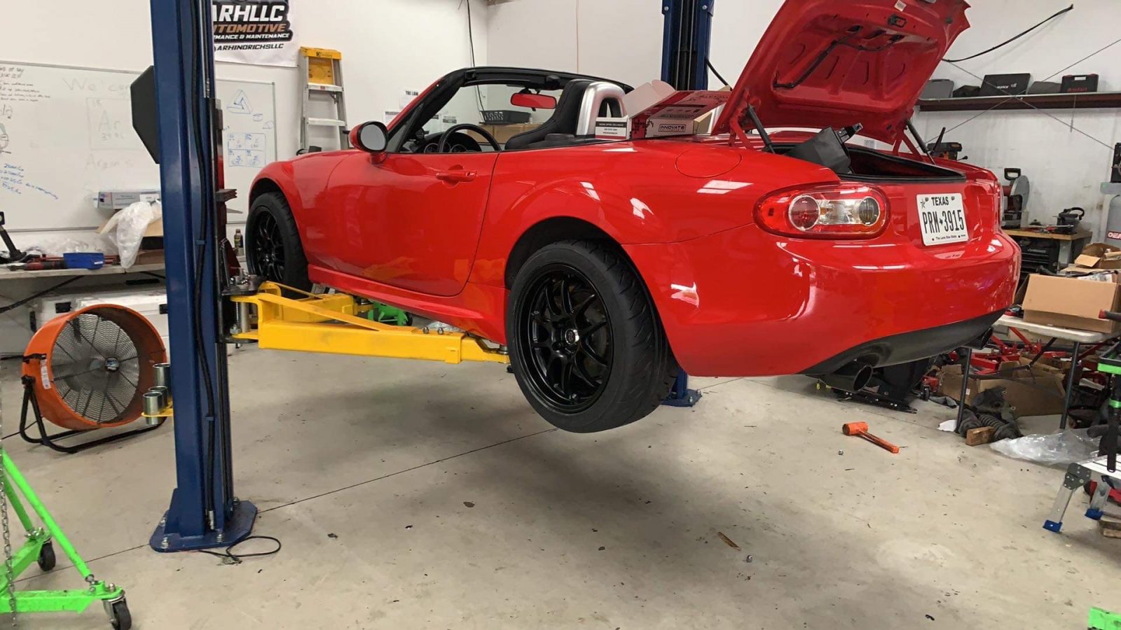

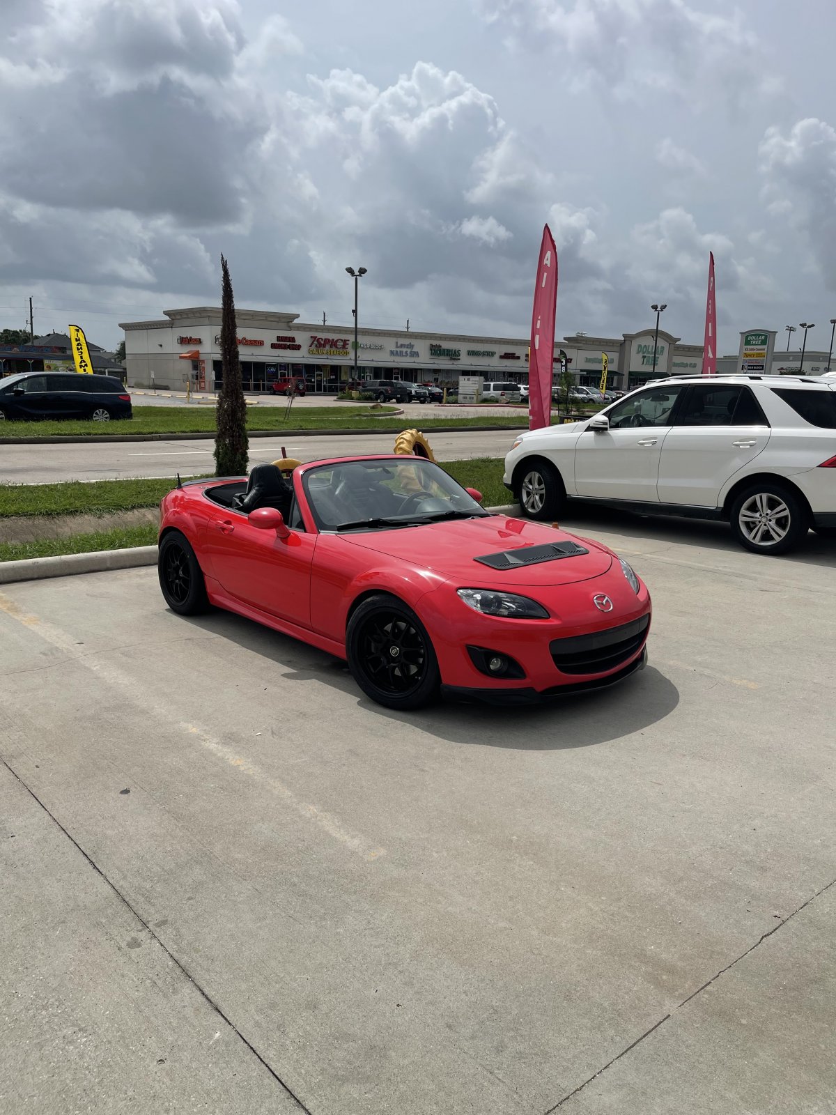

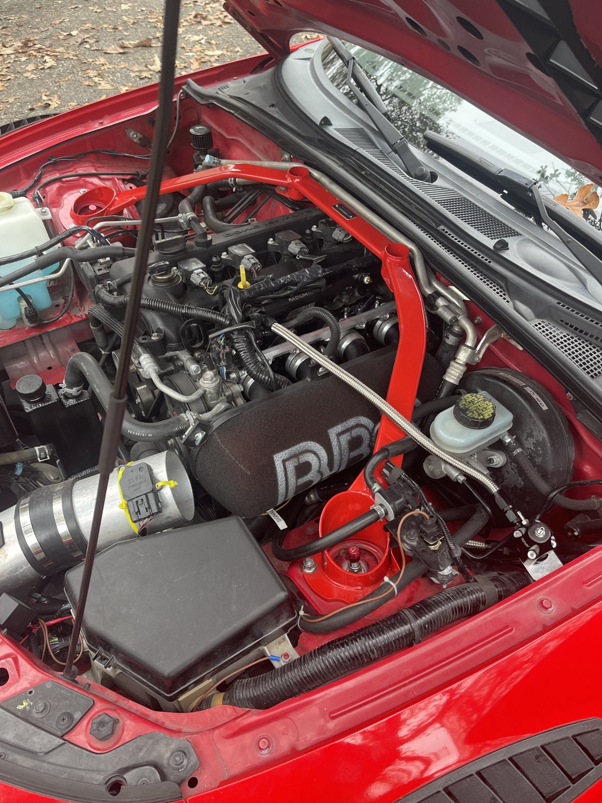

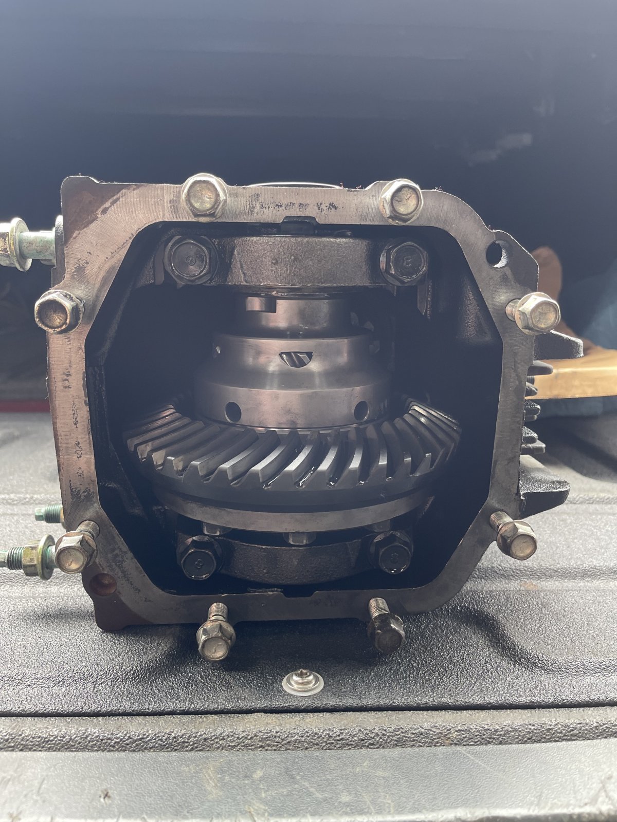

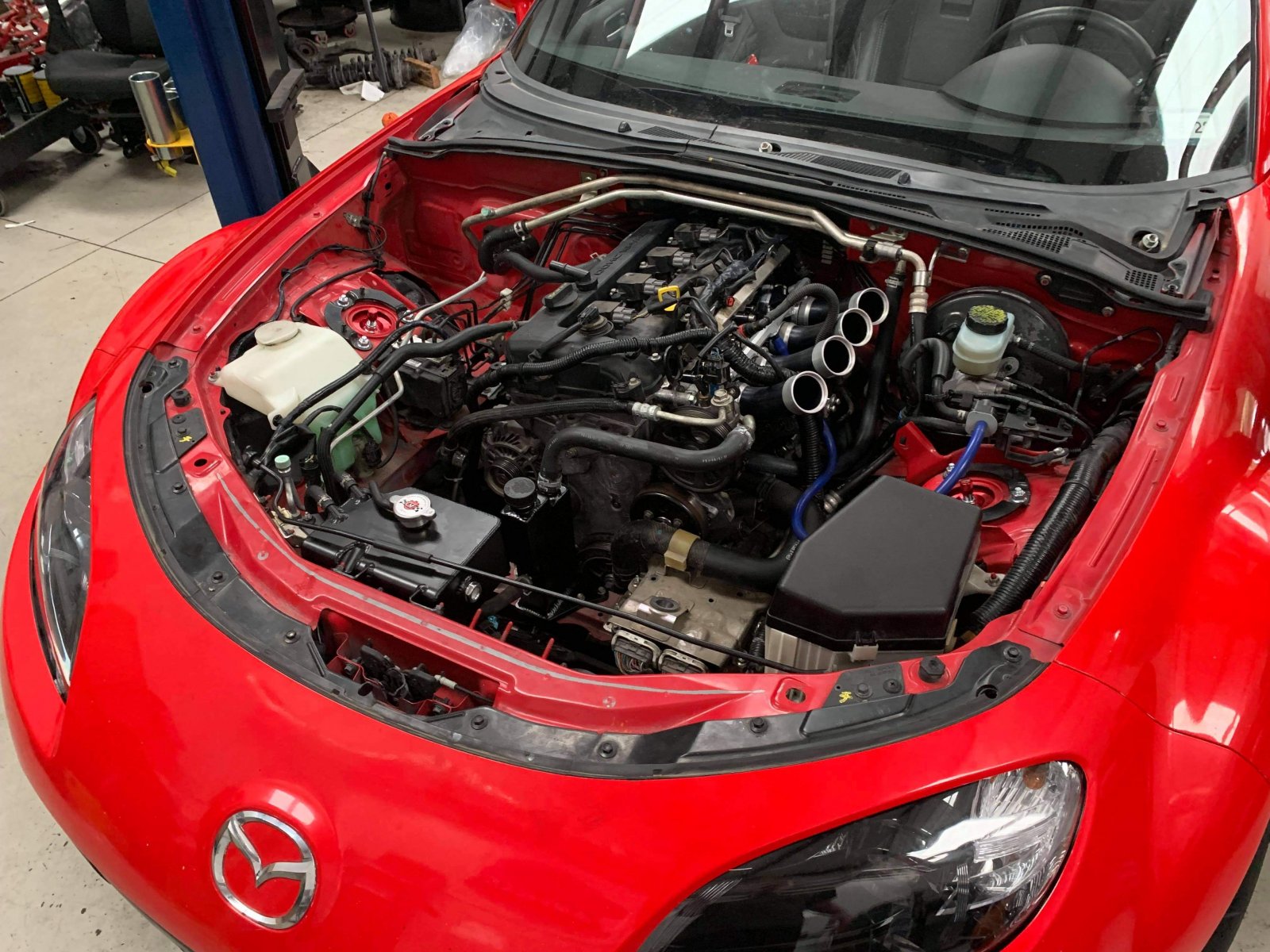

So, my car no longer had a motor, but!! $450 later, I had a 2.5L out of a Ford Fusion. Essentially the same engine as my old 2.0, but much bigger bore. The engine was left pretty much stock except it was fitted with Brian Crower stage 2 plus Cams and valve springs. Steel light weight flywheel and an exedy stage 1 clutch which is holding for now (I am exceeding the torque limits). A Goodwin 1.875” header was installed and a catted and resonated midpipe was also installed to the stock rear muffler (I hate fart can 4 banger noises). The diff was pulled and a quaife diff was installed. Meister club coilovers were also installed and the powder coated factory wheels came off and new 17x9 enkei PF01’s with 245/40/17 RE71R’s went on. The battery was relocated to the trunk and I cut a hole in the hood for a GT500 vent which fit very well. Then came the really cool part! BBR ITB’s!!!! With everything together and a base tune, I limped the car to the dyno. The ITB’s weren’t all the way adjusted and it hurt the numbers on the dyno, but it was alive and the ITB’s are LOUD!!! I could finally drive my car!! I went and got a custom alignment done and it felt sooooo much better!! The car is back in the shop right now for some finishing touches that didn’t get done before dyno day (The tuner flew in just for the dyno day). The throttle position was 9 degrees from wide open throttle along with some other tweaks that needed to be made. Once the tune is updated it should drive much better with more power.

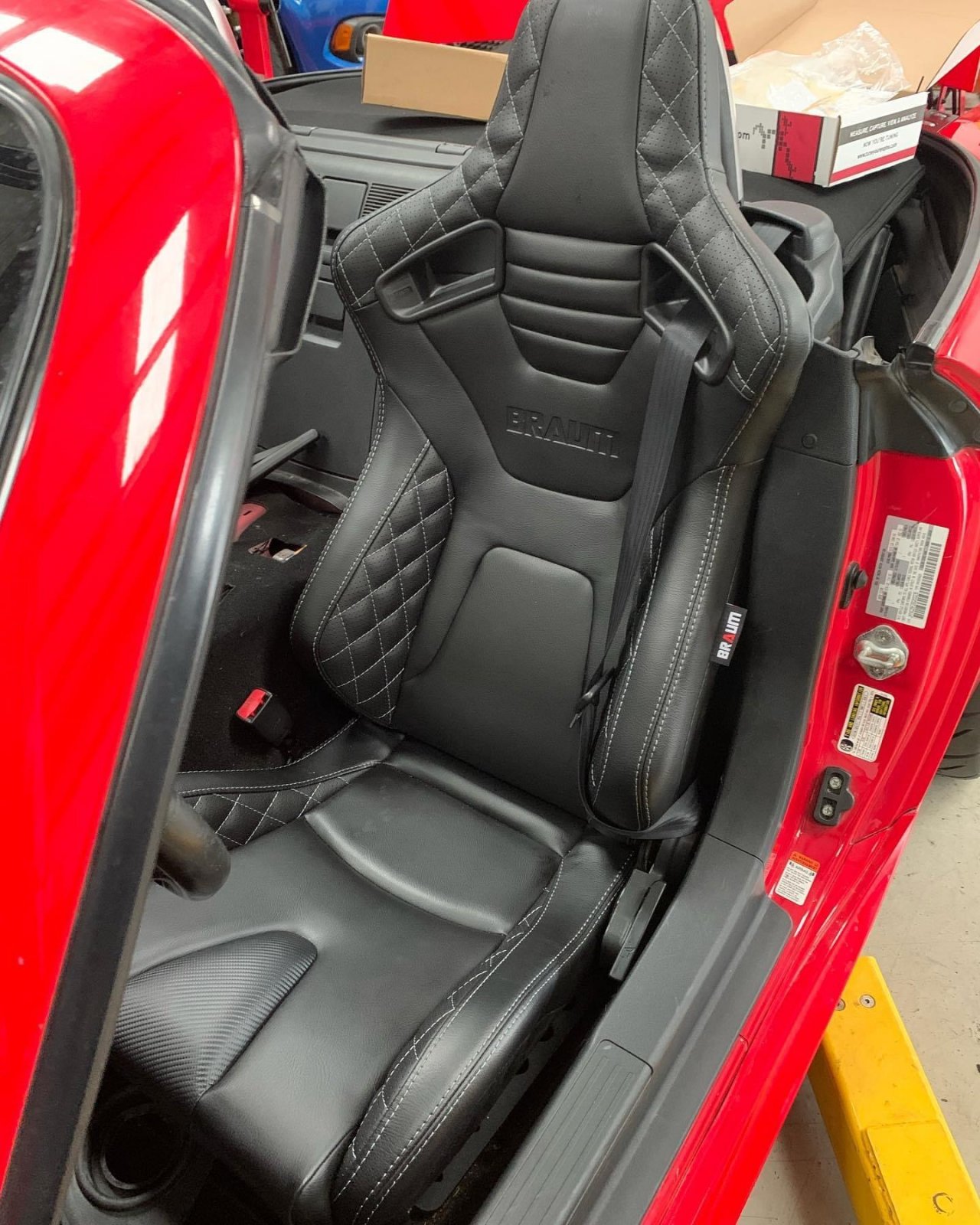

I have a blackbird roll bar coming and schroth 4 point ASM harnesses that will go nicely with my Braum elite X seats. This car isn’t done, but it has more coming

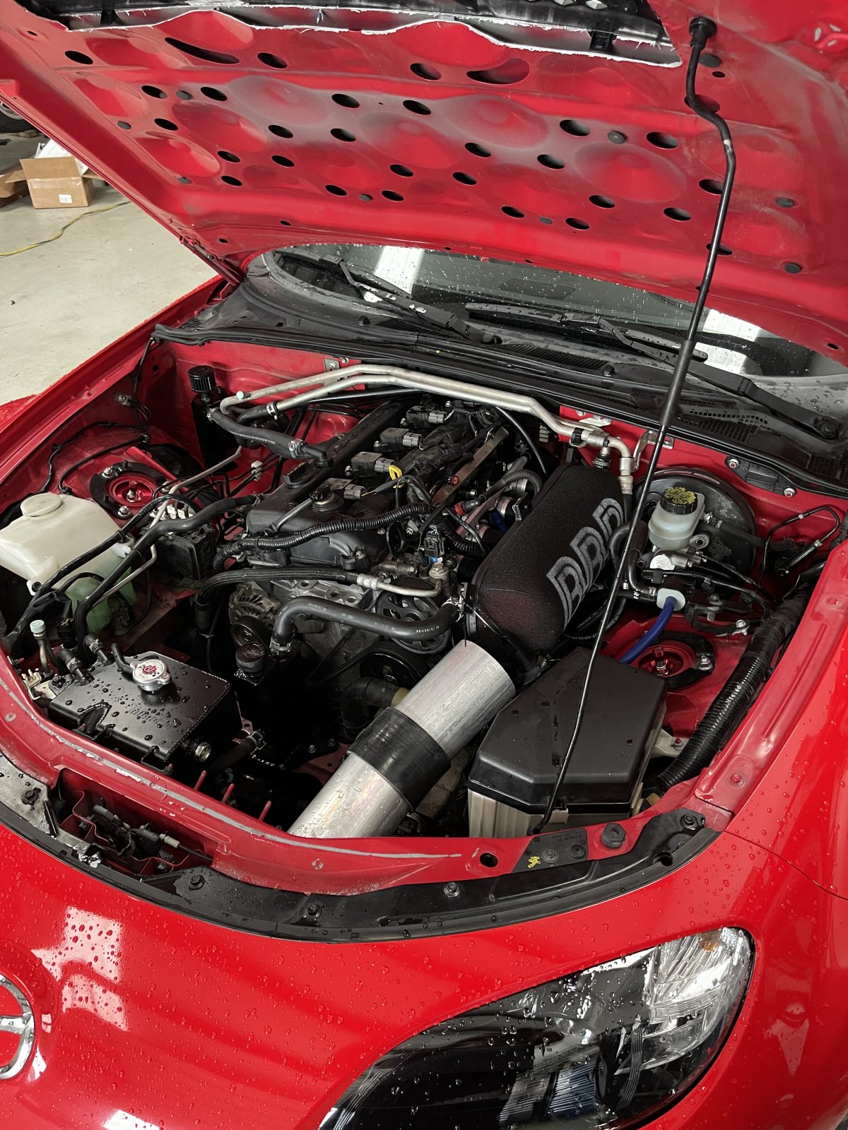

More coming, not done by any means. Cutting the rear bumper for a rear diffuser, figuring out an axle back exhaust solution that doesn’t sound terrible, light weight looks nice and will help down force. Also a front splitter, I haven’t ordered one yet. I am working on a finished 4” intake and likely make a plenum to force the ITB’s to pull from the 4” tube. Currently when stopped at a stop light, IAT’s sky rocket and the idle gets rough.

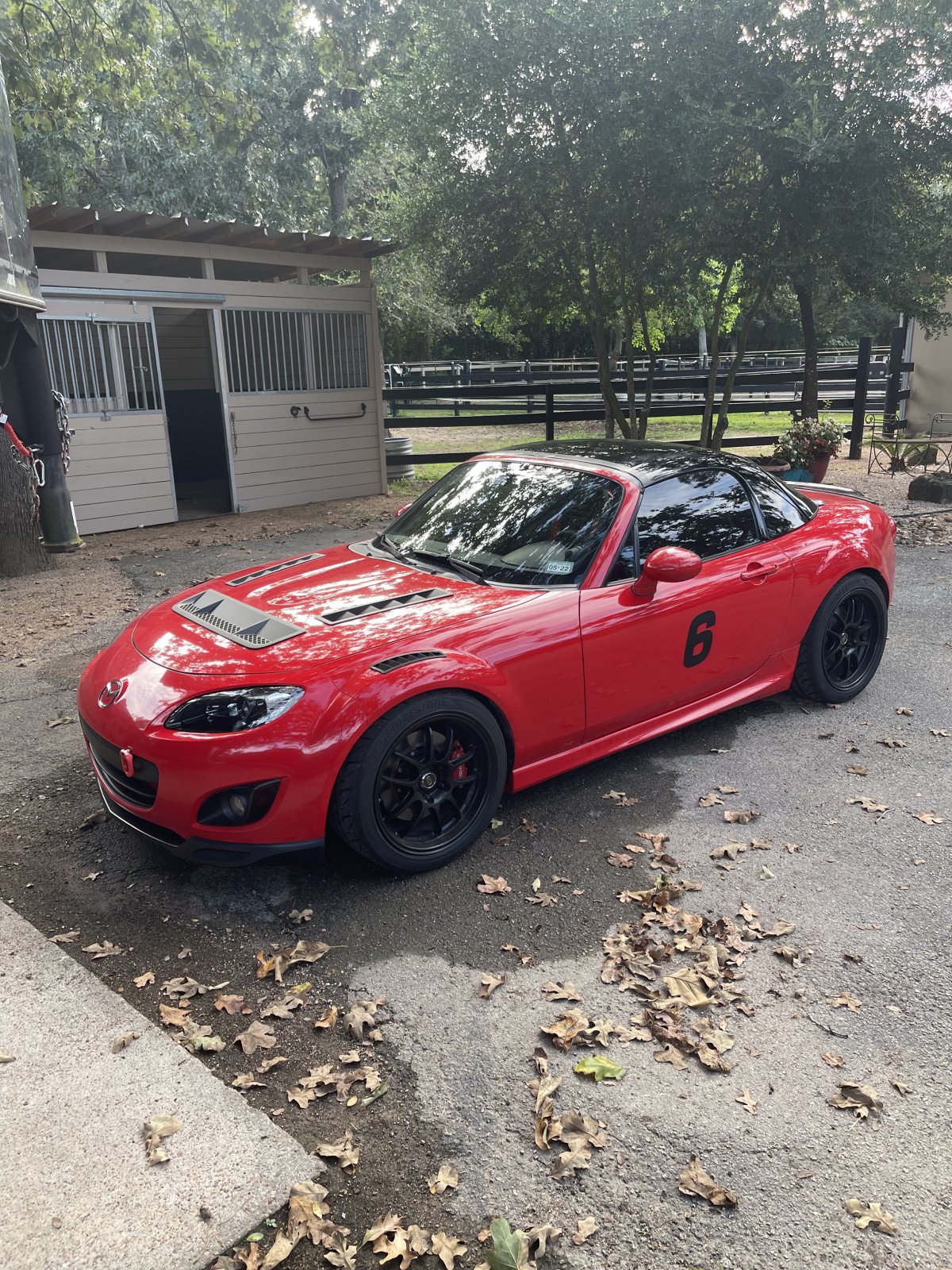

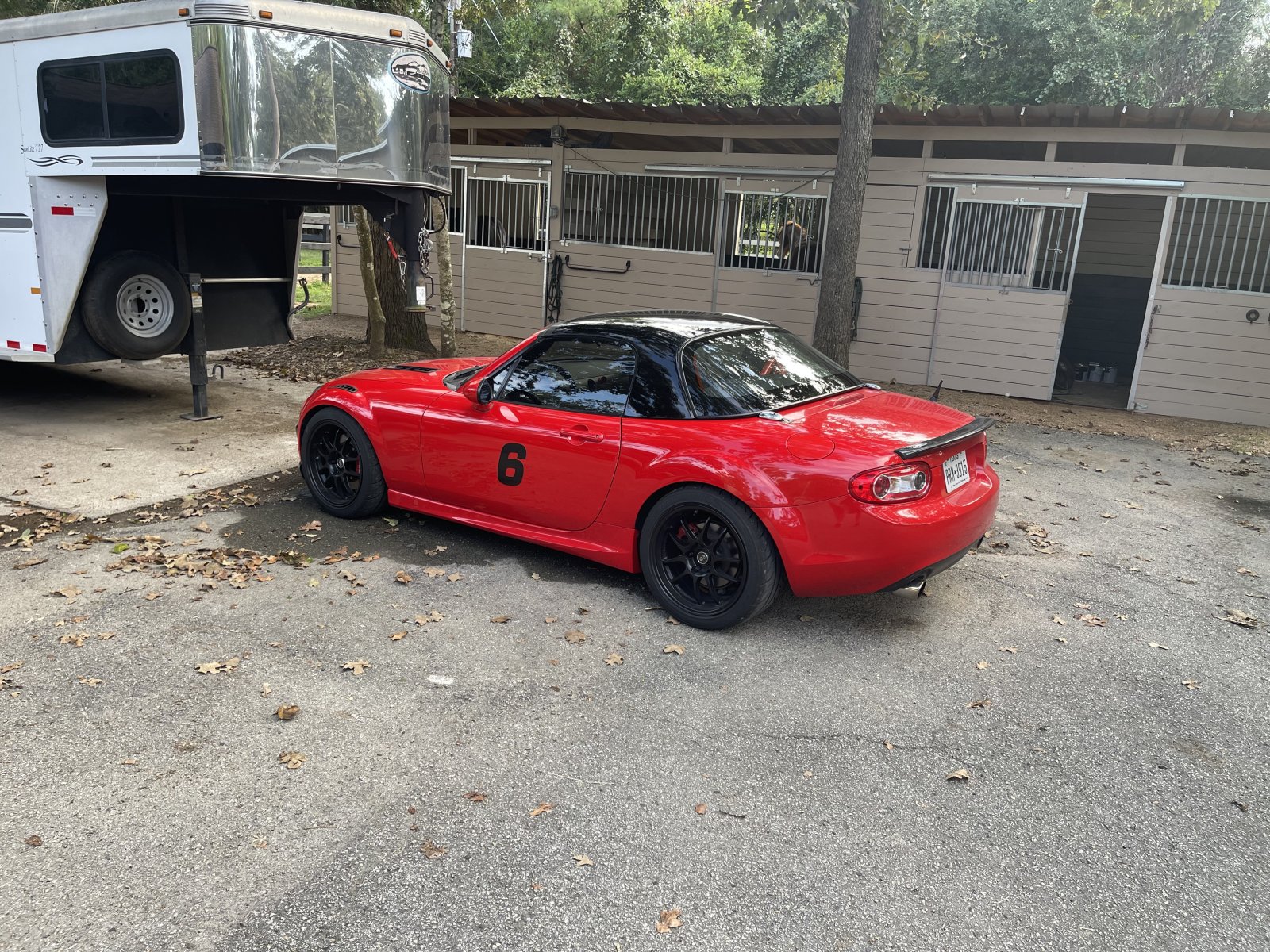

More vents, broke some stuff, upgraded that stuff, and more track time! Oh and now I have a hard top. Going to add a vacuum pump for the brakes and head back to the track hopefully in October

upgraded the brakes with slightly larger 2 piece rotors up front with wilwood 4 piston calipers and 2 piece rotors in the rear. I also added a vacuum pump because between the cams and ITB’s they weren’t creating nearly enough vacuum for the brakes.

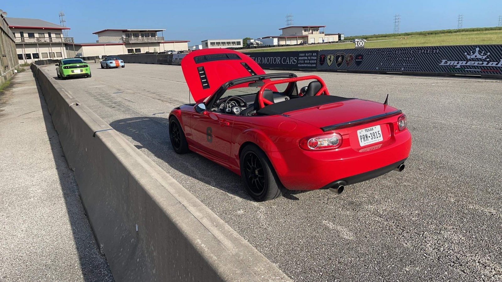

After a long hiatus, I finally came back to auto X in November, the upgrades and raced 2 days in a row. I had a lot of fun and there was 1 giant glaring issue from both days, grip. So, my 17x9 with 245/40/17’s came off and 17x10 with 255/40/17’s went on. I was rubbing like crazy (I expected this) I went way more aggressive with the alignment and pulled the fenders as much as I could.
I also installed a new fuel system. I now have a full return system with a surge tank.
I went to MSR for a Miata track day and learned that the fenders were not pulled enough, The tires felt like all seasons on a Buick. The fuel system threw the tune off a bit also and I didn’t get the updated tune until I was hauling the car home…
A few days later I went to Auto X again and while preparing the car, I went to adjust tire pressure and figured out why I was having such problems with the tires at the track day… the gauge was broken and instead of having 32psi (what I set the tires to for the street) I was actually running 26 PSI… Russel saved the day and let me borrow his tire pressure gauge. Magic happened and the tires actually started doing what they were supposed too. I kept stiffening the dampers and getting faster. I never lost grip all day, but I did go off course 2 times in the same spot, the first time I went over the bumper put 2 tires in the grass. The second time only hit the bumper, but it compressed the suspension on the driver front and ripped up all the fender liners. I pushed through the rest of the run dragging plastic.
I have fender flares coming to fix the rubbing issue forever. I also will be replacing the ITB’s with a supercharger, I need more power to keep up the with Lotus in my class. Annnd on Black Friday I also ordered a lexan spoiler and a front splitter.
