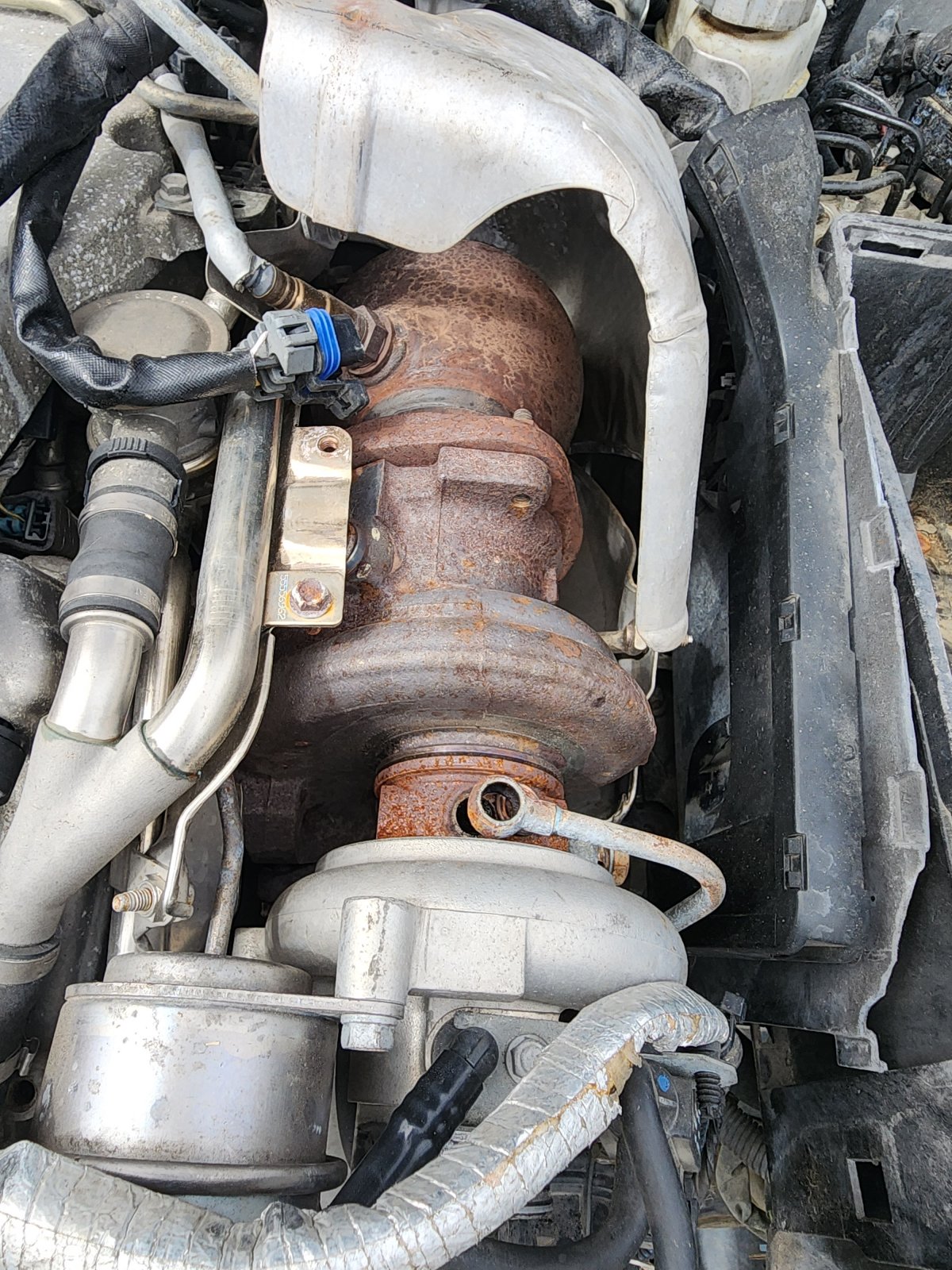

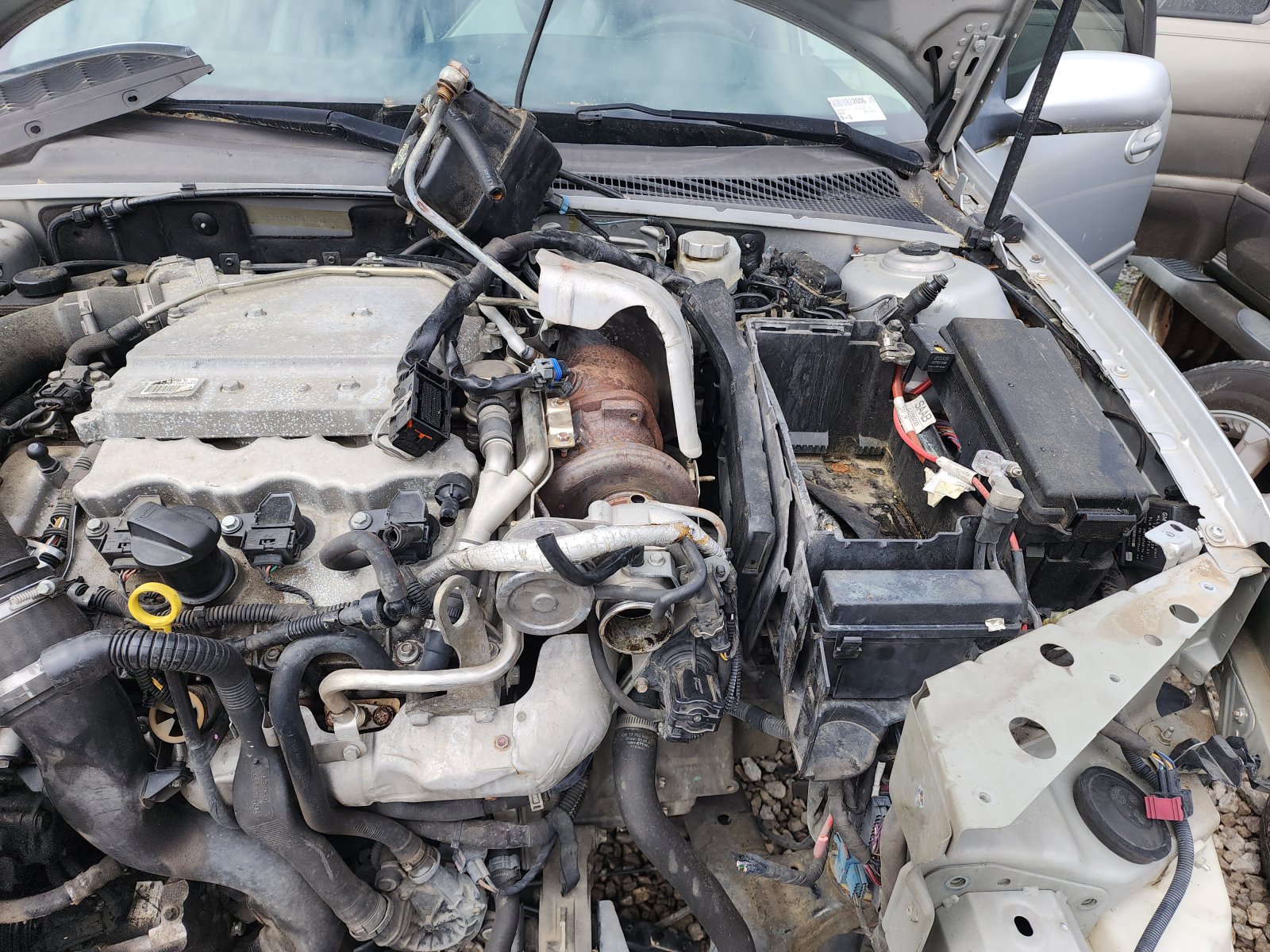

Hot exhaust issue? If the turbo is where the fuse box is the exhaust on the forward bank of the motor goes up and towards the trans. A little more space between it and the gas tank than the usual V6 arrangement.
If you are talking about the exhaust/ muffler and a rear mounted tank, the exhaust is a lot cooler by the time it gets there, than the turbo will be. It’s still probably fine with the metal tank and nothing a heat shield wouldn’t fix with the plastic tank.
95Blitz

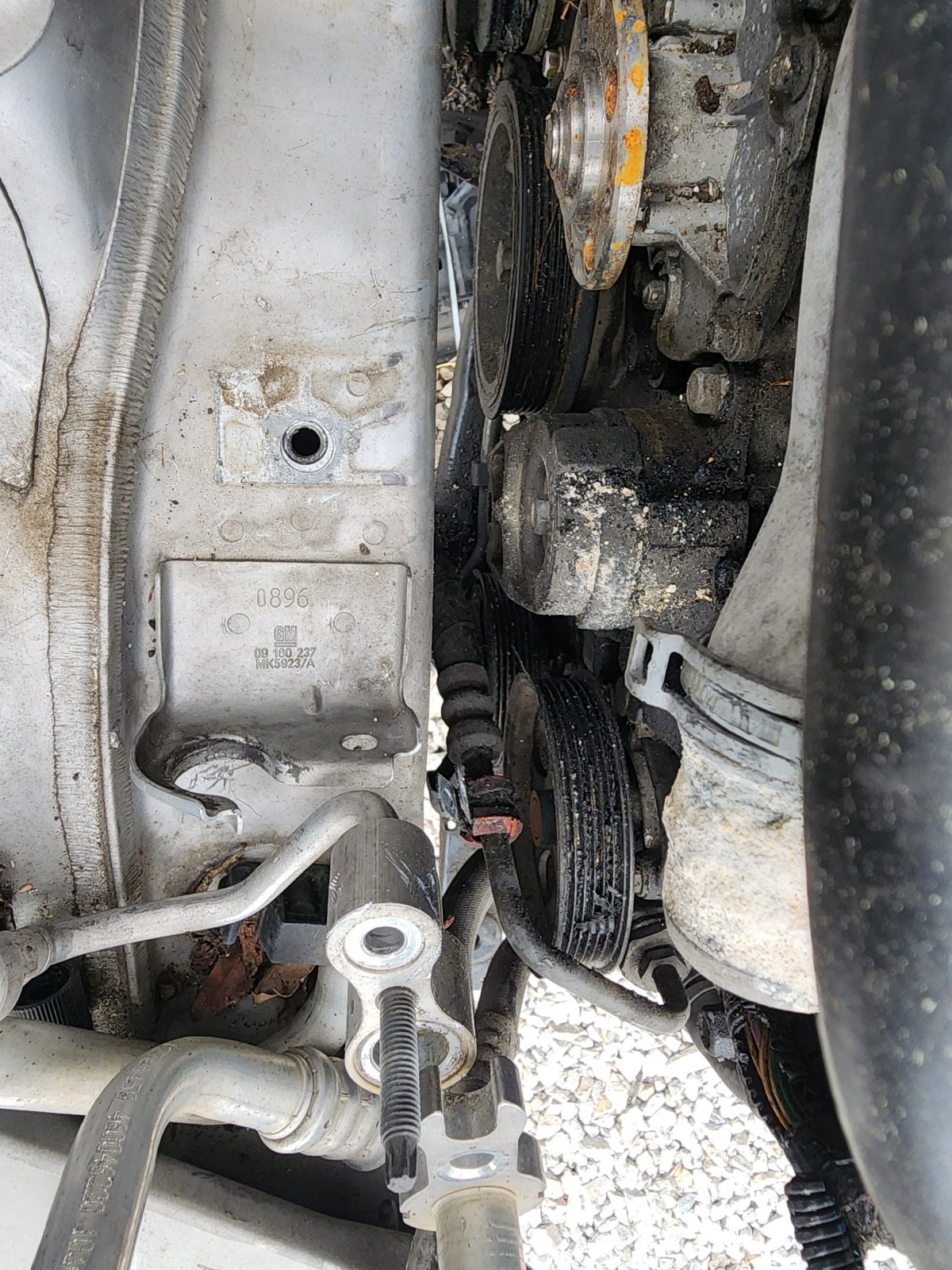

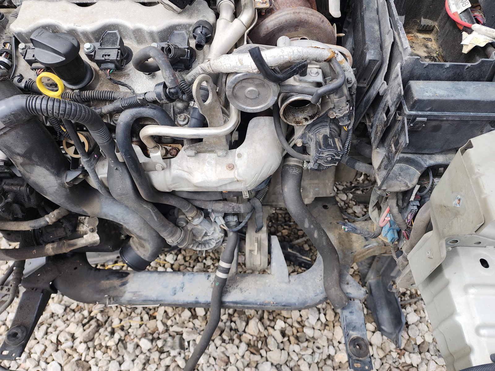

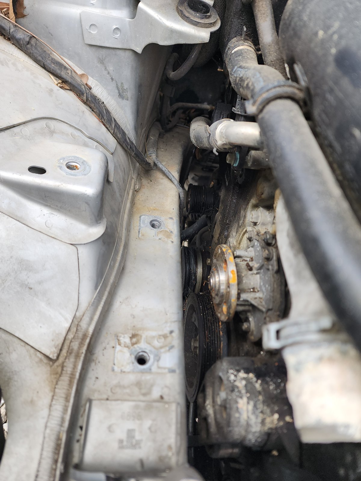

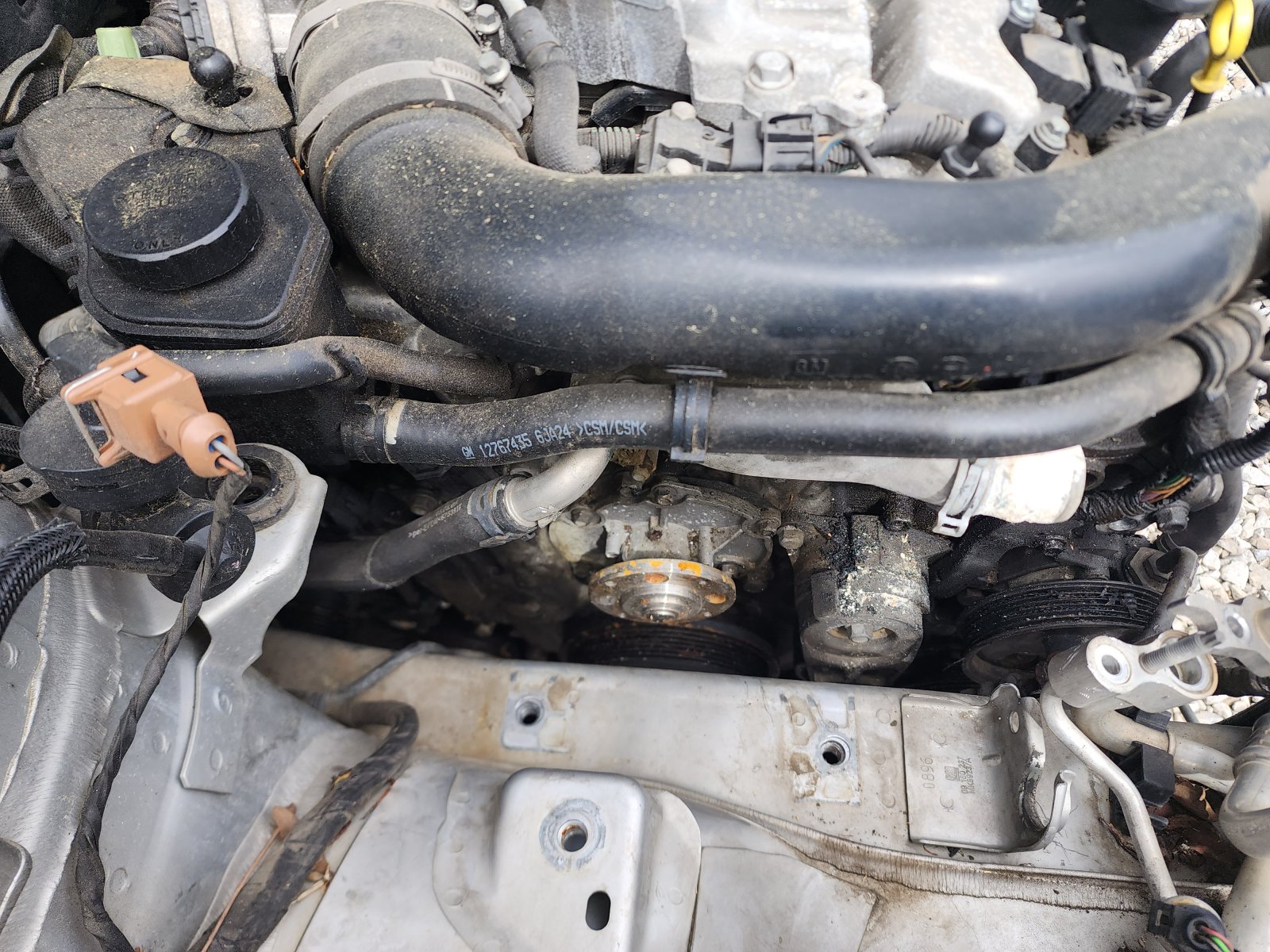

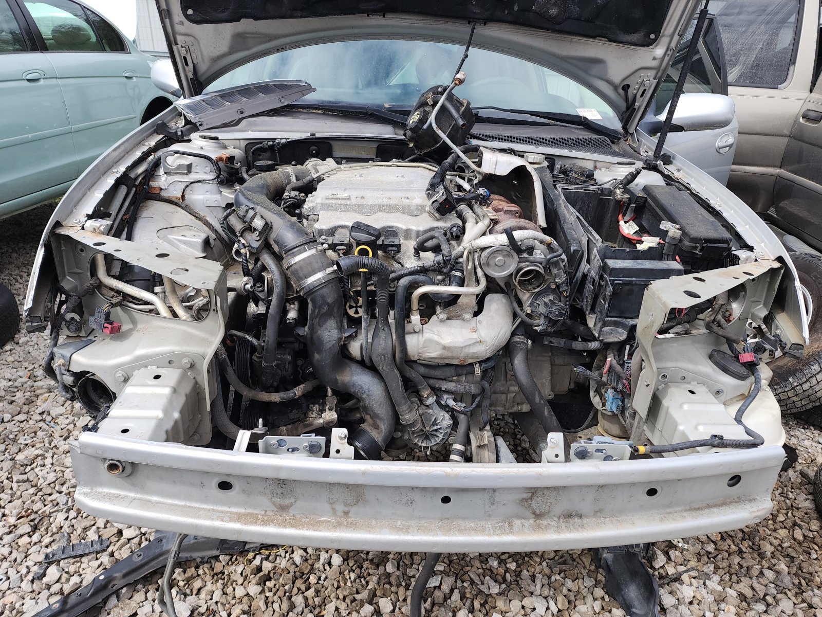

So after looking the fuse box would need to be move to above the fuel tank on the passenger side. But it would fit with a few mods. If I had the money I would go back and get the motor and trans just as a test later on.

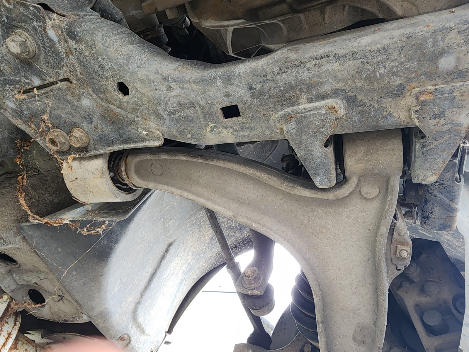

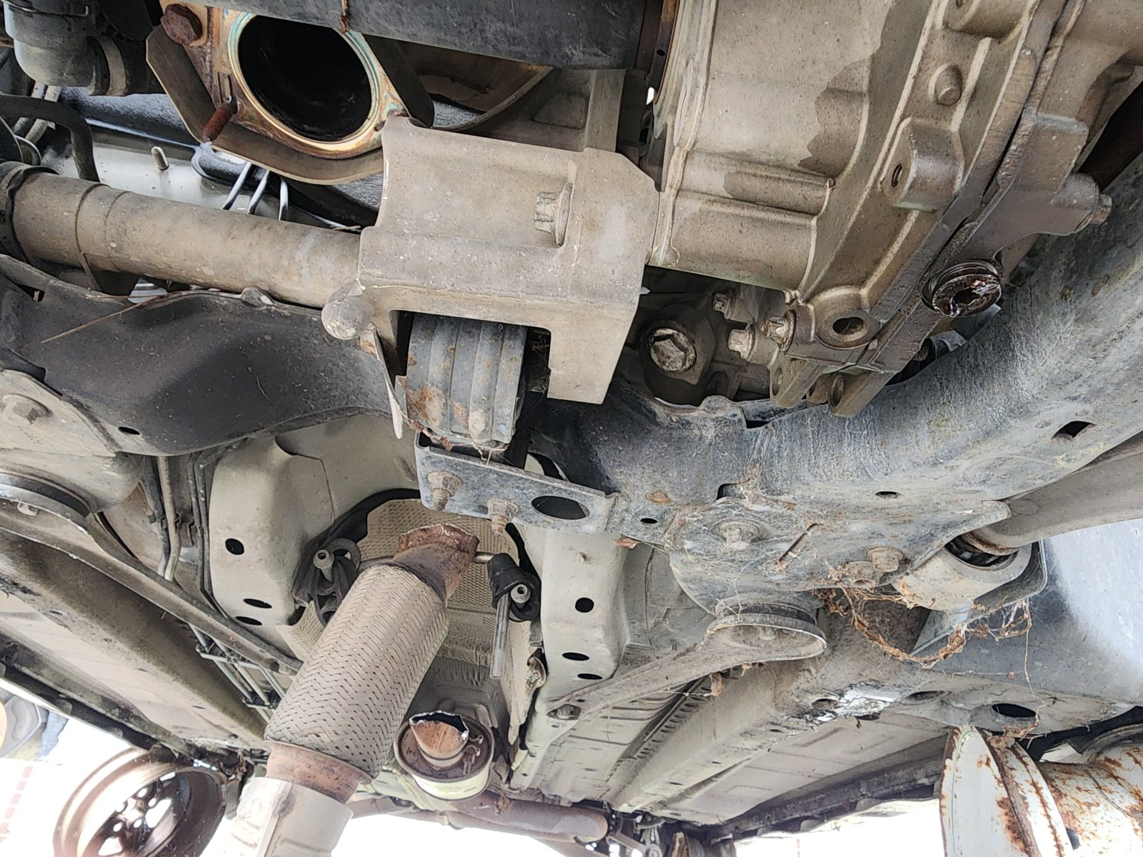

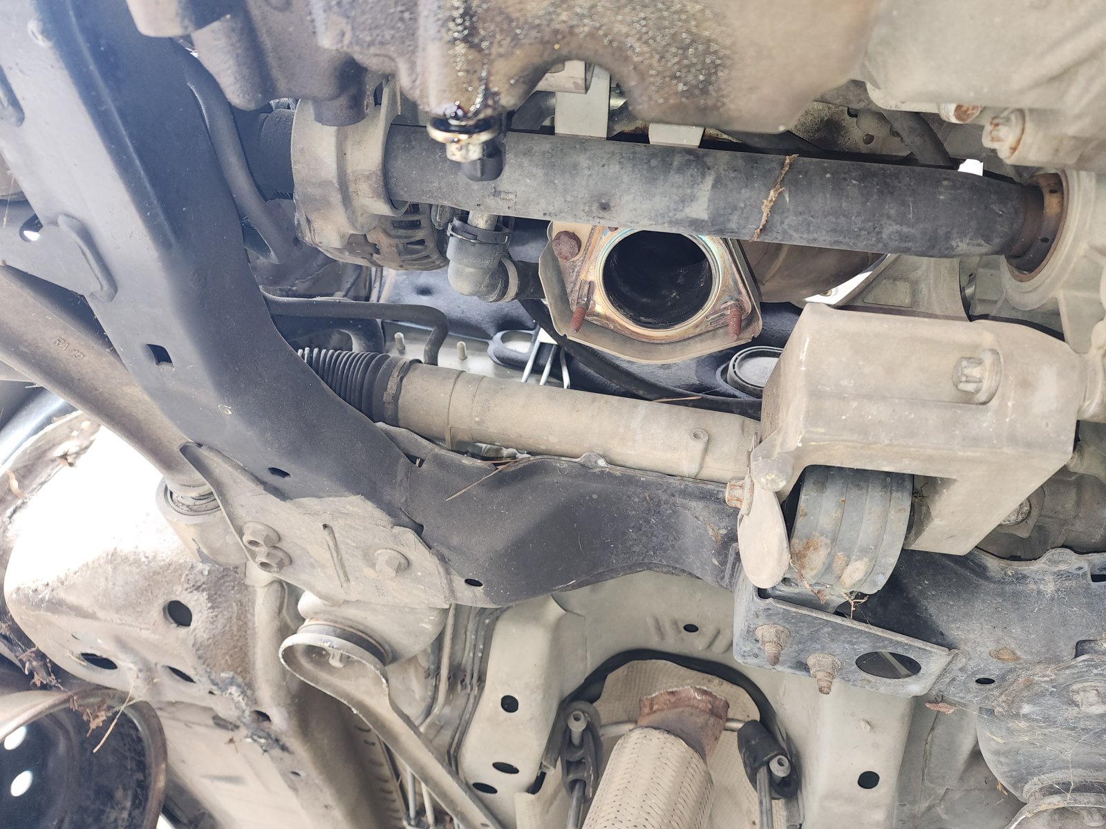

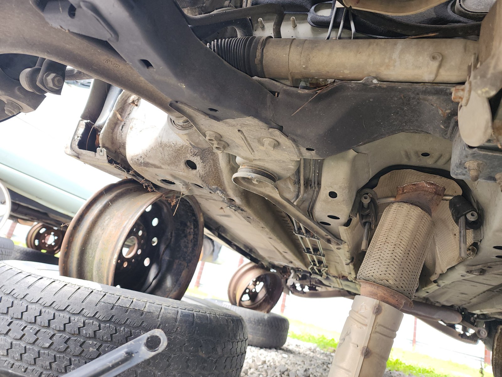

Here are a few measurements I took of the sub frame.
Subframe 38.5" wide at the front of the car, a little over 32" front to back.
12.5" front Trans mount flange to drivers side front subframe bolt
I was hoping the subframe would bolt straight to the Goblin but it won't.
Here are the pics I took.
